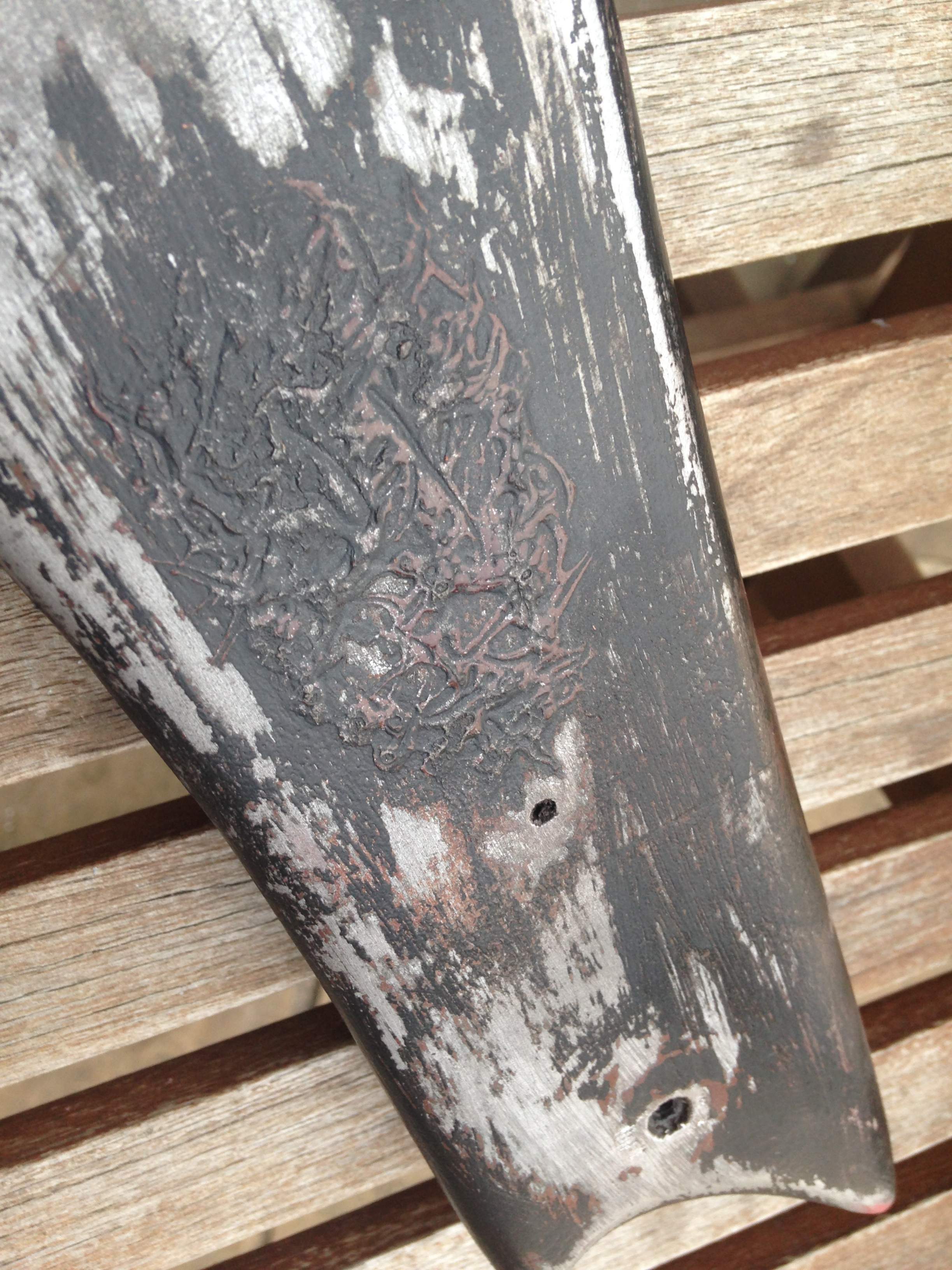

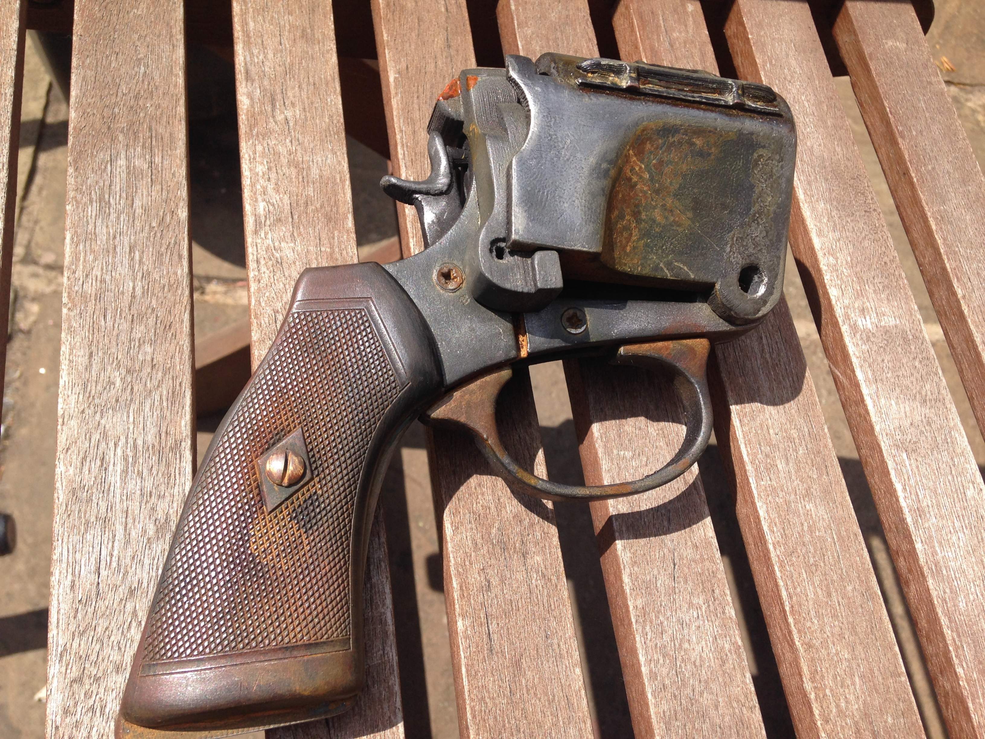

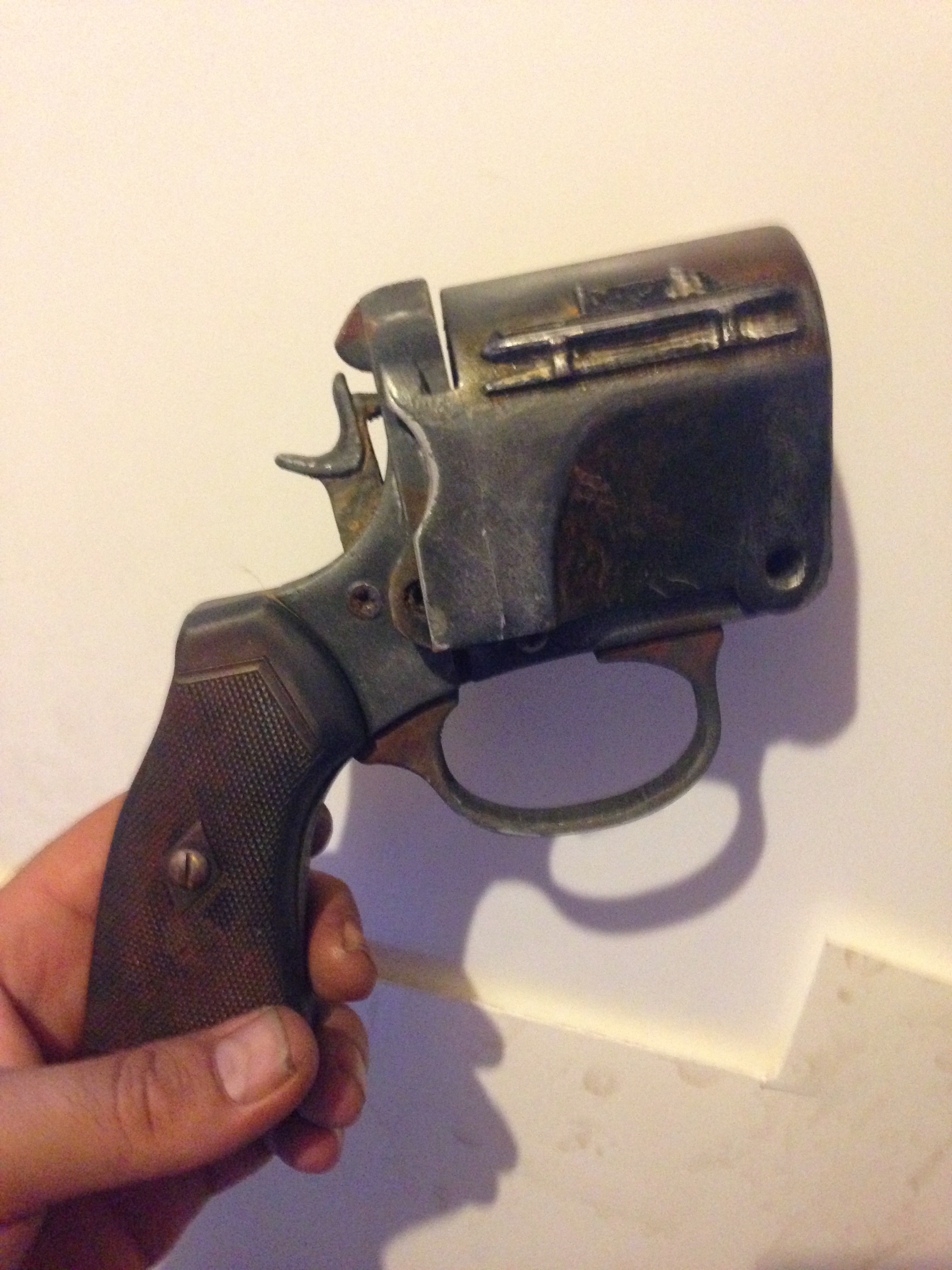

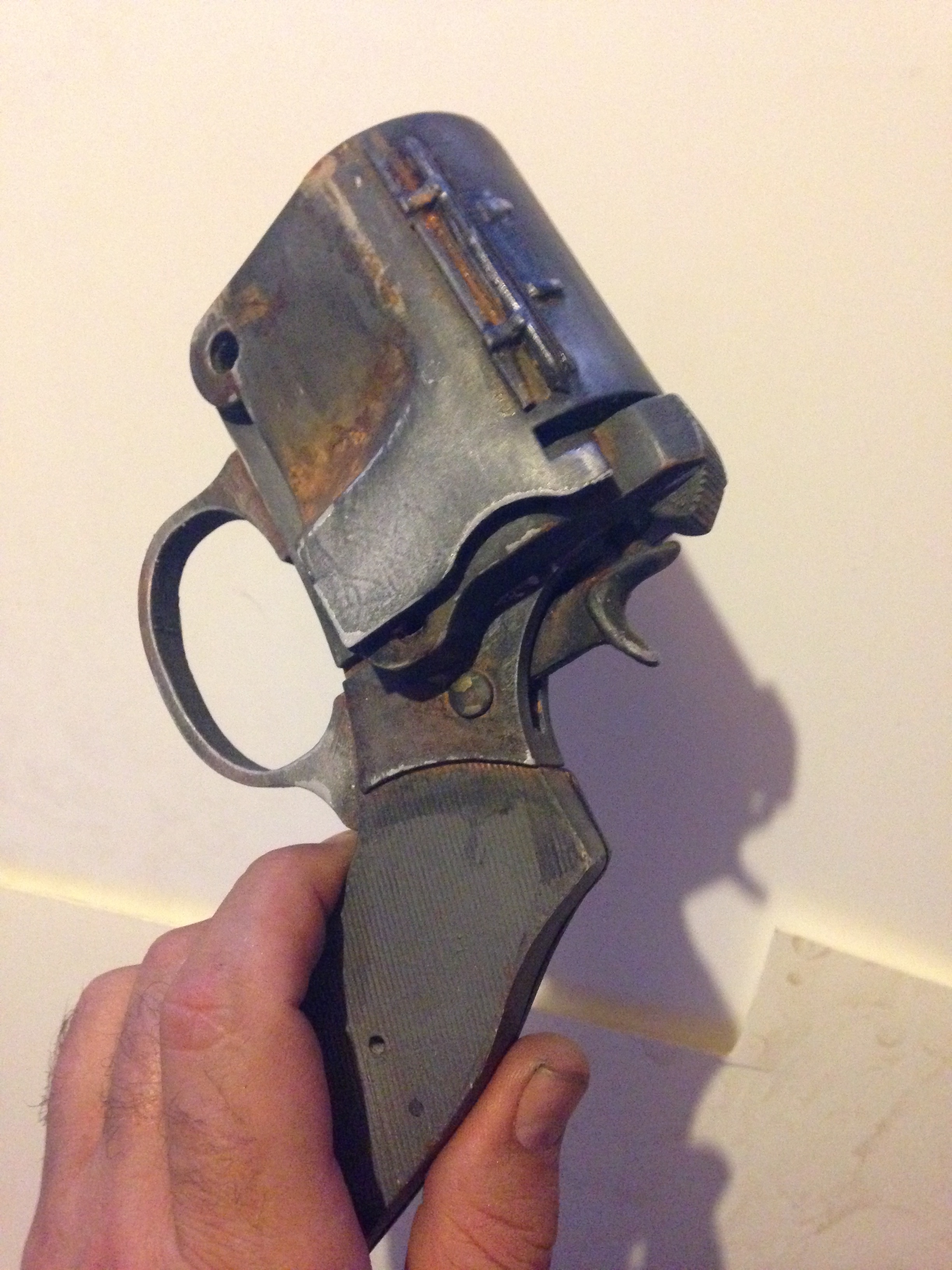

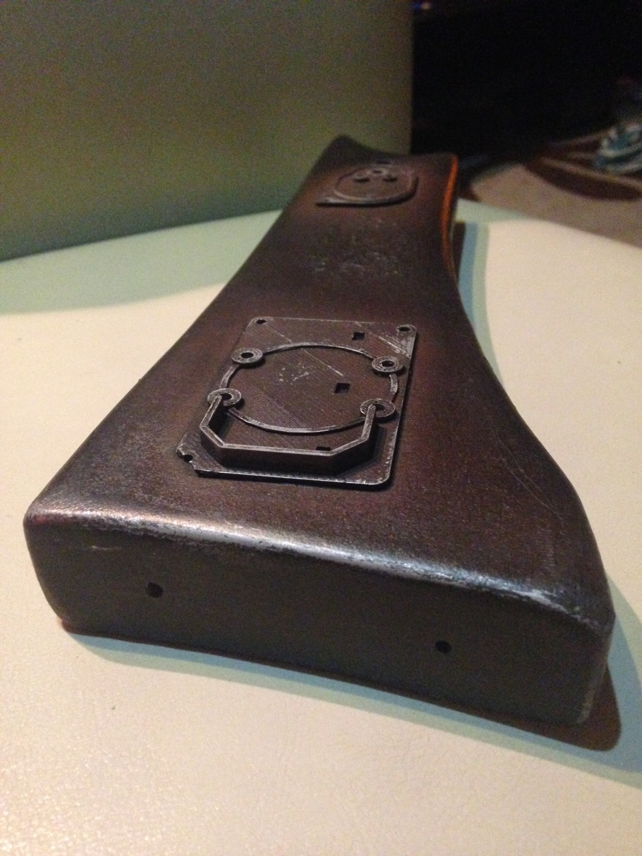

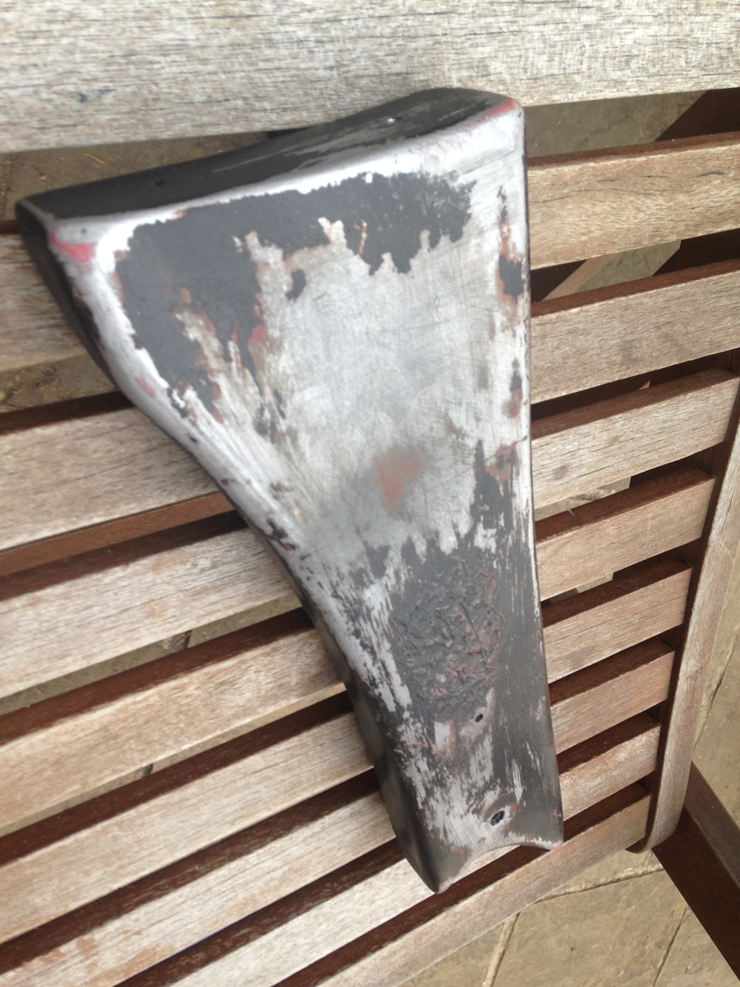

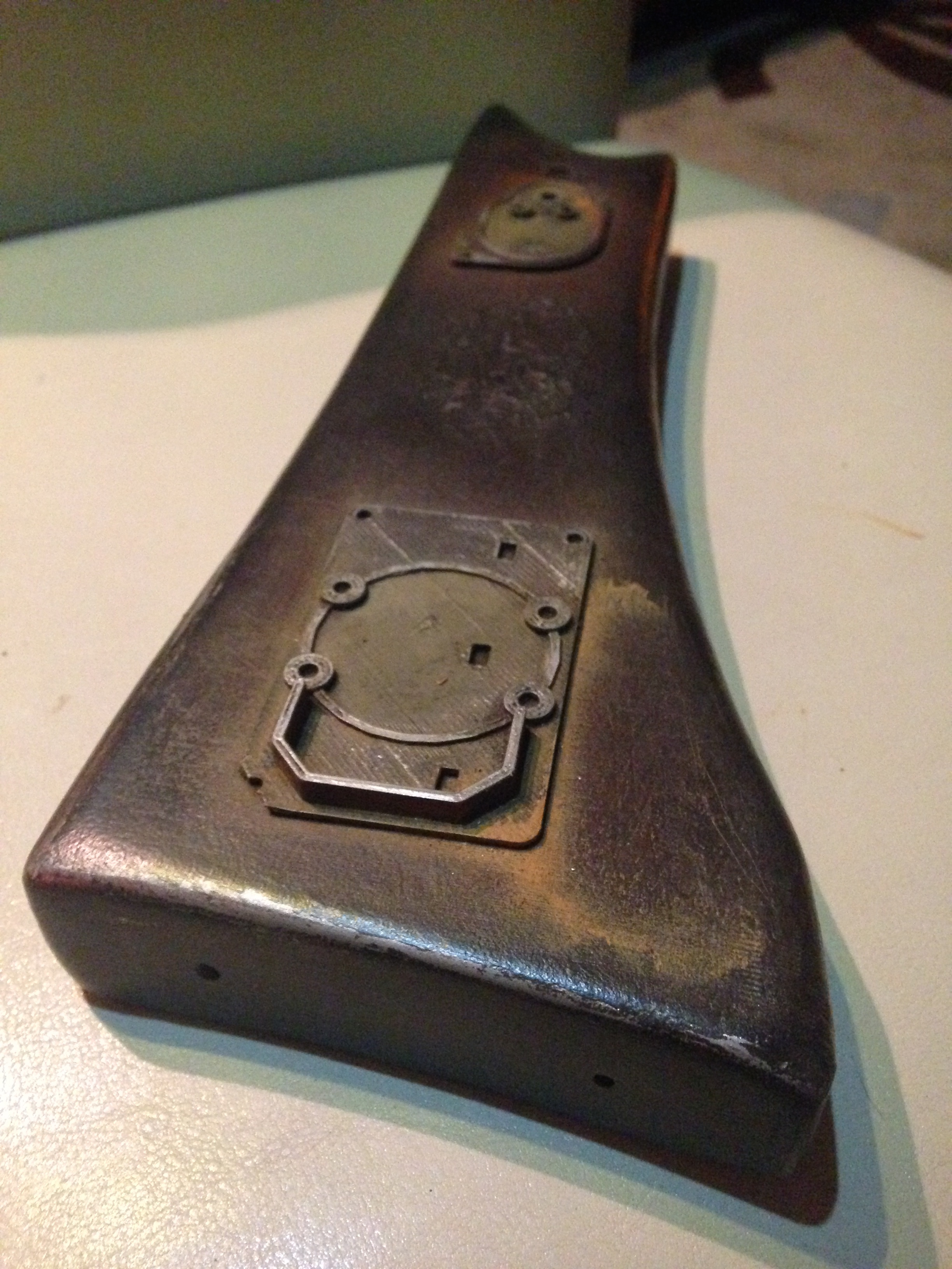

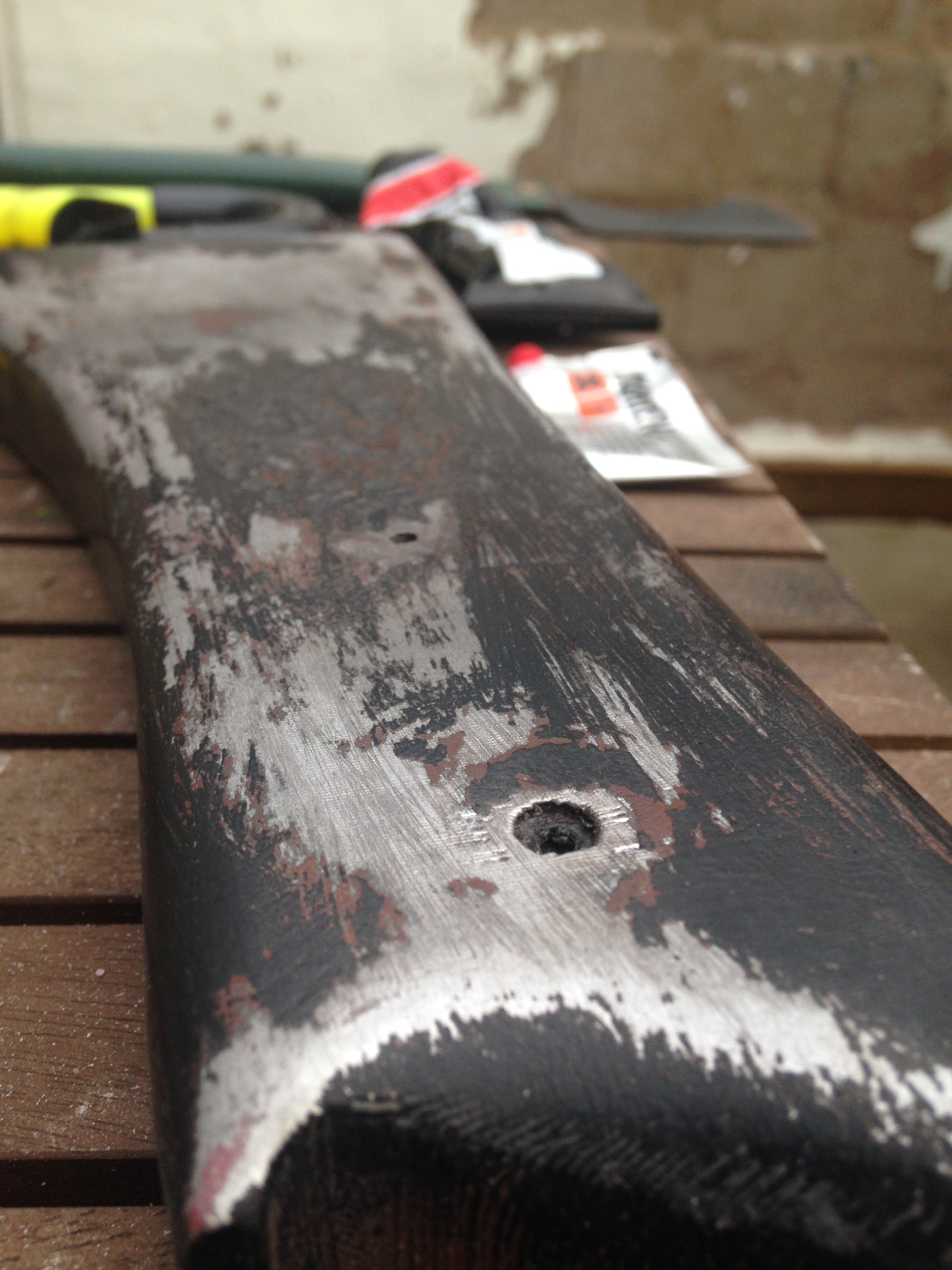

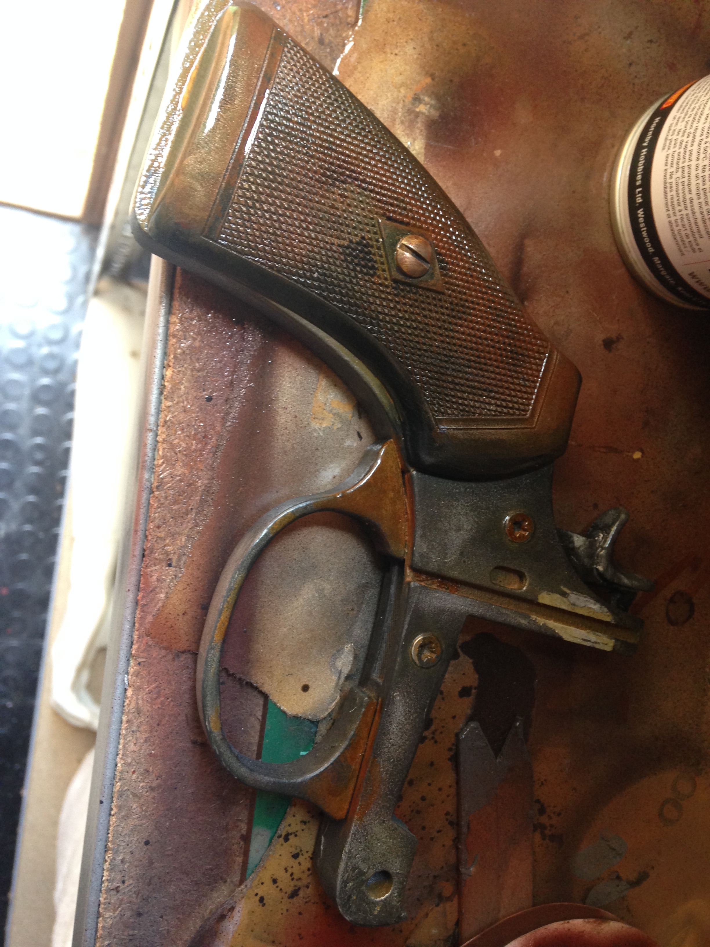

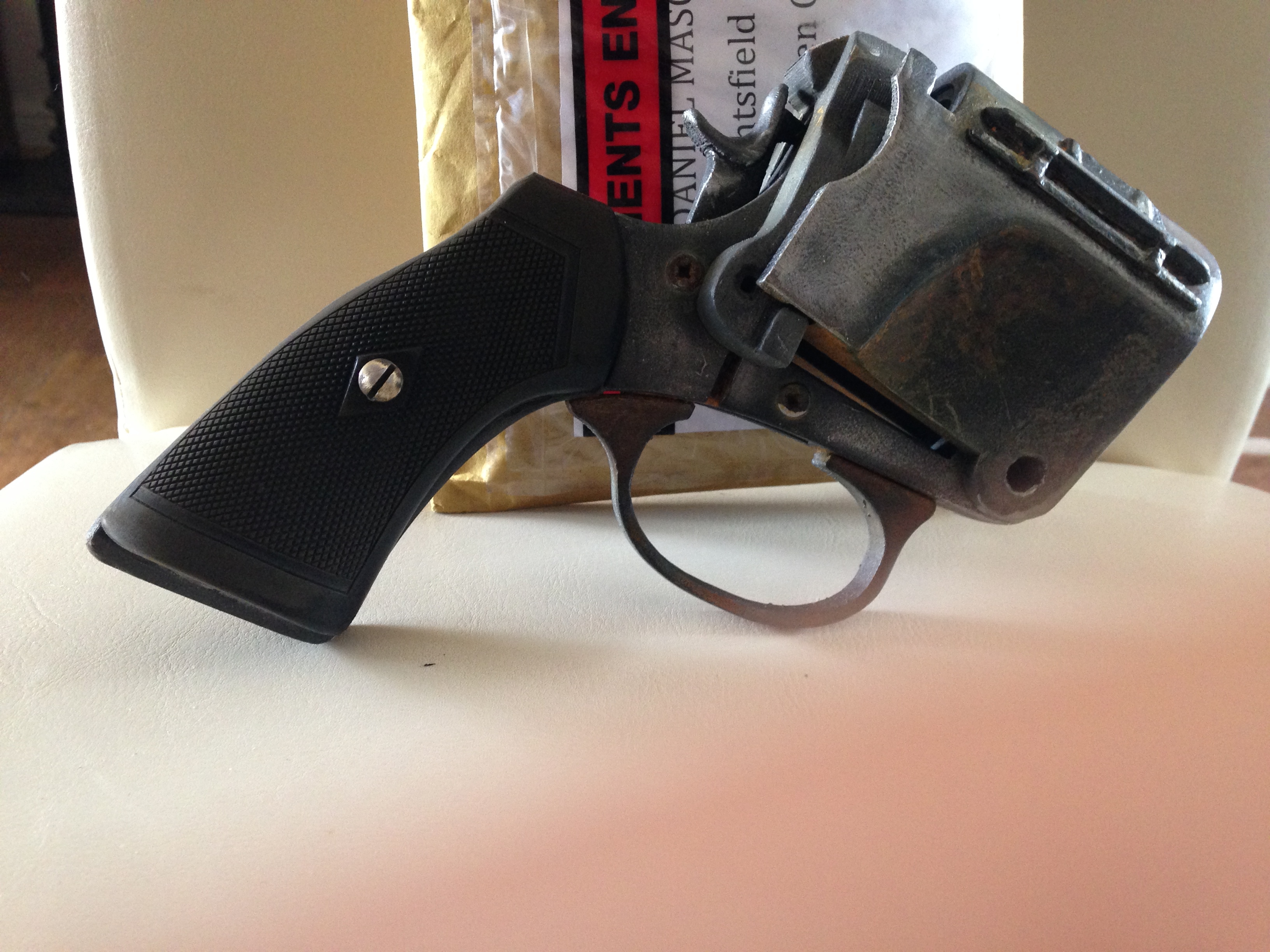

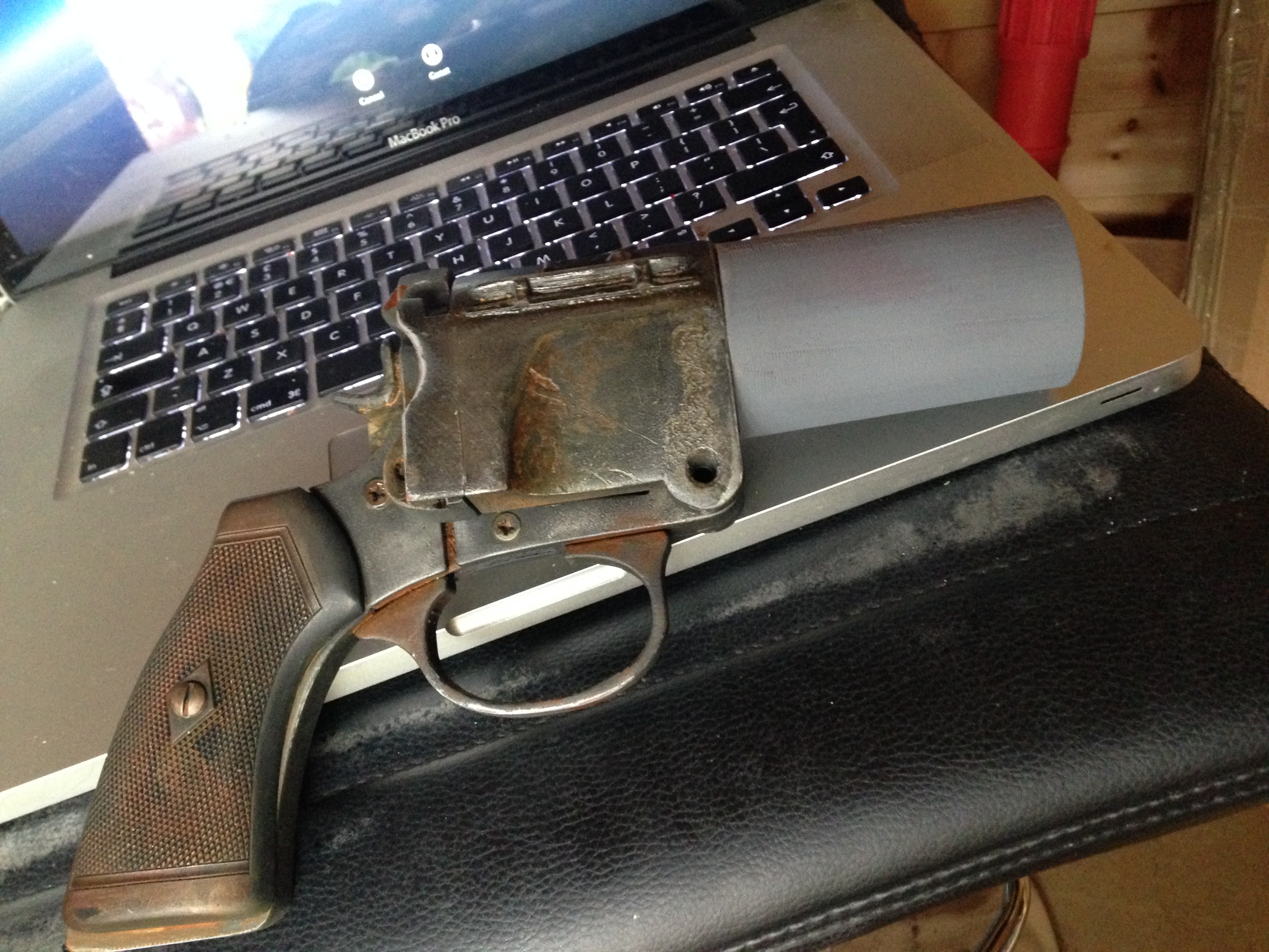

I base coat grey the another base coat of silver then a final base coat of gunmetal grey, then washed with black, then misted with smoke, then I use oranges reds and smoke for the rust then smear silver paint in certain areas to show a metal effect then mist with smoke again which is a sticky paint so stipple after to get the pitted effect the smear with your finger silver again then scotchbright it all,

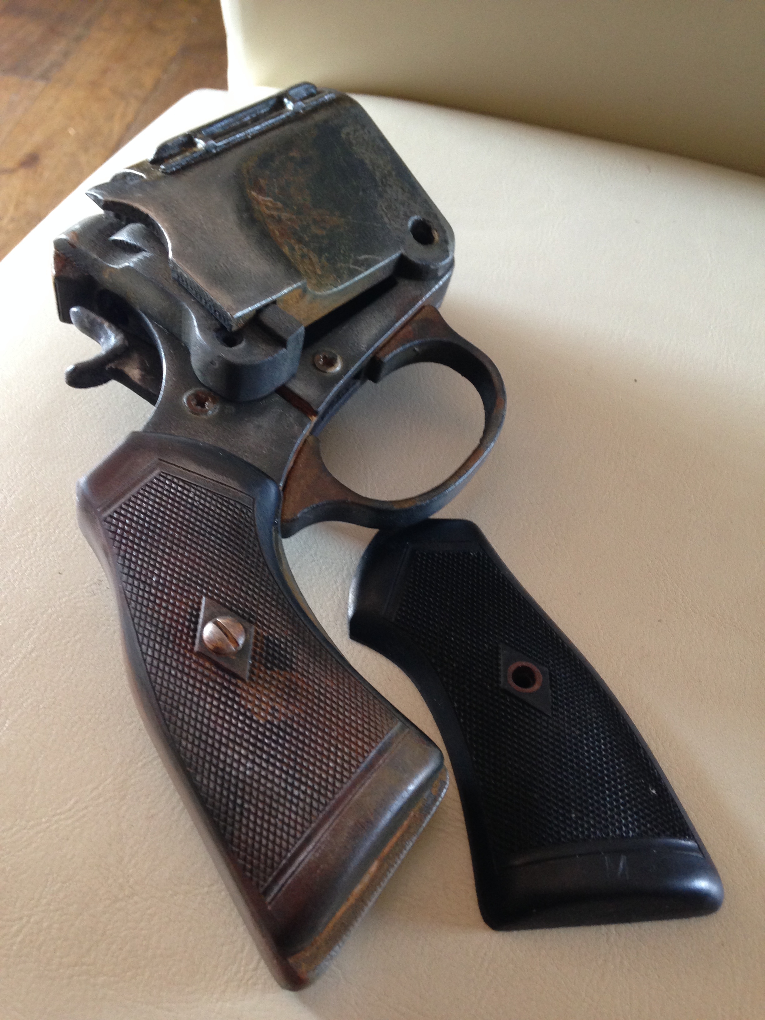

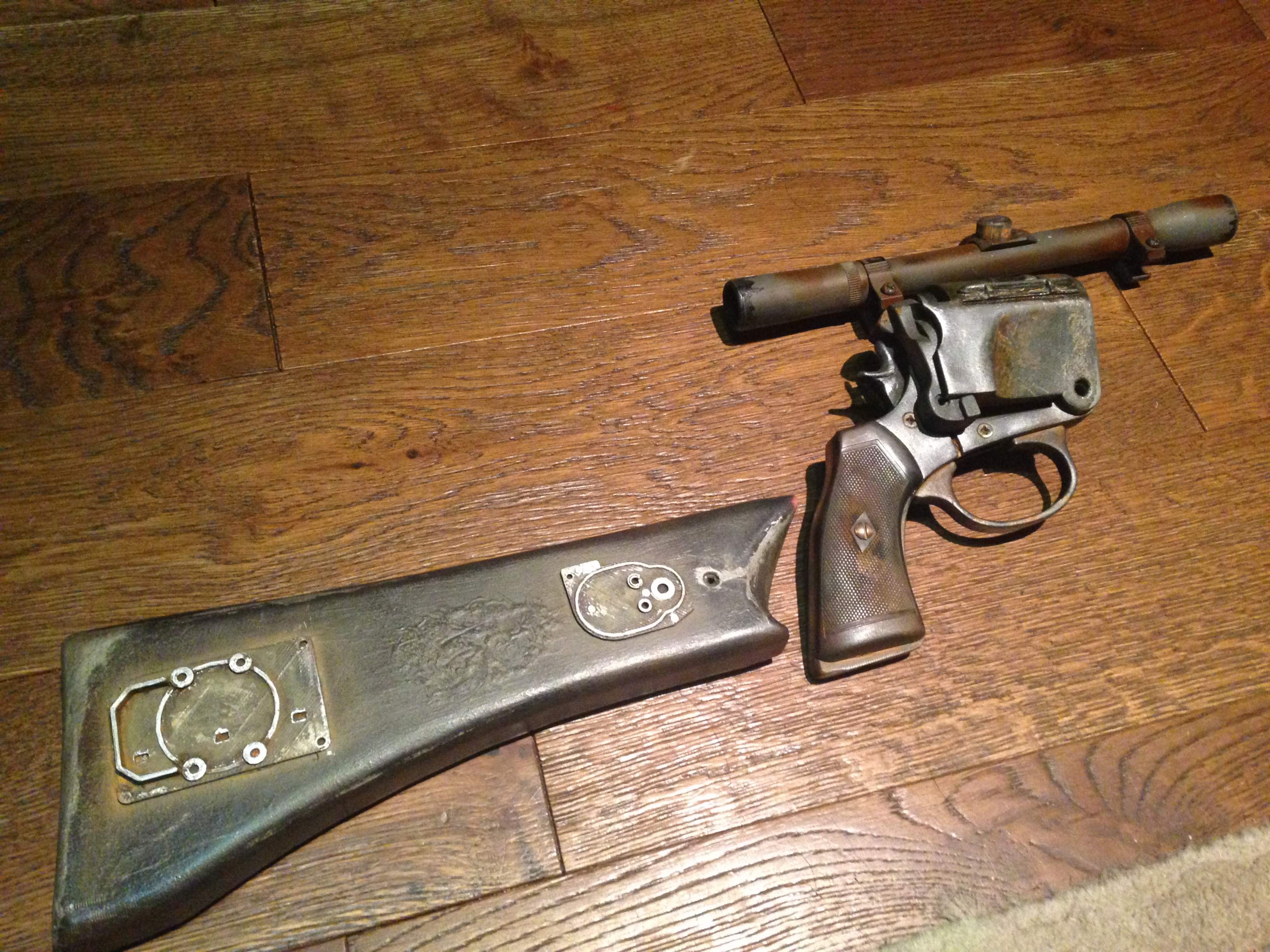

I finally got my vintage webley revolver 6 grips so applied and weathered,
IMG_2411.jpg IMG_2420.jpgIMG_2412.jpg remember to use translucent orange its sticky and shows the metal underneath

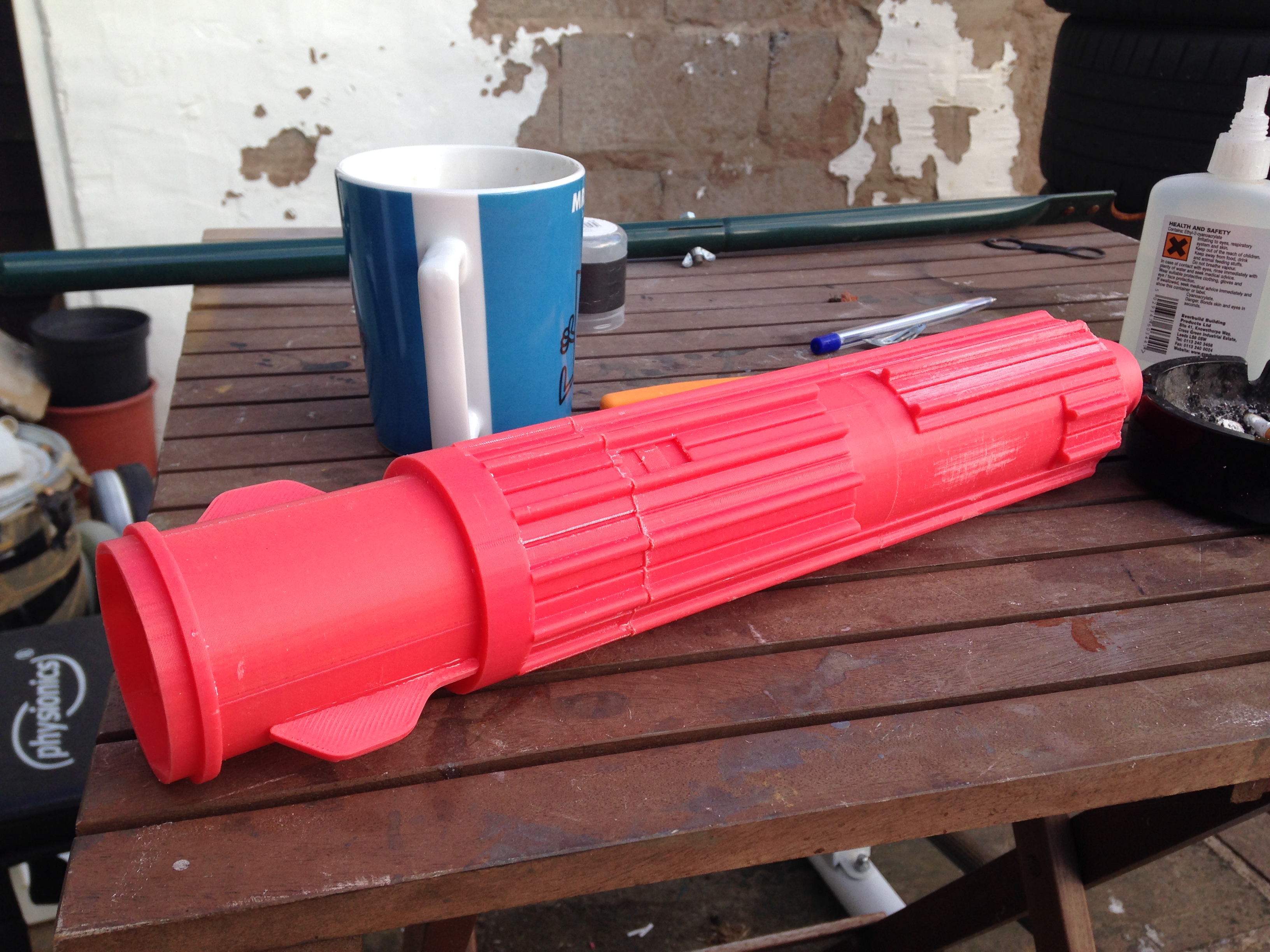

Hi Ralfskunk I'm using a UP2 printer its defo cost effective if you get a good deal on your ABS you can pick up 3 reels of 1kg ABS for around $100 on ebay the process takes about 2 reels, the only thing is its time consuming i think it took around 2 days non stop printing.

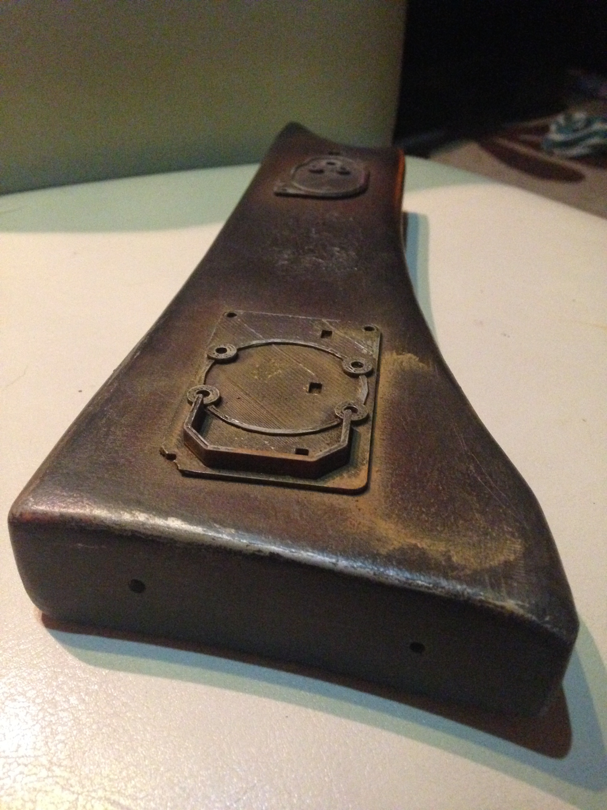

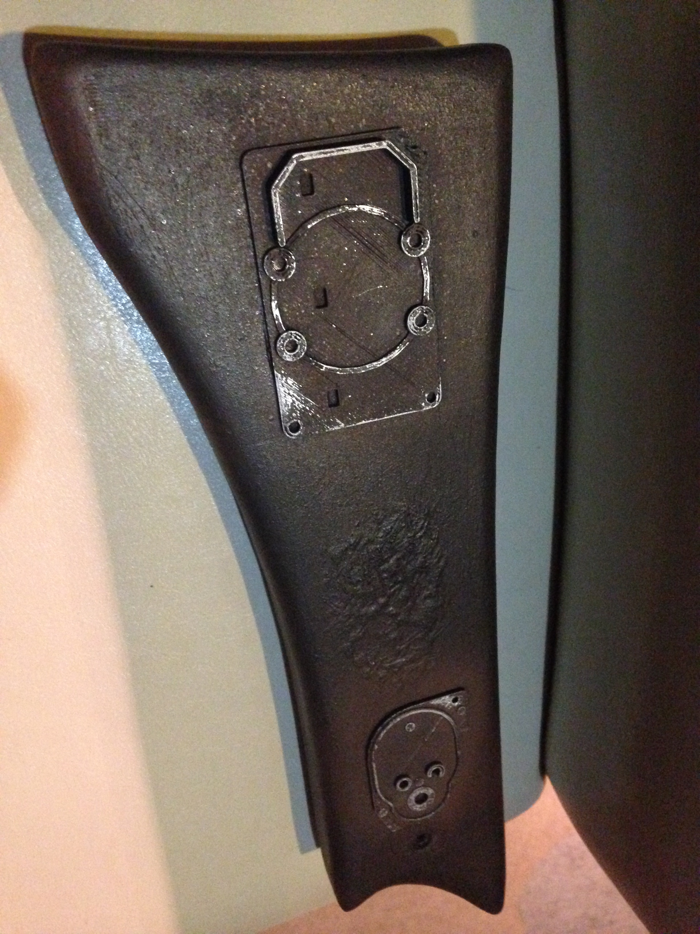

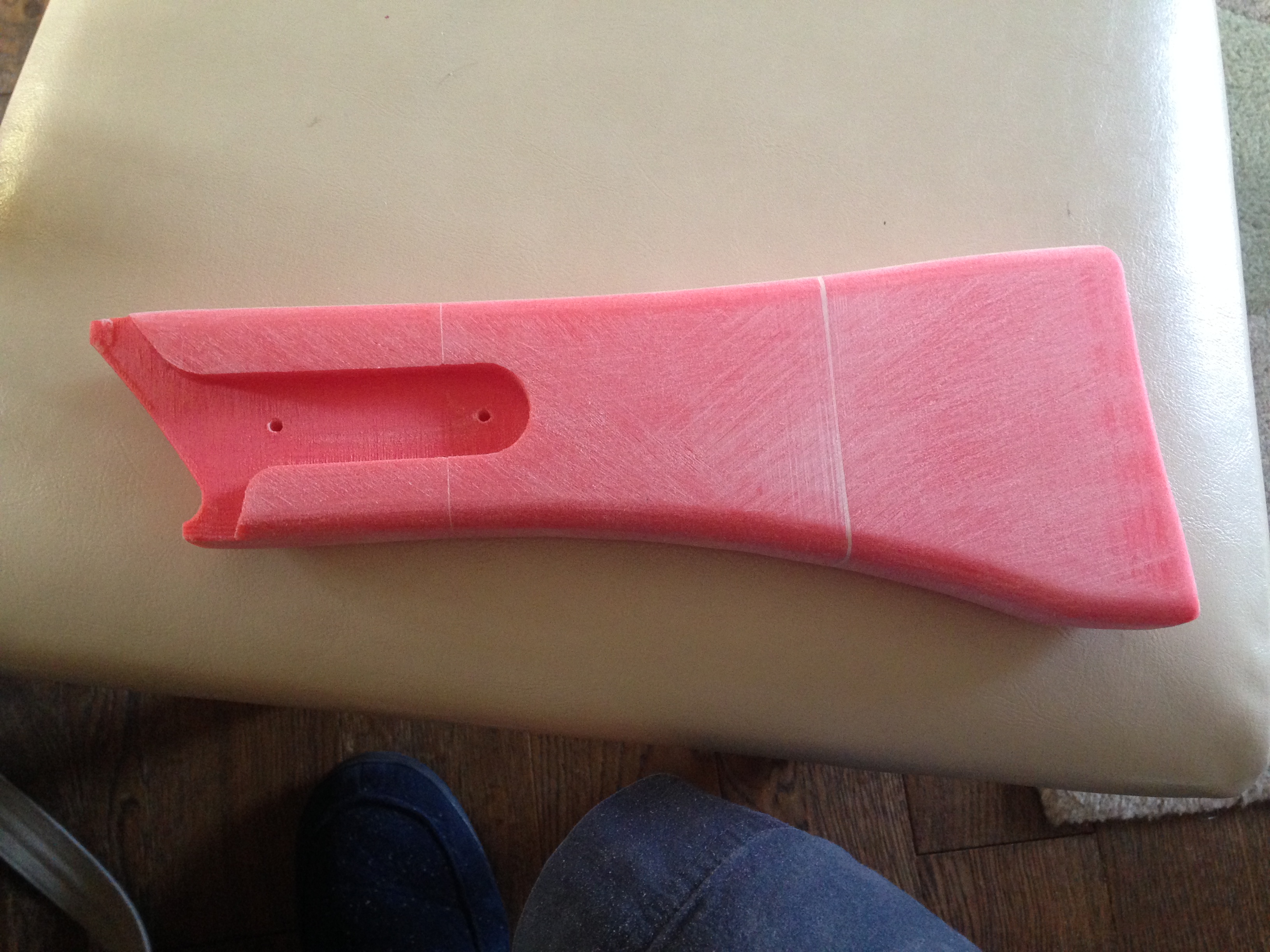

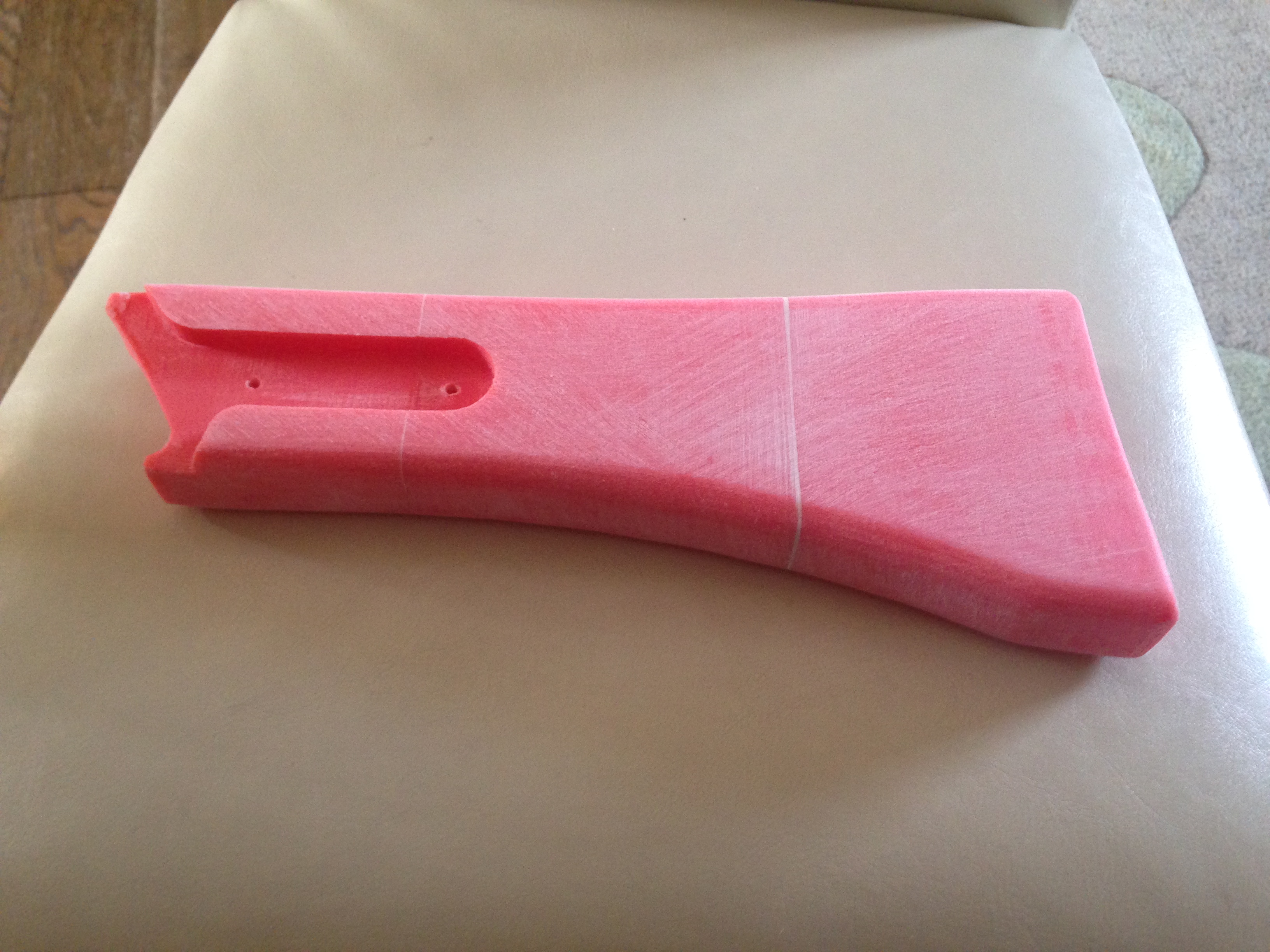

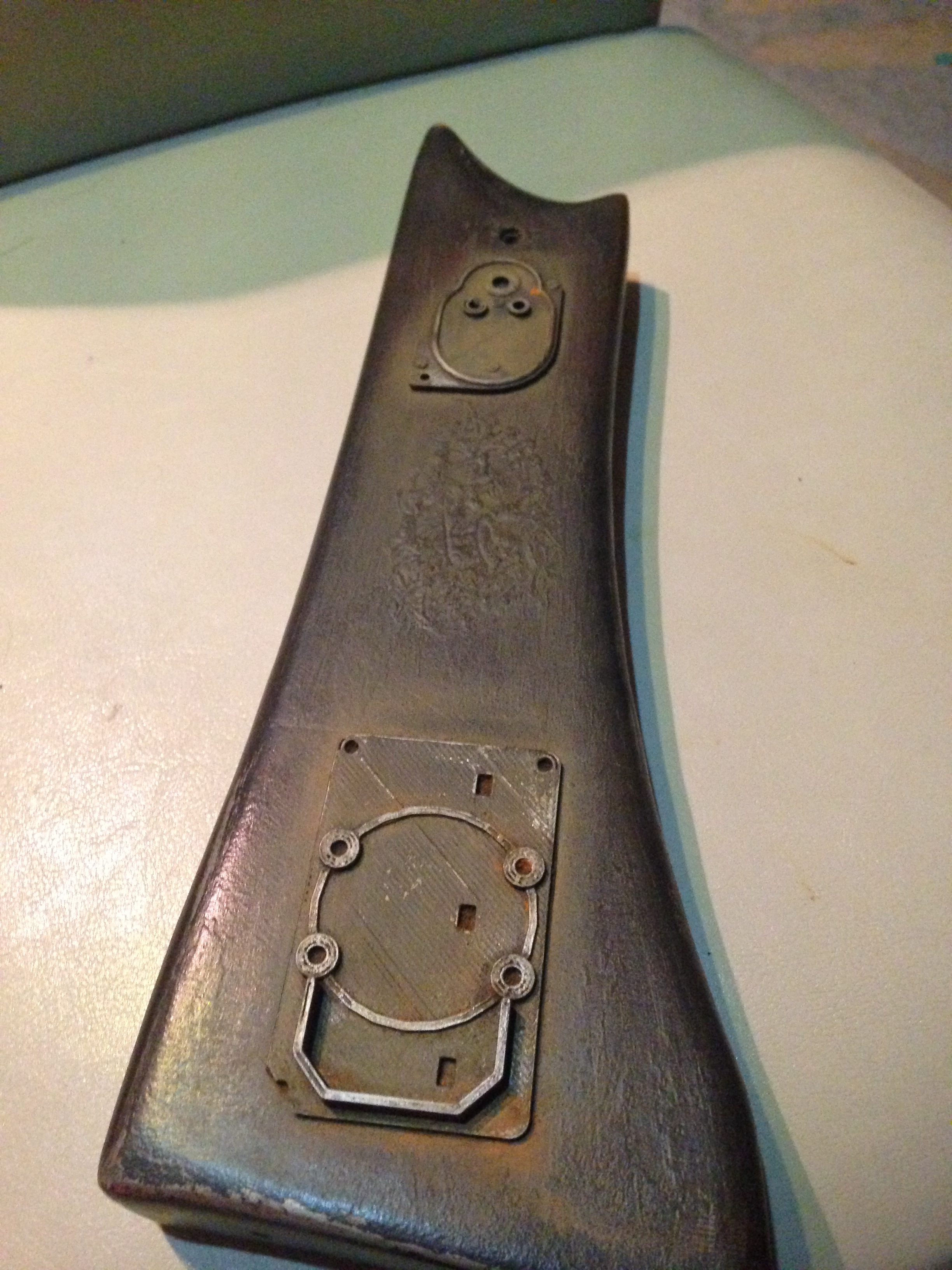

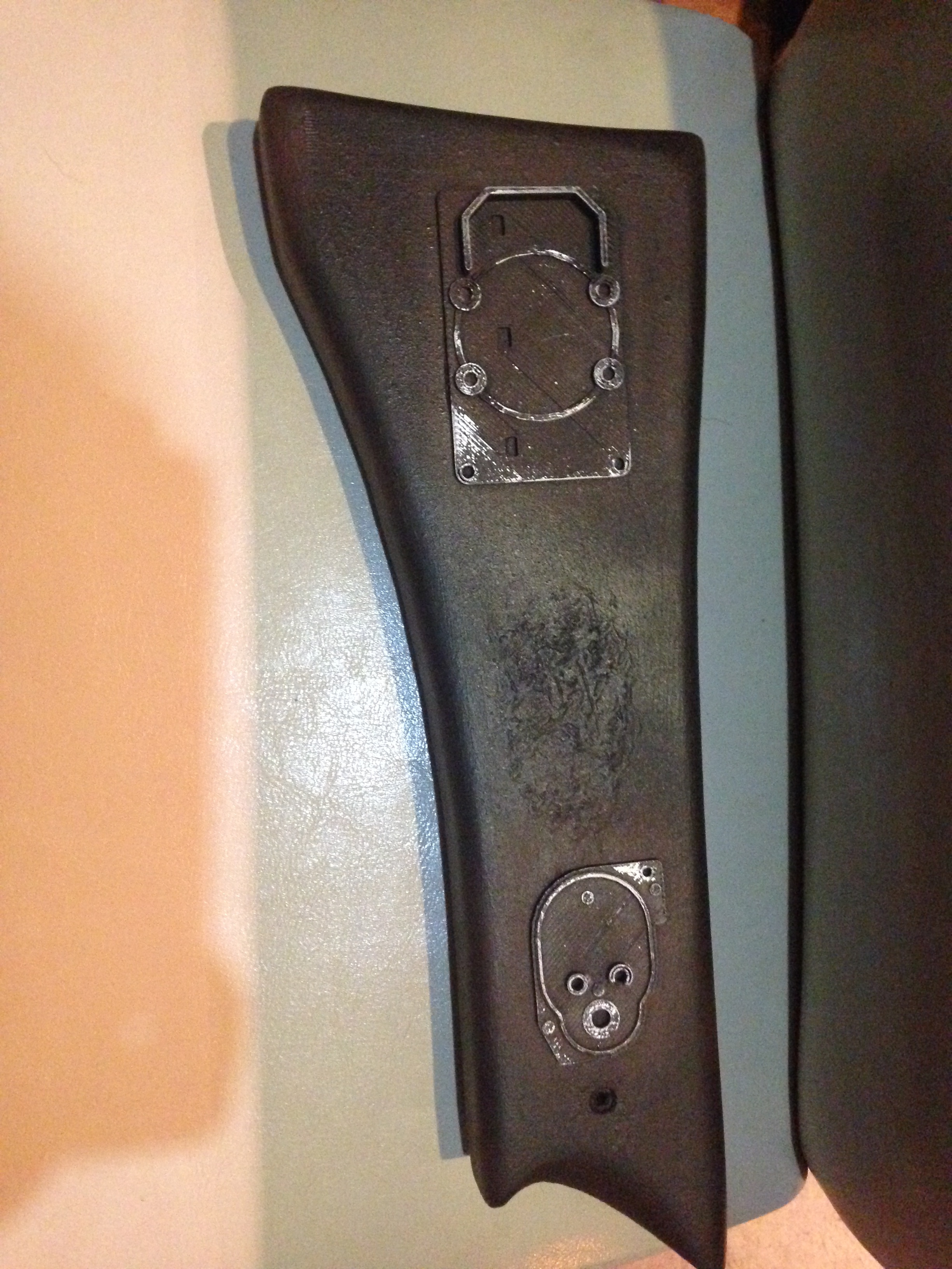

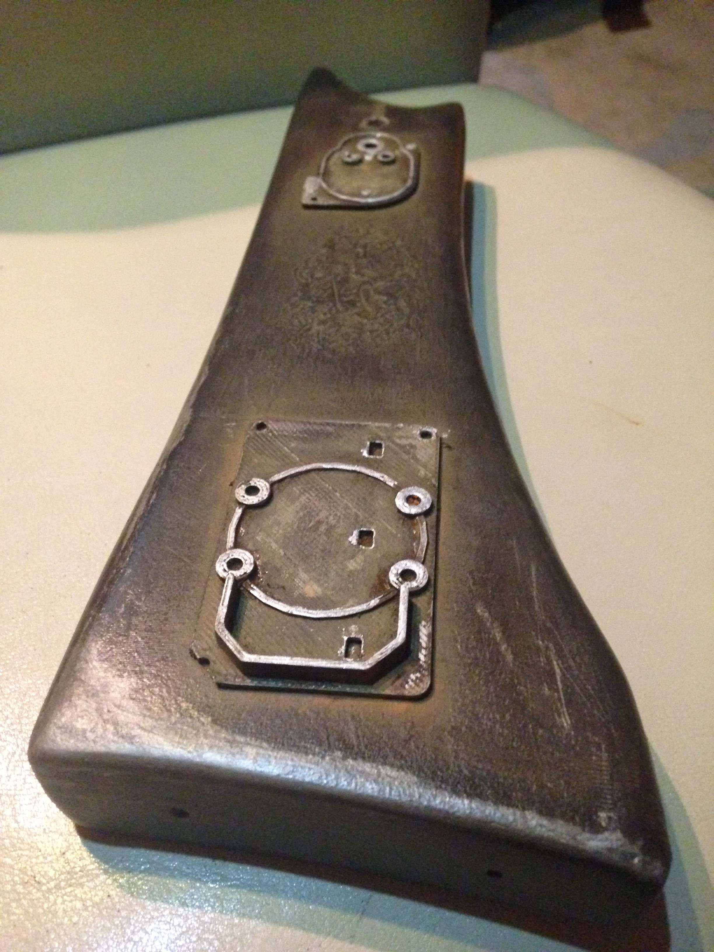

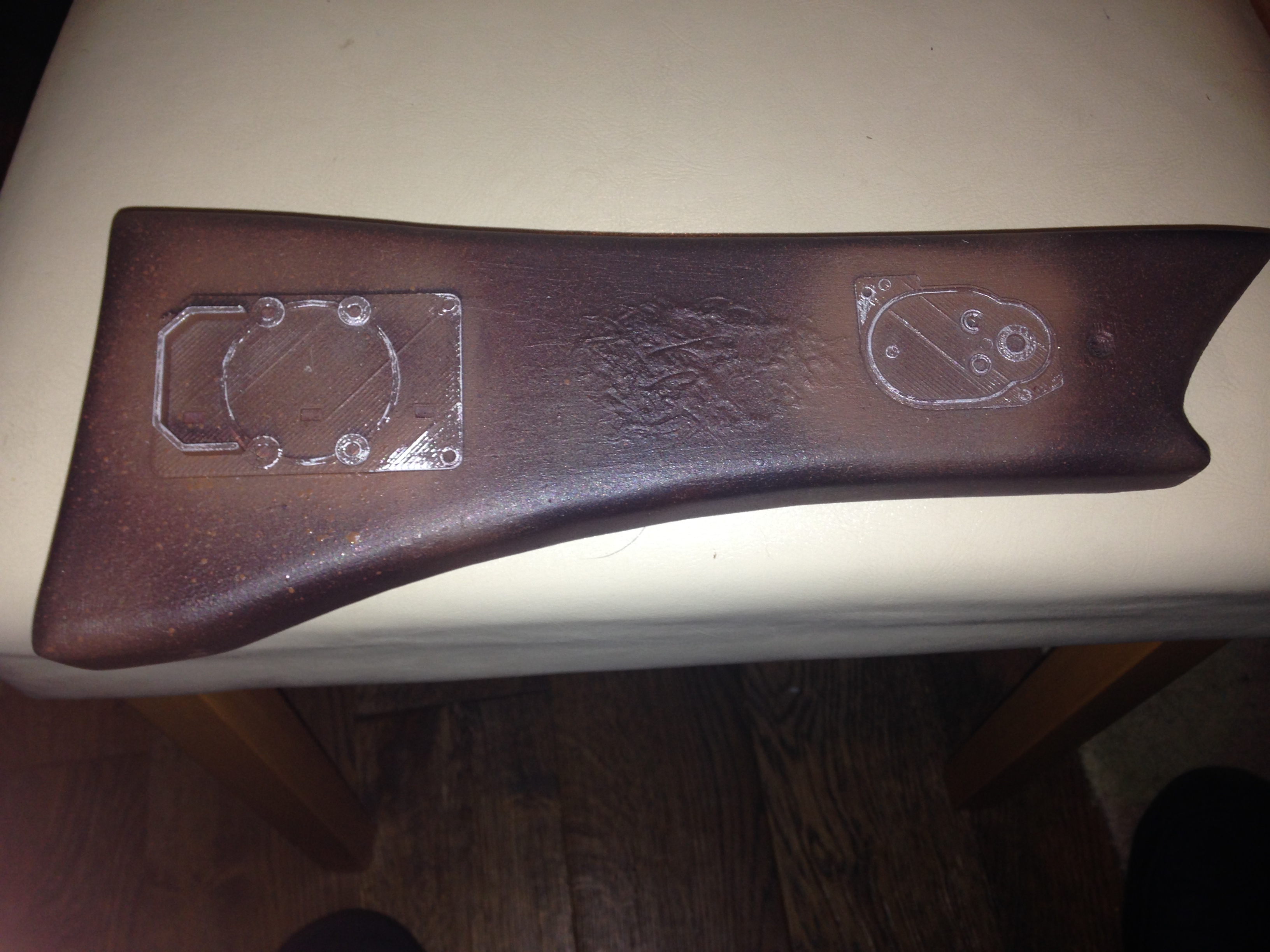

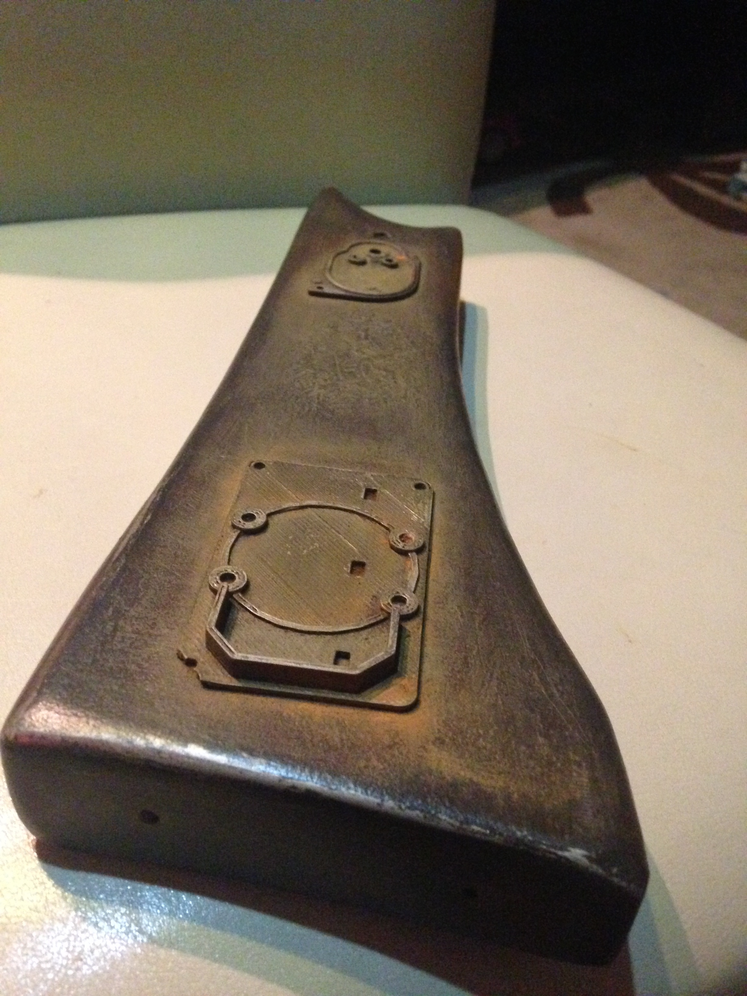

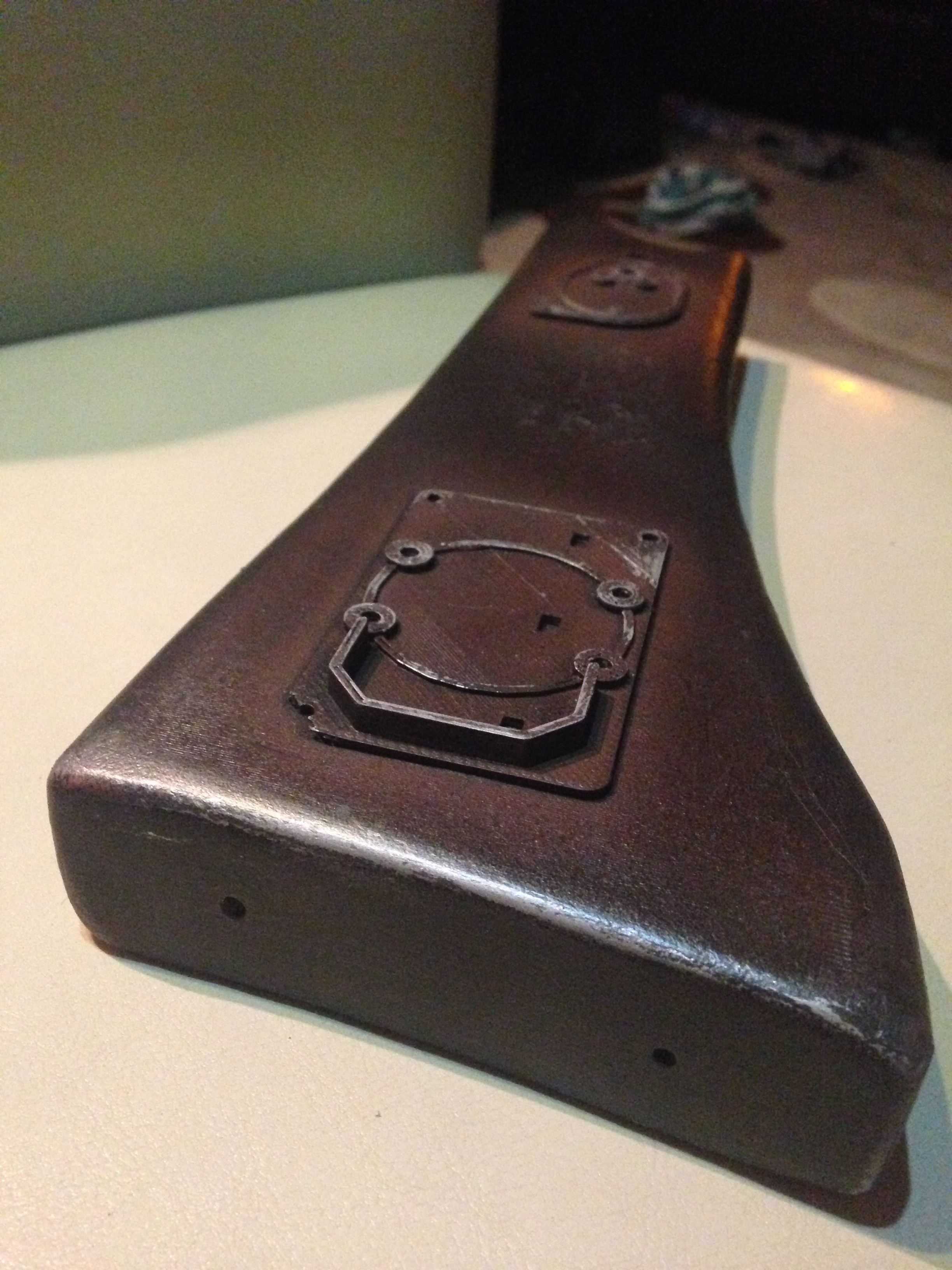

quick update on the stock I've layered it to look like a wood piece that has been painted several times I have also used glue for texture, now it just needs masking and dusting with black and rusty browns,

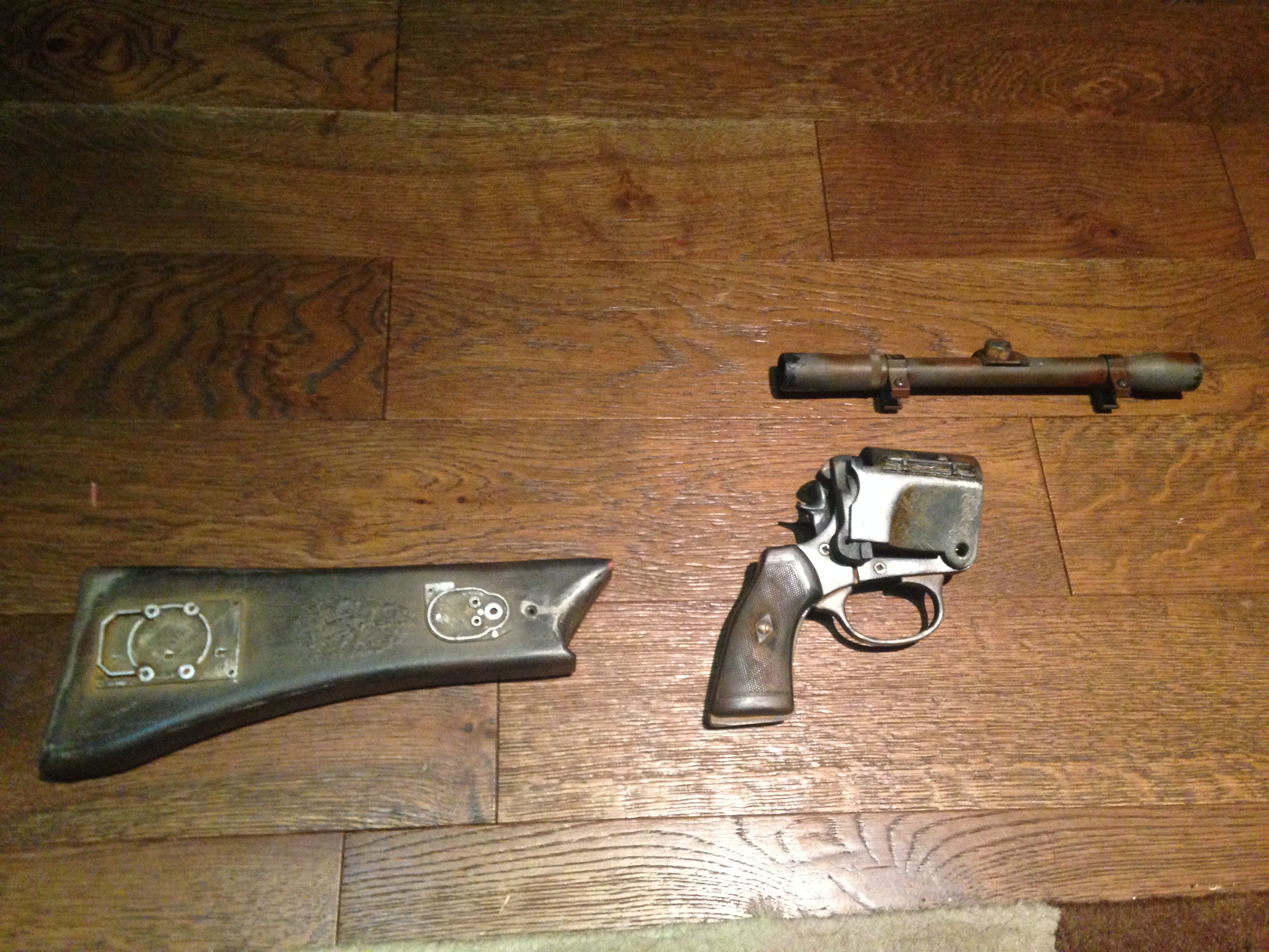

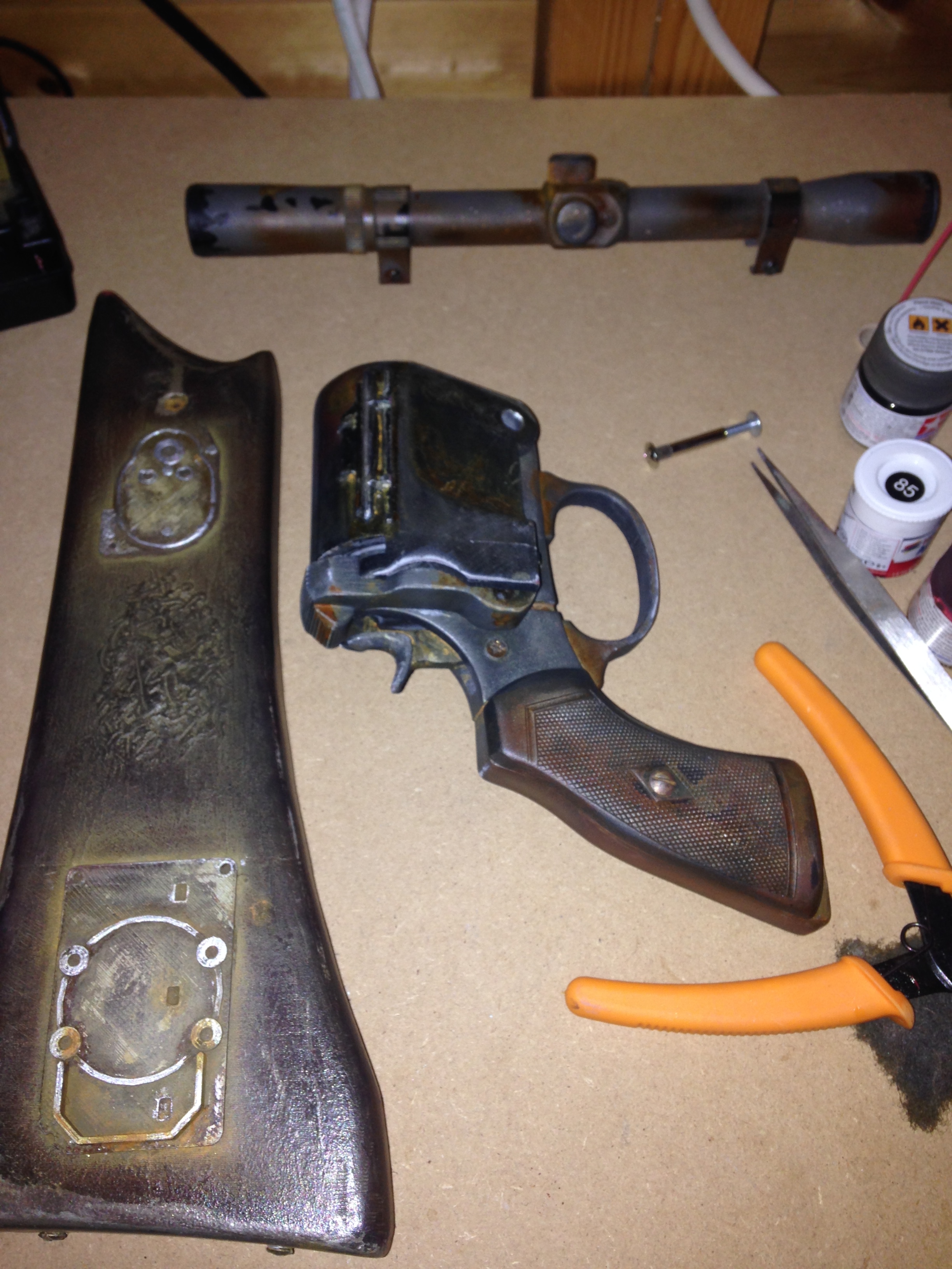

Well quick update all the pieces I was doing are finished and dull coated,
Now I am trying to make the bracket that holds the stock to the butt in aluminum as the 3d printed one doesn't feel strong and could be a week point,

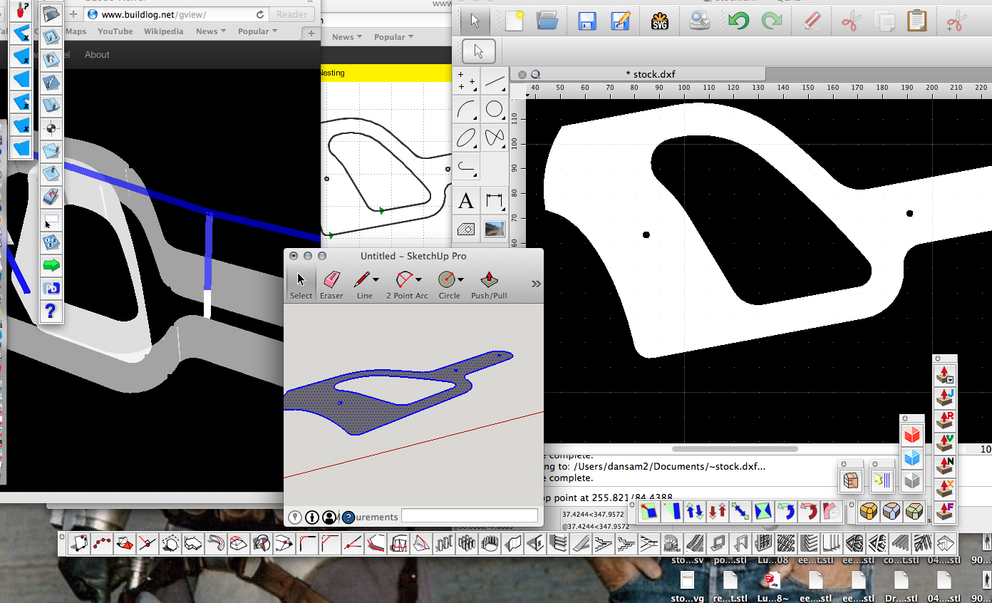

I am using 4 programs just to convert my CAD image to a Gcode, if anyone knows any better methods of converting a sketch up file to geode on a MAC I would be extremely grateful
So still waiting on a couple of things before I start machining some aluminum,got the inner barrel done and have now finished printing the main barrel which took 10hrs to print!!!!!
Just needs smoothing and painting:)
