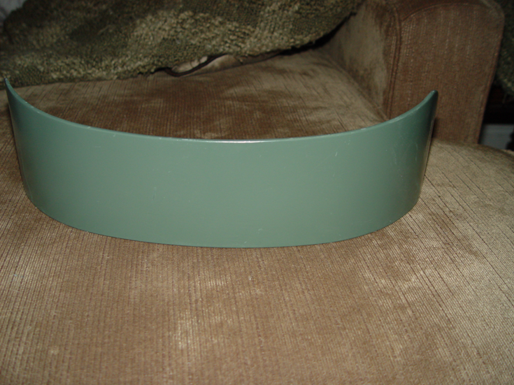

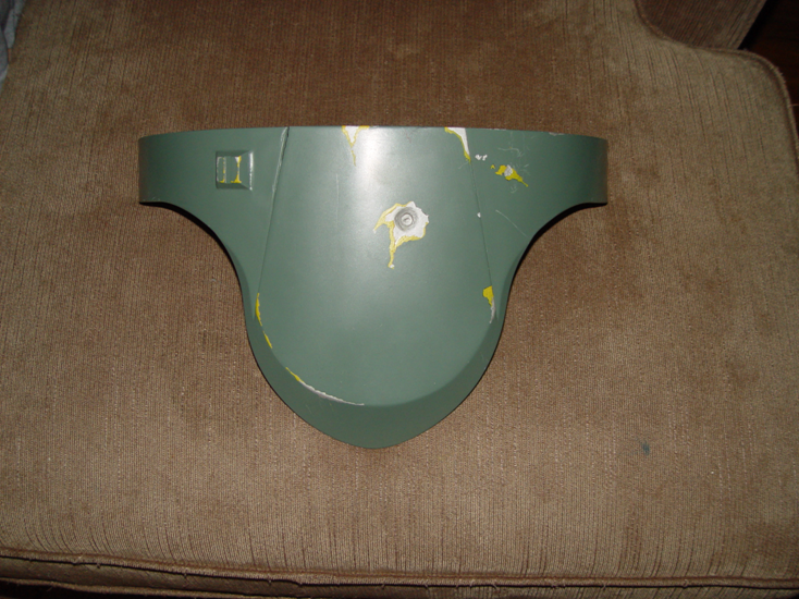

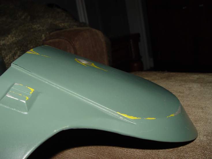

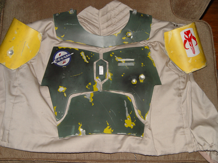

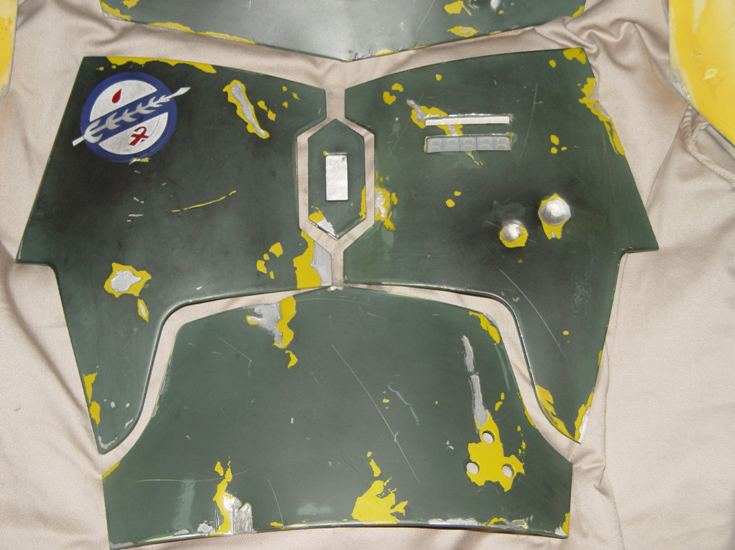

I bought a set of armor from FullMetalFett a while back and just about finished it. The cod and butt still need to be finished (painting) but the chest is about done. Since this is 1/8" aluminum, and came without dents, I couldn't get it exactly like the fiberglass stuff, but it is so cool when someone comes and knocks on your chest armor and you get that 'ding'. You always get a double take from the knocker!
This is my first set of armor, so in all truth, I should have started with something a little easier to work with, but the best part about metal armor is that all I have to do is add some stripper to the stuff and start over, (beleive me it comes in handy when you are learning!)
I don't know if FMF still makes the stuff, but he is an artist with metal. The curves and bends are perfect! Truly a great find! Oh, and in case you are wondering, because it is aluminum, it is lightweight and doesn't cause any problems like you may be thinking metal armor would cause.

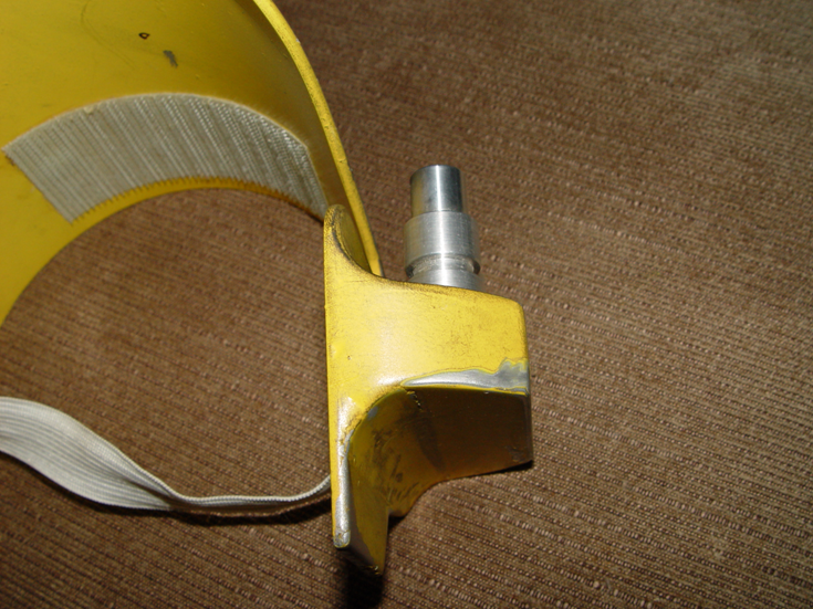

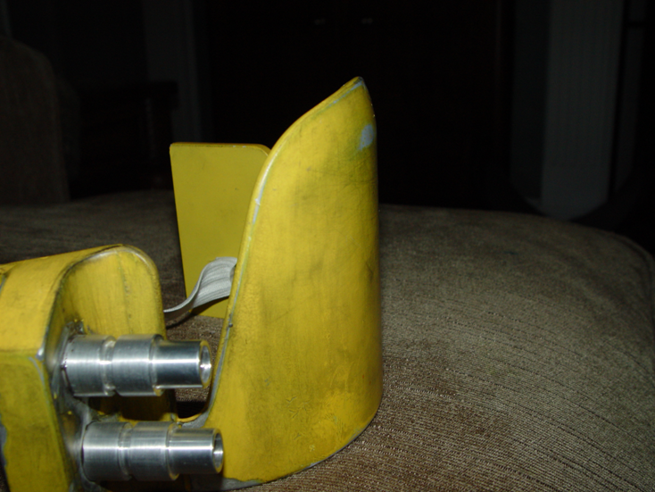

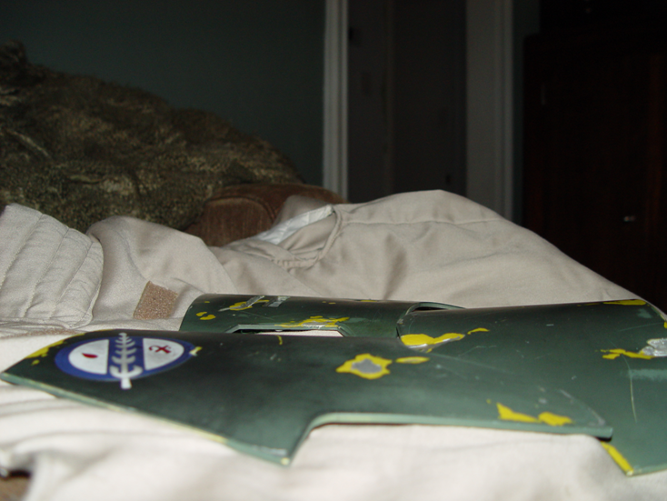

Here are some more pictures that show off some of FMF's talent. You can see the metal thickness as well as the curves. You can see that these are not flat metal pieces, but they have depth, just like fiberglass. Again- so cool FMF!
Superb, 1/8" Ali.... The curves n bends look great.
Have a question, is the cod one piece of Ali or made up from a few pieces like Wickedbeards? Same question regarding the knees?
Luvving the thickness of the Ali.... cool :)
The cod is two pieces that have been welded, not glued together. Really nice and sturdy. The knees are also two piece, though I think the plates on the sides of the knees were glued with epoxy or something since I don't see any signs of welds on them. Thanks for the compliment BTW.

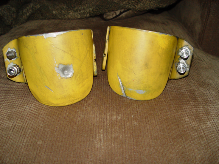

Hi mate, I'm in the process of painting my own metal armour (I'll upload photos soon). I've spray painted the entire armour yellow then green so that I can make the battle damage look real by sanding and scratching the plates. the effect looks quite good.

Again, great looking armor. How did you end up putting the dents in?
Thanks. I cut a profiled block of wood on my bandsaw, then laid out the armor and hammered a centerpunch if different sizes into the spot where I wanted the dents. The wood block kept the curviture in place and had enough give to let the dents through.
