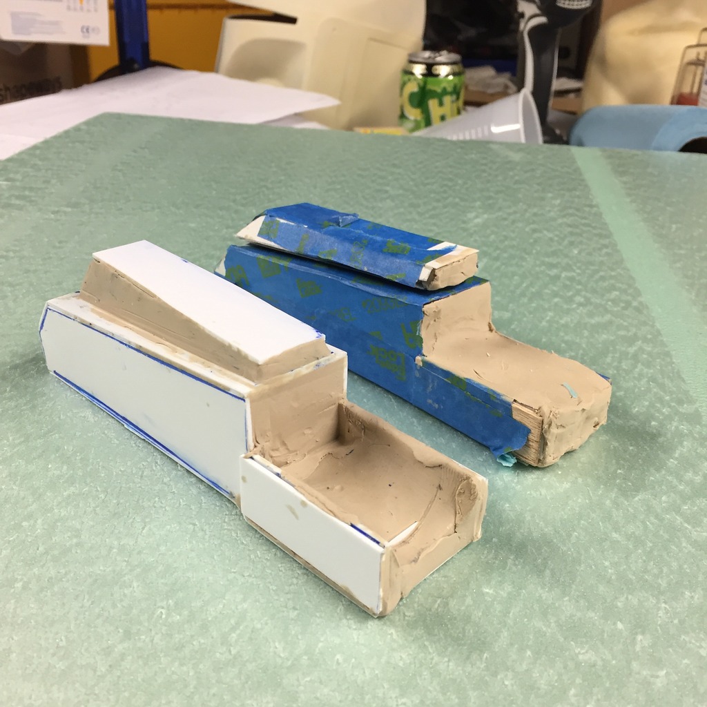

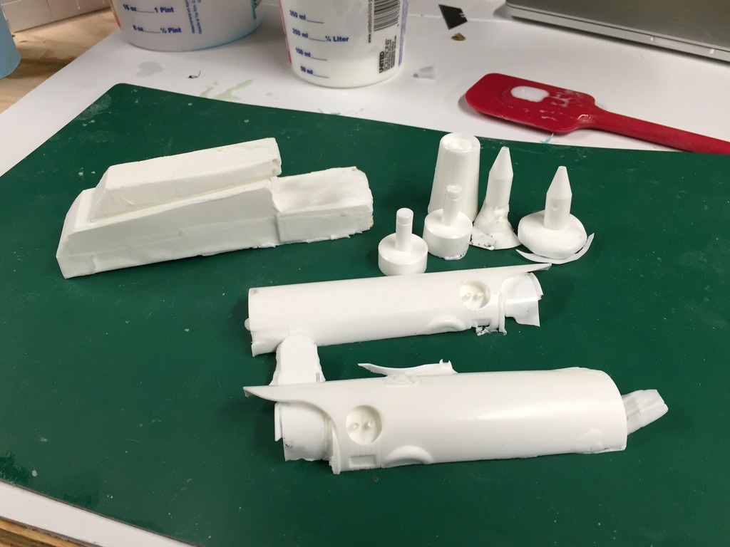

Been working on making the upper part of the sling gun all weekend. Here is the rough cast of it. I currently have it all filled and drying. Also a few other pieces cast for the supertrooper.

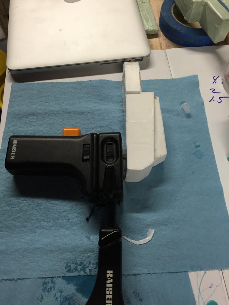

Although the rough mold/casting was ok I wasn't happy with it. I made a new model ( I think the rear of the upper area is a little bit high but I will sand that out) and will be making a new rough mold. I think the new model will get it pretty close.

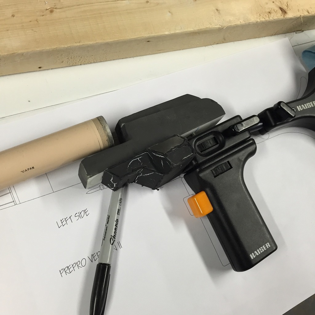

Little bit of finish work and this will be ready to make a production mold. It's a bit tall in the back but it can be sanded down. Pretty happy with the results.
Looking good, although that spider cracking on the paint might cause some issues...I'd look for a different paint if I were you, I've had that issue before, its a pain to deal with. I'm not completely sure what causes it, though I'm sure some of the more knowledgable people here do...
The spider cracking was cause I sprayed it on straight and with residue from clay on it I think. That piece is actually an model built from the templates using cut outs of ABS with clay in the center to keep it from collapsing when I make a mold of it. One the mold is done, I'm going to make a casting of the piece in resin and work off of that to make a final mold to start making real usable parts. Even with the resin they say to let it air out for a week or so before painting.
