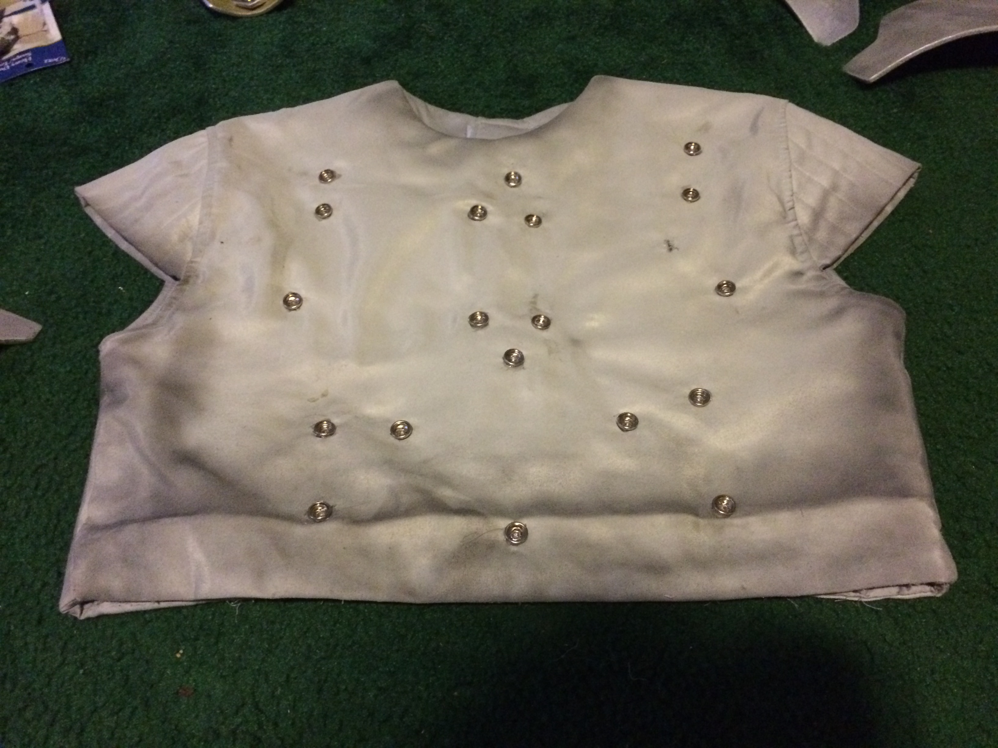

I used JB Weld to secure the bolts to the armor, then attached the armor to the vest using magnets, to hold the end of the bolt pinched to the flak vest fabric so I could adjust the position of the armor pieces on the vest until I was satisfied. I then used duct tape to cover and secure the magnets on the vest so they wouldn't drift, and then marked the spots where the magnets were taped to punch the grommets through the vest.

An easy way for placement. Get the bolts attached to the armor somehow on the corners etc. Then put a little permanent marker, or crayon, on the end of the bolt. Find where you'd want it on the vest, and push. The crayon or marker on the end of the bolt will leave a mark where to put the grommet.
The bigger the grommet you are willing to use, the less exact you need to be. Just make sure you glue the bolts onto the armor a little ways in from the edge to make sure the grommet isn't seen above/below the armor when in place.
