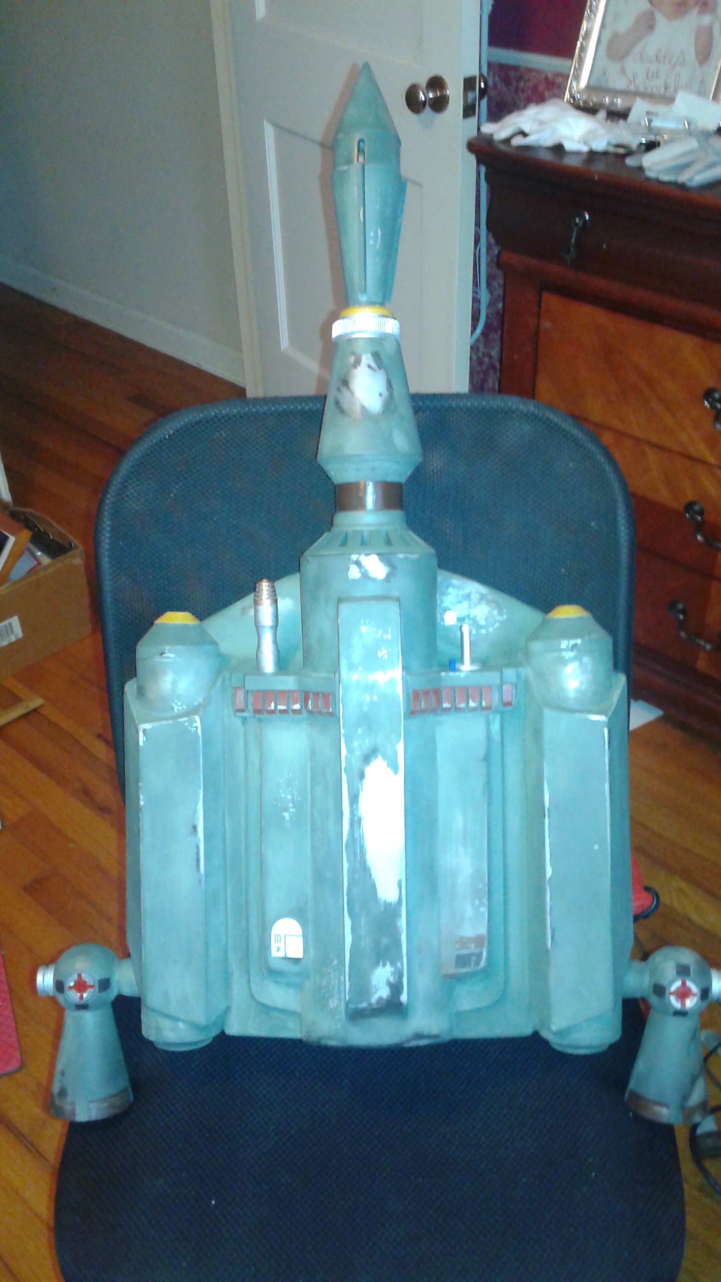

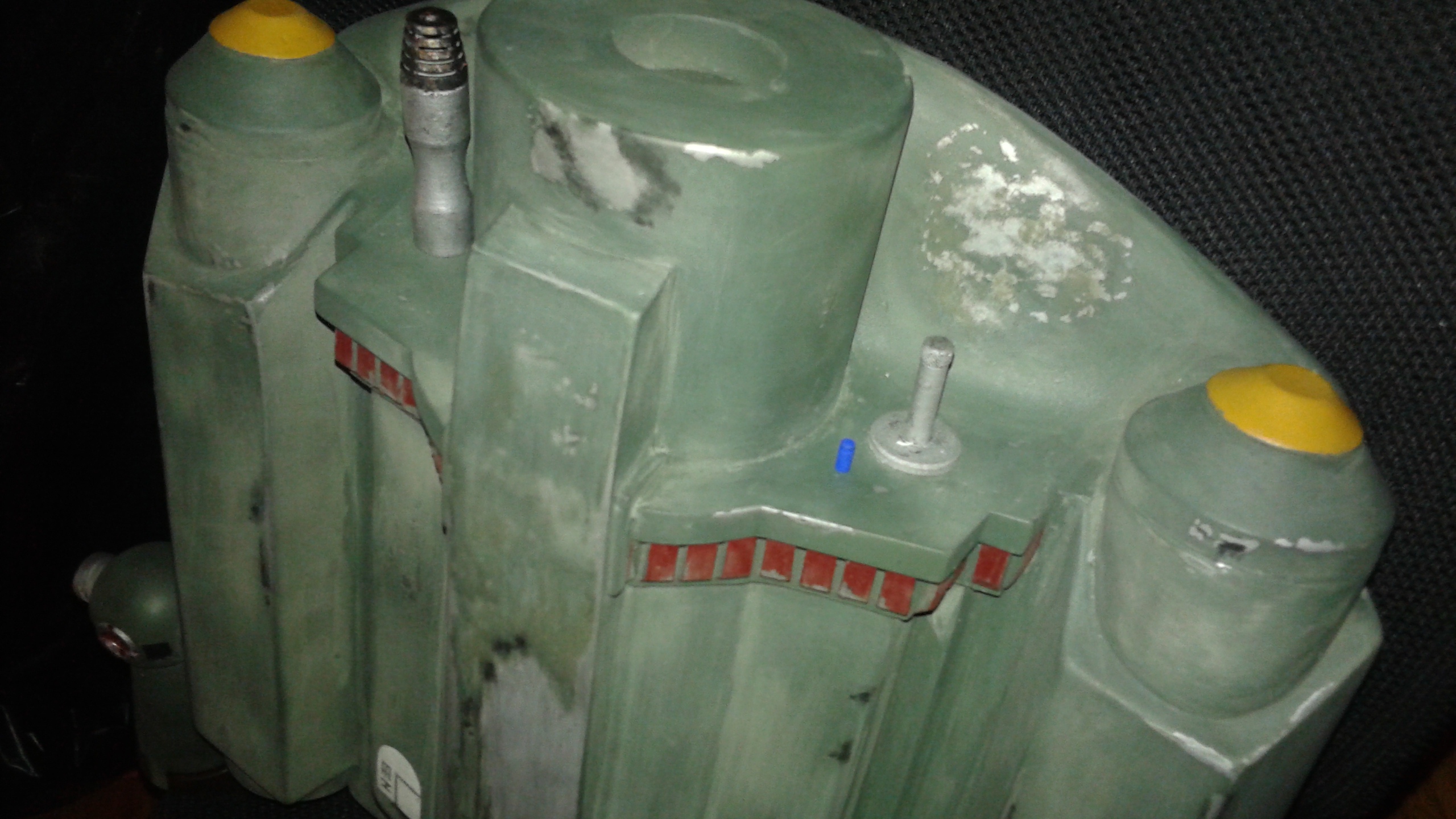

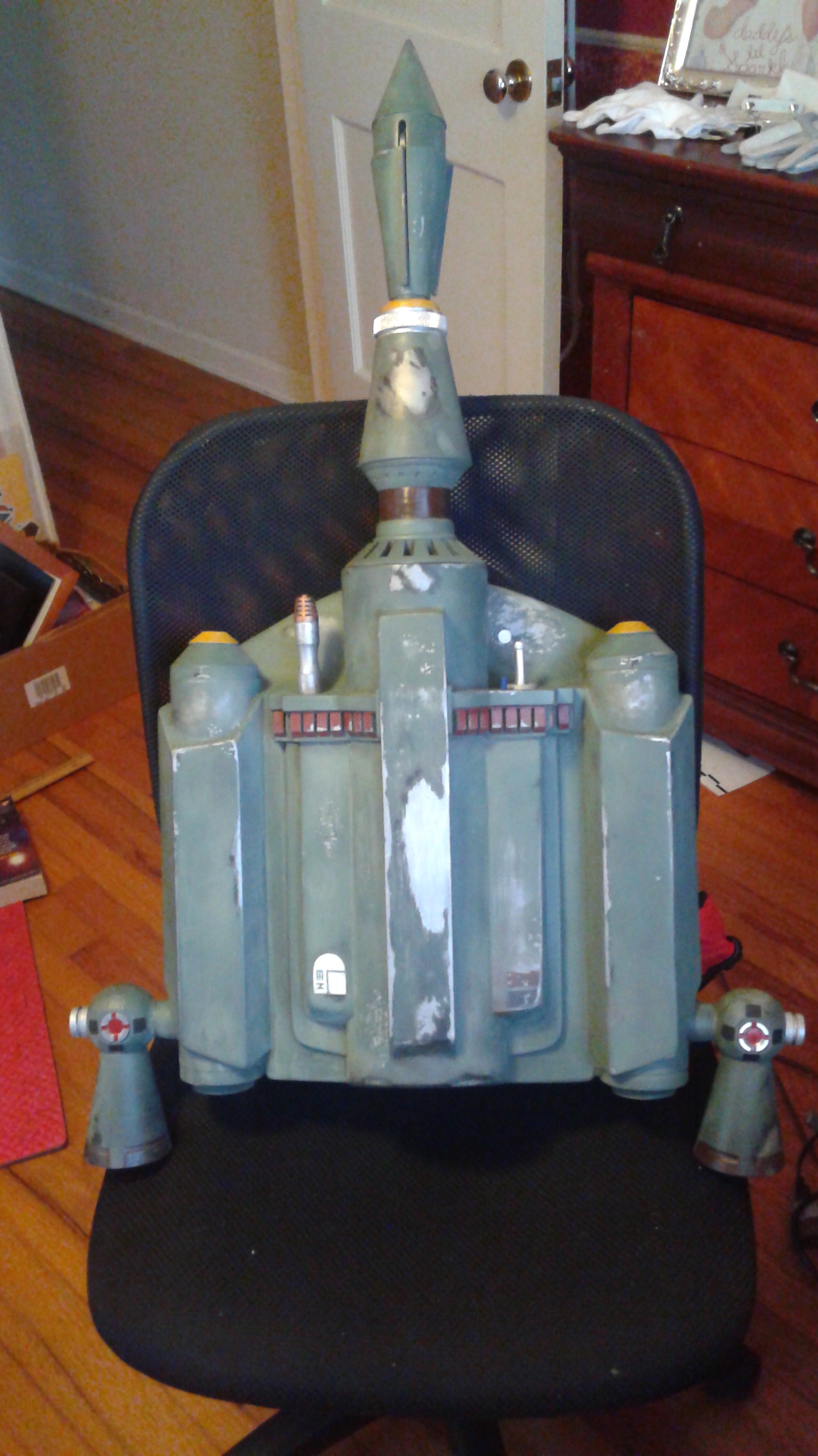

I have gotten to a point on construction and paint, where I can call the jet pack complete...
A beautiful cast by Christian....
Here are a few "highlights"

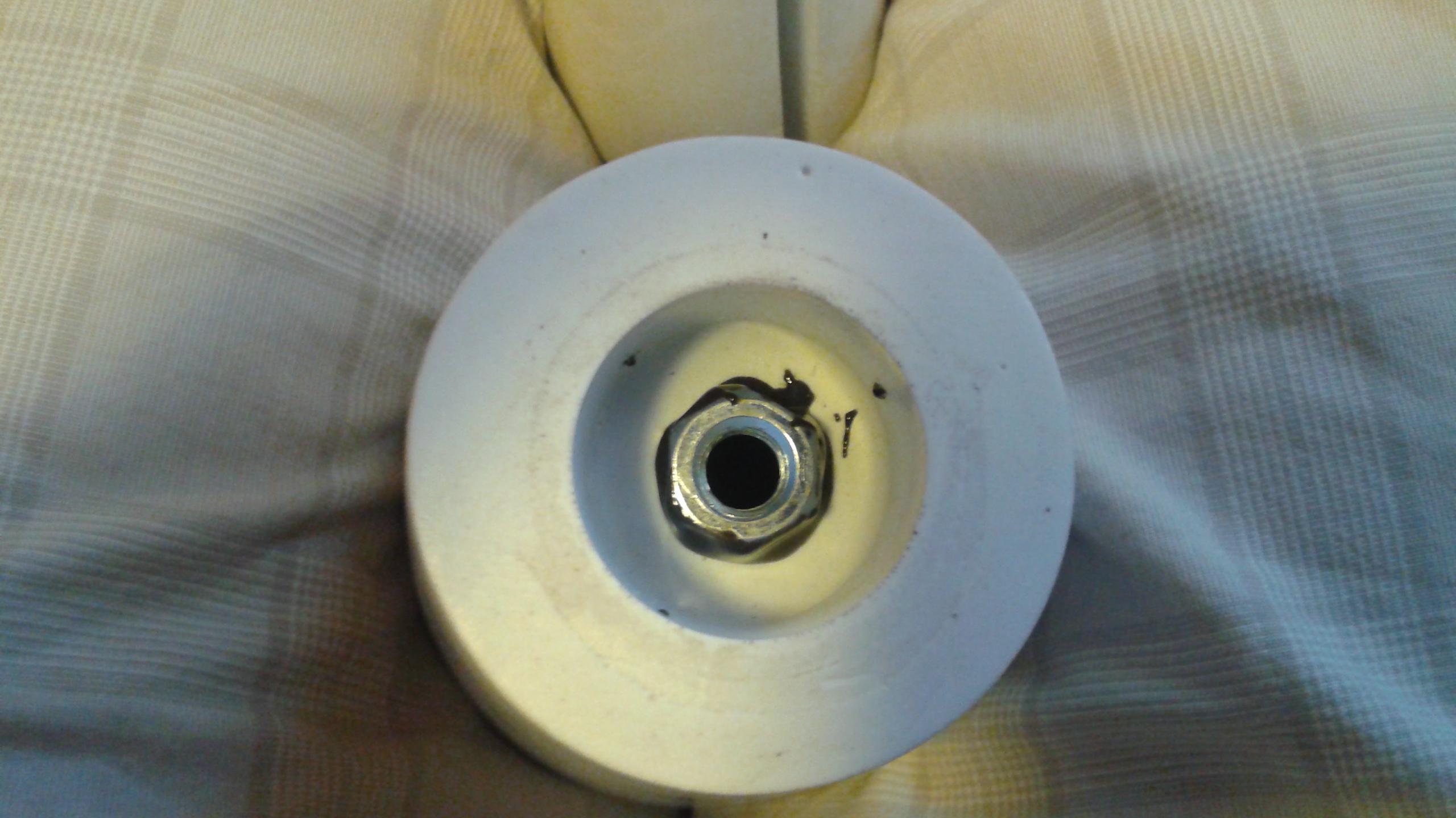

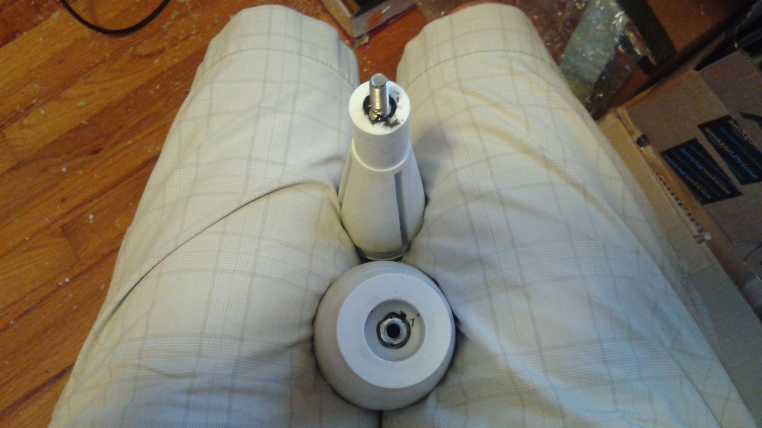

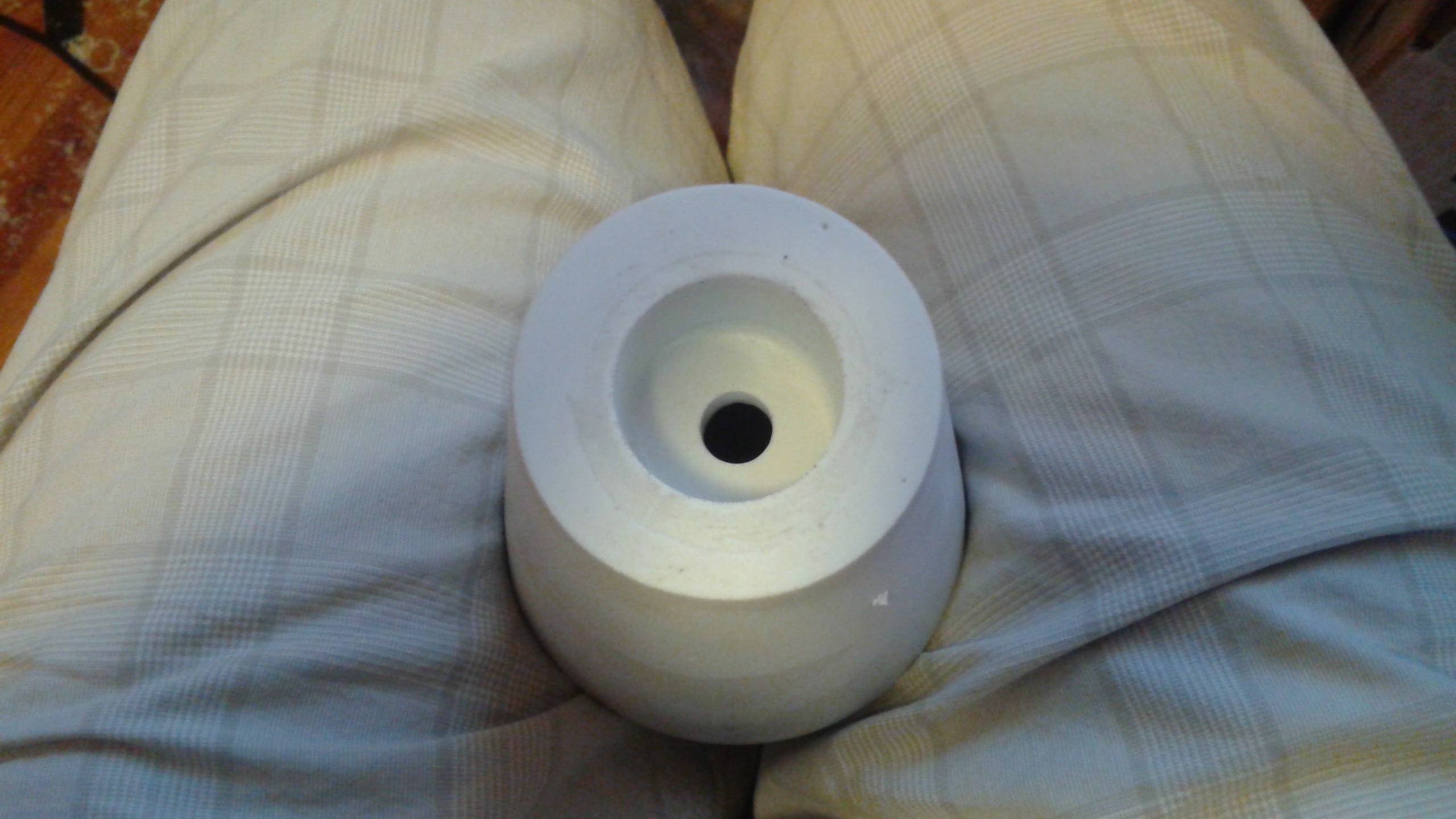

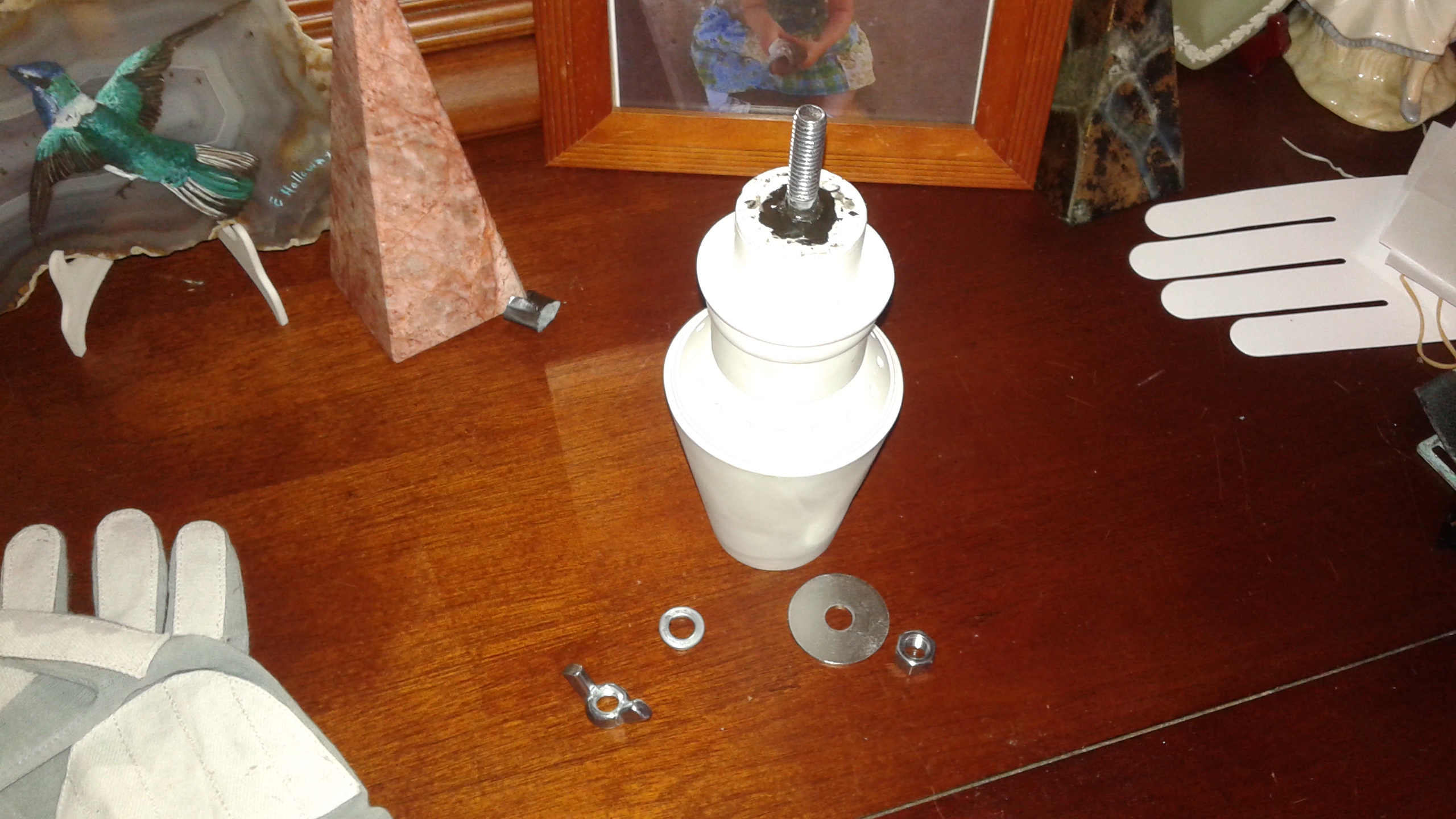

Went ahead and used bolts and nuts to attach rocket.
Tried to keep it as simple as possible....

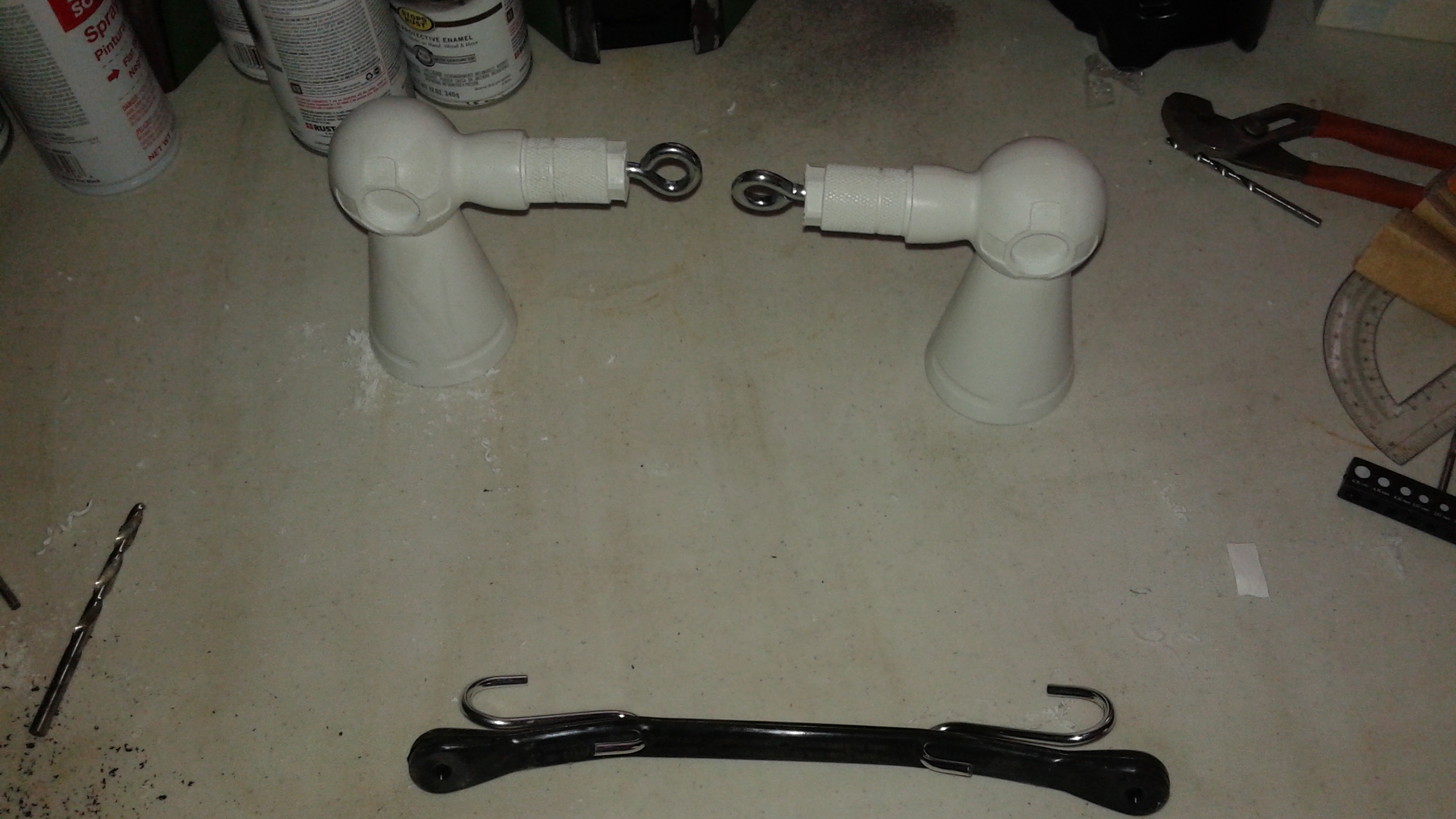

Thrusters, done with bungee. Really liking this method.

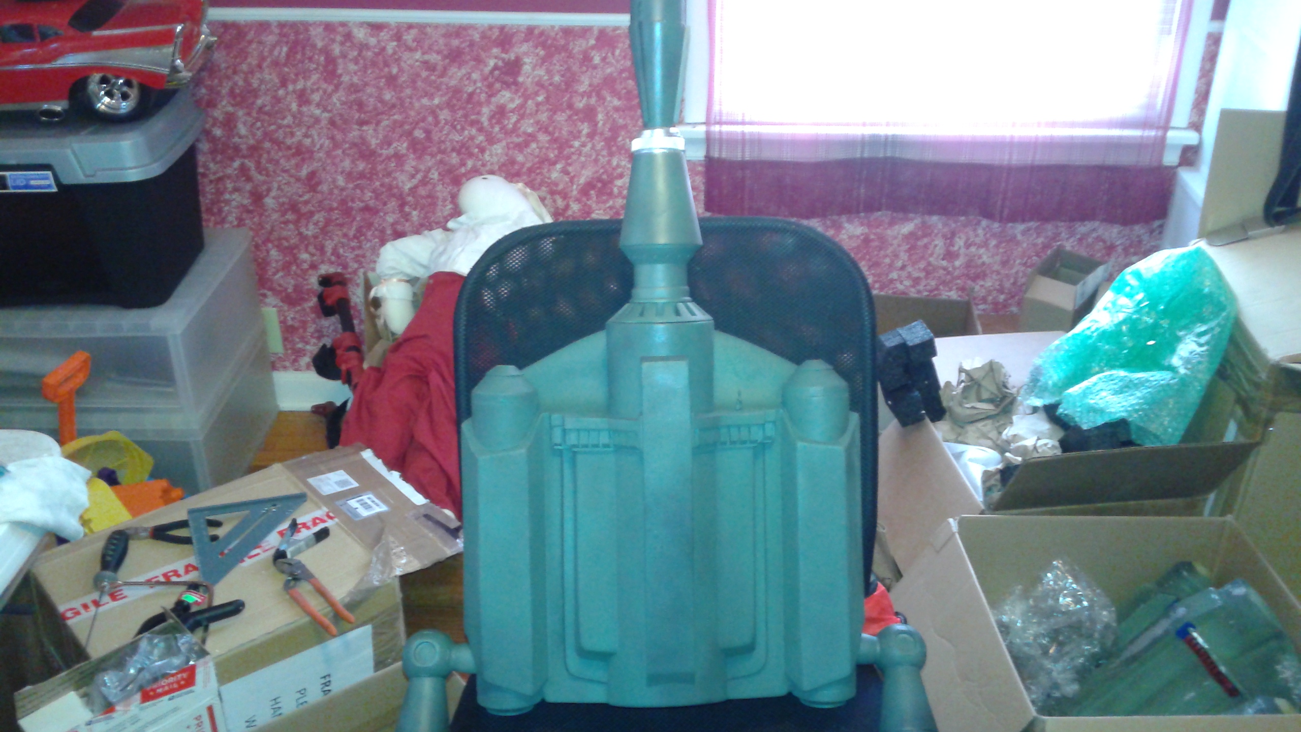

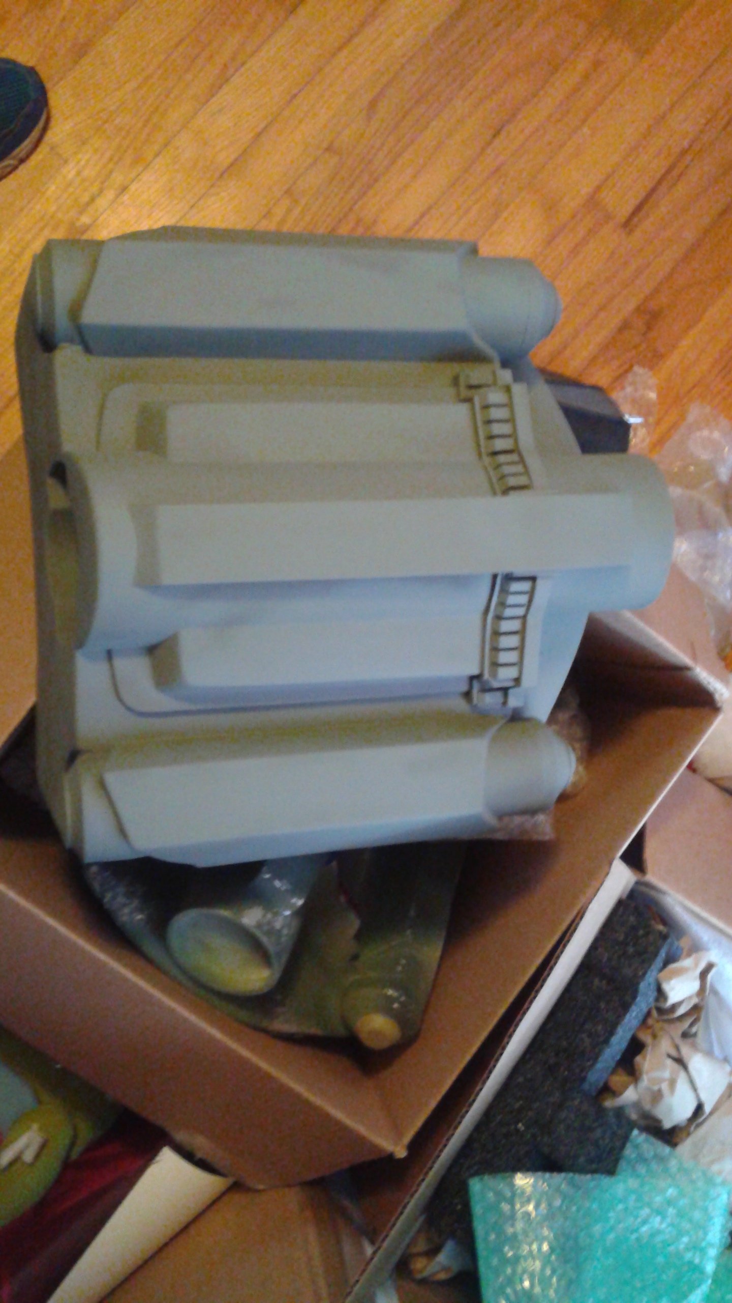

Primer, and base layer

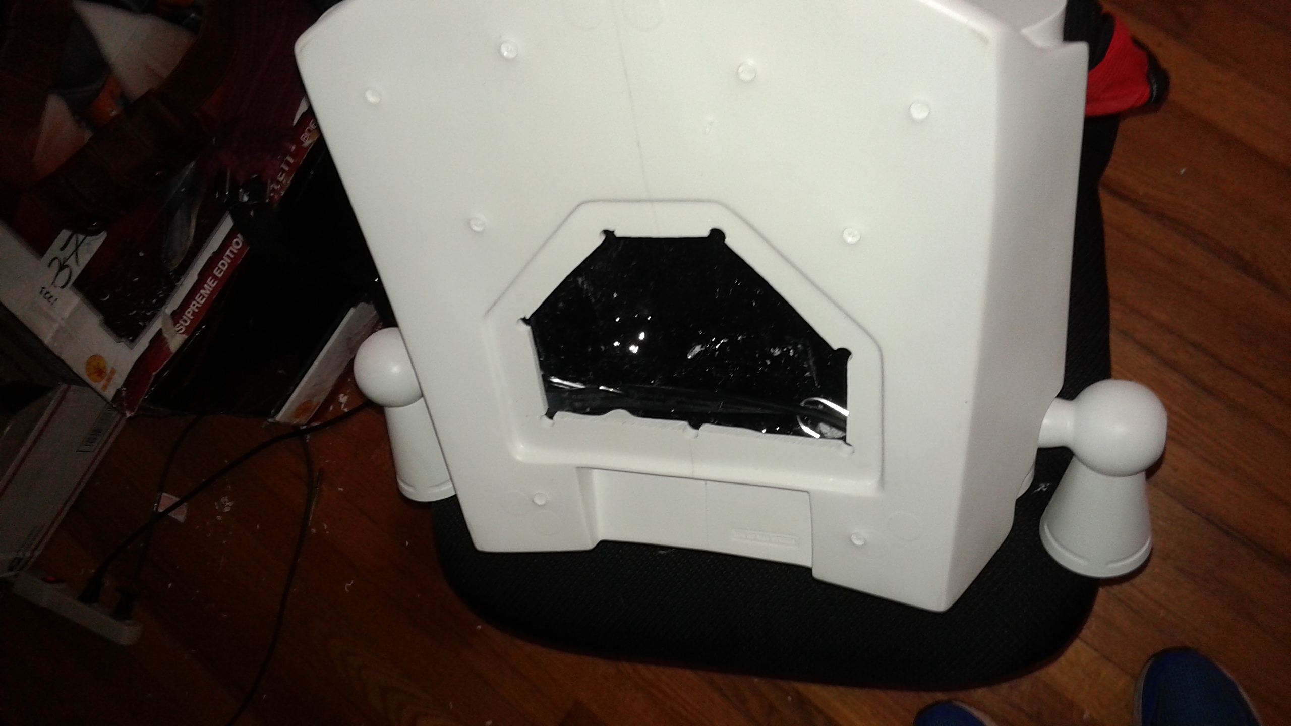

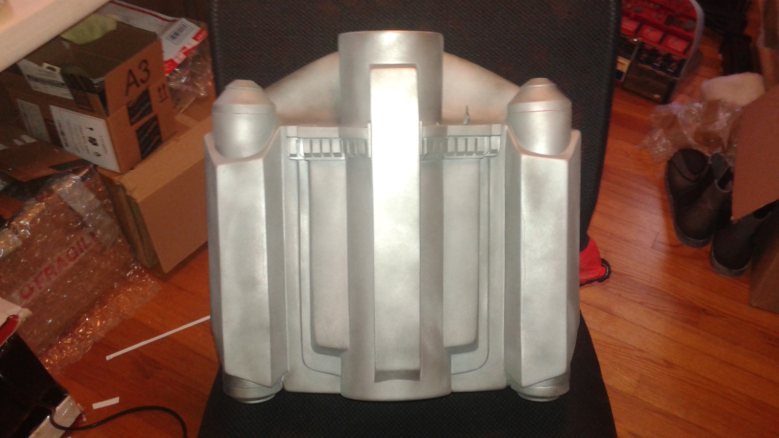

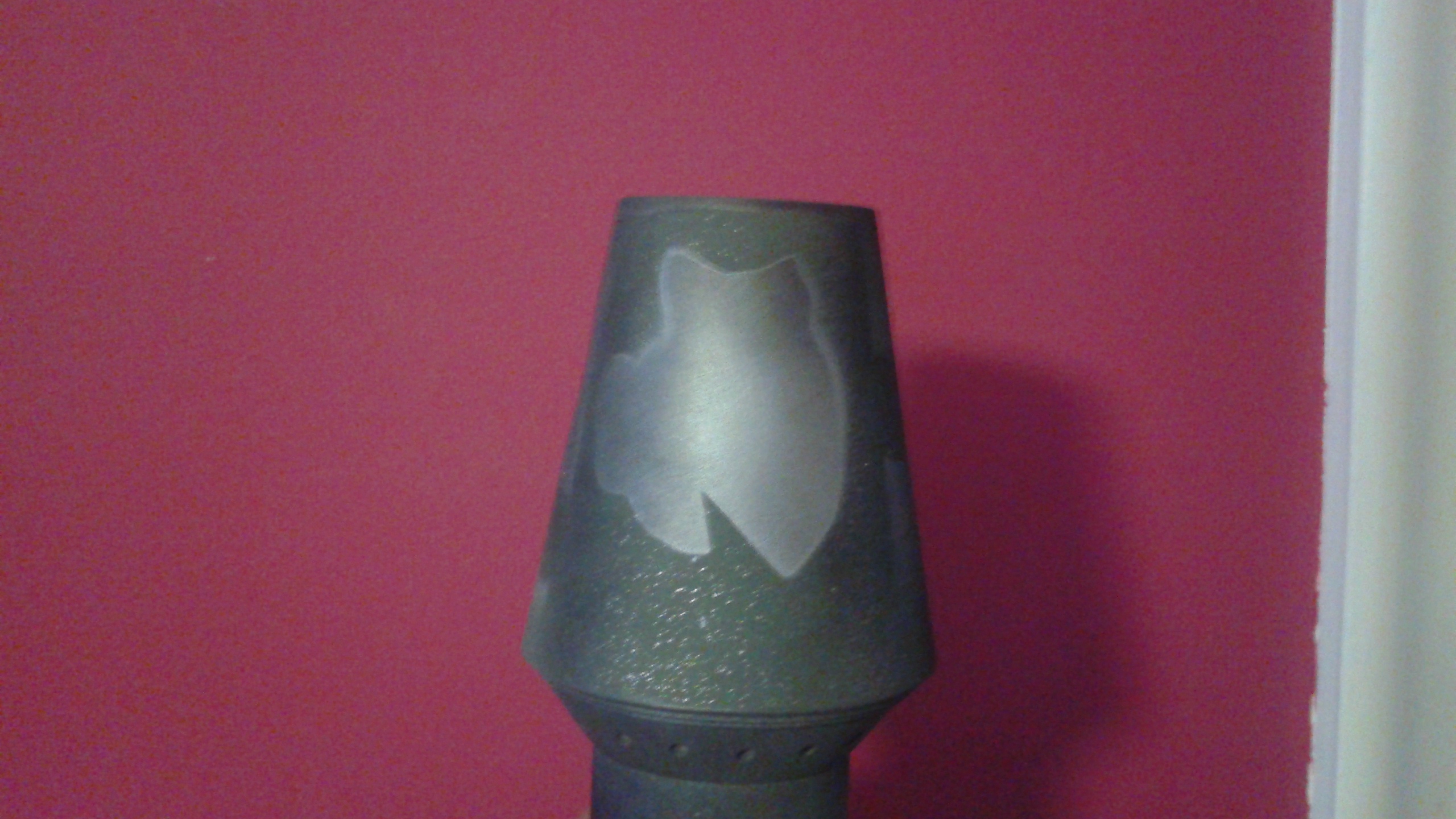

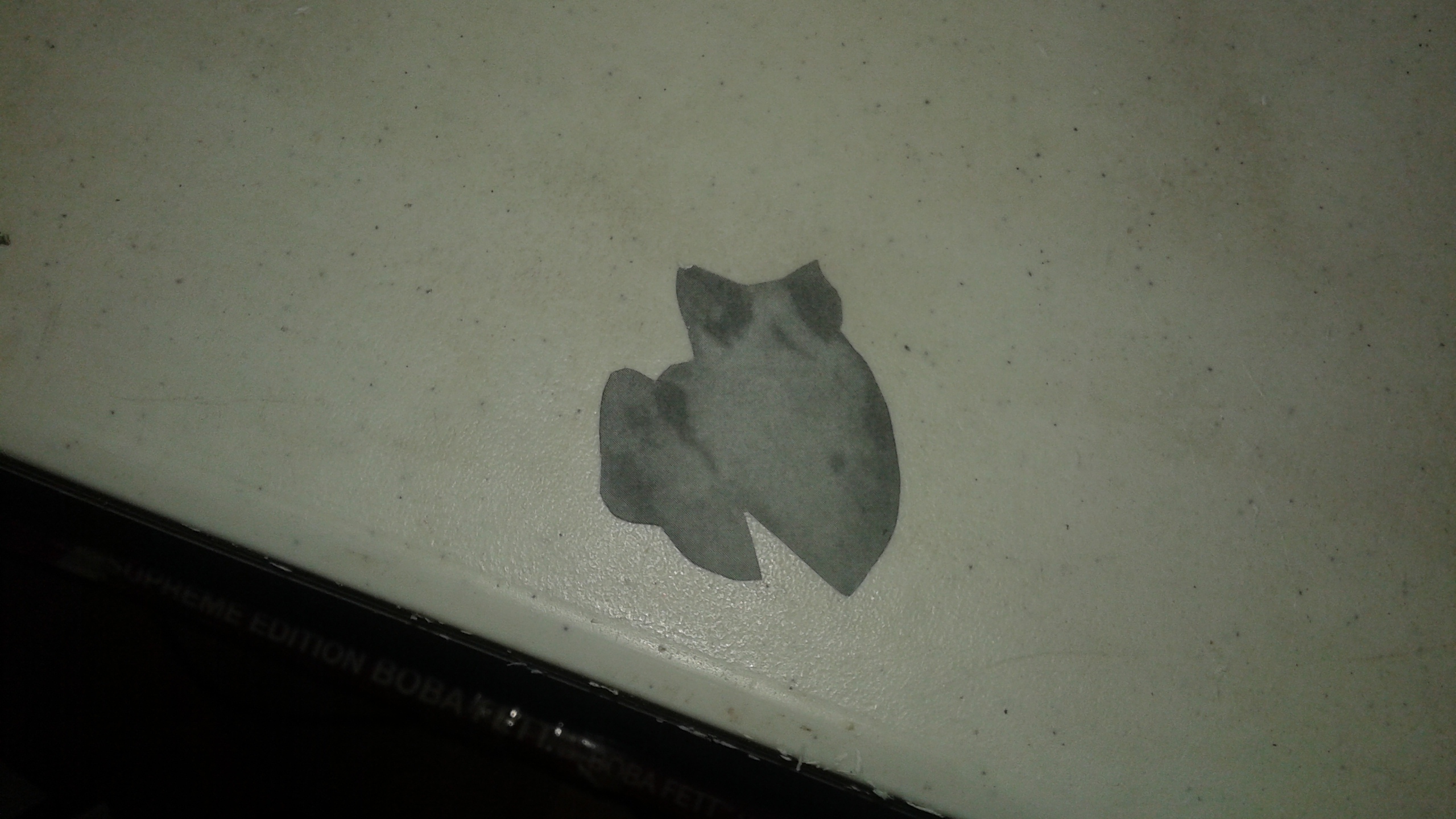

Cheating....

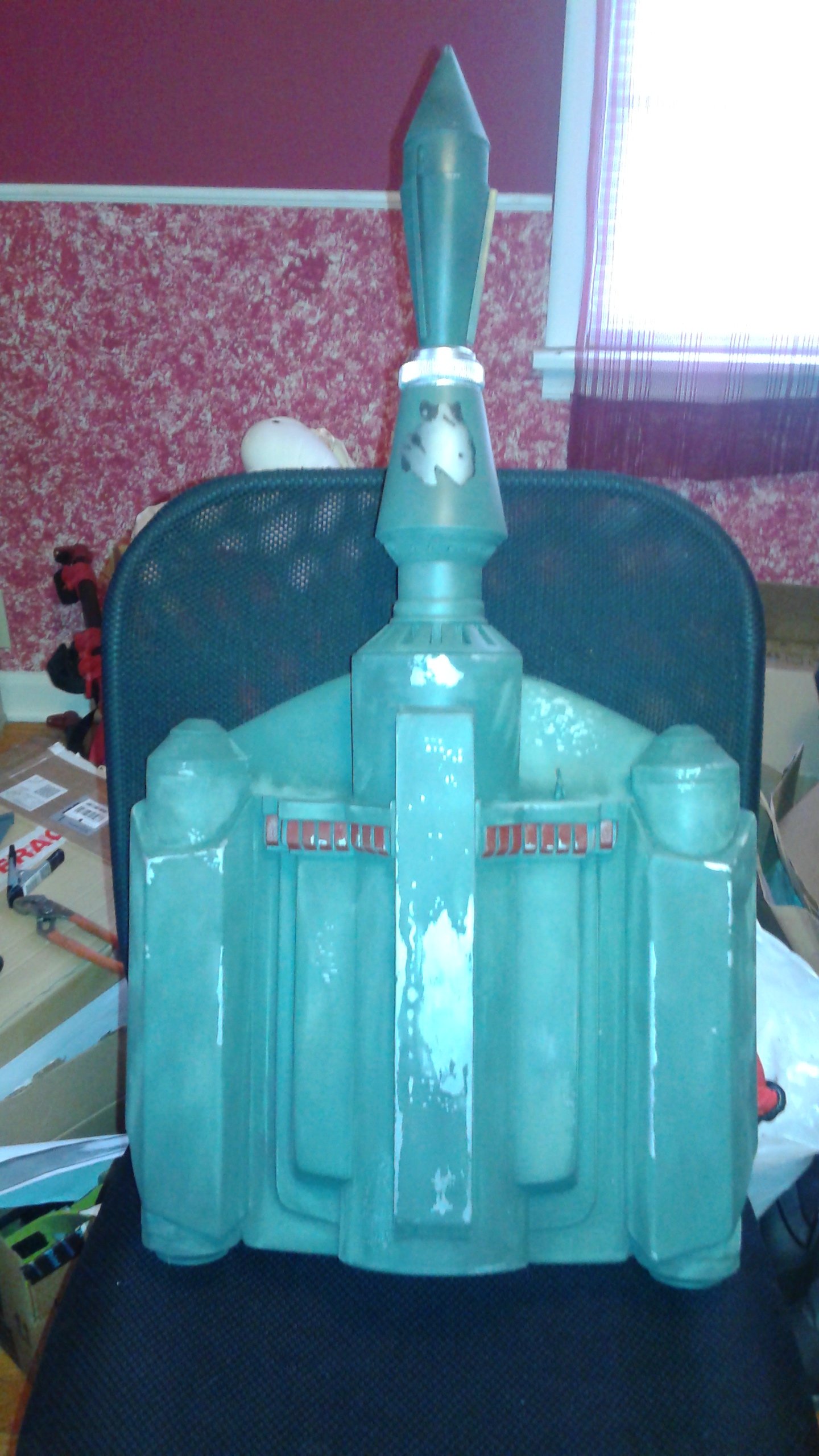

Color! and a messy room :)
Colors are spruce green, olive green, and flat black misted together while wet.
These things are not easy...you guys who take these on as commissions, kudos to you.
Almost forgot the white dot.... :)

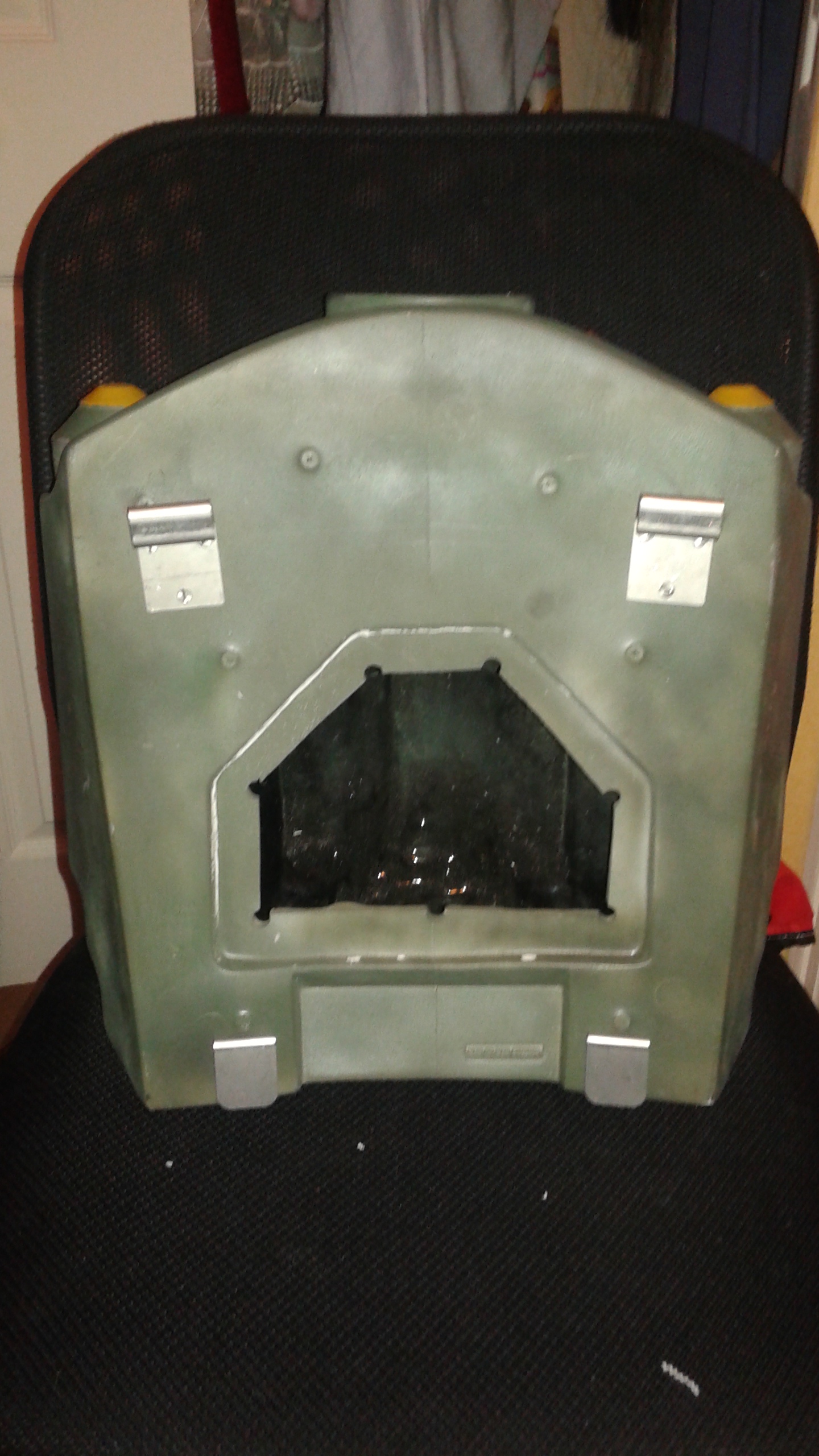

Hooks and Clips...Need to revisit the back side at some point to clean it up a bit...

Yea the ESB pack is more difficult than ya think lol. Some folks just paint it green with red details and the big silver area in the middle and call it a day. there is SO much more to it than that...and you did a killer job on this man, nice work!

Highly recommend the bungee method. I have zero doubt I would have broken something with a "hard" attachment by now.
Glad to be of assistance! Question: how did you get the hooks in the thrusters? Did they just screw in? Did you drill a hole then screw it in? Did you end up using glue, jb weld, or some kind of adhesive? I want to try this method because it seems very versatile! Until I completely deck my jetpack out and make it 100% functional, propulsion and all, I think this is the route I would like to go ;)
Awesome! :)

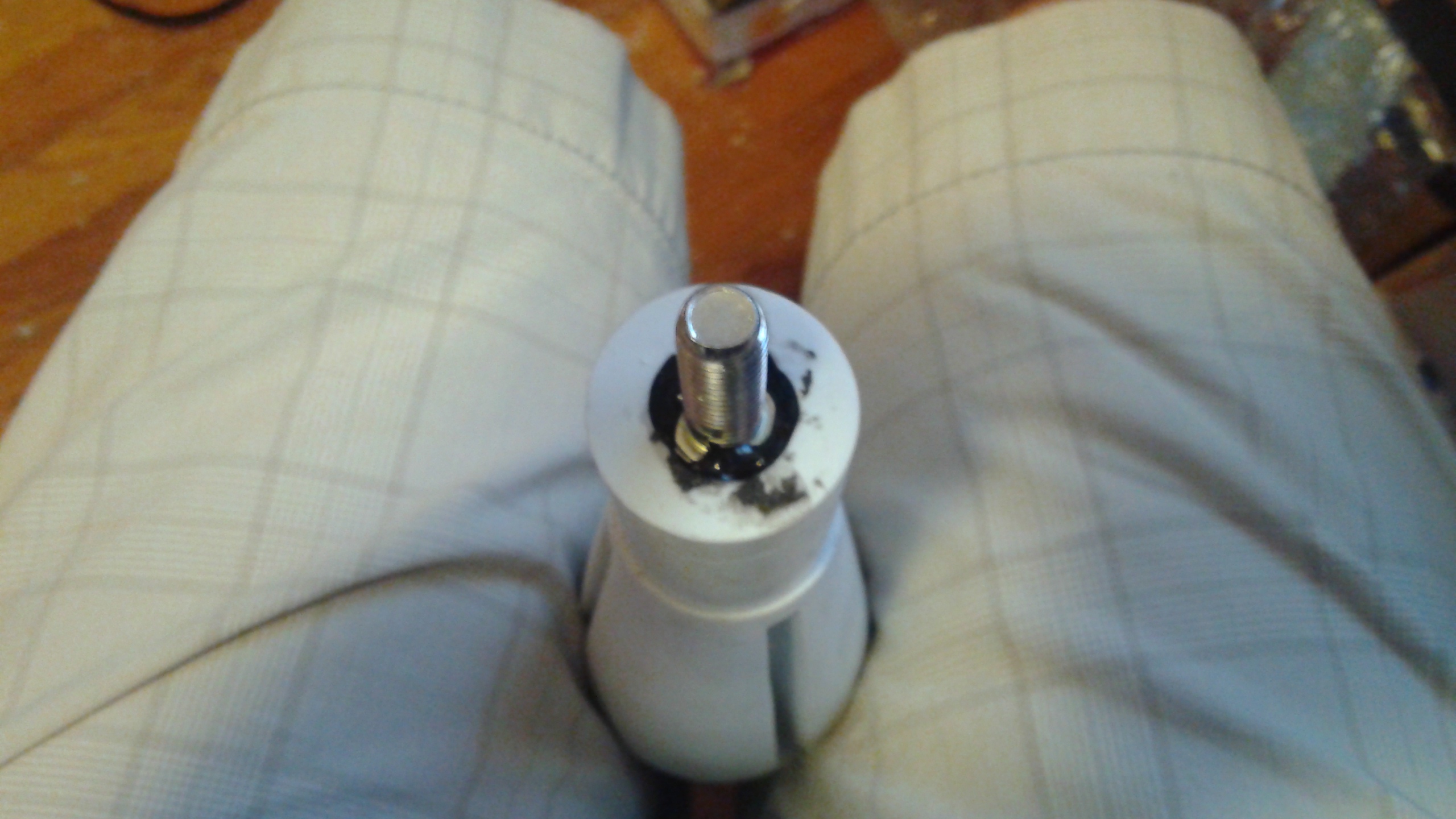

Once I found "center", I used a center punch (not sure how I went all years without one) to get started. I went slightly smaller than the od' of the hook with my bit, and screwed it in. No jb weld or anything...It seems very solid given that I was careful with sizing...I didn't read your thread well enough, and made my hole up top, in the rocket, a bit larger than I needed too. I did not get the benefit of being able to "screw" the rocket base into the main pack as you did...
An added benefit with the bungee, is that as the thrusters "turn", they slightly increase tension, and do not necessarily want to return to vertical.
