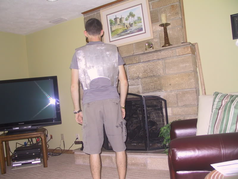

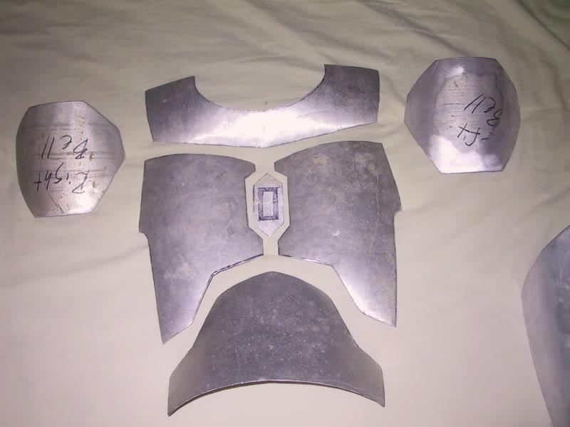

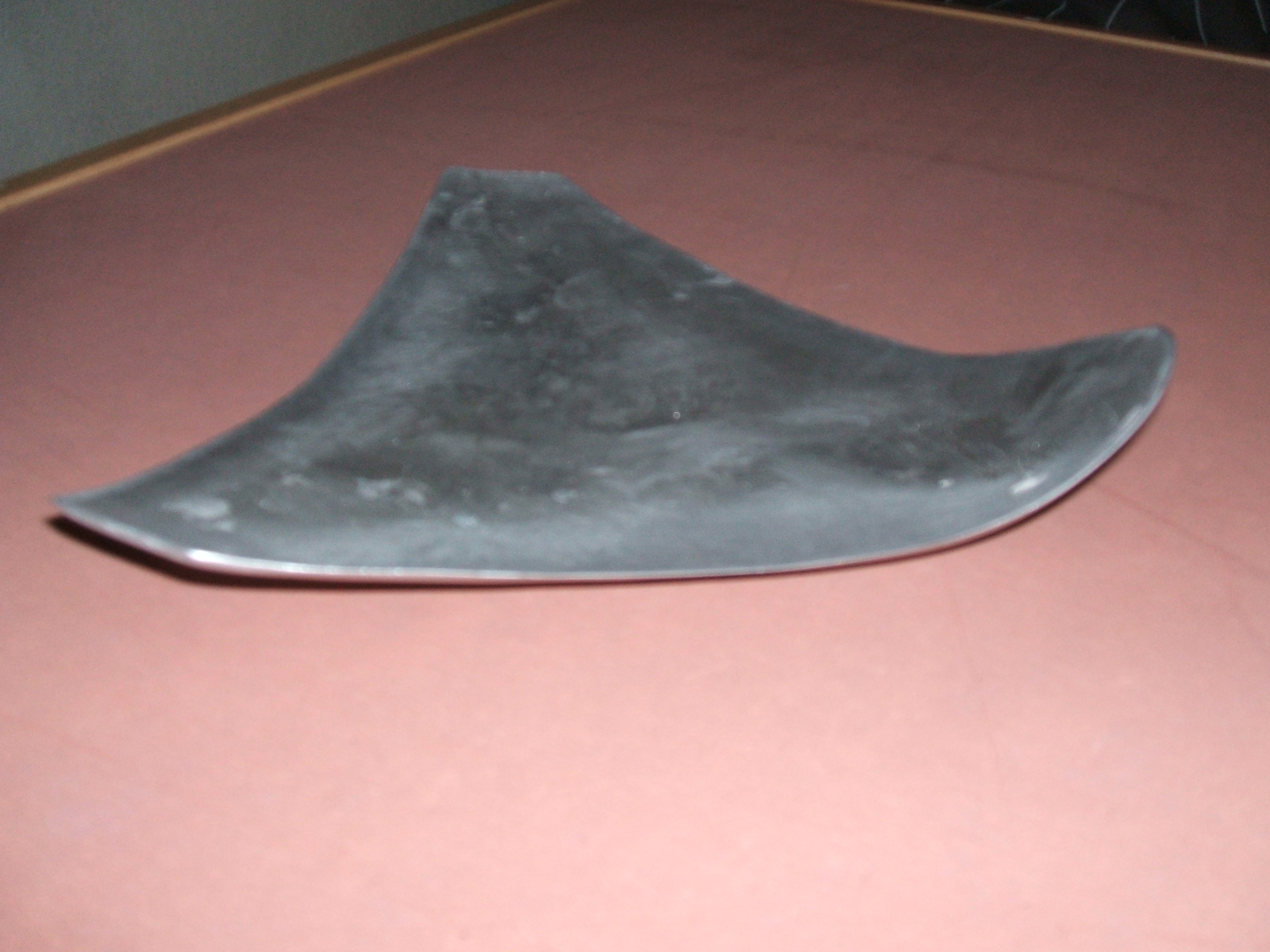

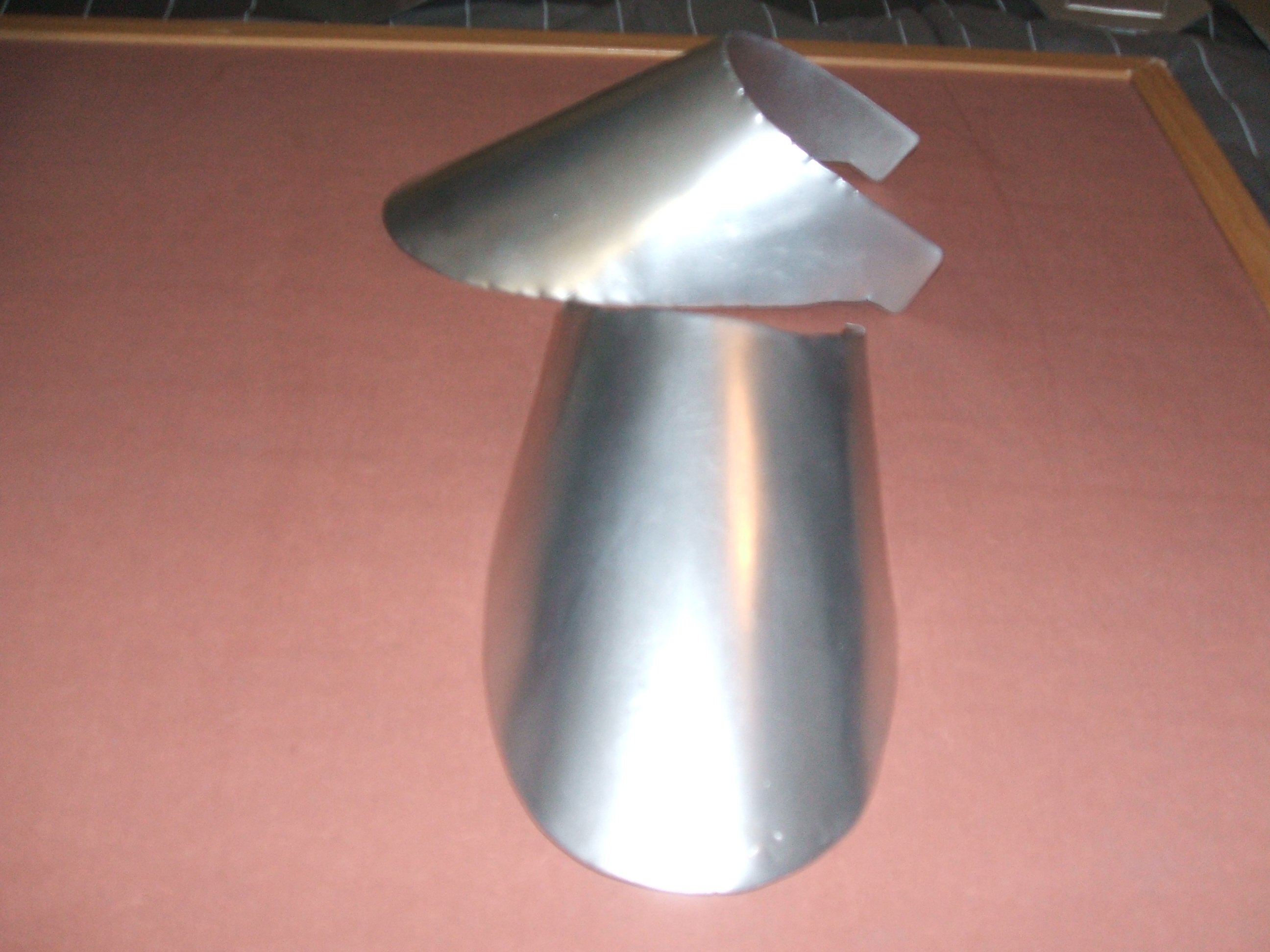

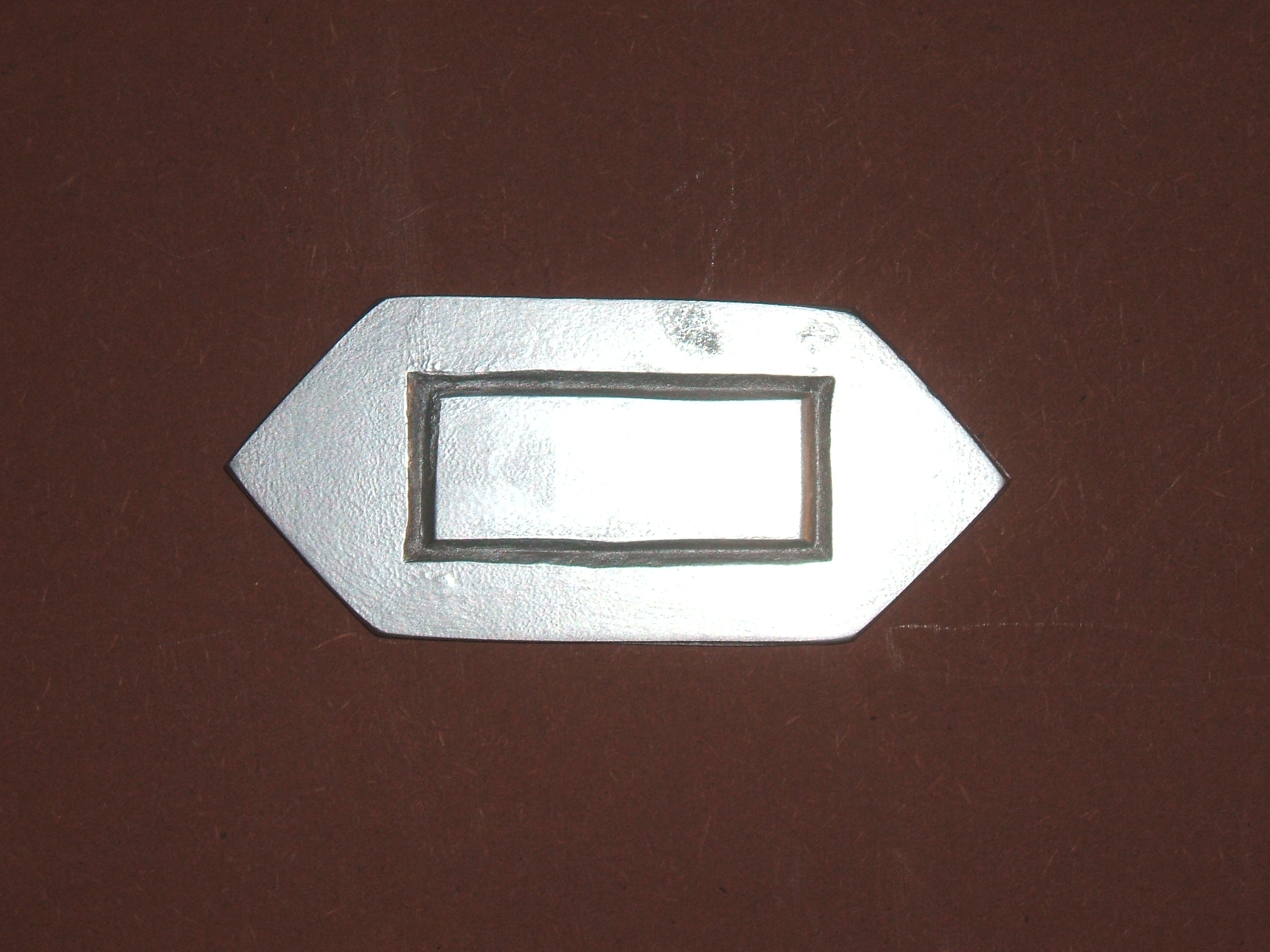

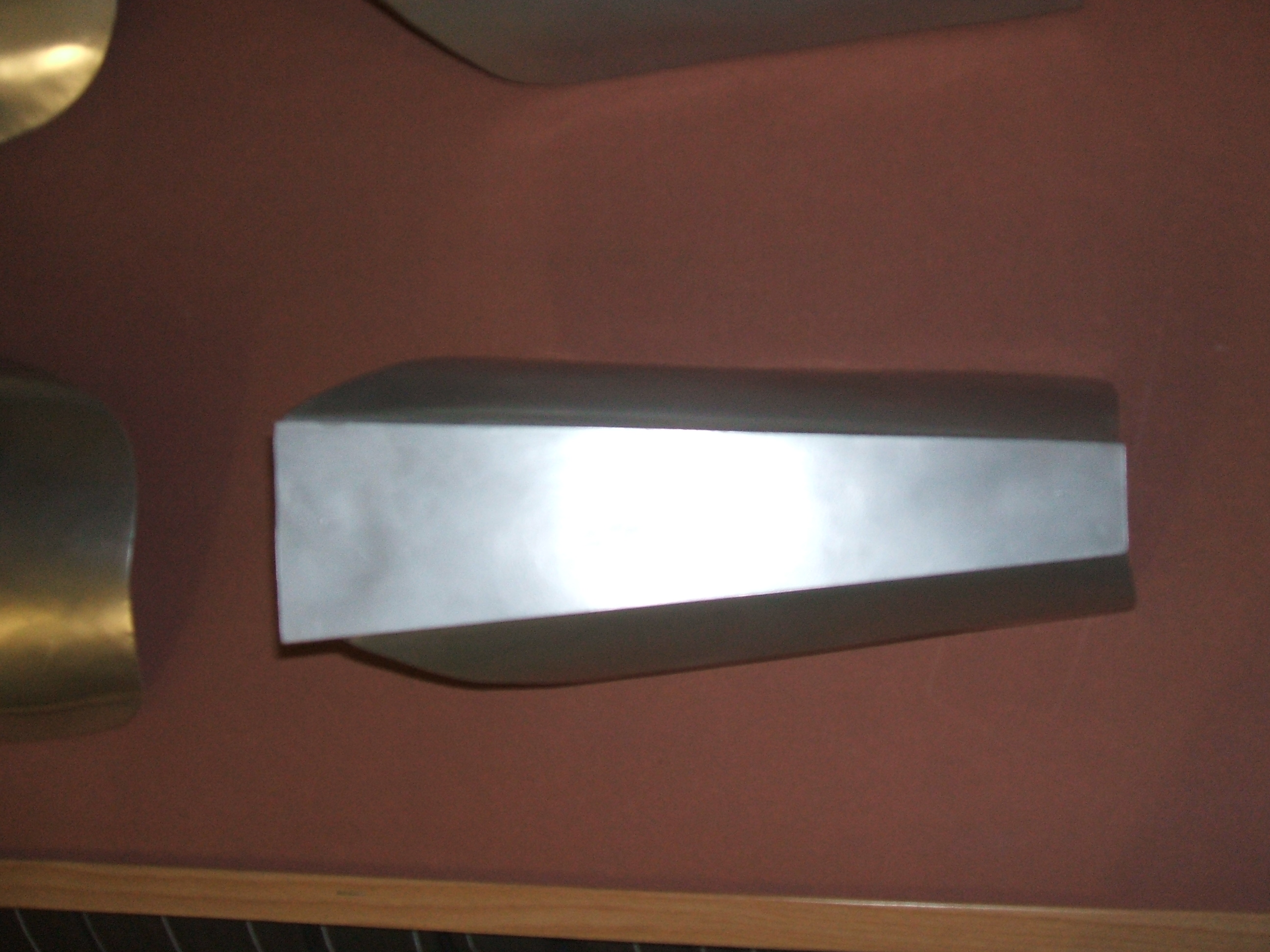

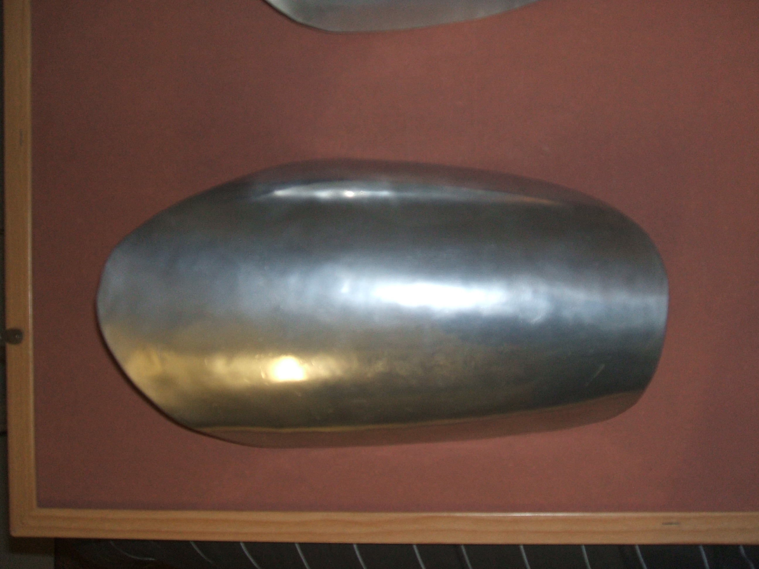

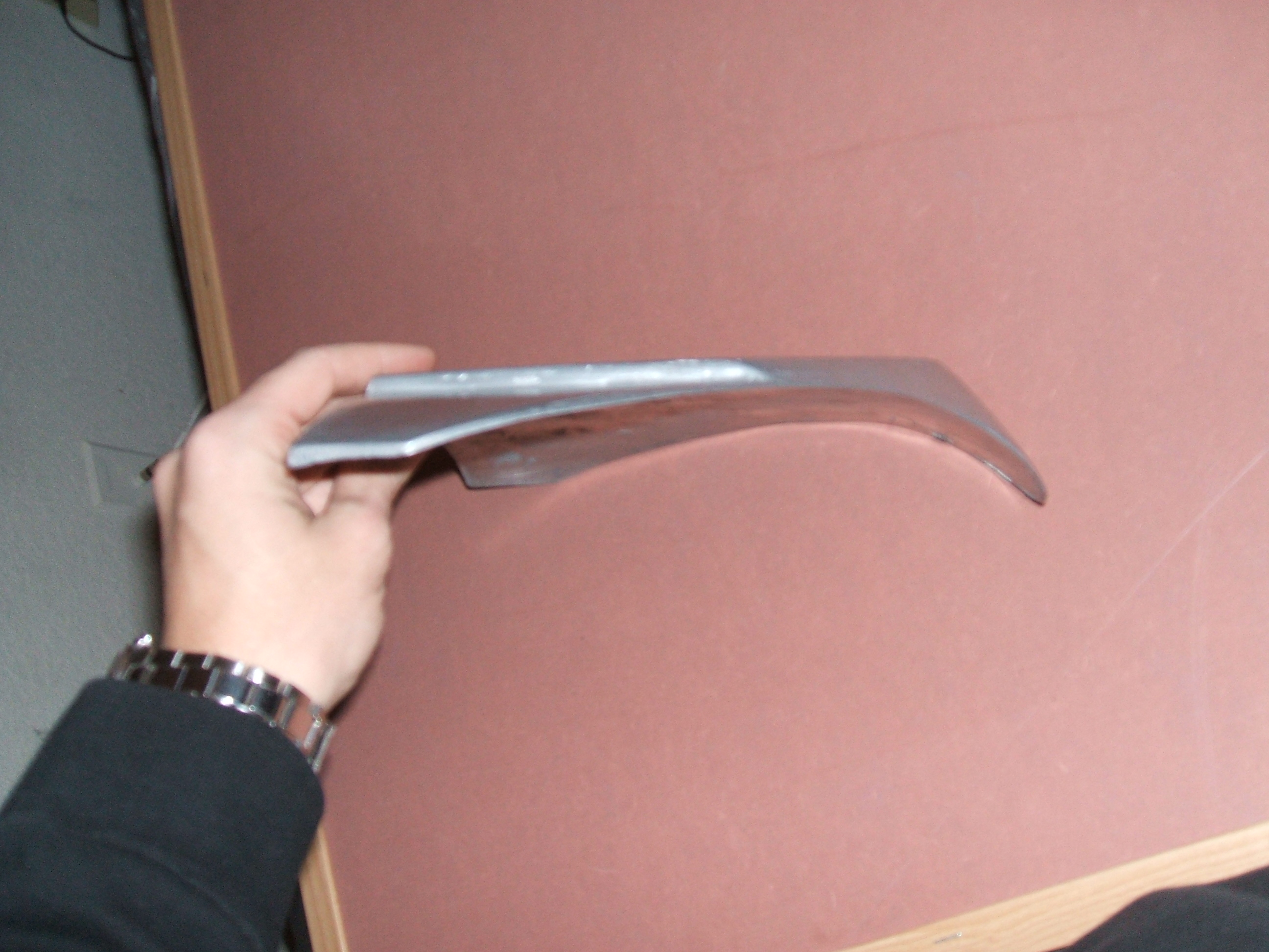

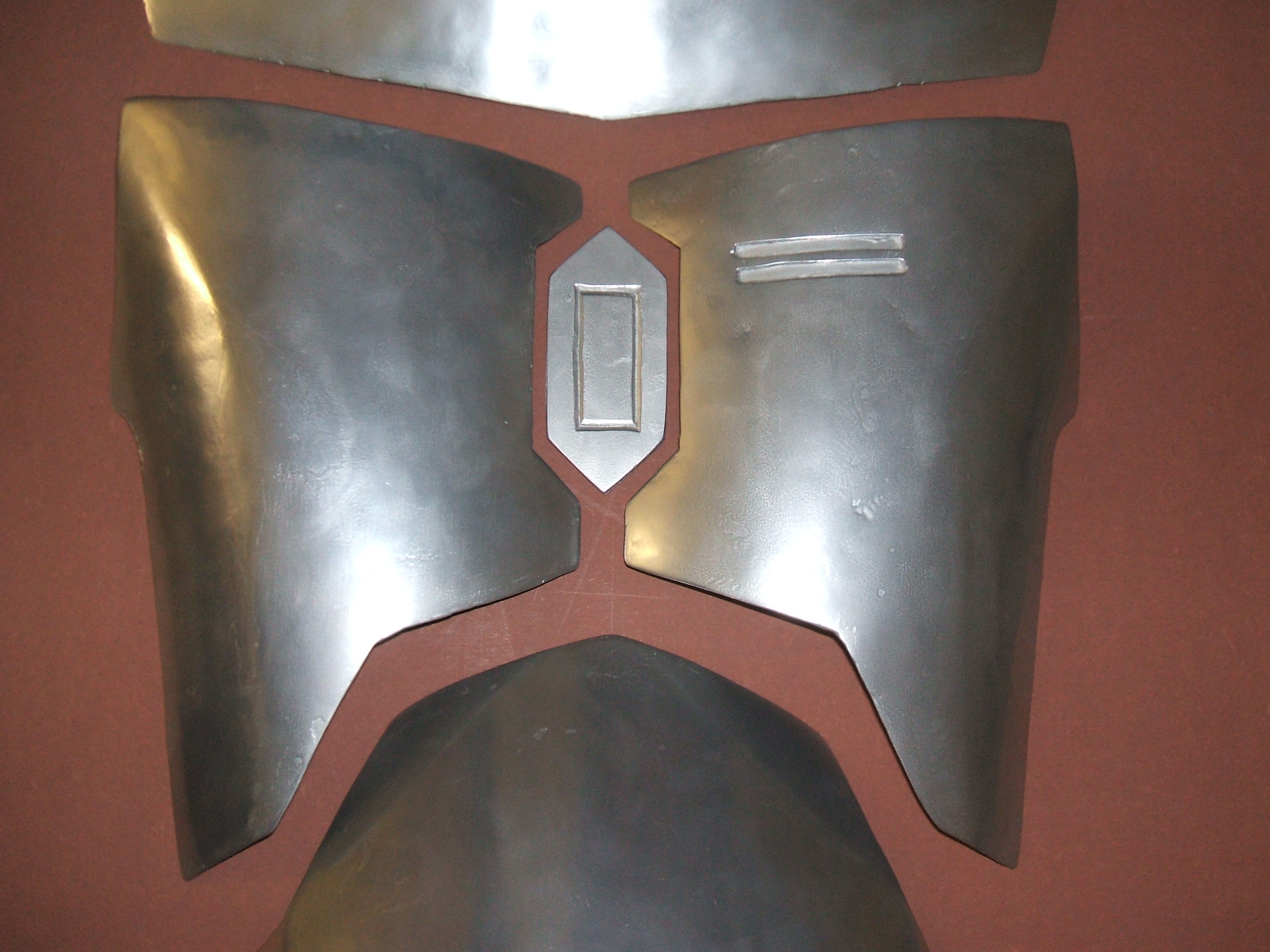

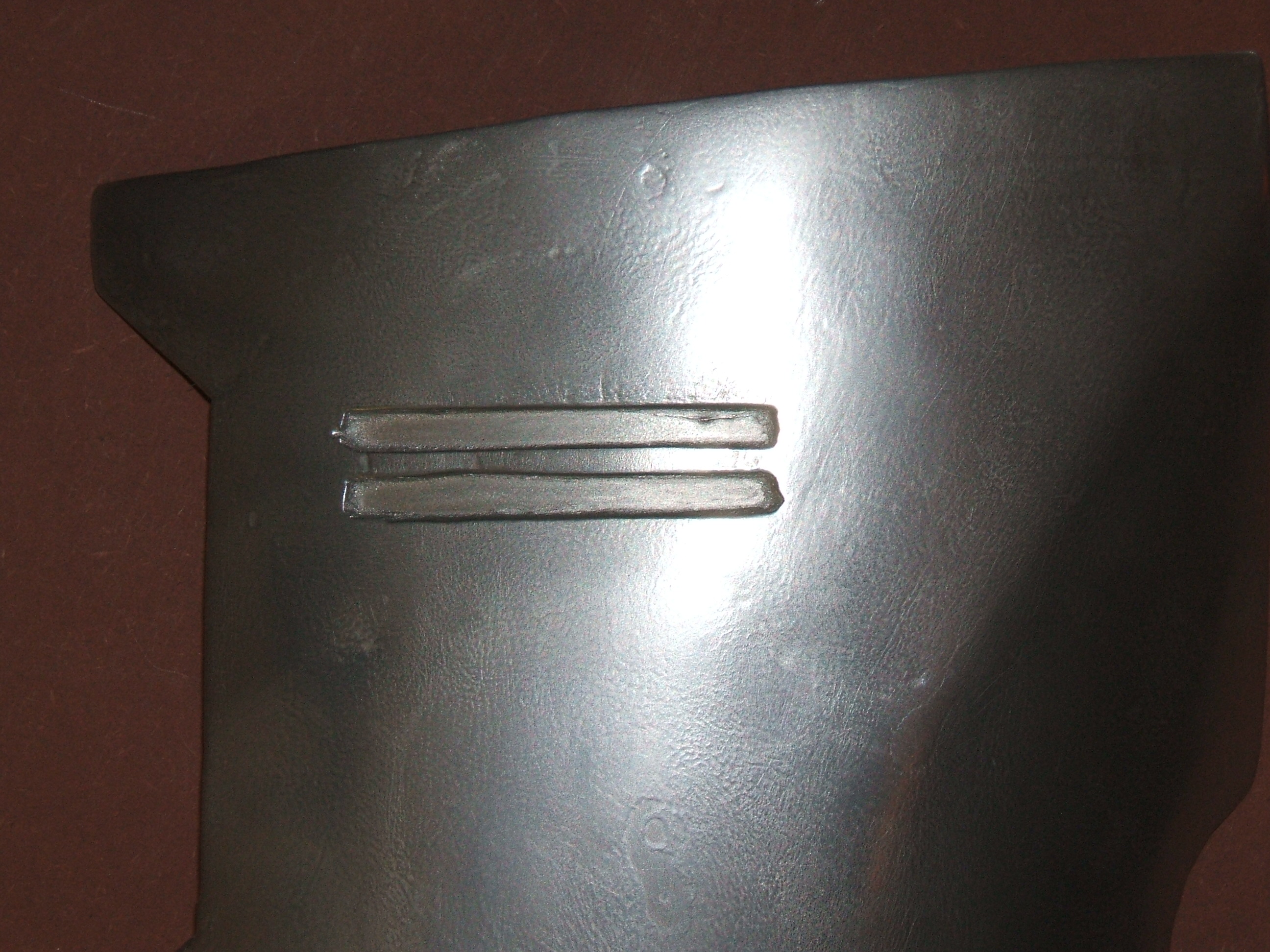

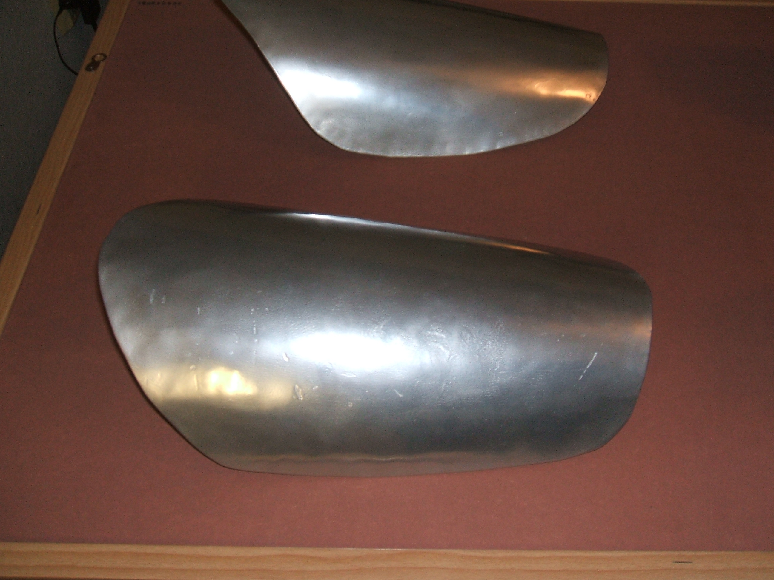

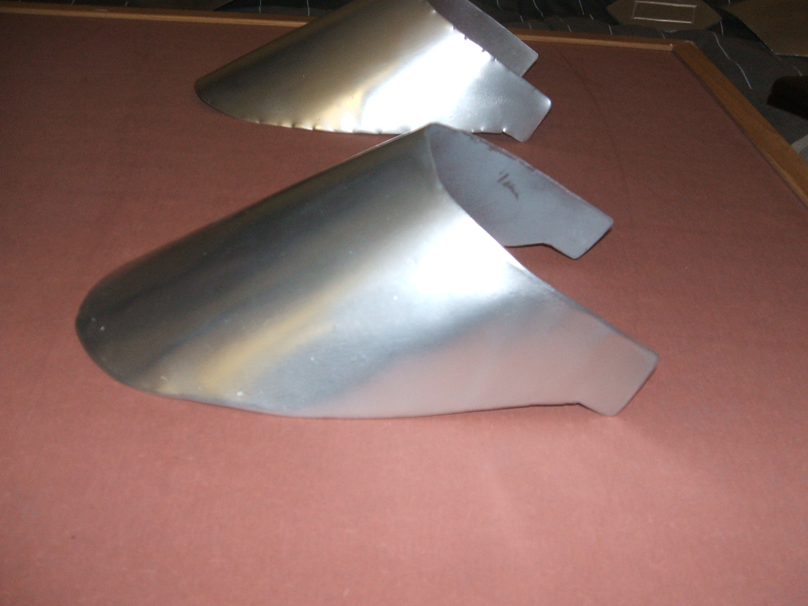

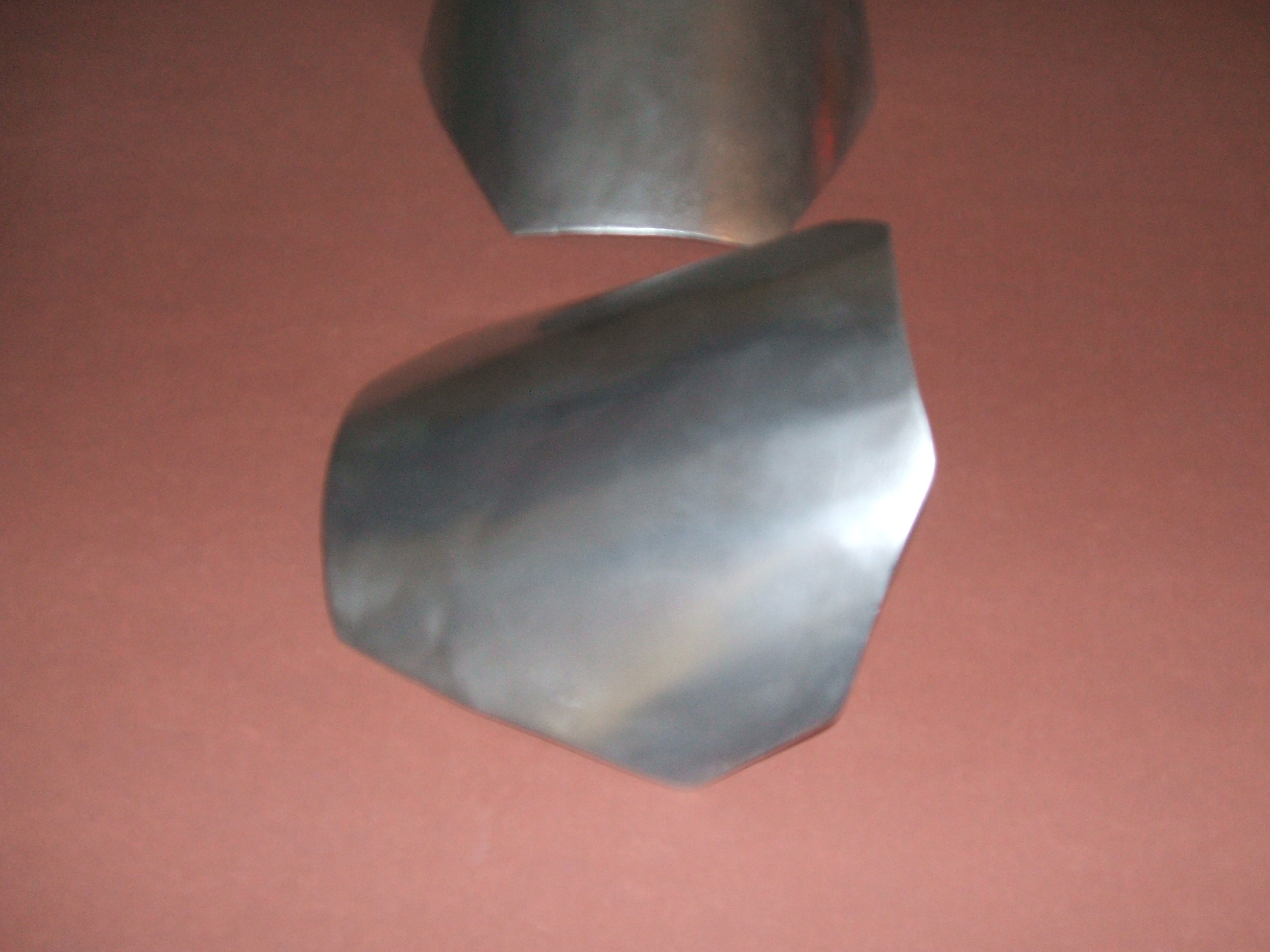

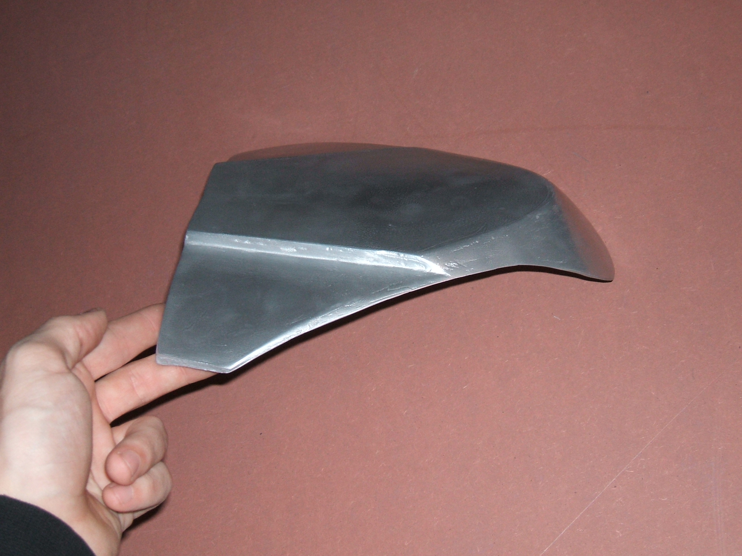

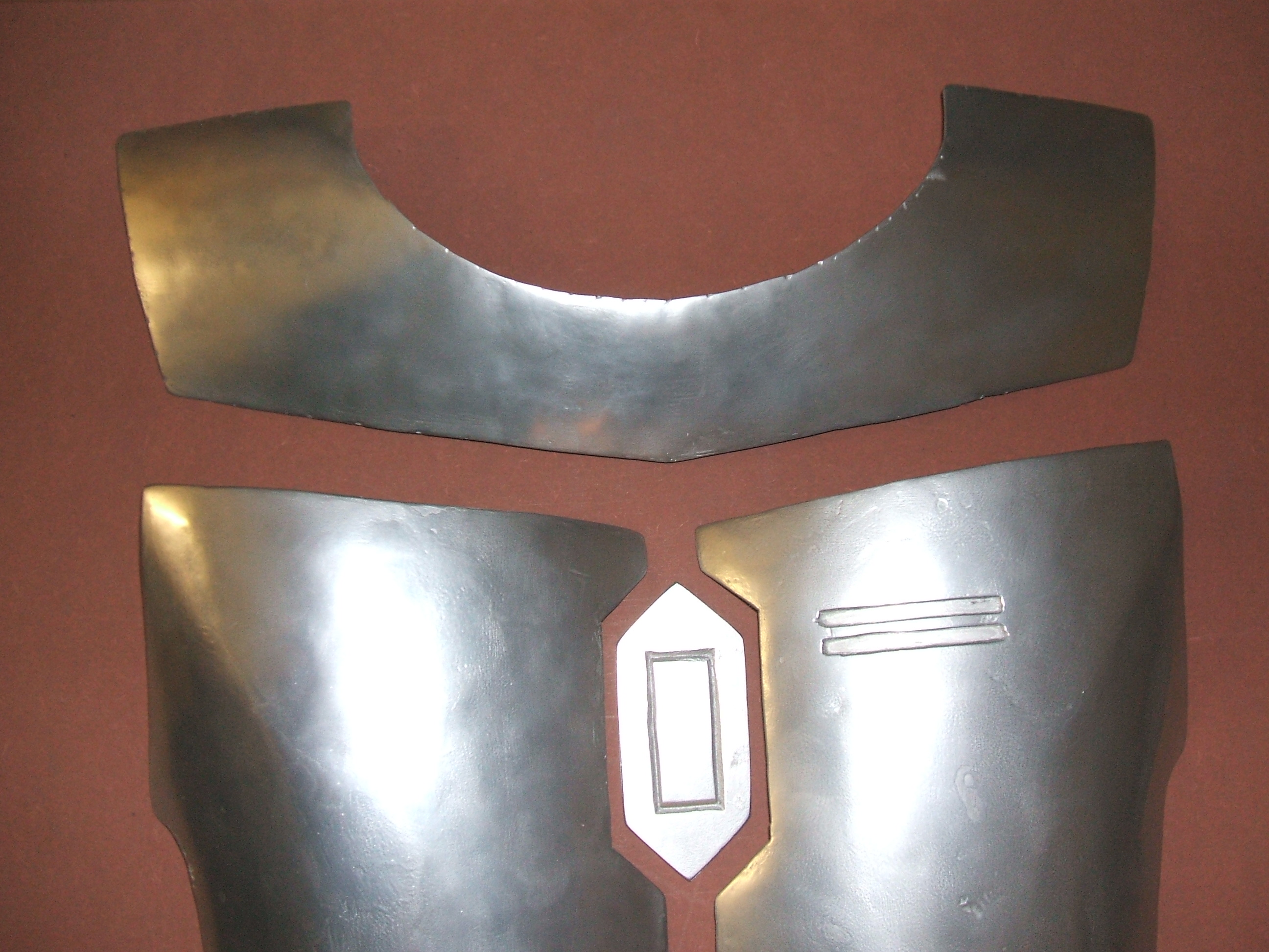

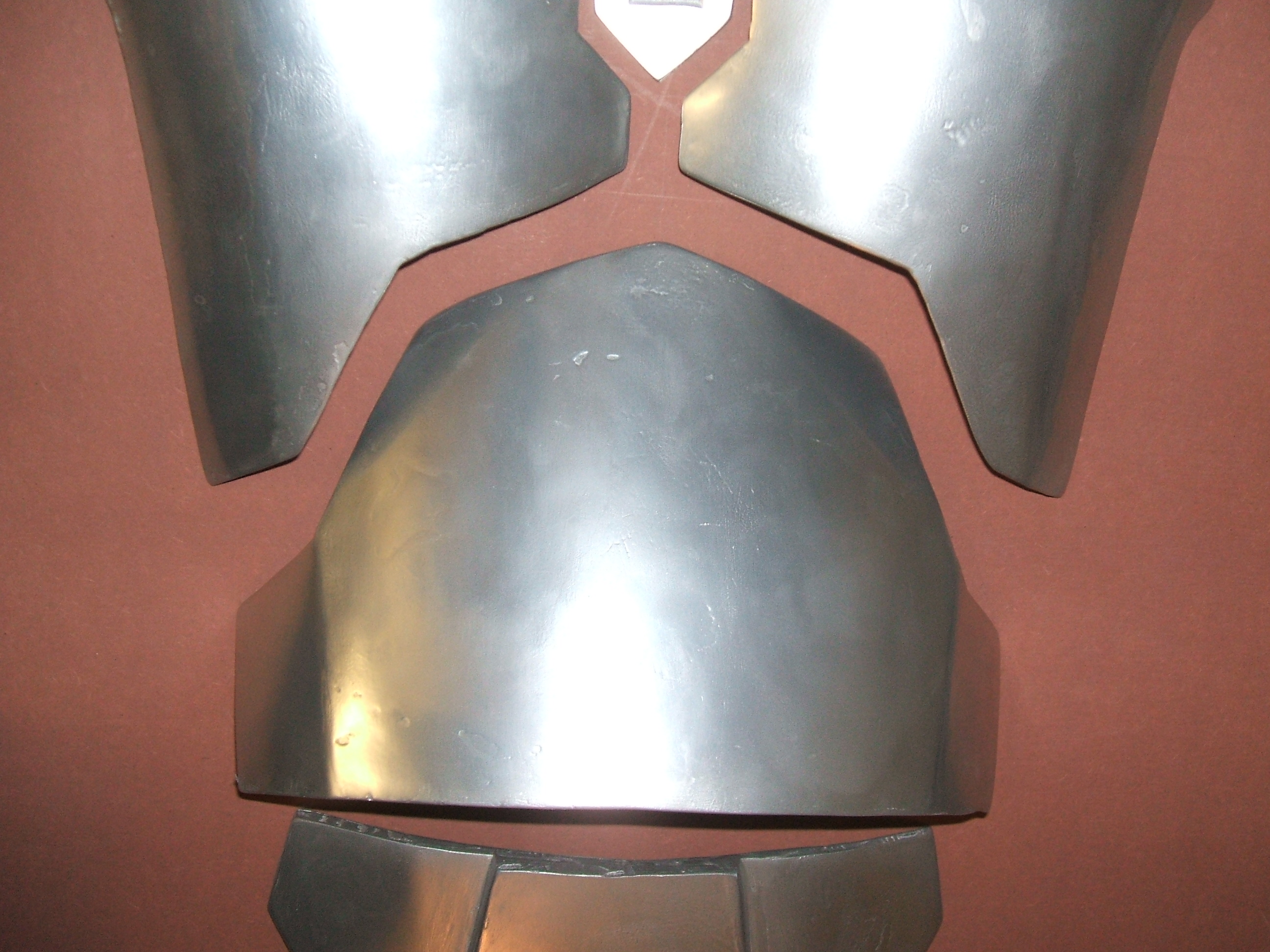

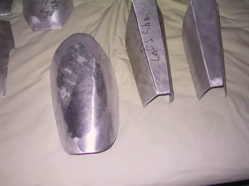

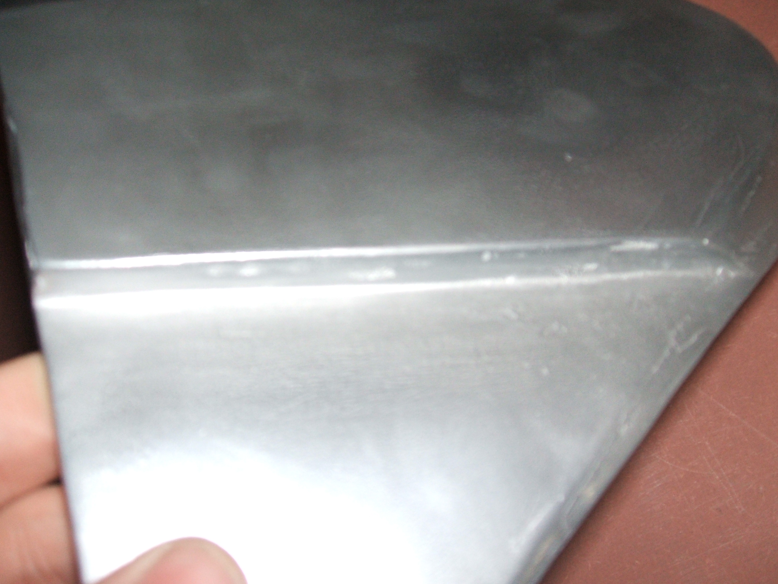

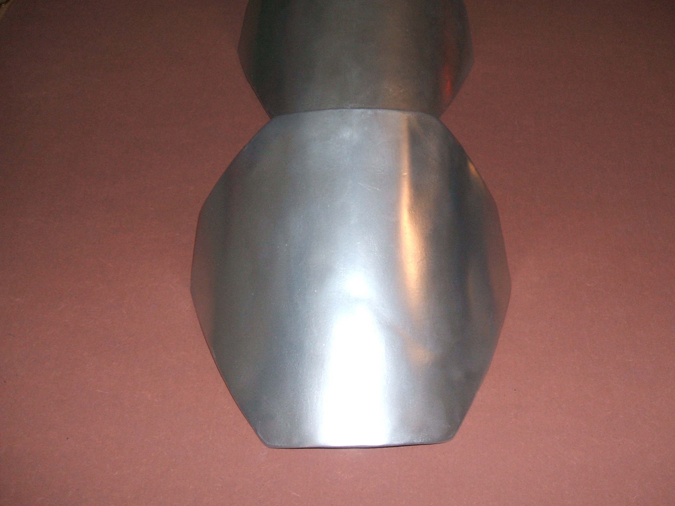

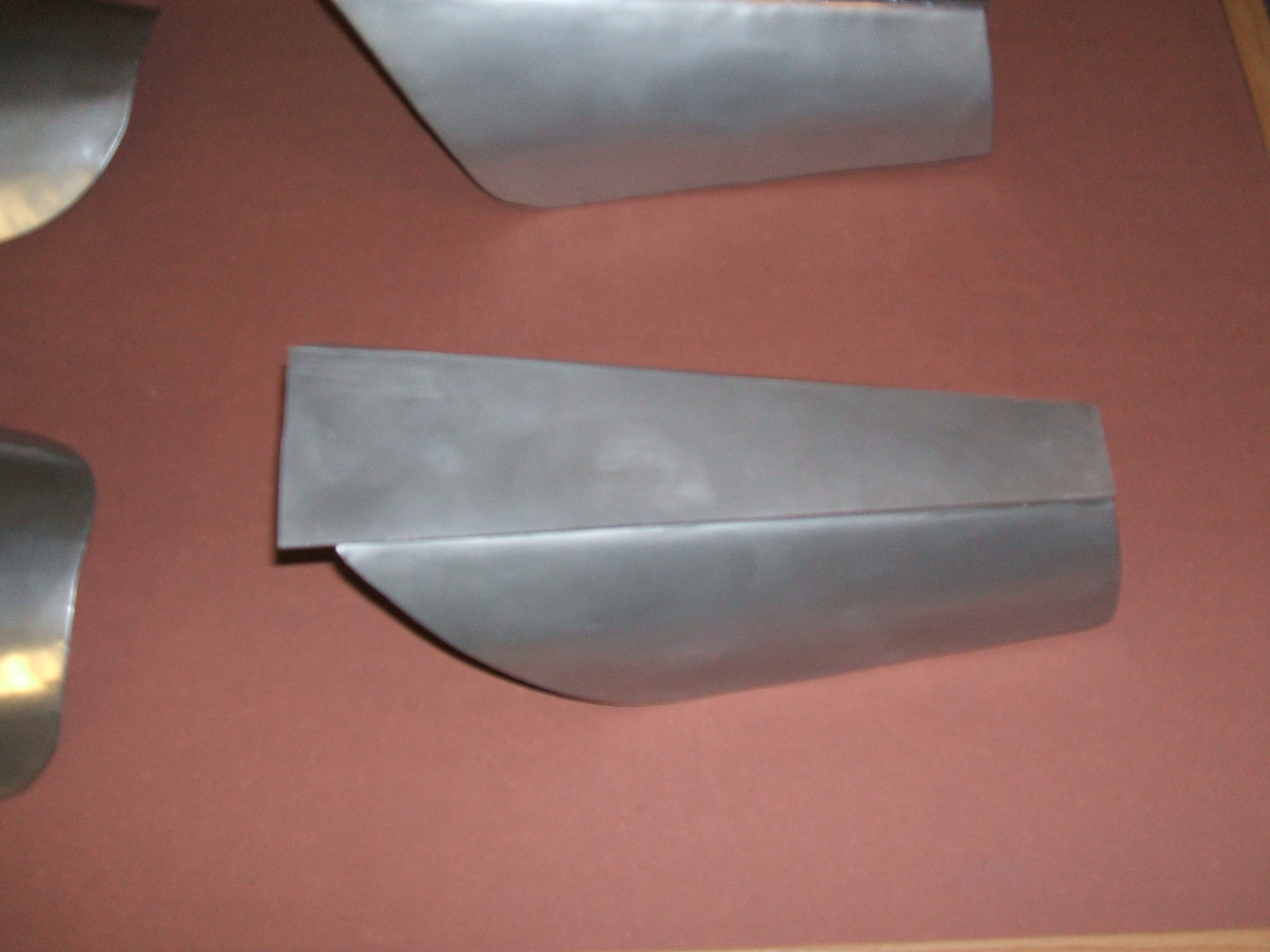

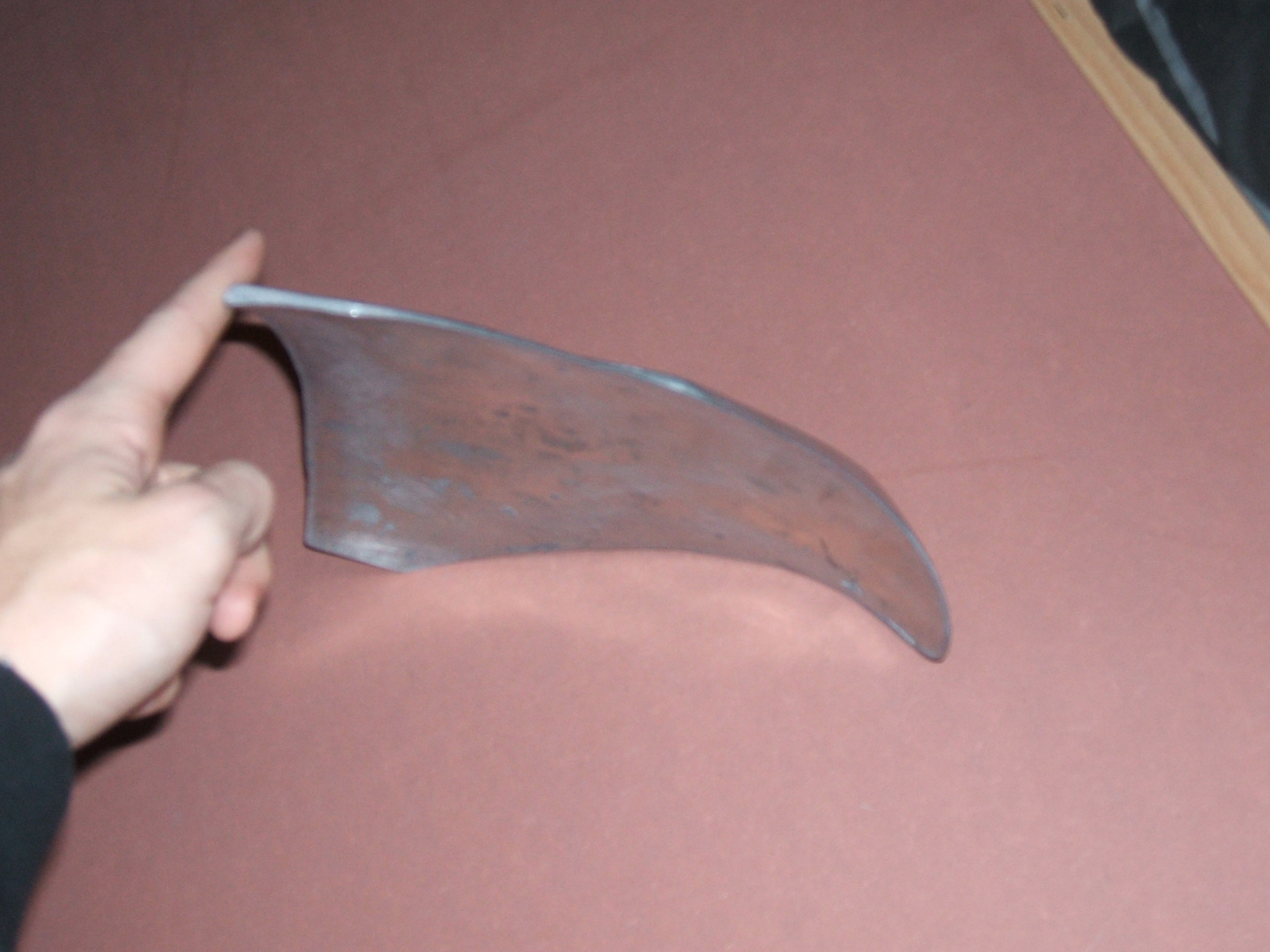

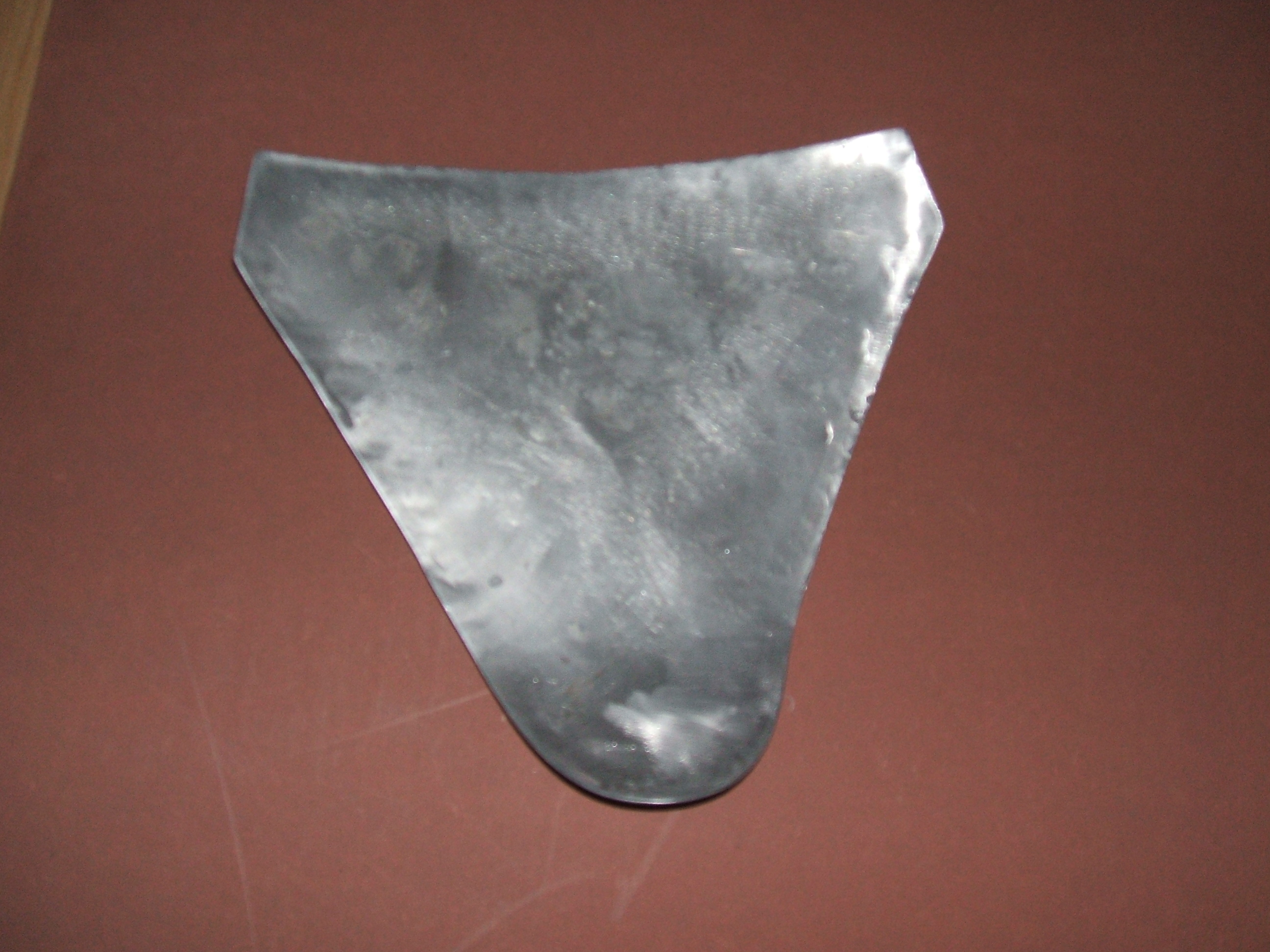

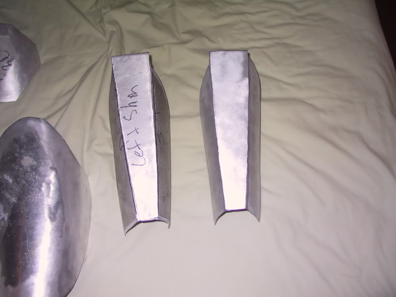

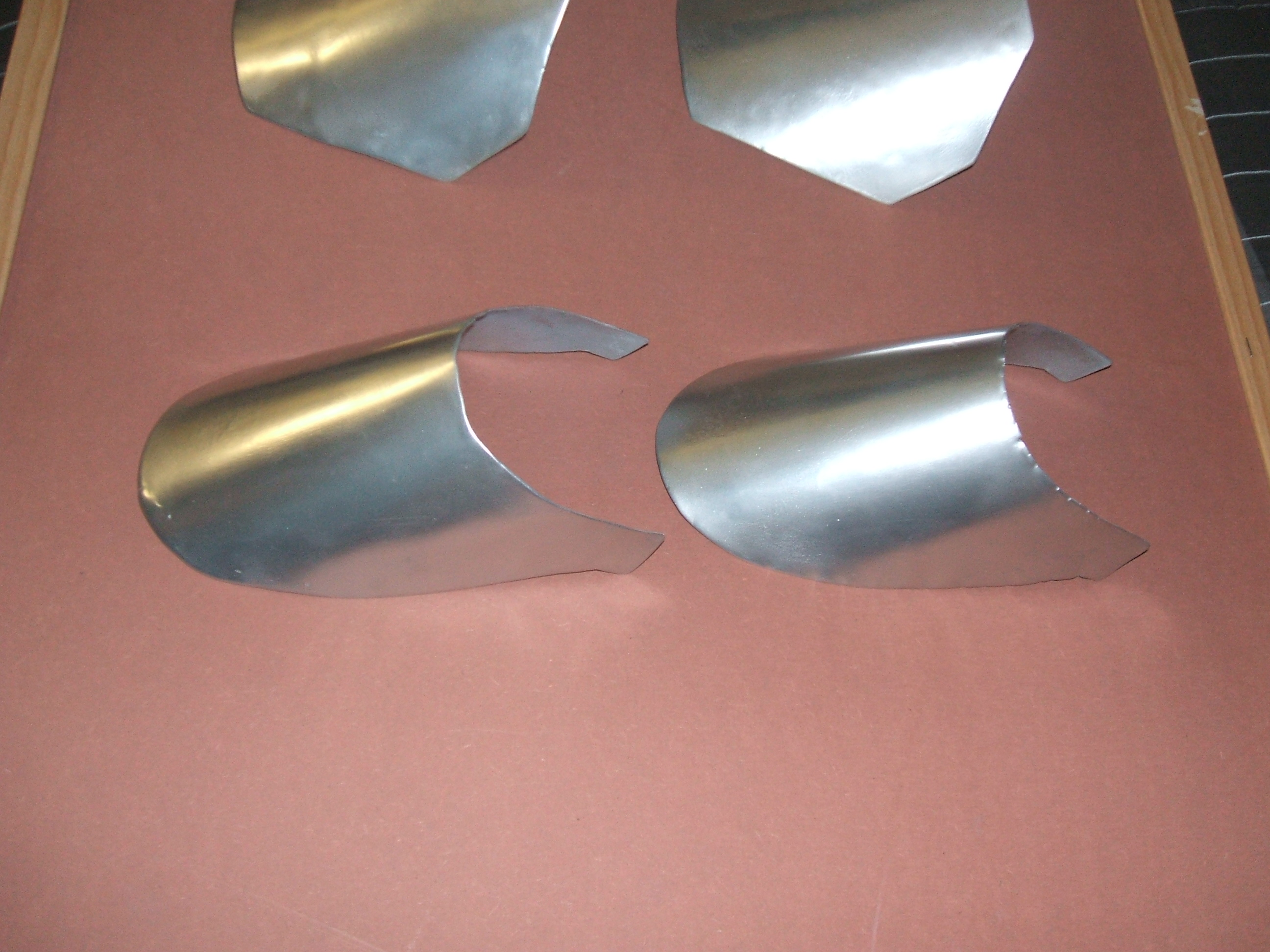

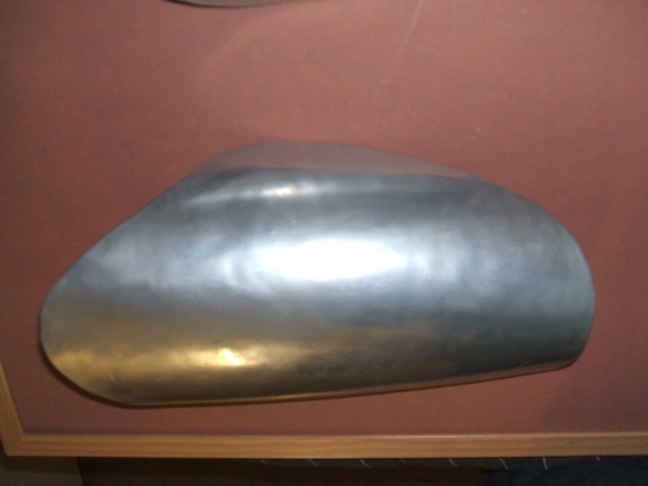

Here are some pics of my armor progress as of yet. The backplate needs major modification as far as the interior bends are concerned. Opinions are nice and I need constructive criticism from anyone who is willing to give it.
I have done some modification to some pieces as these pictures were taken almost a month ago. The armor itself was hammered out of sheet aluminum I wan to say 20guage.
Ab plate needs to be flattened in the middle I think but anything else? Shins also have been widened a little. and the chest/back slots have been cut

Looks amazing! I especially like what you've done with the back plate.
Want to make me one? ;)
Great job!
Well the thing I messed up that Im going to have to rehammer is the center upside-down "U" detail. I wasn't paying close enough attention and I hammered the dent inwards from the outside instead of outwards from the inside, which caused the U shape to sort of rise away from the back instead of hugging close like its suposed to.

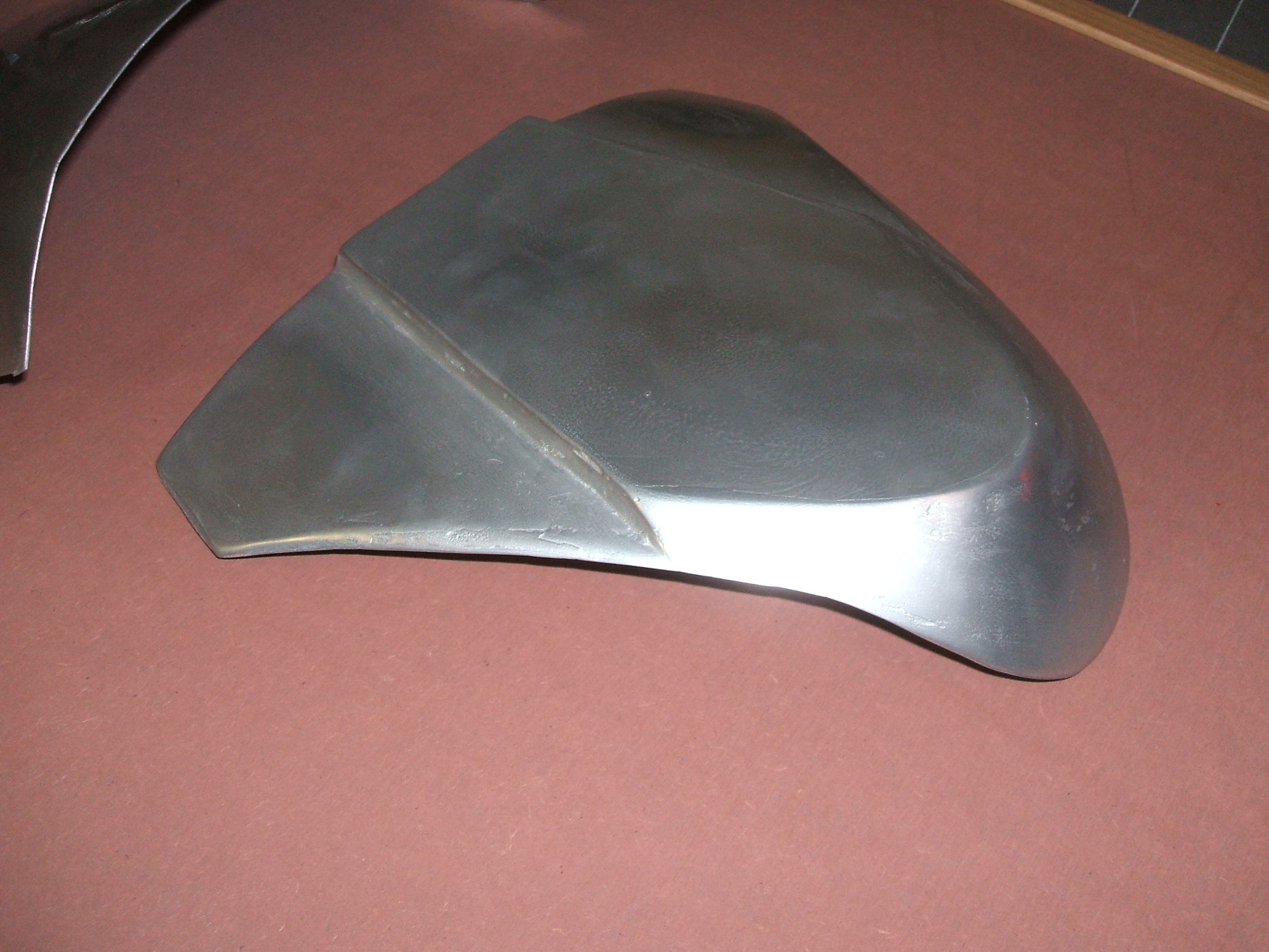

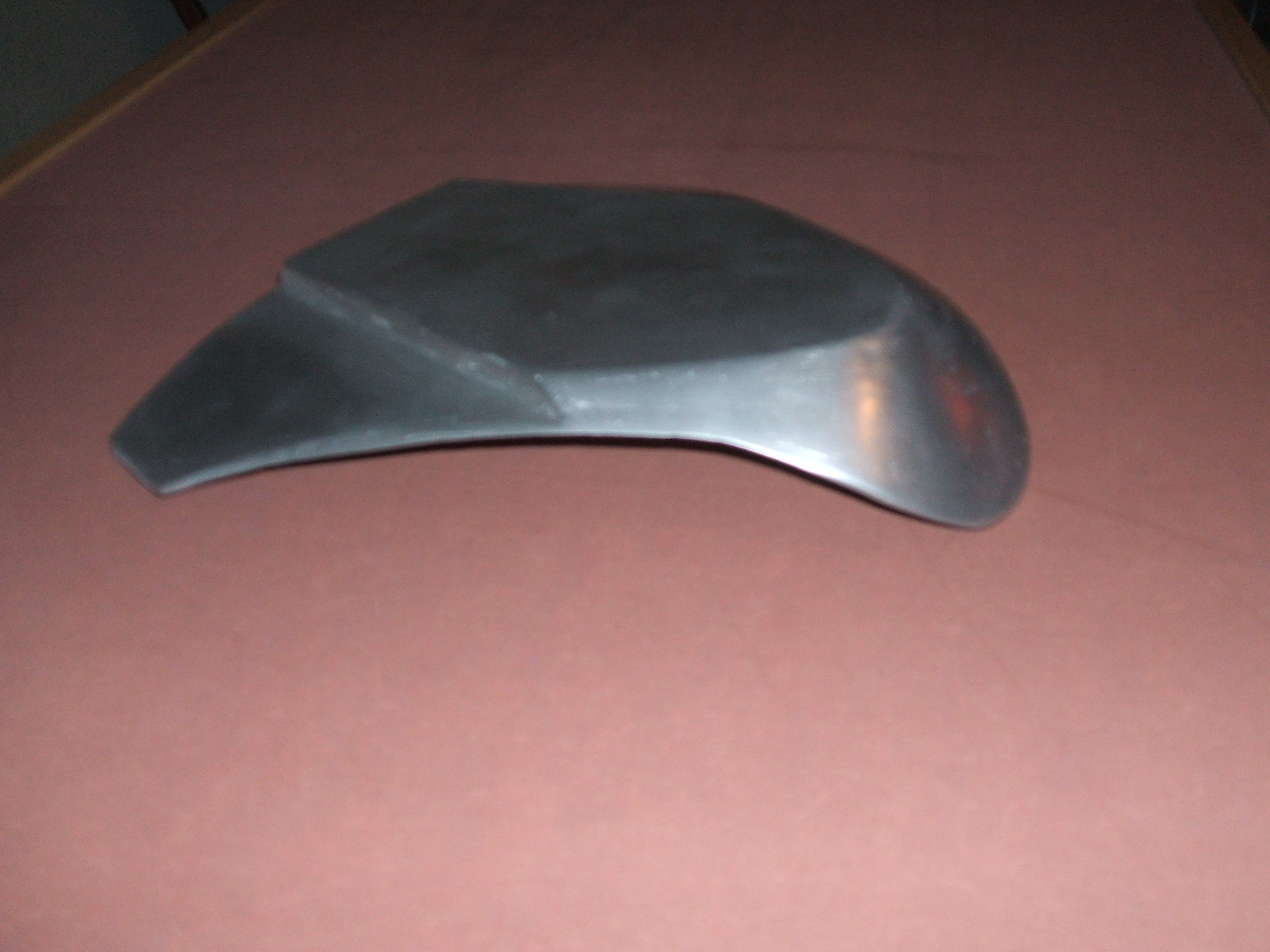

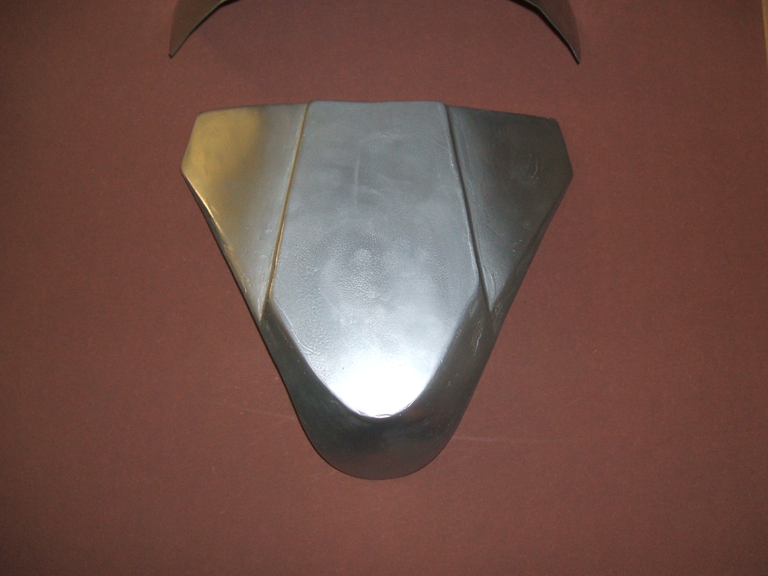

The crotch plate is also almost done, just have to add the center raised up area. The top and bottom plate for the crotch piece have been attached and the gap has been filled with bondo. I think it looks nice, I just need to get ahold of a camera to take some pictures here soon.

just applied silver RnB to m collar and shoulder pieces. turned out very noob looking, but it will suffice until I can afford better armor later on down the road. Remaining pieces need minor sanding on some spots and then I should be good to go with applying RnB to the rest of the suit. update pictures coming soon I hope!
since you are making this out of aluminum, you don't really need to RnB it. just sand the aluminum with finer and finer grit until you get to about 1000, (i'm going this route with some of my armor, and i used 320, 400, 800, then 1000 grits) then take some metal polish, i suggest Meguiar's® Motorcycle All Metal Polish. you can get an almost chrome finish out of your aluminum with that stuff.

Well I have finished the following pieces and am awaiting a better time (not so cold outside) to do some minor bondo work on other pieces. Here are the ones I've finished rub-n-buffing:
right chest plate
ab plate
collar plate
shoulder bells
thigh plates
shin plates
boot covers
As of now I have to do minor bondo work on:
cod plate(attach the center raised plate to the underlaying main plate)
left chest plate(attach a small flat piece behind the two horizontal slits to make it Jango accurate)
center diamond(attach the outer and inner pieces to an underlying diamond shaped piece for an accurate center diamond)
back plate(small bondo work to add the raised sections around the strap holes for the jet packs)
the back plate also needs to have the inner most curved detail ridge corrected as it was dented inwards towards y back before and it now needs to be dented away from my back in order to create a convex bowl in the interior section of the back plate
is what im doing to the back plate inaccurate? or should I make the inner detail ridge go away and flatten the ridge?

Backplates are EXTREMELY hard to do out of hammered metal, Jango even more that Boba because of the flat horseshoe in the middle. The only good way I know to make that shape is to use a technique called "Fluting" where you take a cold chisel and go around the inside of the backplate where the U is, raising the area. Once your done with that, you need a very thin chasing hammer that is almost mirror smooth to smooth out the top of the dent and impress the edges down to make that U look raised.
If it sounds complicated, that's because it is. I use this method on steel armor and it works great, but it's not so easy for aluminum because of it's tendency to crack instead of bend.
Well, as it turns out, the backplate is very hard to do and I ruined mine after trying to recorrect the U-shaped bend in the back, the collar plate no longer lines up with the back plates to short collar sections.

The armor looks good... I think the shins are a little odd, but that may just be my opinion... maybe they are too wide on the strip at the top of them.
I think the armor looks great so far... when you get pics of it close to your body we can get a better idea of how it will appear once suited up.
I'm curious about the codpiece... do you have any WIP? Can you take a pic of the back? I'm in the process of redoing my scratchbuilt Boba cod and was going to use metal to get a good shape out of it.
The cod piece was actually made with WoF templates. I cut a top plate and a bottom plate, filled the gap with bondo, then stacked/glued some cut up plastic (for sale) signs to achieve the center raised section and bondoed the edges to give it a crisp squared off look. nothing but aluminum, little plastic, and some bondo. First post updated with back of my cod piece

Hello supertrooper, tell me how you made the cod piece??? I am making my jango costume and the cod piece is killing me off!!!!!!!!!! I dont know how make the cod piece with my iron 2 mm plates and I talknig about the curve you know, tell me..............????????????????....thanks
Snowaure,
I hammered the bottom plate around the tip of the cod piece to start rounding it out, as well as a little bending by my hands for a subtle curve of sorts. I lined up the top edges for both plates, used Wizard of Flights templates to get the spacing right as he has a small cutout that show how much space you should have, then filled the gap with bondo and smoothed out the edges. The center raised section is just multiple cutouts from a big 'for sale' sign that were glued together then glued to the top plate, then sanded apprpriately, and finished off with a little bondo to make the edges squared off.
Unfortunately the closest you are going to come to seeing my work in progress pictures are the before and after rubnbuff pictures in the first post of this thread. Trial and error worked for me, being as aluminum is very forgiving when it comes to have to rebend minor curves. Hope this helps
