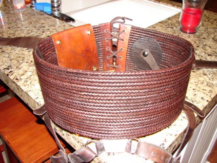

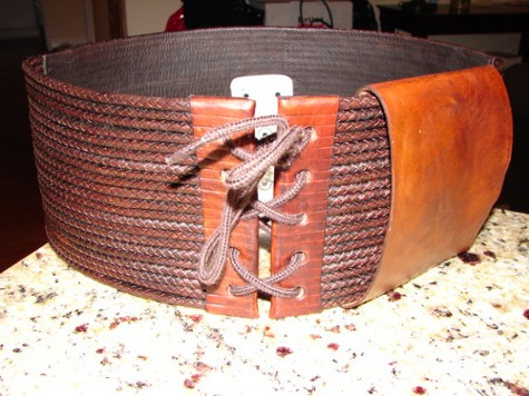

Here's my newly created braided leather bolo belt. Not to sure about the back closure, but it's screen accurate so oh well. Used 21 braids, but I'll probably be getting rid of two of them when I have time. I used the 6mm bolo from MJ Trim and the belt's width is just shy of 5.25".
The entire project took me the better part of the day, and I only had one setback.

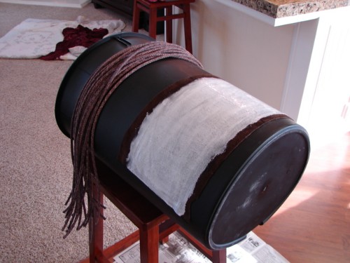

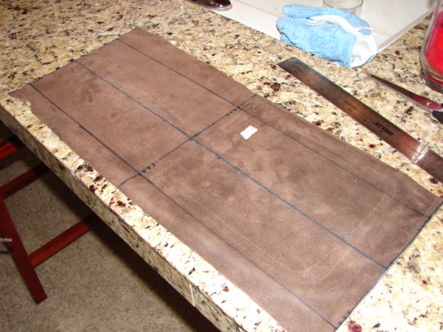

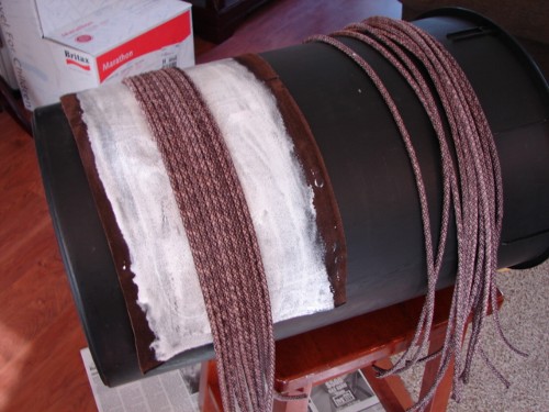

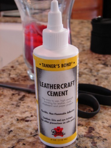

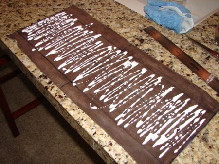

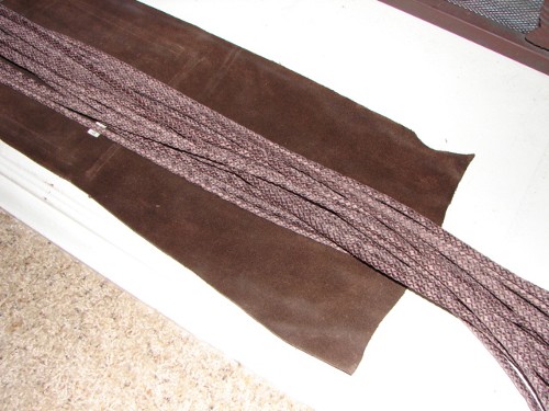

I'll post the pics and they're pretty much self explanatory. But I will say that I did sand down each braid strip with 100 grit sand paper to rough up the surface and smooth out the edges because the glue wasn't sticking as well in the test-runs with scrap pieces. I also did test-runs with glues like Goop(fabric), E6000, & Superglue(gel and liquid); and none of them performed as well as Tandy's LeatherCraft Cement where the viscosity of it seemed to penetrate the leathers better. And I also used two types of leathers on the belt: leather piece taken from an old bomber jacket on the inside, and 2-3 oz belly hide on the closure edges and cover.

Tk-938, it's a strip of 1/8" sintra cut 2.25" wide. I heated it up on one end, folded it over onto itself in a half circle, superglued and bondo'd it to close the gap, and then trimmed the sides at angles.(y)

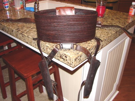

Things I'd do differently next time:
1. move the circle pieces of leather(with the snaps for the holsters) closer towards the middle because the snaps get in the way when I've got this thing on and I'm trying to push the cover piece over when taking the belt off.
2. use the accurate 4 ply 6mm leather cord, but I'm too lazy to braid it right now.:lol: I did find this place in India that has it, but I emailed them and they replied with a minimum order of 500 yards at $170 per 100 yards. What would I do with 500 yards of this stuff. :confused
