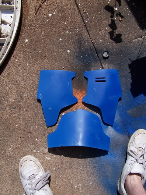

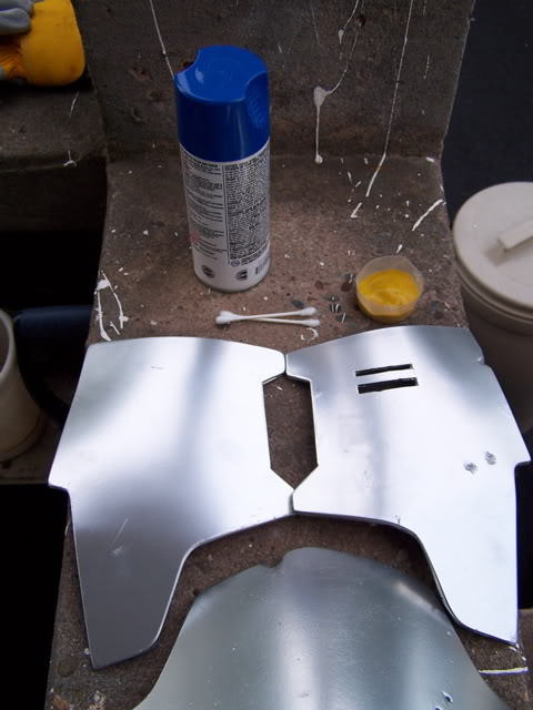

I use mustard as a masking liquid, it gives a nice random damage effect when you rub it off :D
For example.. here's something I did a while back
Setup
Apply mustard where you want silver to show through
Paint
Paint dries
Rub off mustard and wash mustard out of crevices with wet paper towel, let dry
I've read that some brands of silver can be stained by using mustard.
