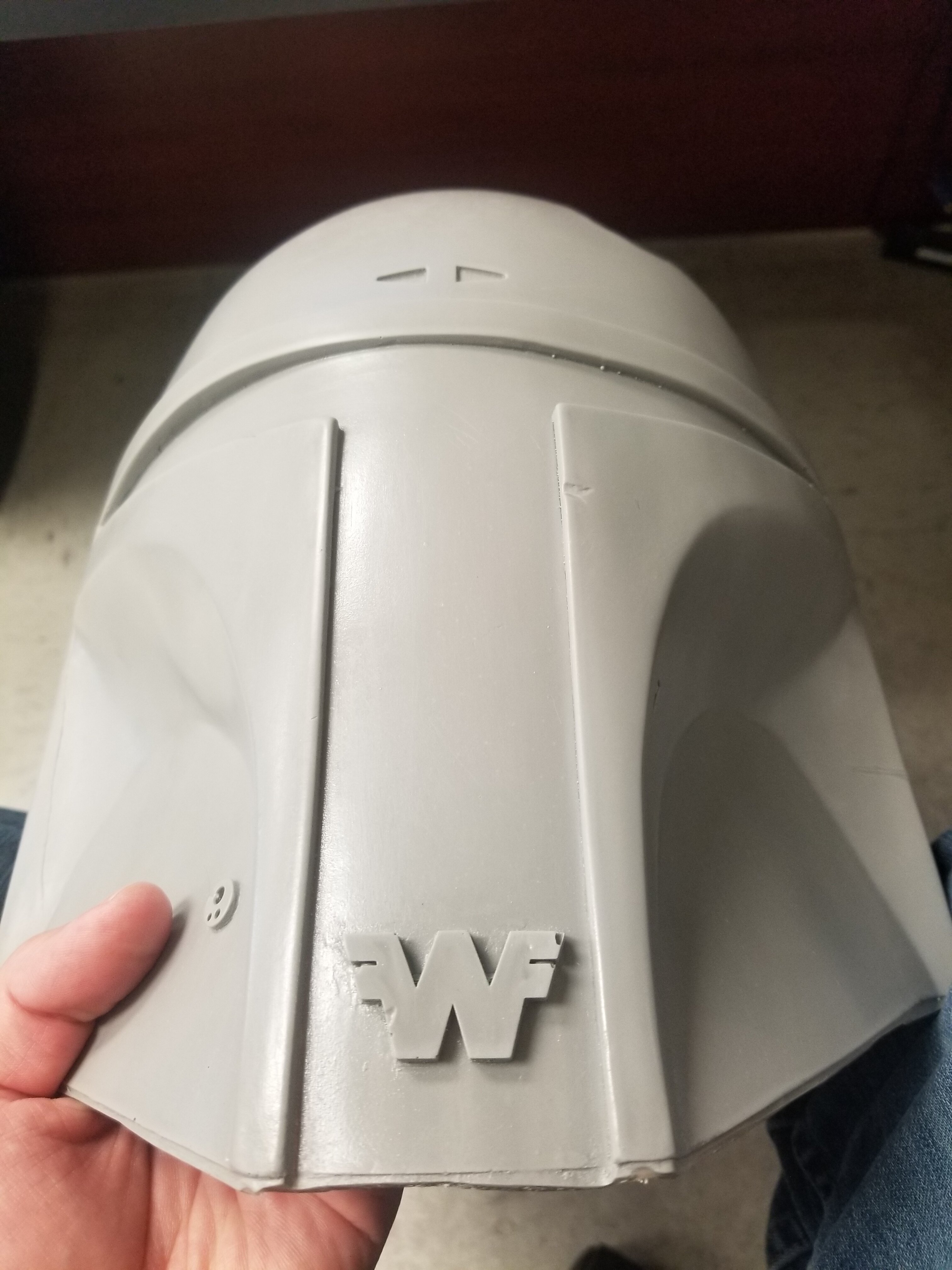

I went with the WastedFett/Viva Fett Fugly helmet and love it. I do have a few questions though as this is my first cast resin helmet and I want to do it right. I am looking for guidance on how to properly prep the helmet for paint and also the best ways to trim the excess molding safely without screwing up the helmet. This is not my first rodeo of helmet prep per say, as I did a 3D printed helmet prep and paint up which aged me about 10 years in 12 months lol. The shape was a little off on that 3D helmet though, and approval standards may have denied it so I went with the Fugly, and honestly couldn't be happier with it.

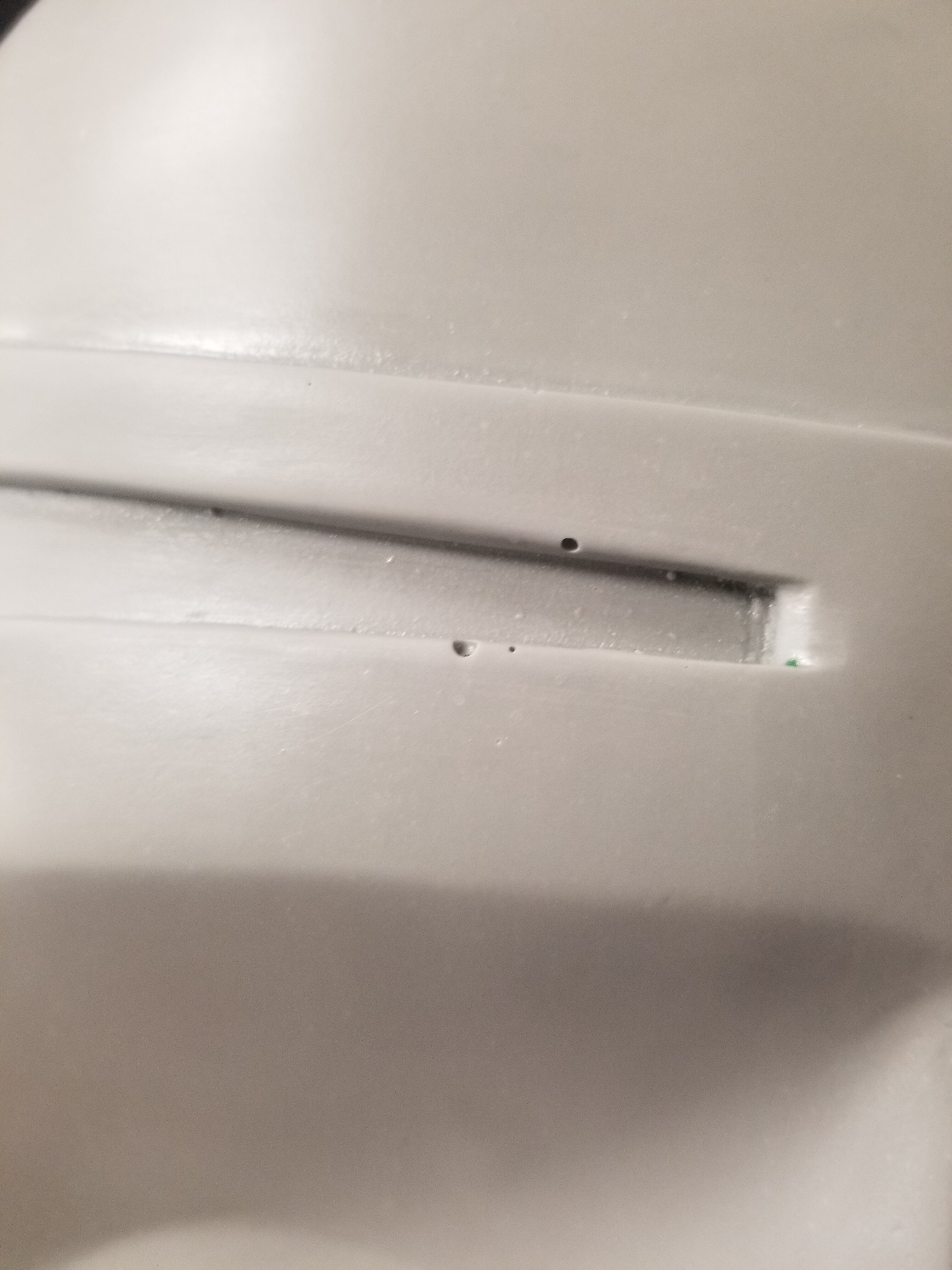

Awesome helmet. The fact there there are no lines from going the printer route is a huge head start. With that said, did you guys lightly sand the entire helmet anyway though for better paint adherence? There are also a few bubbles in the mold (I believe that's what they are) here and there which are no big deal, but I want to make sure I'm filling them correctly and my prep work is exact. What do you use to fill these little bubble holes? I used Bondo on the 3D printed helmet. Just curious if that is also the go to on these resin casts? There are a few tiny holes pictured in picture 2.
I also wanted to see what you guys used to trim the excess molding off. It seems it is coated in resin and will be tough to cut. Especially around the visor area. I assumed sanding it down on the bottom areas but the visor area seems like a different monster. Sorry to be the 1000 questions guy, but I know there is so much experience on this page and wanted to come to you guys with this so I do it right. I plan to start prep tomorrow morning some time. Thanks for all your help. I've attached a few pics for reference.
You’ll want to use bondo or hobby putty as superjedi likes to call it for those small air bubbles and then boom sand it down lightly so it’s nice and smooth!
