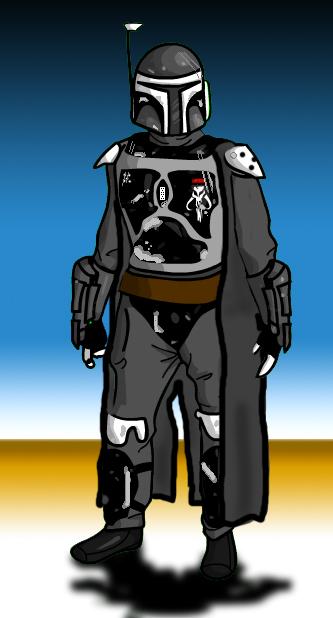

Here's a concept for the Mando I'm starting.
I was originally going to go straight up Boba, but with all the known info about his suit, I'd never make a perfect suit. So original idea it is!
I'm going for a sort of Western Gambler look. Will have dual blasters that will holter under the armpits beneath the coat. Will also have wrist blades.

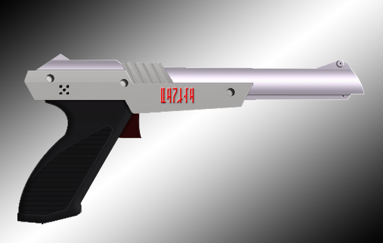

Here's a concept for the blasters I'm going to use based on NES Zappers.
I'll possibly add a scope to the rear and definately some sort of extra random parts on the body to make it look less toy-like.

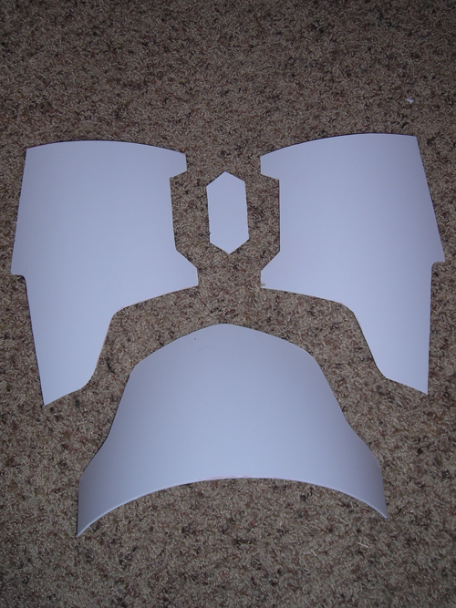

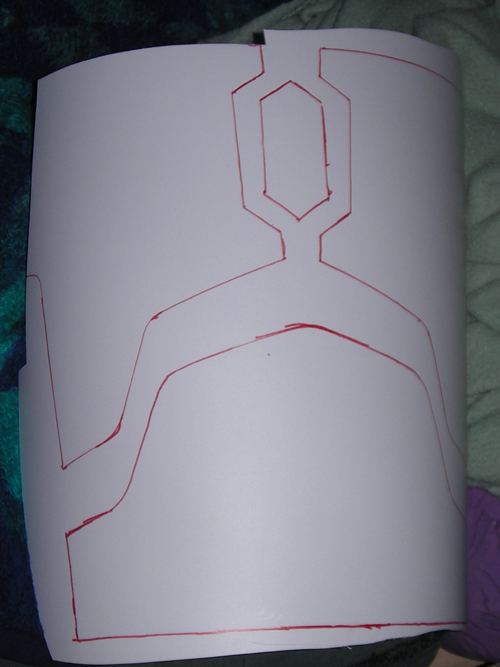

Wasn't going to start on this until later, but I've been kind of burnt out on the figures I'm working on and felt like a change. Using the brilliant trash can idea. Got a Sterilite at Wallyworld and use WOF's awesome templates to cut these parts out. Thinking about adding a blade to the design that will retract into one or both of the gauntlets ala Kroenen from Hellboy. Will probably use the trash can again for that. Would have the rest (shoulders, neck, crotch) cut too, but I broke my utility knife earlier today on something else and had to do with kitchen scissors.
nice! I had a mixture of DREMEL and tin snips, and since my hands are small and the tin snips are bigger than I need I did not do a very good job. YAY FOR SANDERS!
I would have used my Dremel, but it was like 11:30 at night when I started and I didn't want to wake up the lady that lives below me. Man, using scissors on this stuff is not a good idea. It really wrecked the heck out of my right hand. It feels like when I first started making chain maille way back when. I got pretty clean lines though. I'll just have to go back with the Dremel and clean up the edges and cut out that middle rectangle of the diamond and the light holes on the chest. Oh and do damage.
I have 2 of the three colors I need (silver and grey). I'll probably snag some black tonight and paint when the weather gets back to normal here.
Also just did a quick mock up of damage placement.
(fixed with other bg color to show it's not broken)
I'm not breaking anything. At most, there will be a dent on the collar and chest parts and some scratches Dremelled in. what might look like a broken part is actually where it will be weathered down to the silver base coat. Sorry about the cruddy images, I only have access to MS Paint here at work and I've gotten lousy with it over time.

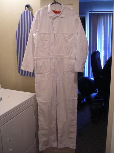

Just got 2 of these.
$22.85 + shipping for each. Will be modifying one with pockets, pouches and sleeves made from the other.
Bestbuyuniforms.com
Just search for "coveralls" when you get there. I got the Coveralls - 65/35% Poly/Cotton Heavyweight in White, but they have them in Navy, Spruce Green, Postman Blue, and Shell Brown too. They also have a set of Bright Orange ones for $19.95 that I could totally see someone using as a Rebel pilot or Bossk.
I have been looking for decently priced coveralls for almost a year now and this is the best that I have found.

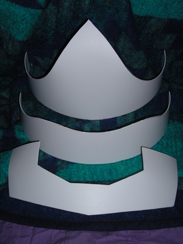

Got cod piece, butt plate and collar out of the rest of the trash can.

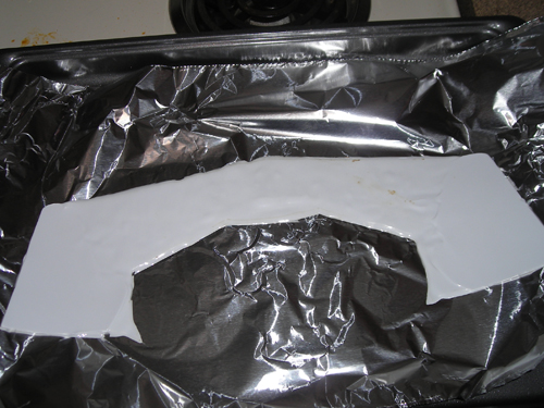

I bent the cod armor with some boiling water, but when i tried that on the collar, I came back today and it had returned to it's orginal shape. So I tried the oven...
But, will have to redo the collar because I stepped away for too long and this happened: :cry
So... lesson learned :lol:
Will have to do the shoulders, collar, and back from another can.
Anyone have a suggested temperature to set the oven to to heat this stuff up? I had it at 350 I think.
