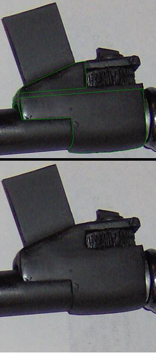

I used that kind of foam to form the upper portion of the grips and part of the sight on my scratchbuilt DDC Defender. I coated it with plain ol' 2 part, quick set, epoxy, sanded it smooth, and filled any low spots with spot putty. The sections outlined in green on the second pic are the parts made out of the foam. It worked out pretty well.
