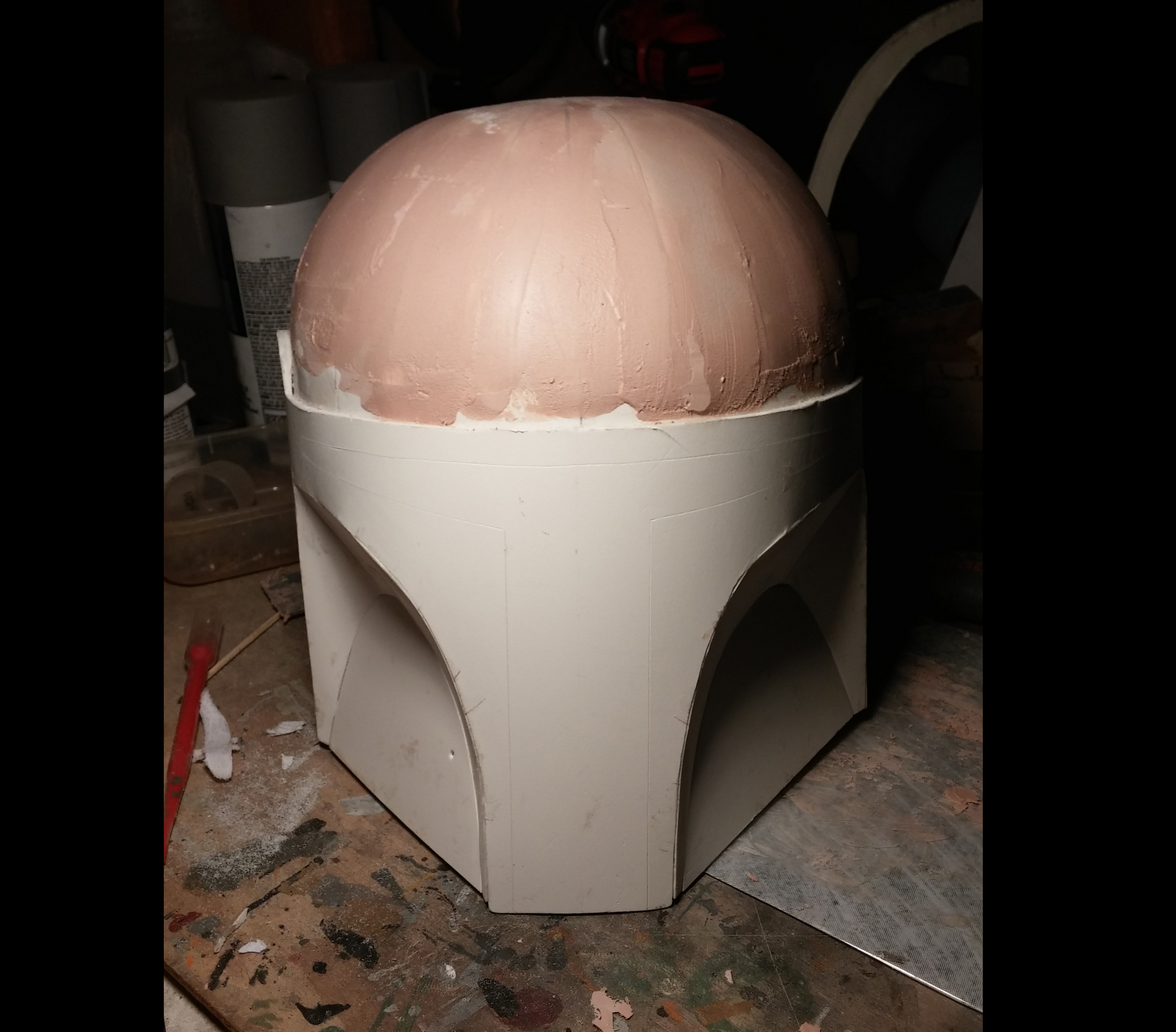

If you're planning to wear the helmet very much, then I would recommend Bondo which is an automotive body filler. It's what most people are using for wearable scratch builds. You could use spackling paste, but its pretty soft and will dent easily. If you go with bondo you will need to buy a good respirator which you will find in most home stores Like Home Depot or Lowes...Bondo fumes are toxic.
You will need to spread the filler in roughly 1/8"/3mm layers...filling in the gaps as you go...sanding in between the layers. You could put on a thick layer and sand that down, but I find this more difficult to control the shape. Just take your time.
It really takes some patience. You are basically sculpting the dome. When you get done it may look a little lopsided or lumpy...just apply some filler to the low spot and sand.

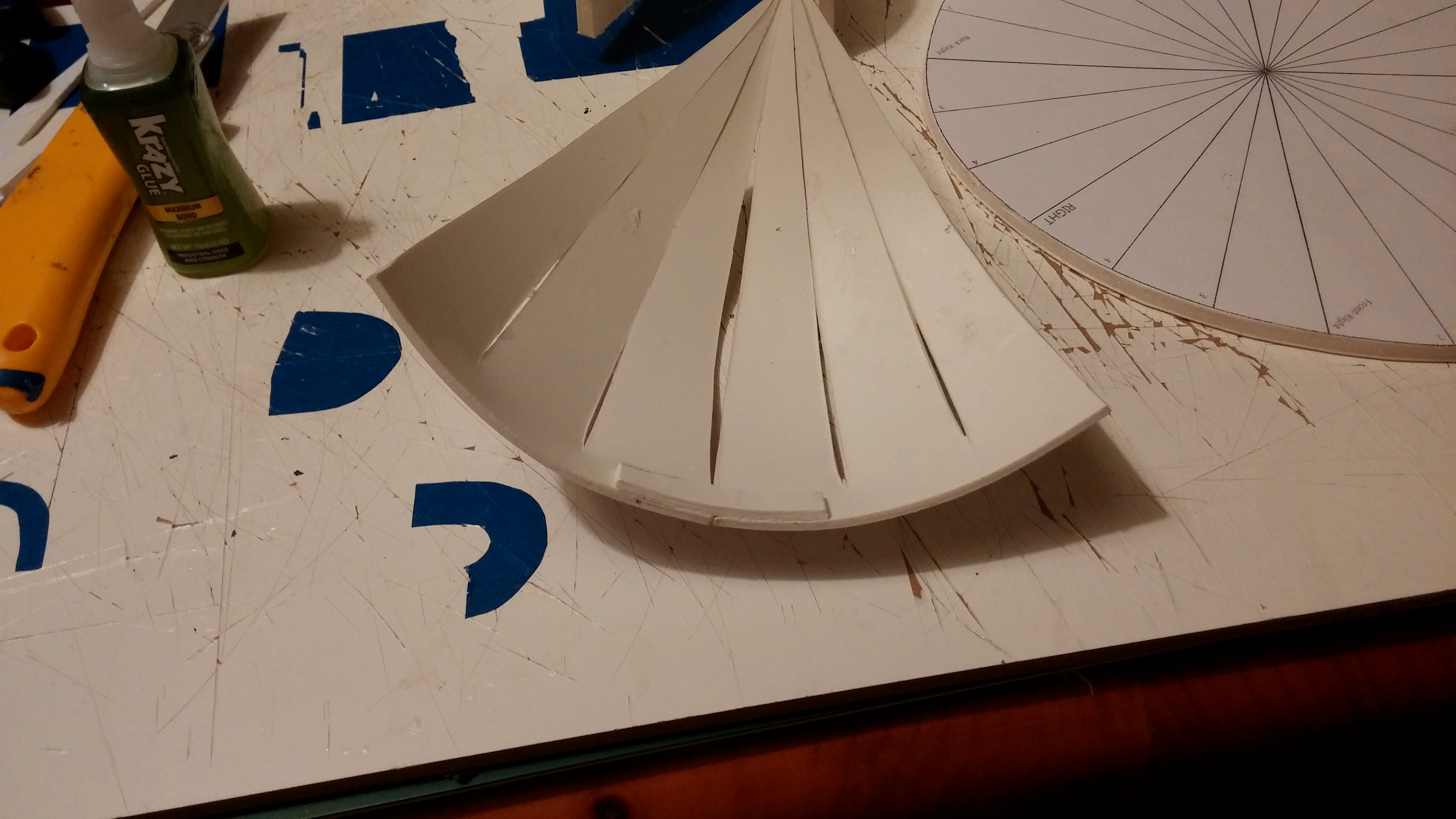

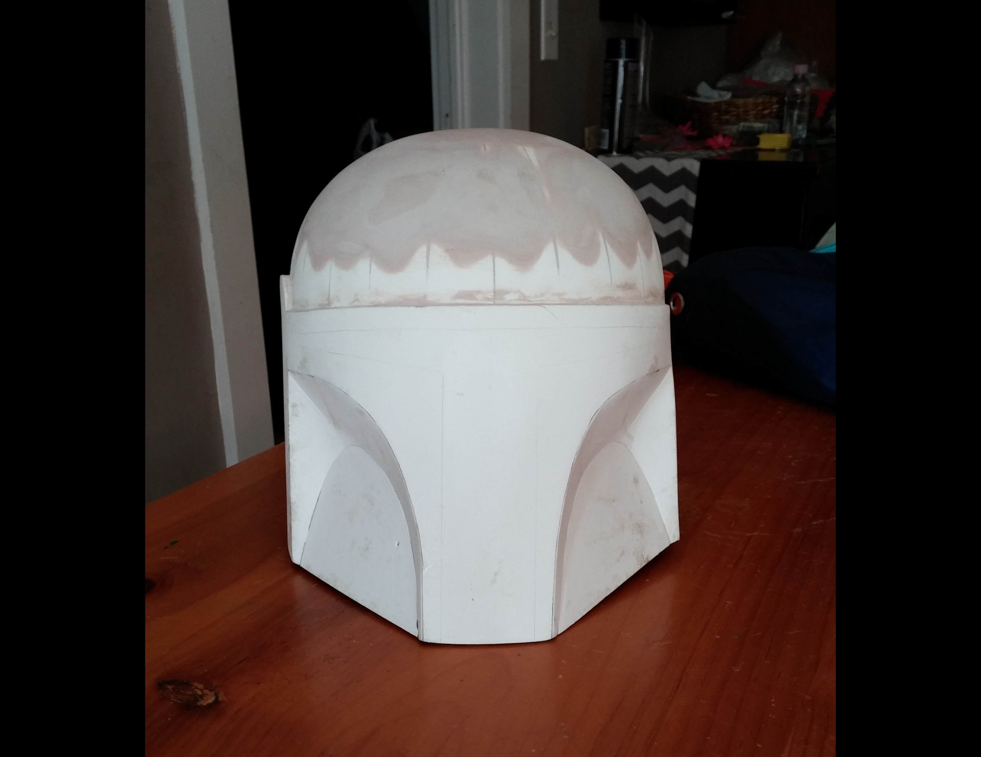

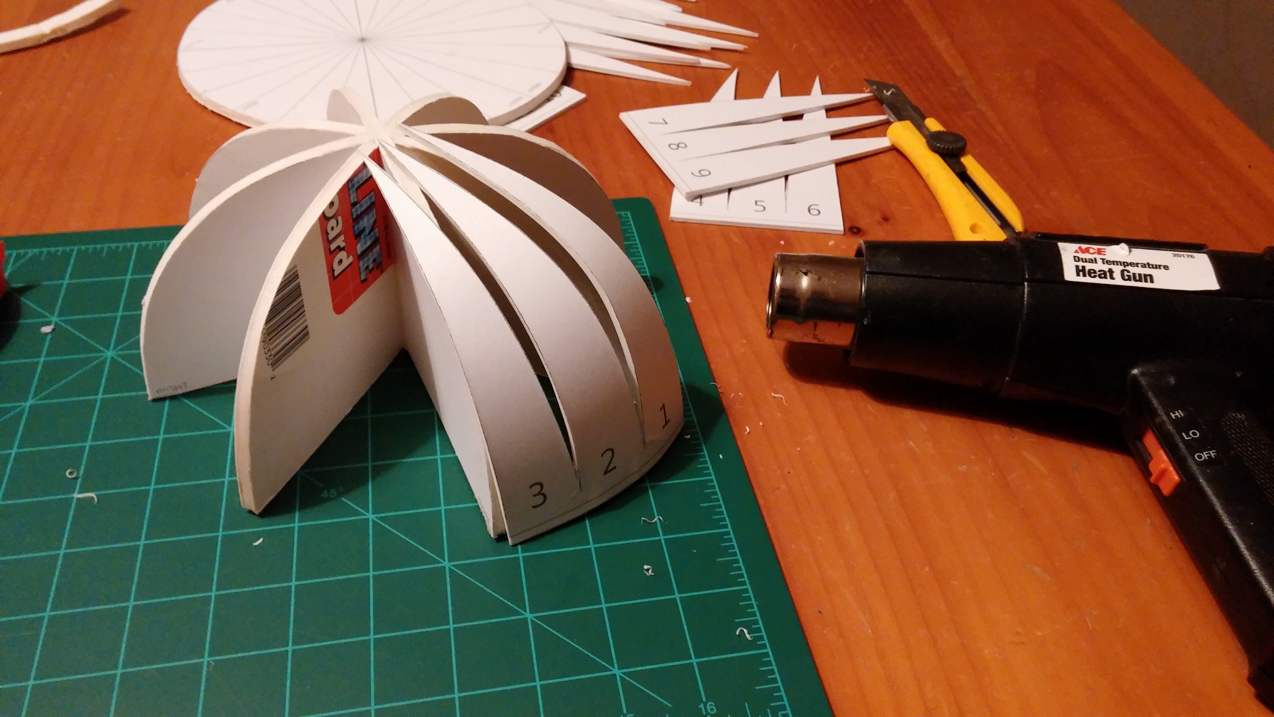

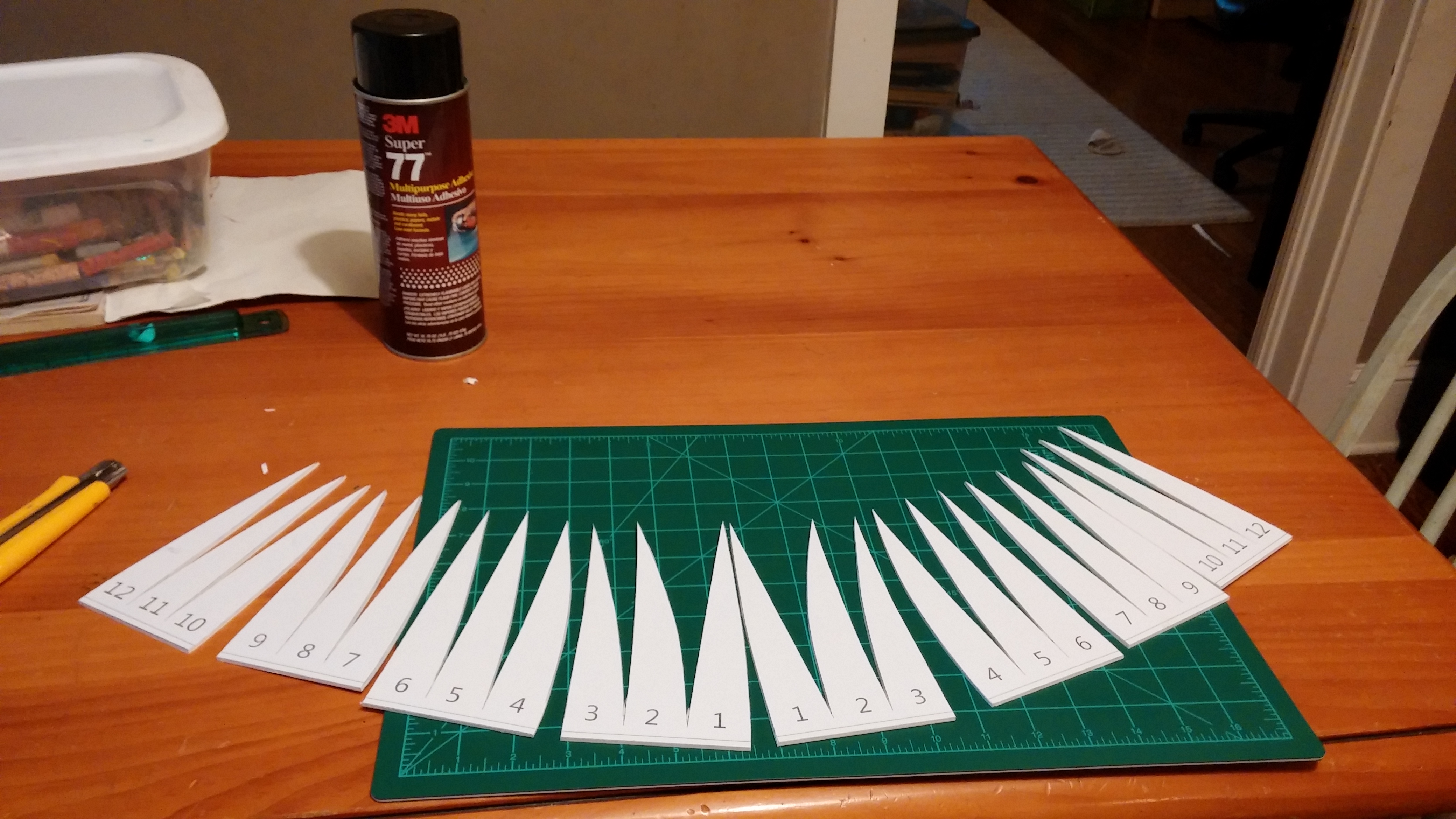

edit...I found some pics of an old sintra build with bondo in the dome.
0721152033.jpg0721152303.jpg0721152151.jpg0725152049.jpg0725152049a.jpg0802151510.jpg
