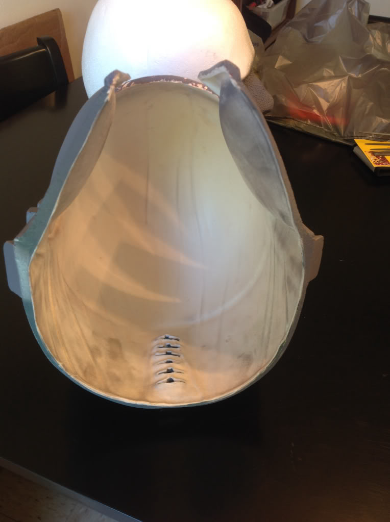

I made some progress with my problem areas yesterday thanks to the addition of diamond cutting wheels to my arsenal. I'm a little leery of heating the helmet up to pull the ears out now that that is done though... I may give it a shot though, I just dipped it in boiling water to get the back of the helmet shape even. Should I go that route again with it? Here are the pics of the keyholes and visor area now (they have not been sanded and smoothed out yet)
Looking better. I would trim up the bottom ring so that there isn't any of that return there. That will help with being able to reshape it without putting stress on other areas. You can use the boiling water if you want but a heat gun will work too.
