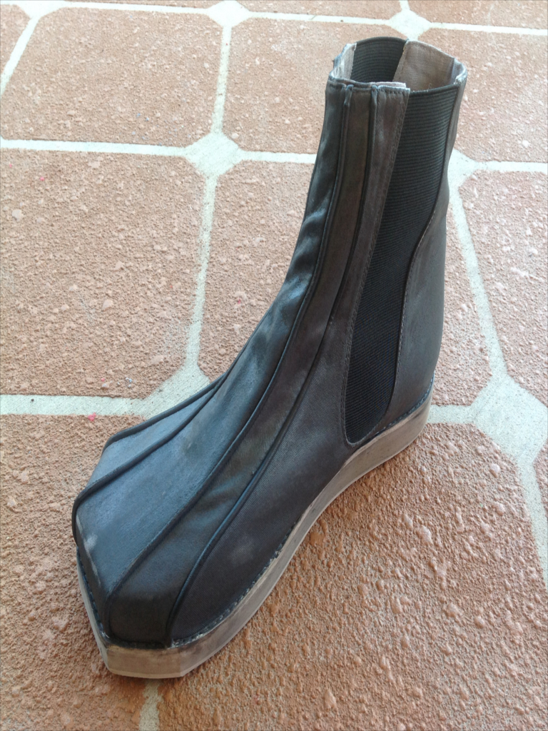

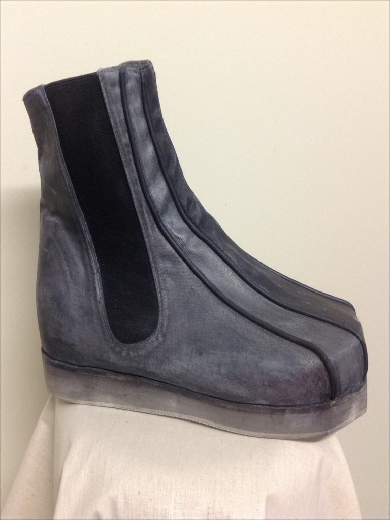

Hi all, just wanted to post a couple of recent photos of my Boba boots. They have been newly painted and weathered but I haven't used a fixative on them as yet in case I needed to do more work on them. I also need to add the toe spikes, which I have yet to purchase. These are MOW boots.

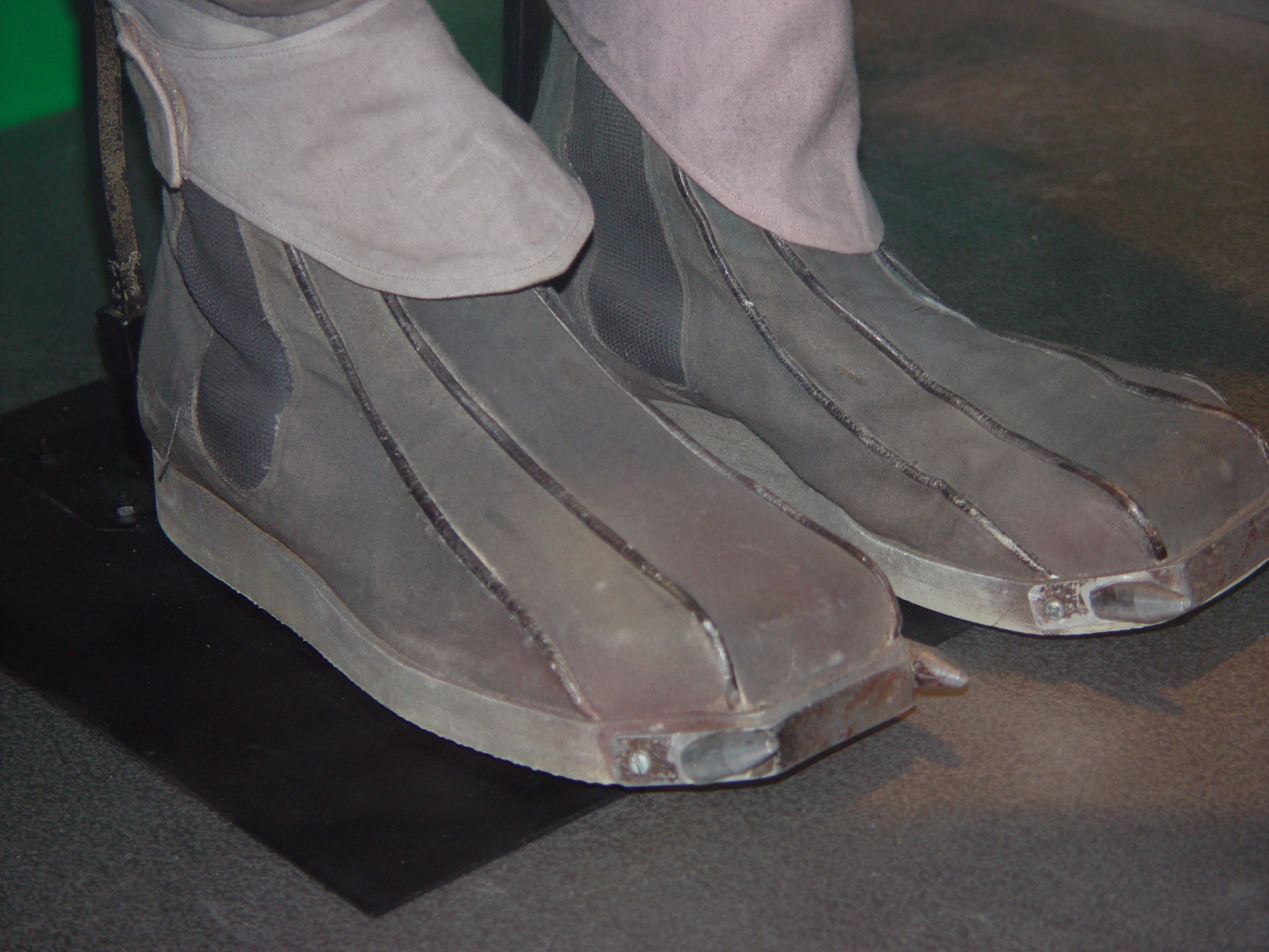

Here is the main reference photo of the ROTJ Hero boots I'm using:
http://www.thedentedhelmet.com/gall...163-boba-fett-return-of-the-jedi-costume.html
Obviously, with such a reference I am leaning towards a darker toned boot. I'd welcome any feedback from those in the know. Cheers, Jason.
Yes, I agree these photos don't show the stripe that well. Might be because the photos were taken out in the Aussie sunshine! But the stripe is indeed there, so much so I've had to debate whether it was too dark...in real life it is quite obvious and in other photos you can see it clearly. It was probably also a little more obvious before I applied the latest dark wash to the main grey sections. I possibly need to upload a close up photo that shows the charcoal stripe better. All about the angles, I guess.
Your stripe is not pronounced enough. It should be visible even with Aussie sunshine, the side stripes were...
Soles are too clean...dirty them some more...
View attachment 88686View attachment 88687
I've decided it's definitely an angle issue rather than a lighting issue. Here is a photo of them inside, crumdum, and I think they look fairly similar to yours, albeit minus the toe spikes. The charcoal stripe is visible in this photo. You might be right about the dirt level on the soles, though, cheers.

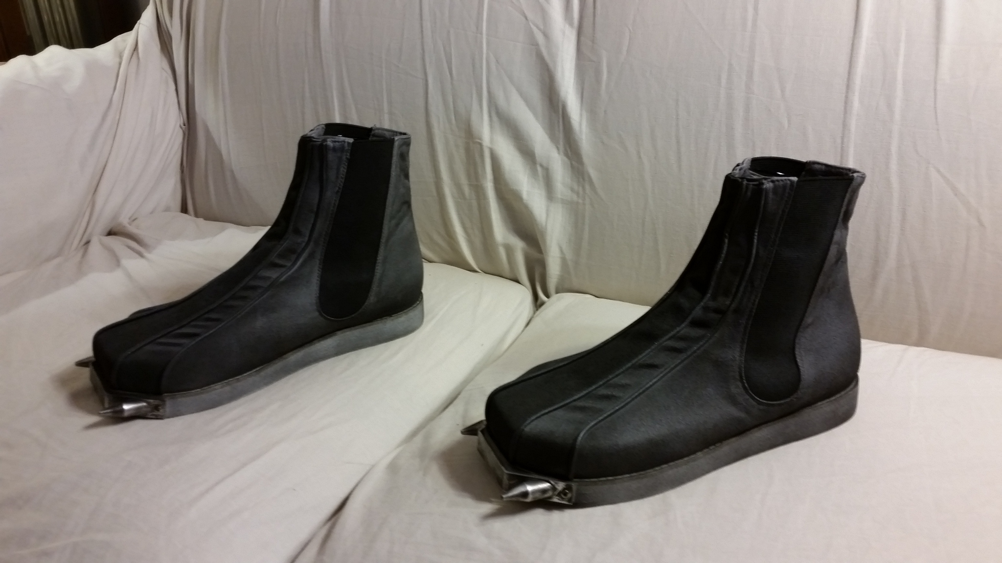

For reference, here are the MOM boots that I was looking at. I took into consideration that the flash brightened the boots a bit:
White chalk is a good start, but go slowly, and rub it off as you apply just so it blends in. I've also used dried clay dust which is more grey. I'll be honest, the airbrushing really did help in the end to get all the little fades.
I think you've got the right look, but maybe just faded out a bit more with an overall grey. If you've already weathered your flight suit, I would take a photo of them next to the dark areas of the shins. Regardless of how dark you make the boots, the colours should somewhat match with that of the bottom of the flight suit.

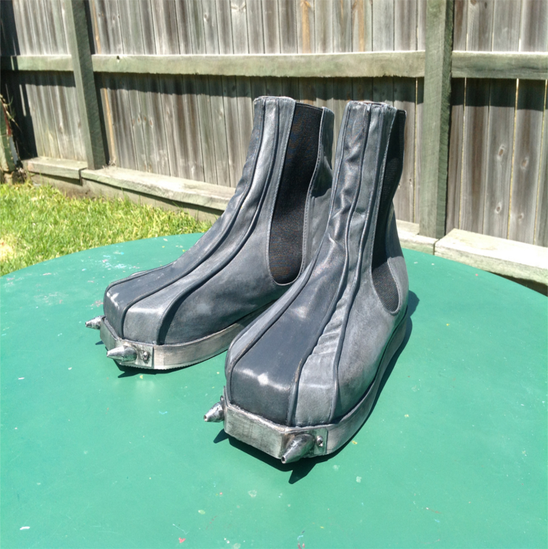

Here are a couple of photos taken today of my boots. In the last week, following some sound feedback, I have lightened them, reapplied the dark wash (which certainly made them look dirty), and then I have worked on highlights (using chalk, charcoal and sandpaper). The ipad photos don't do them any sort of justice but I am far happier with them than I was a week or so ago. In reality, they look dirty and grungy and chalky, all of which has been achieved through layering.
I hope to order my toe spikes this week. I'm really hoping I can very soon move on from these boots.
They look awesome! :) Little tweaks are initially a pain in the ass but when you look back on it later you're glad you did them. Keep it up!

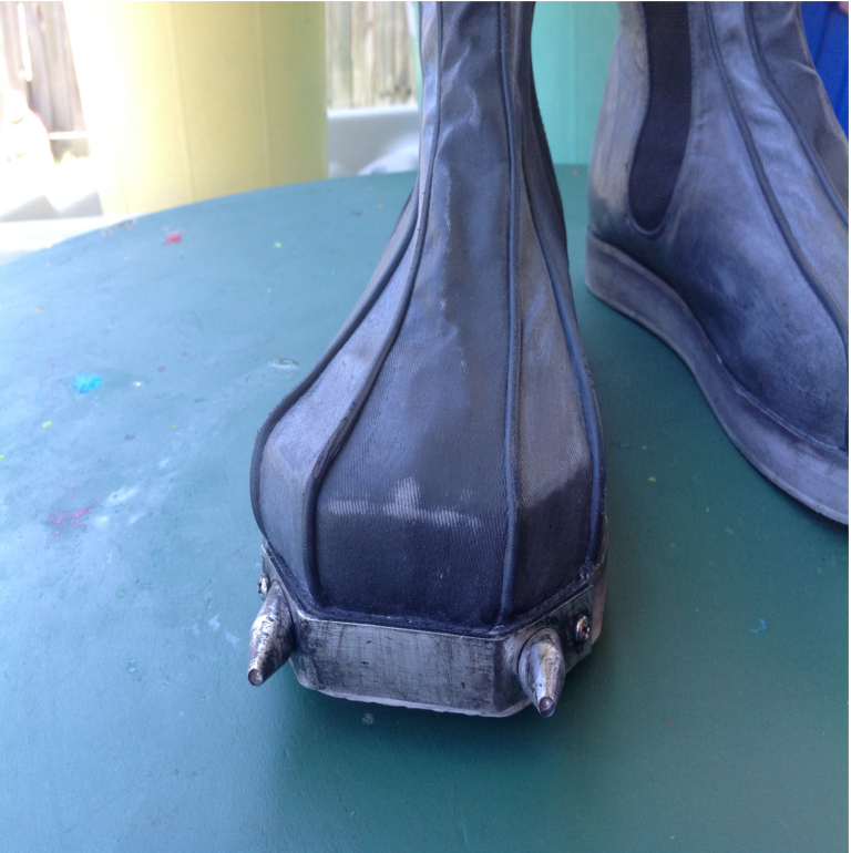

My shiny toe spikes arrived this week from Dakota, so it was time to mess 'em up! A little work with fine sandpaper and some black acrylic paint and they were ready to be attached.
I used 1 inch screws as well as some E6000 on the back of the plate for extra security. I'm pretty happy with how the boots turned out - and I'm certainly glad to be moving on from them!
