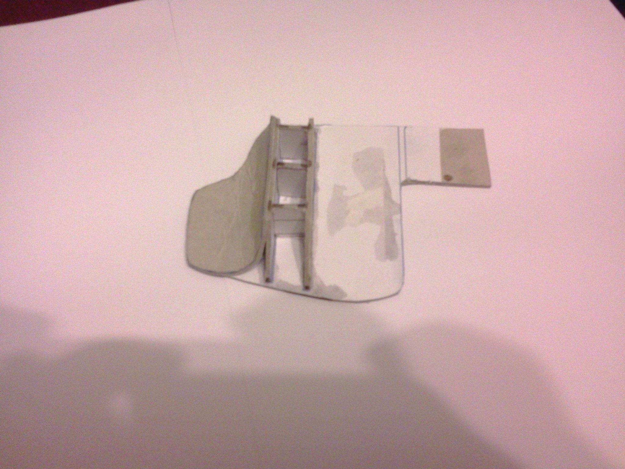

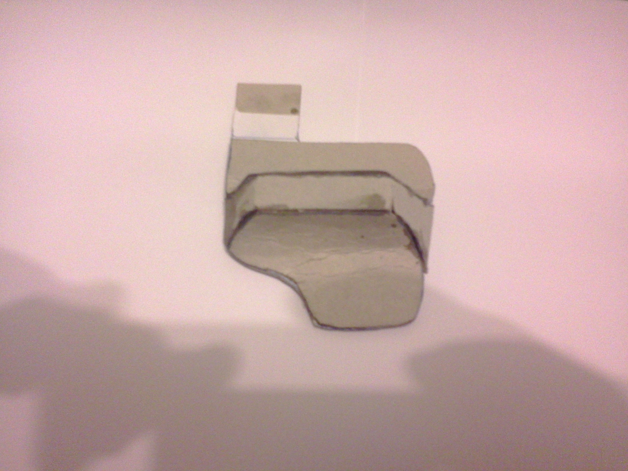

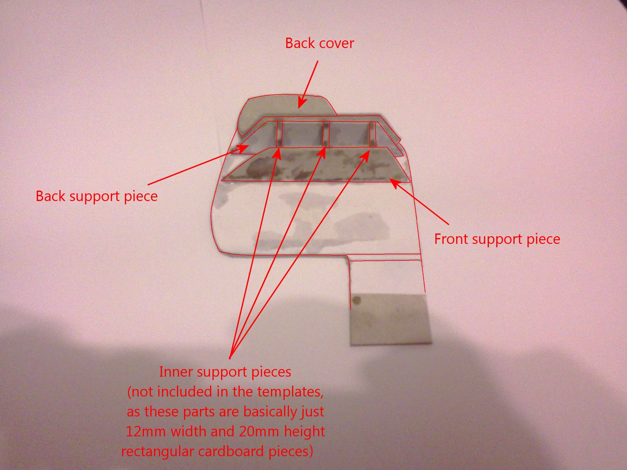

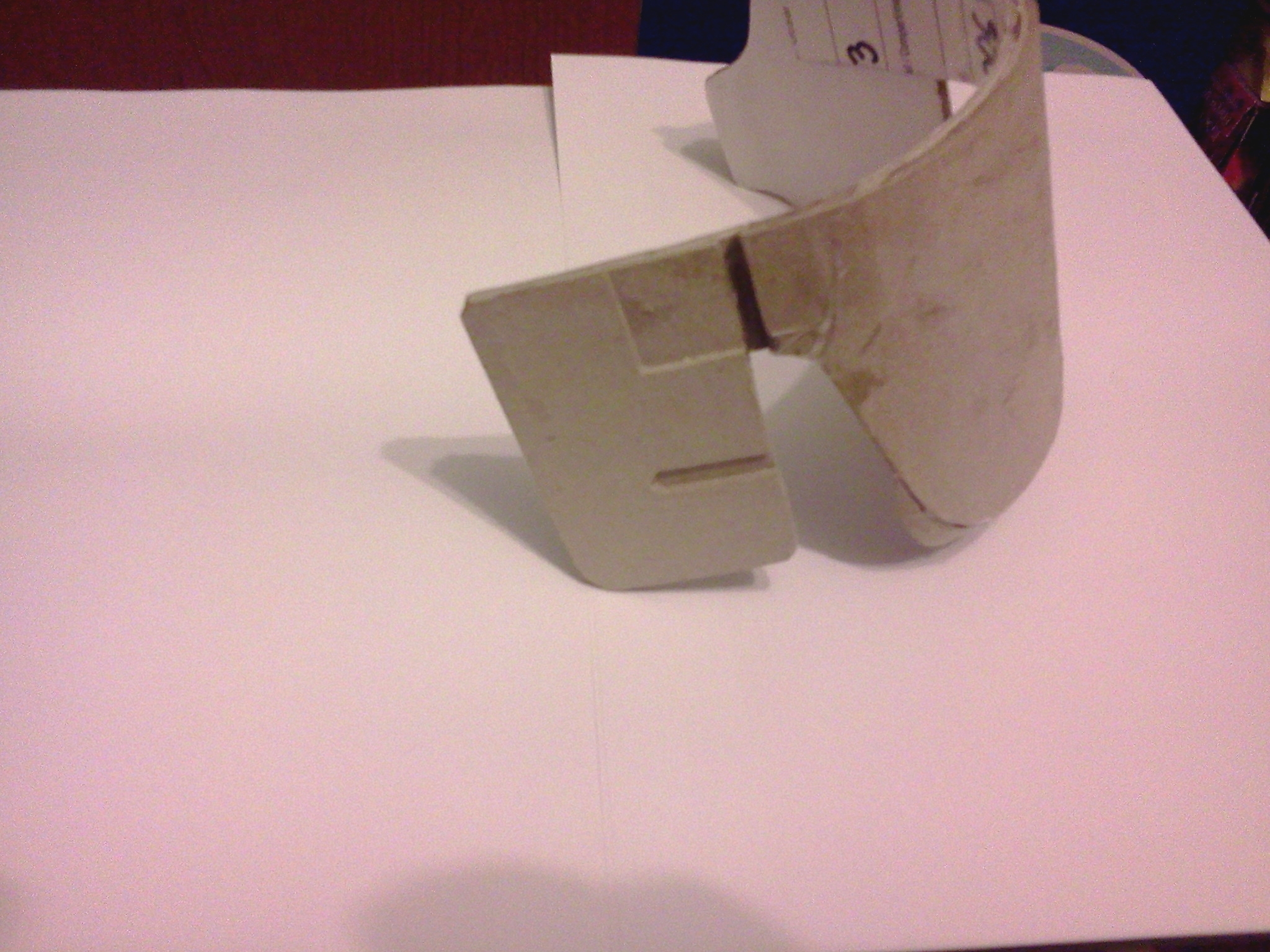

Here are some images with the basic construction of the knee block with the pieces provided by the templates:
As you can see in this image (sorry for the poor drawing) the back cover is above the back support's top edge with about 2mm, and the same goes for the front cover too; this setup will allow the top cover to fit between the front and back covers.

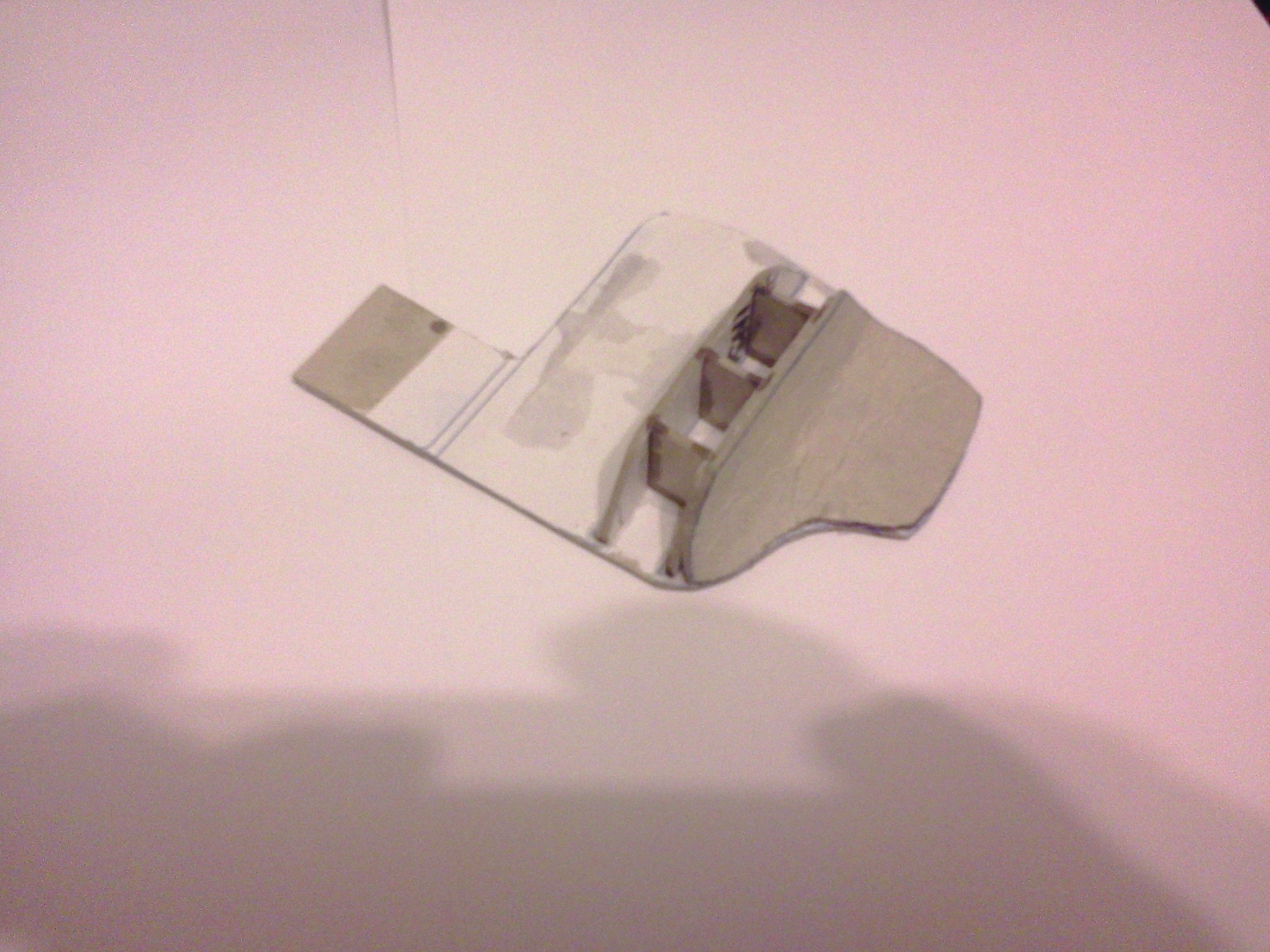

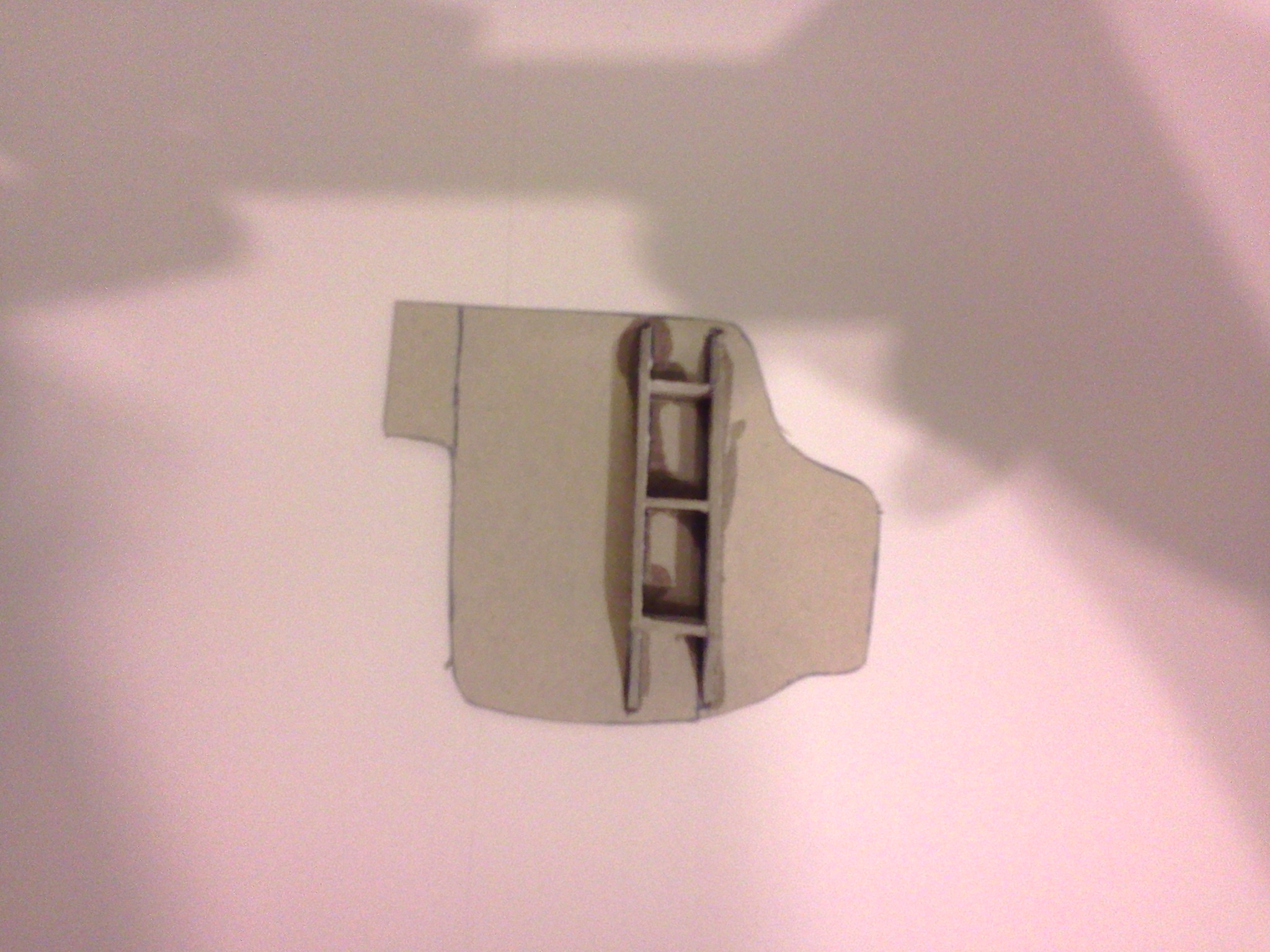

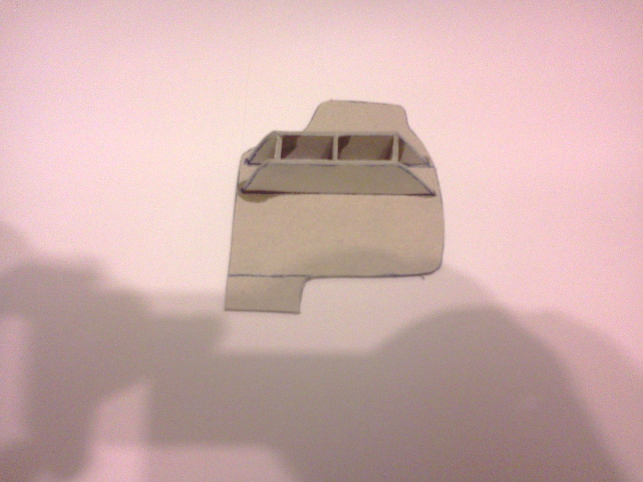

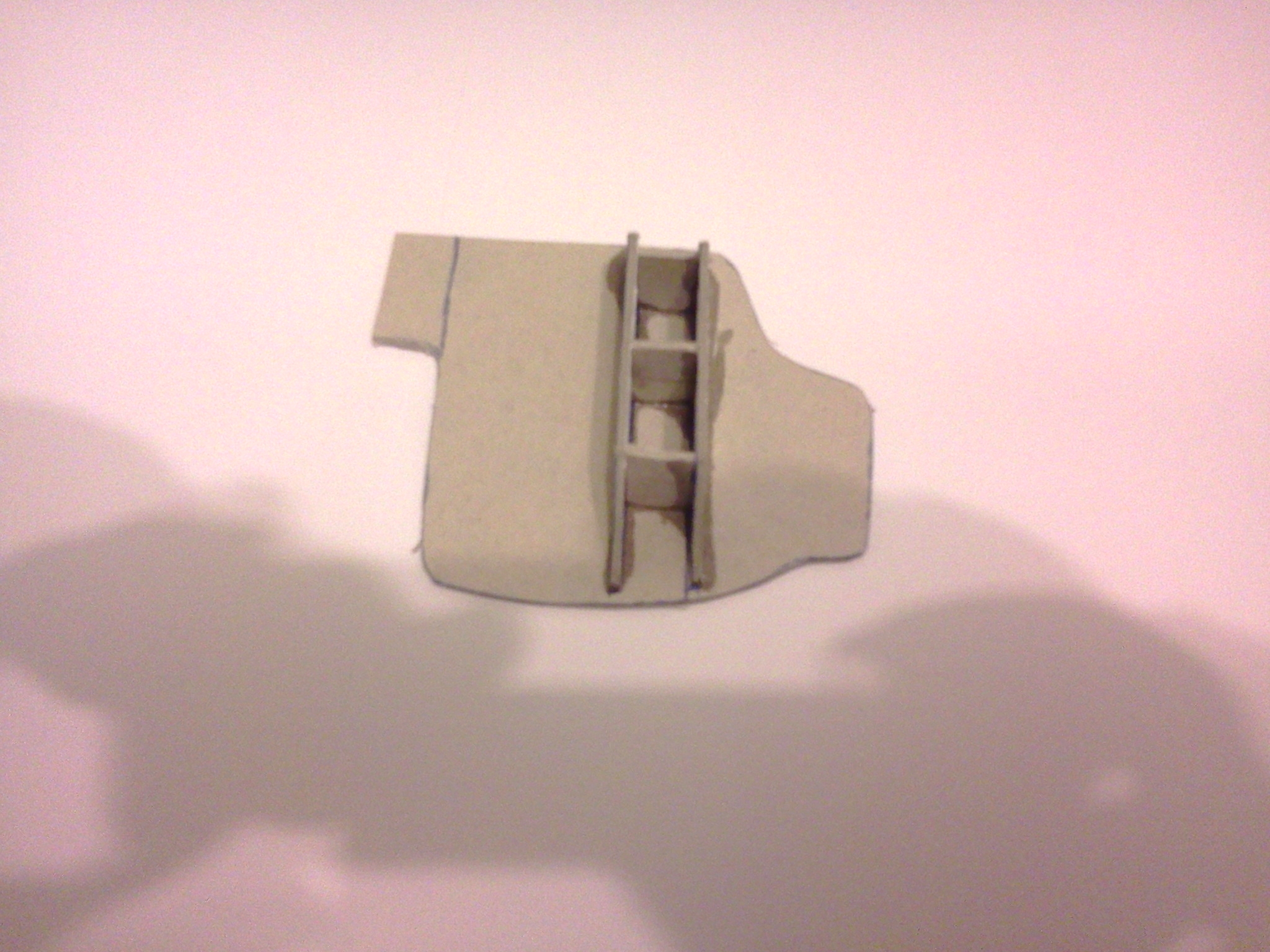

These images shows the front and back support pieces and the 3 inner support parts (from the left knee, as the other images are from the right knee), which are scratch build according to the space between the support pieces (I had a rectangular piece with a 20mm height and a 12mm width):

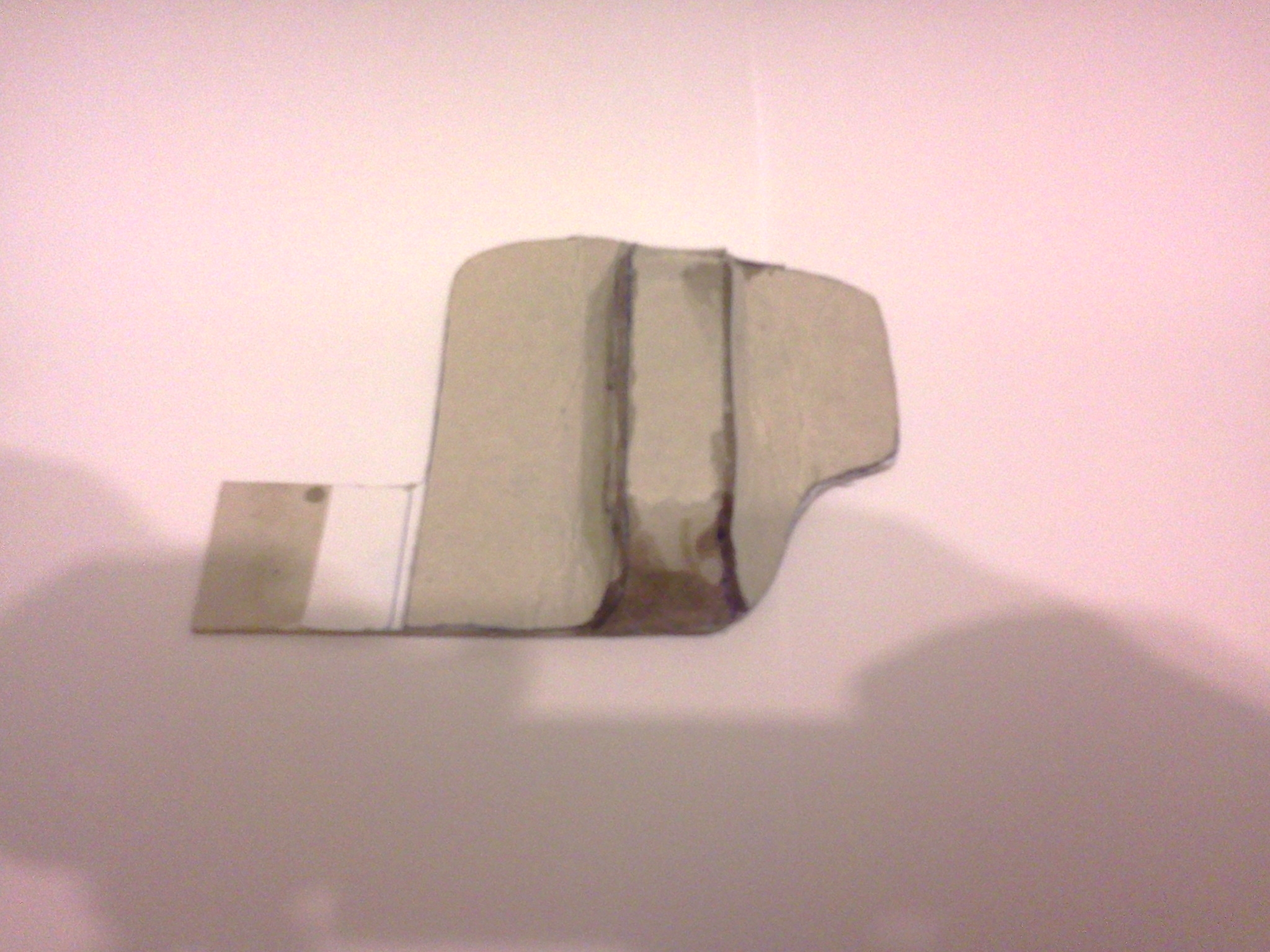

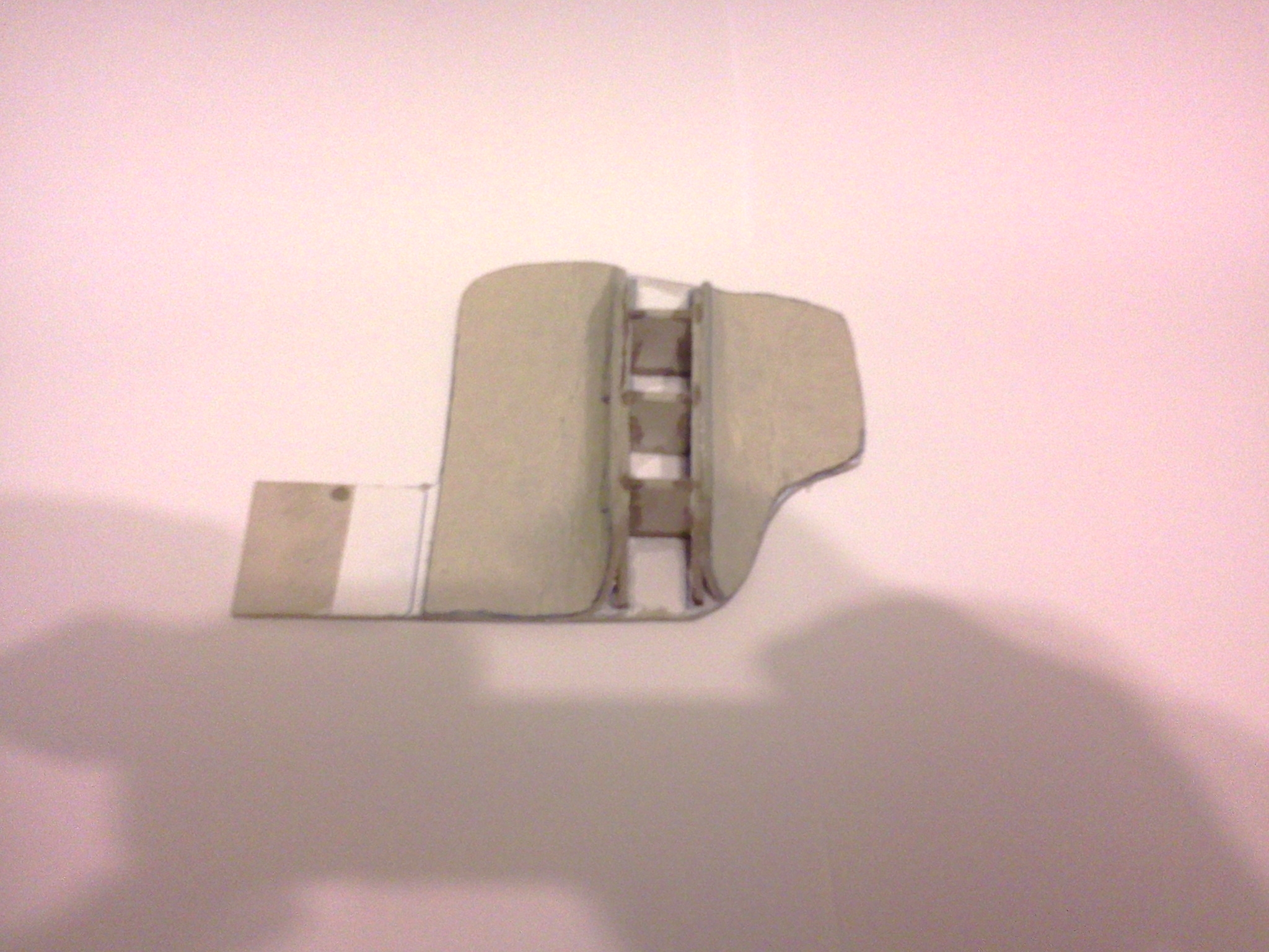

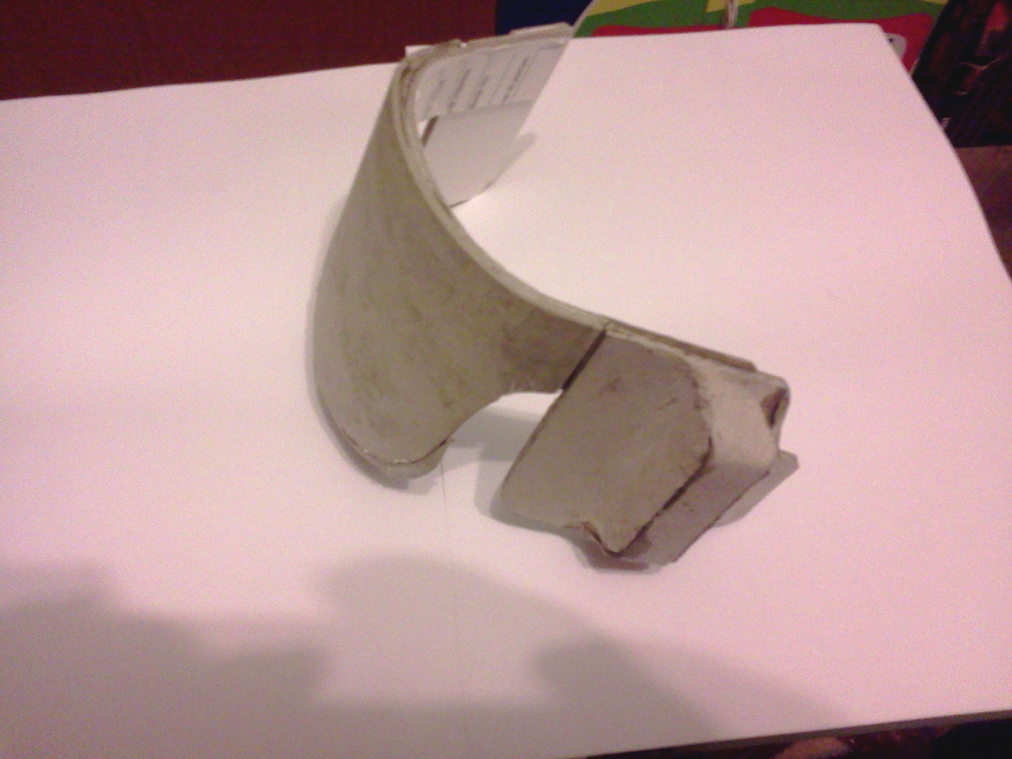

The back cover is already glued to the back cover and the base part:

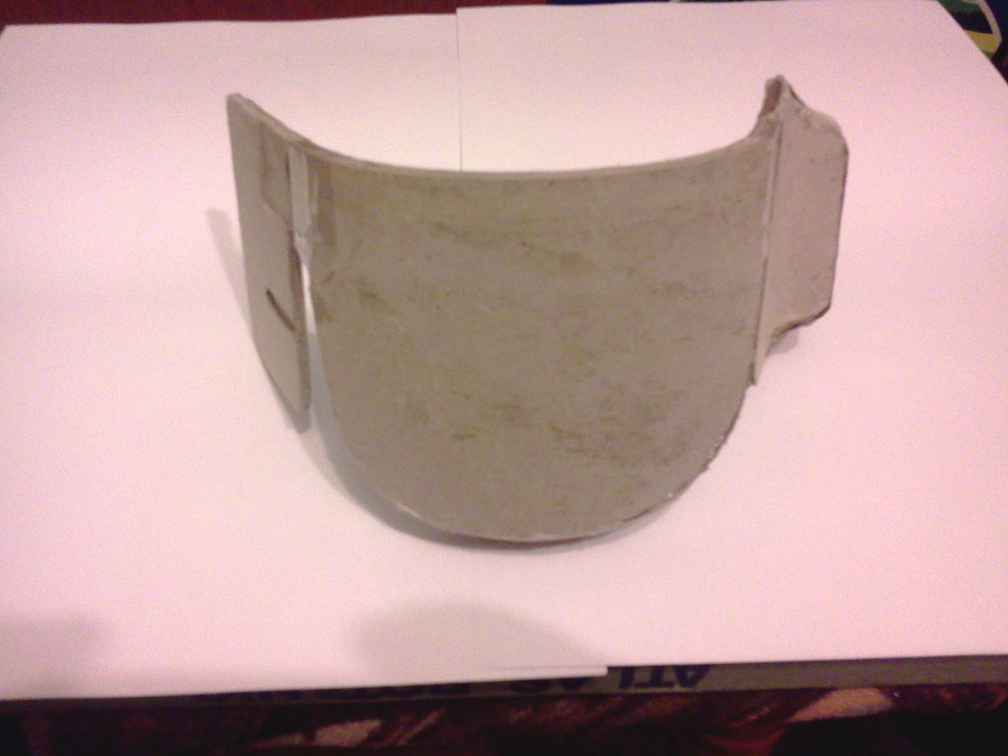

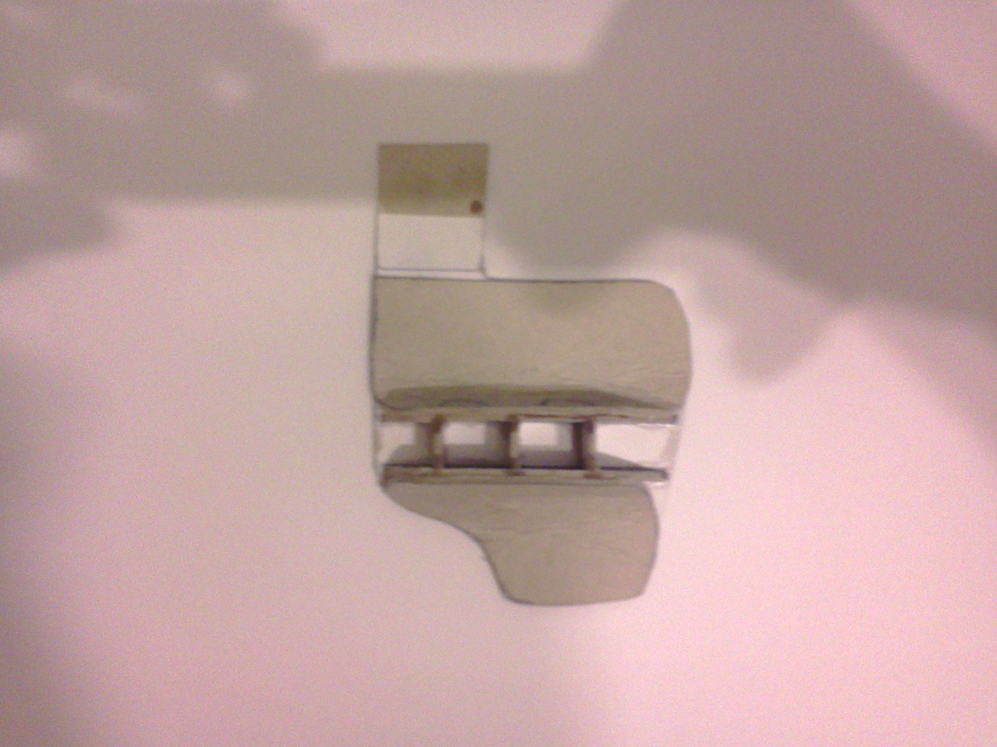

Then we glue the front cover too to the front support piece and the base part:

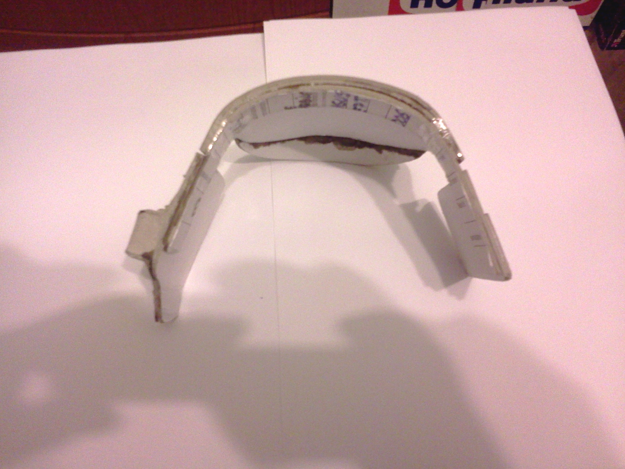

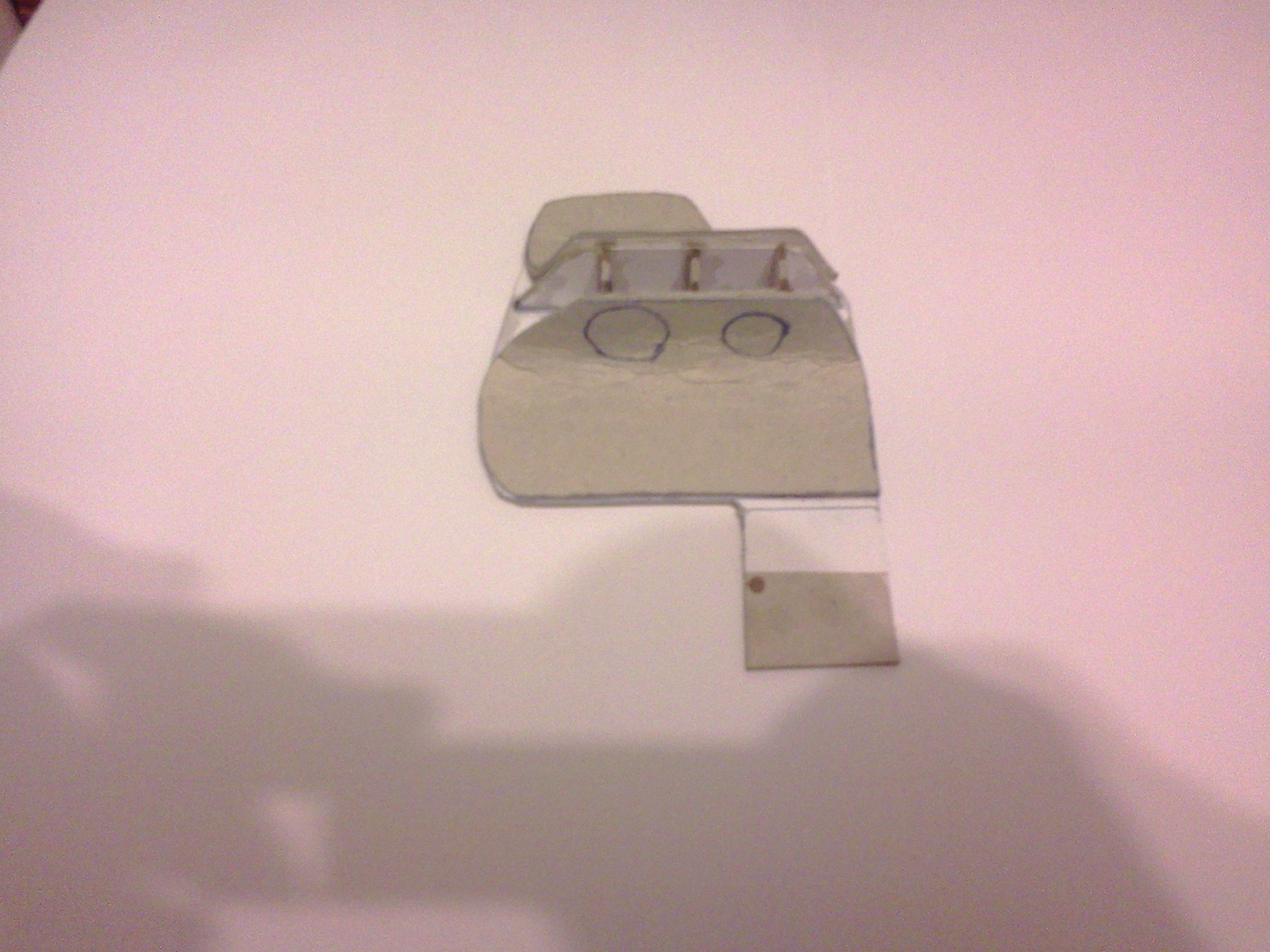

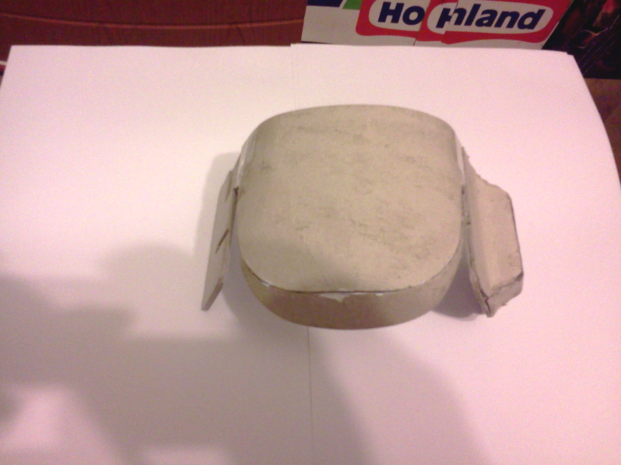

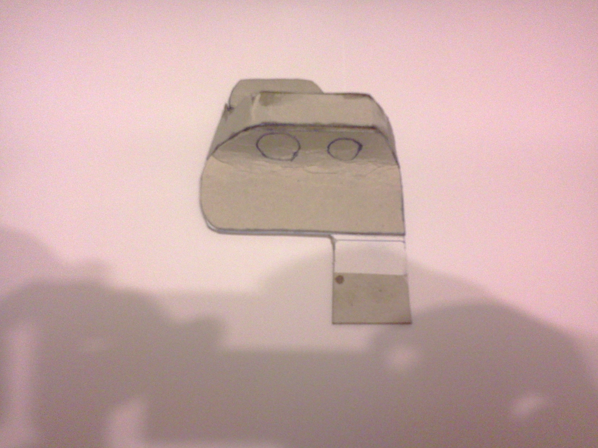

And here is the finished dart block:

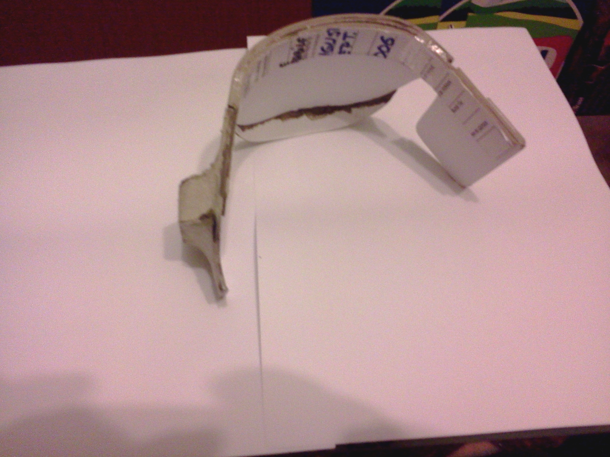

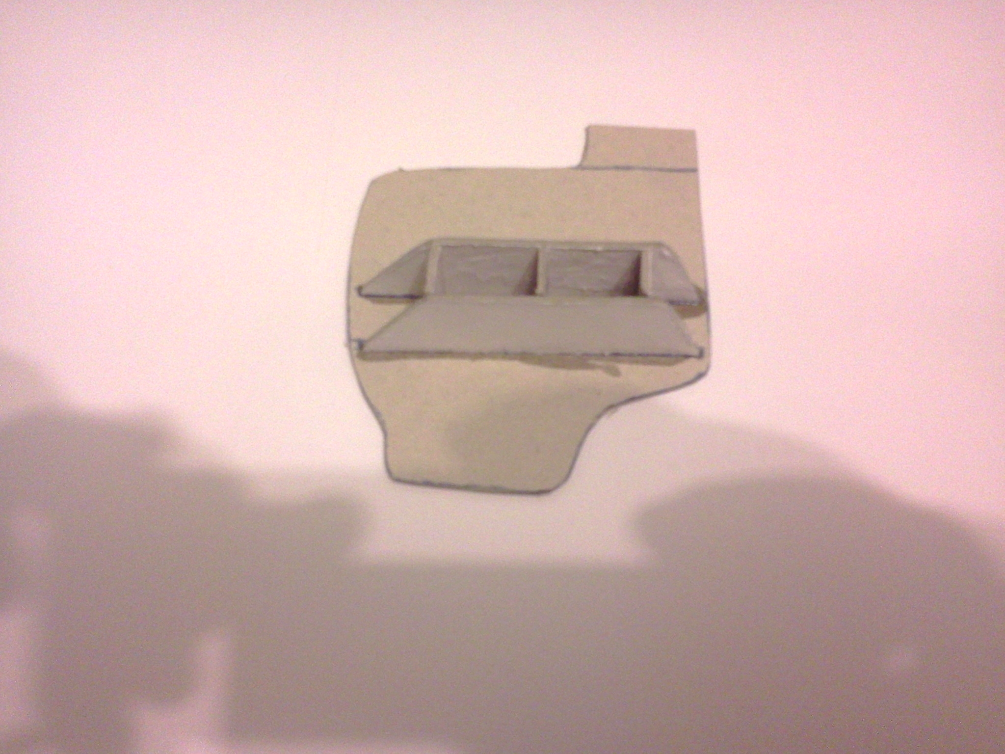

I promised to Will (RKD or redkraytdragon) that I will show him the finished knee... So here it is, Will:
Photo0807.jpg Photo0808.jpg Photo0809.jpg Photo0810.jpg Photo0811.jpg Photo0812.jpg
Because this was made between modifications, the construction is not the correct one, but you'll get the idea.
Have fun!
Very nice work Rafal and thanks for sharing! It looks pretty much how I imagined it would. That's a great approach with the back and front covers being taller than the dart housing support edges, great idea.
Thanks, Will! I had hard times to figure out the best way to construct the dart housing, especially that this part does not have sharp edges, so an easy method was out of my plans, but I'm happy with the end result. My only concern now is the possibility to carve out the inner parts of the housing and adding the holes for the darts. I think I will leave this task (at the moment) to the builders...
