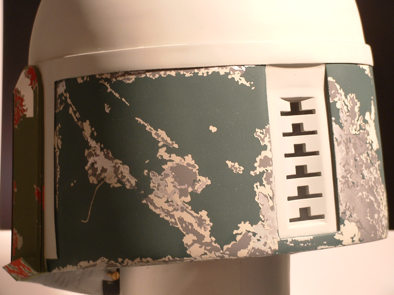

Splendid work m'man. While I don't have the snazzy tooth picky tool, its exactly the way i go about it - mask the outline (I go with standard toothpicks), then fill in the blanks with cheap throwaway brushes (I buy a cheap pack of 10 or so for like $3). Yes, it is time consuming, and yes, it can take more than one session per layer - but it really is worth it, and G - you demonstrate that here absolutely beautifully. Top notch as always :)
Next layer added, hopefully the green layer will tie all the detail together...

Finally added the green on the back panels, what a relief...;)
Still a few more details to add within the silver damage on the right hand panel, however...:facepalm

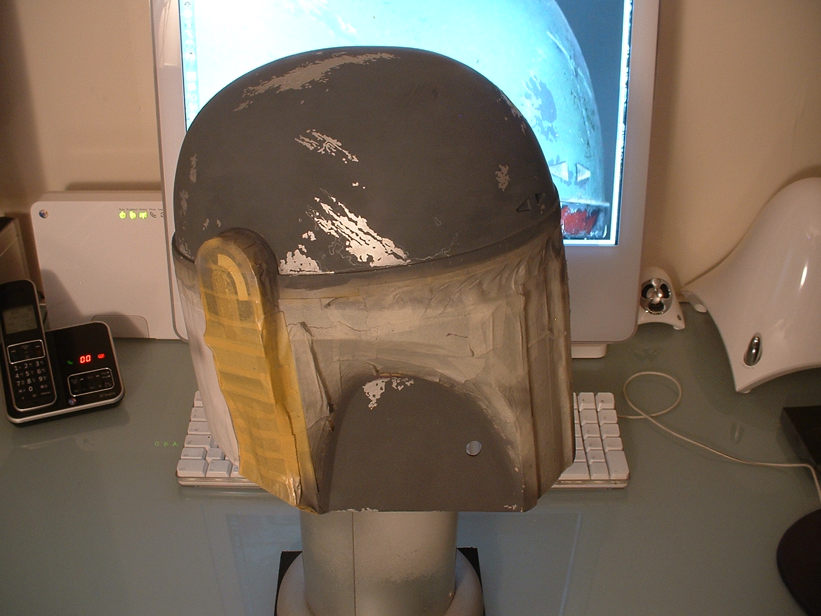

Finally got around to applying the mid grey on the dome and lower cheeks. Spent far too long masking the base grey and silver damage, oh well. On this helmet I'm using Rafalfett's templates as well as reference shots, this really helps scaling and positioning but also means much more detail...
This grey is a new colour I'm using, i finally settled on a tone that works on the rear panels, dome and cheeks and the mandibles and trim. Previously I've used a darker grey for the dome and cheeks, this grey appears to work well to achieve the desired contrast with its adjacent colours, this should make sense later in the paint up...
I need to revisit the dent and other areas to add the fine detail grey within the silver, its easier to manage as a separate masking layer...
