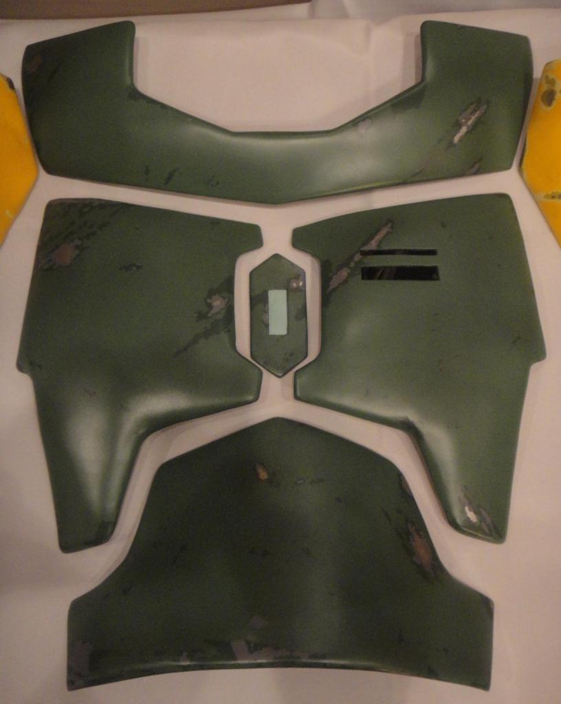

But in general I prefer airbrush acrylics. Easy to work with, easy to clean up, and (partway through weathering) here's what they look like on my Boba-based custom:
--Jonah

I went with mostly the Rogue Studios color list. Mostly. Since my armor is actually stainless steel, I used zinc chromate aircraft metal primer for the base layer on the shoulders. The mid-layer is ATSF Catwhisker Yellow (the pale color), and the top coat is the Reefer Yellow that gets oranger the more one applies.
That primer really is exactly the same color as my Testors yellow zinc chromate paint, and so close as to be almost indistinguishable from my botle of UP Armor Yellow. From looking at the original, the darker yellow on the shoulders and knees is for the deepest weathering that doesn't get bare metal. And yes I know my armor's still pretty bright -- I'm only partway through the weathering and haven't dulled down the shoulders yet. I'm going to do those same time as the knees, which aren't ready yet.
I also took my old bottles of US Med Green and Panzer Olive Green in to my hobby shop and compared to current offerings. I think I can get to my paints tomorrow, and I'll post up pics of the comparison.
And I probably should have mentioned in my post above, that rather than two shades of green for helmet and armor, I used the US Med Green equivalent as a mid-coat over he gray primer, and then the Panzer Olivgrun as the top coat, so helmet and armor will match. As I said -- Boba-inspired, but more consistent. So in that picture, the "US Med Green" analogue is the darker green you can see around the scratches.
--Jonah
