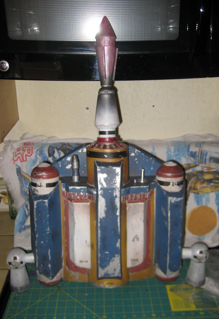

So i was hoping to convert this ROTJ Jetpack I picked up from METALLBOY some time back. METALLBOY did a great job with the build and paint but it did look a bit beat-up, but that in my opinion is what made it look so cool / battle worn. i was hoping color match some ROTJ scratches then apply PP2 damage, marks and weathering. OK here's how it came down.

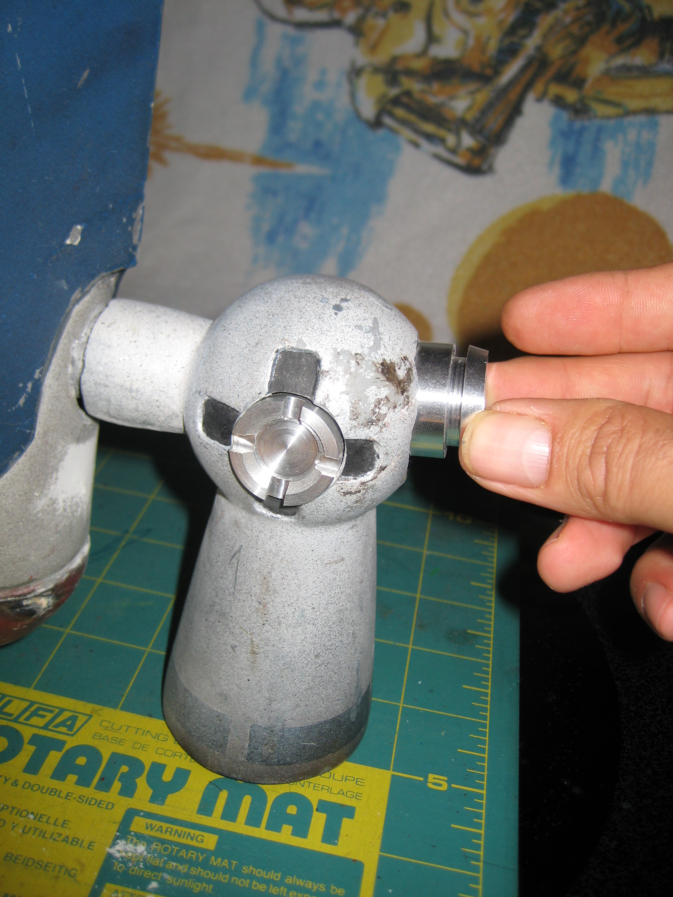

I added some real found parts.

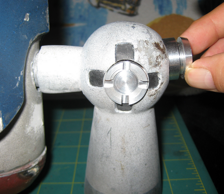

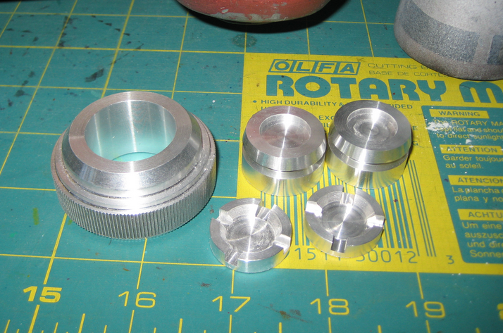

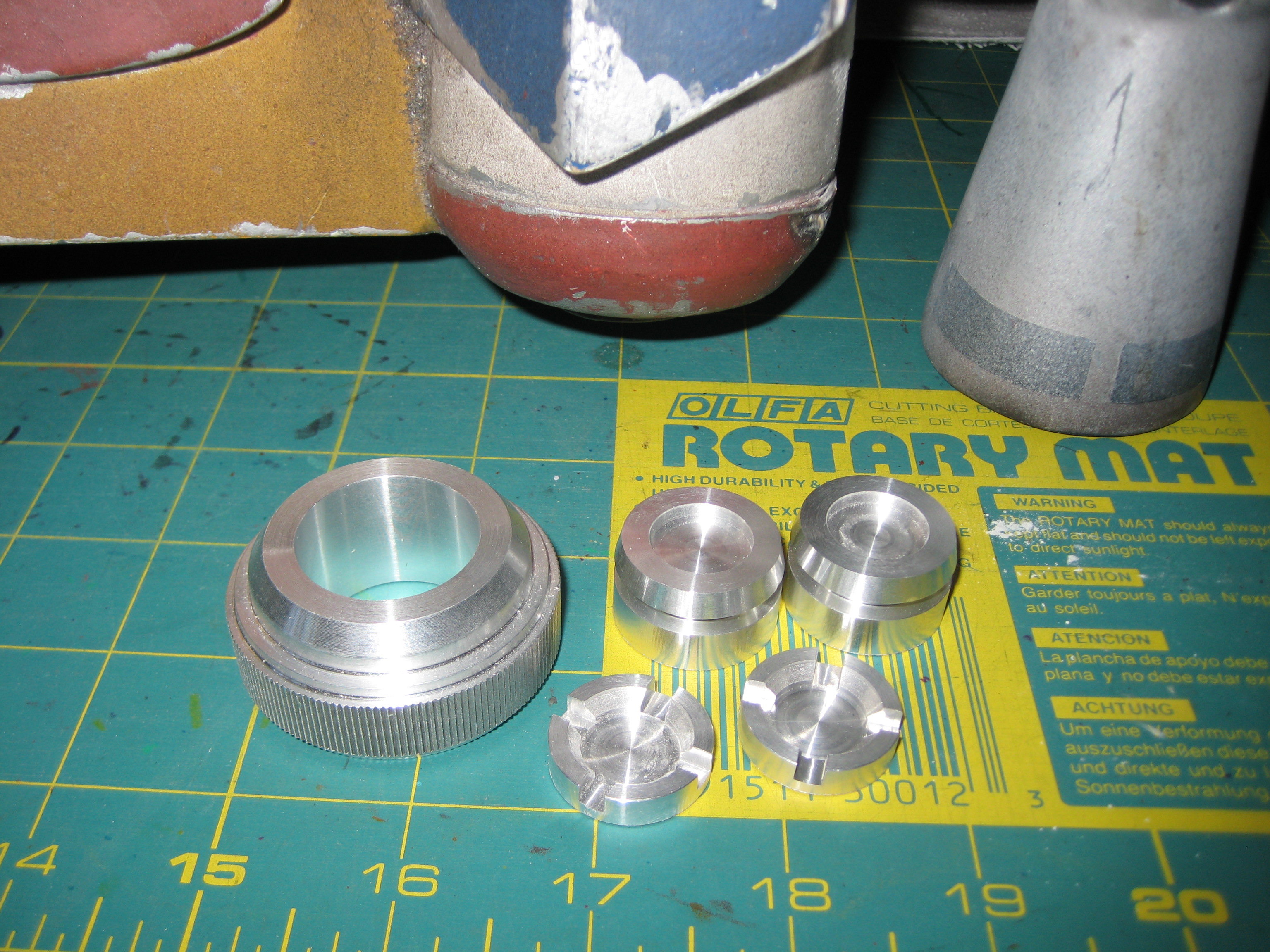

Here's my DARKSIDE aluminum parts:)

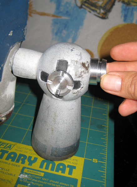

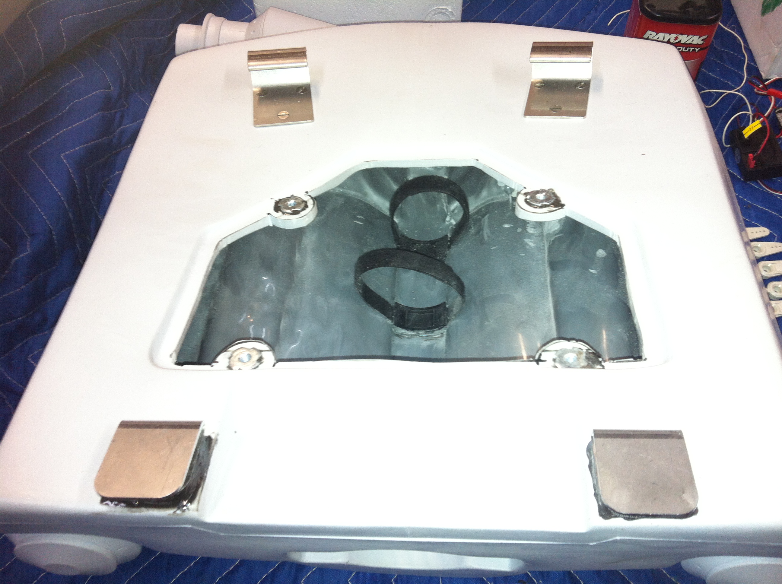

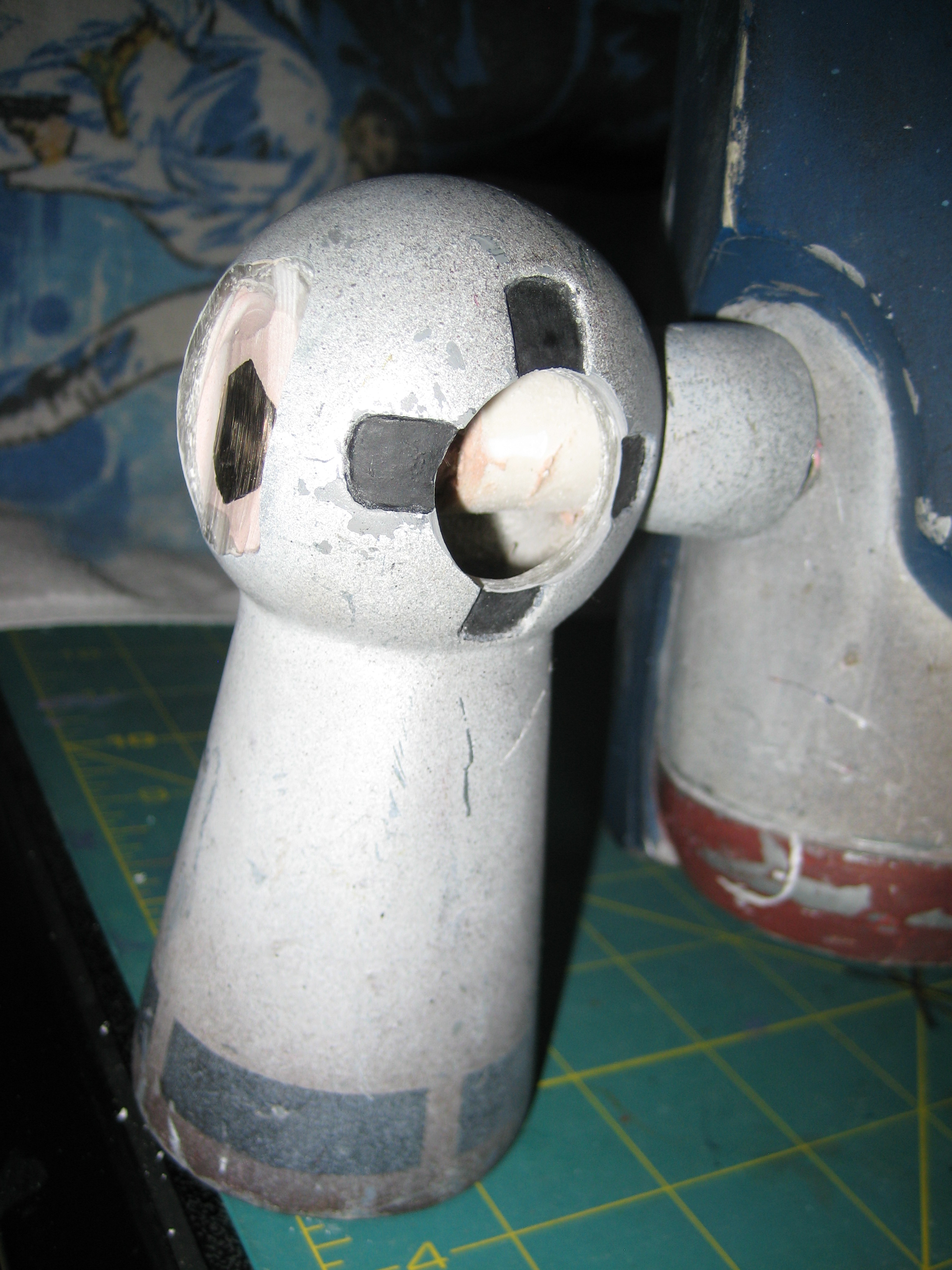

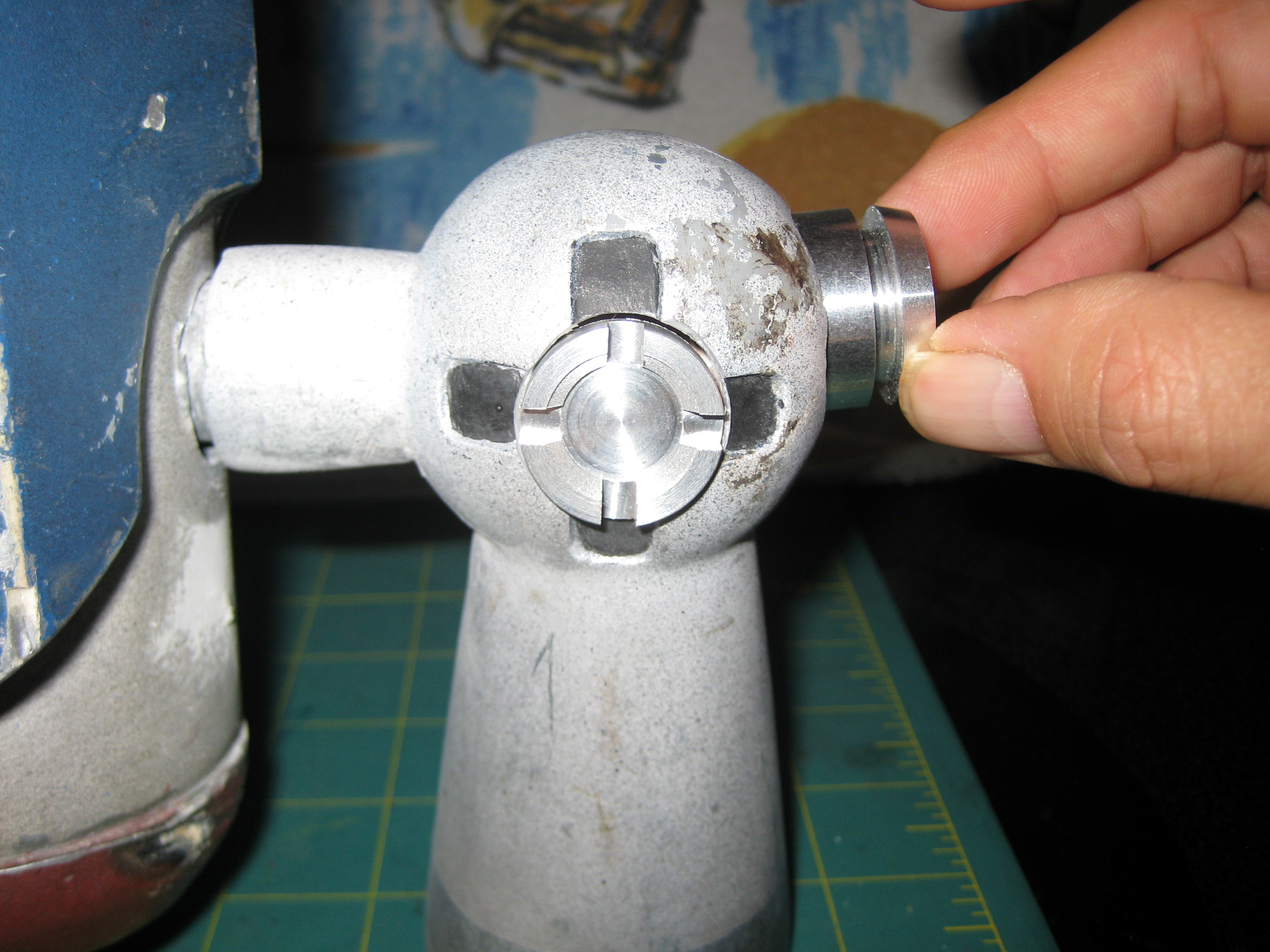

I cut out room for the milled aluminum parts

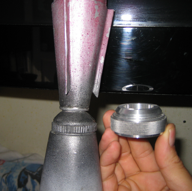

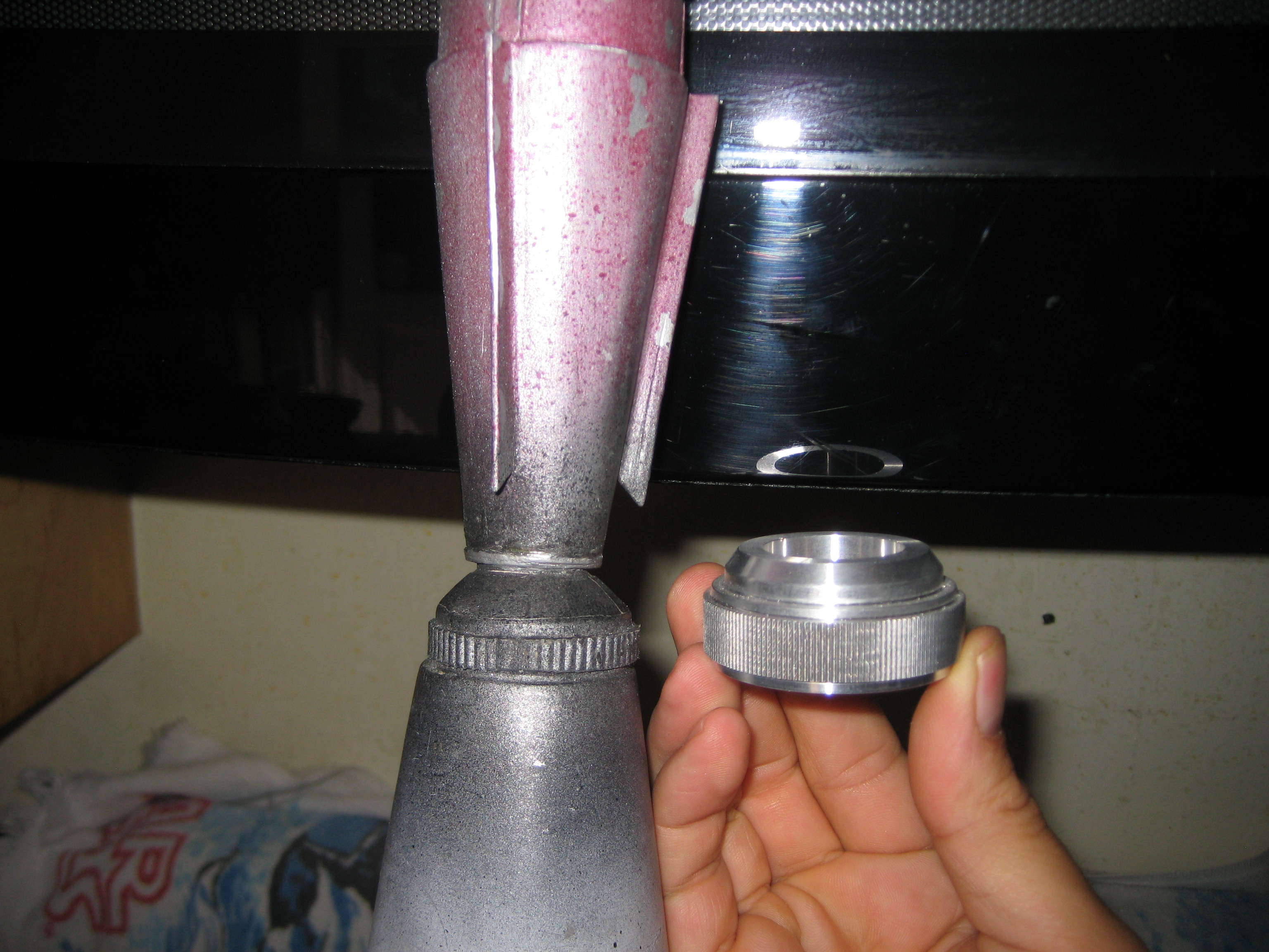

Here's where i realized i couldn't use this pack anymore:(
My cool *** DARKSIDE collar wasn't going to work with this jetpack D'oh! if i cut the rocket down a bit it just wouldn't look right.
OK looks like I'll need a MOW JP kit for my build after all. I'm going to save the above jetpack for a custom Mandalorian build. Back on the wall she goes.

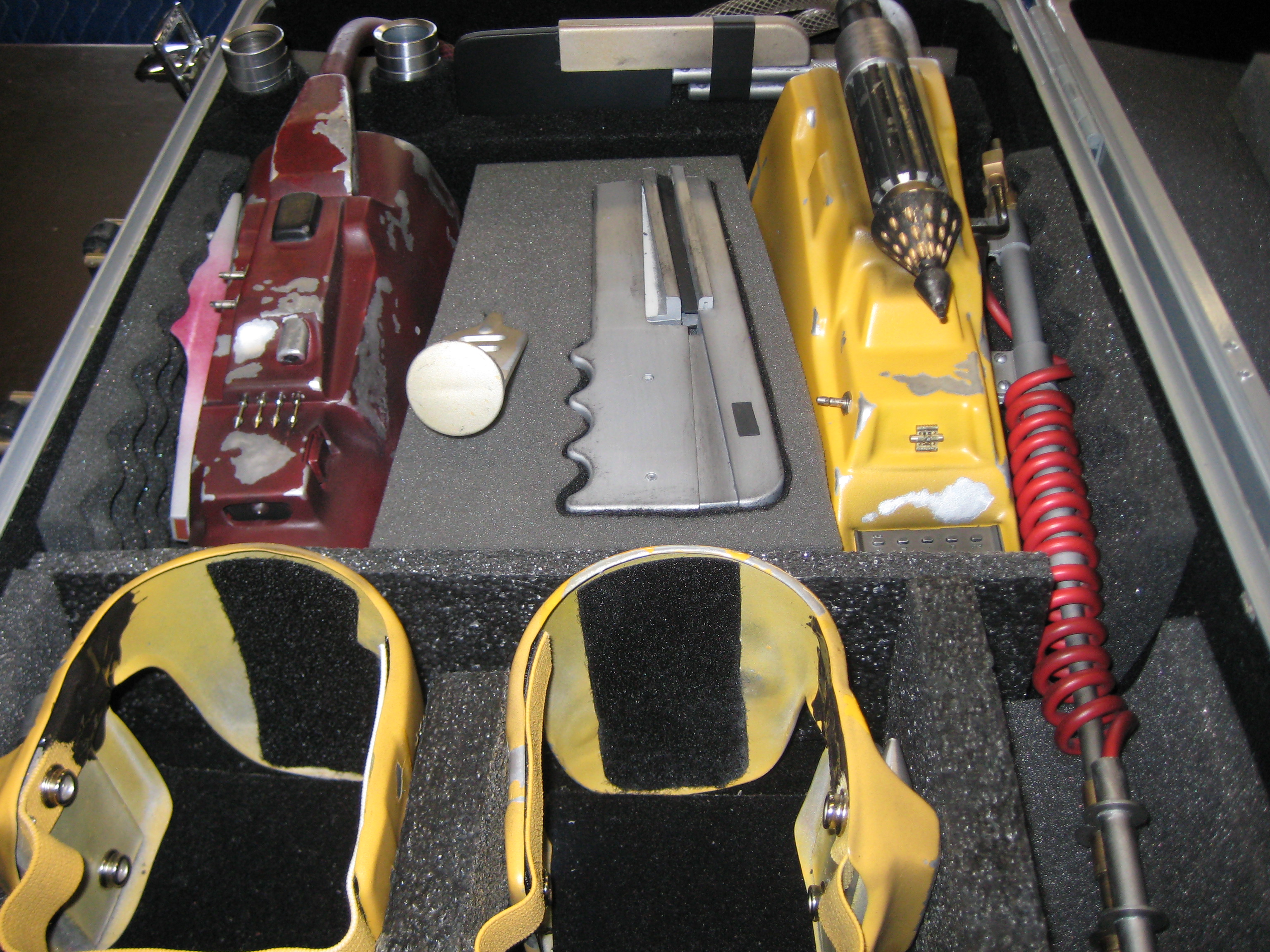

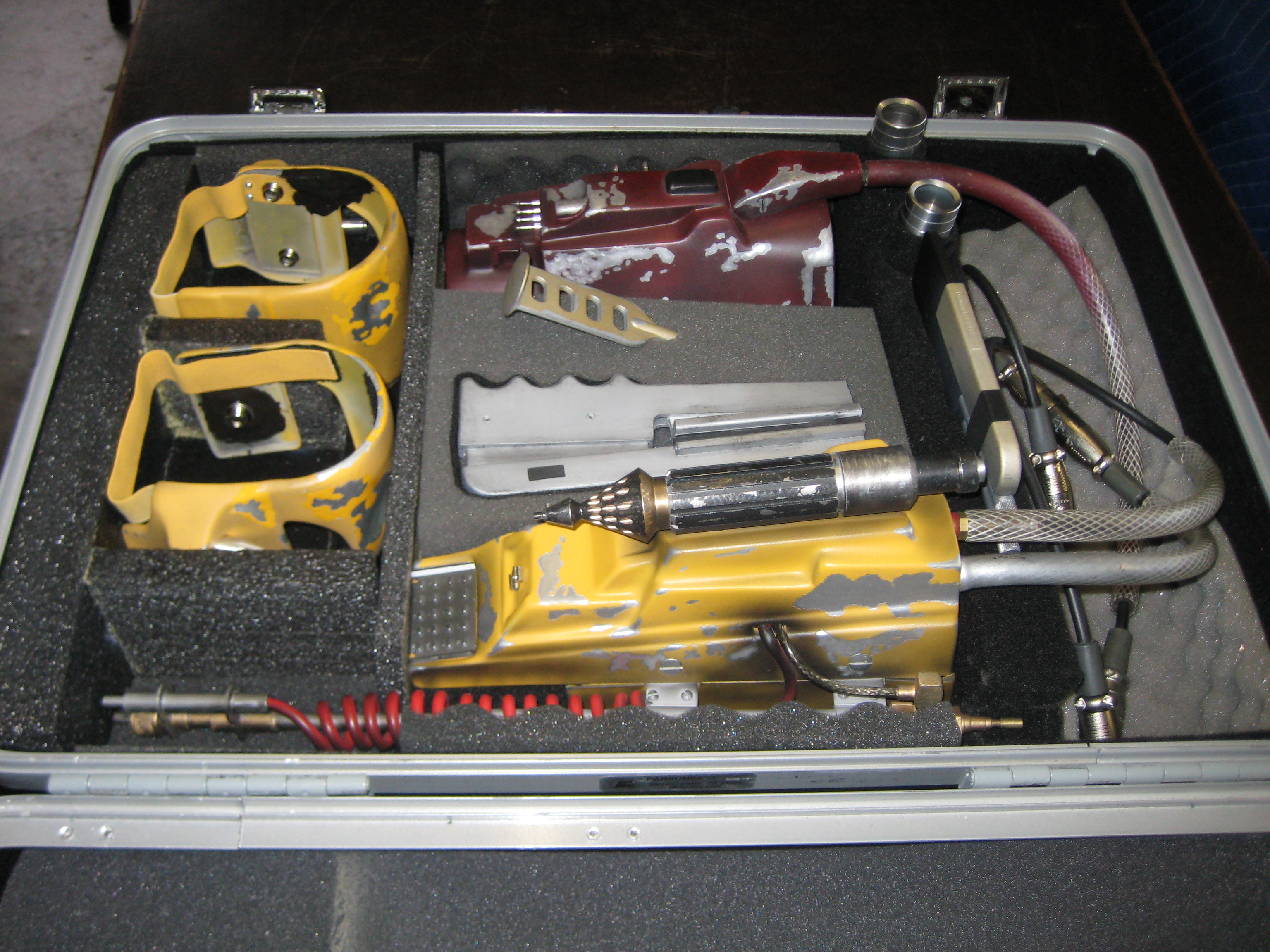

Over the holidays i found these cool heavy tool totes/cases and i had an idea:)

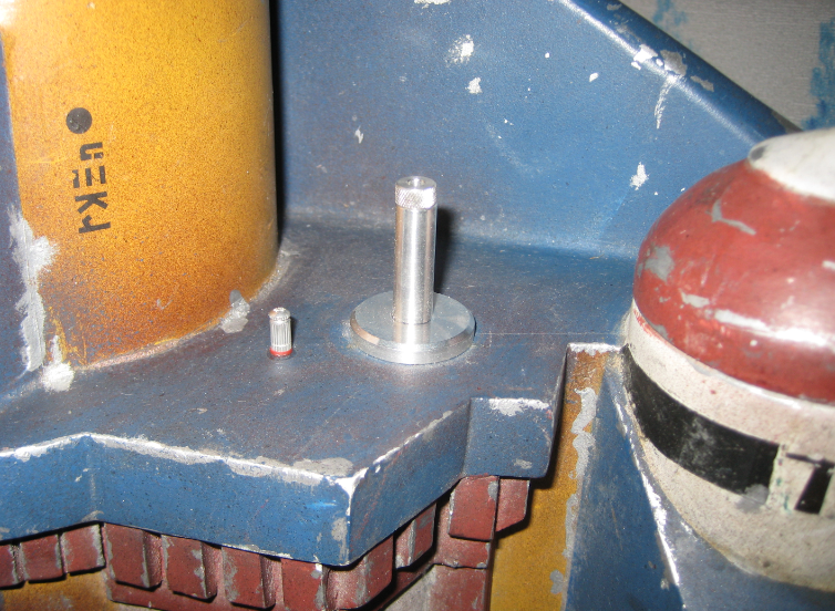

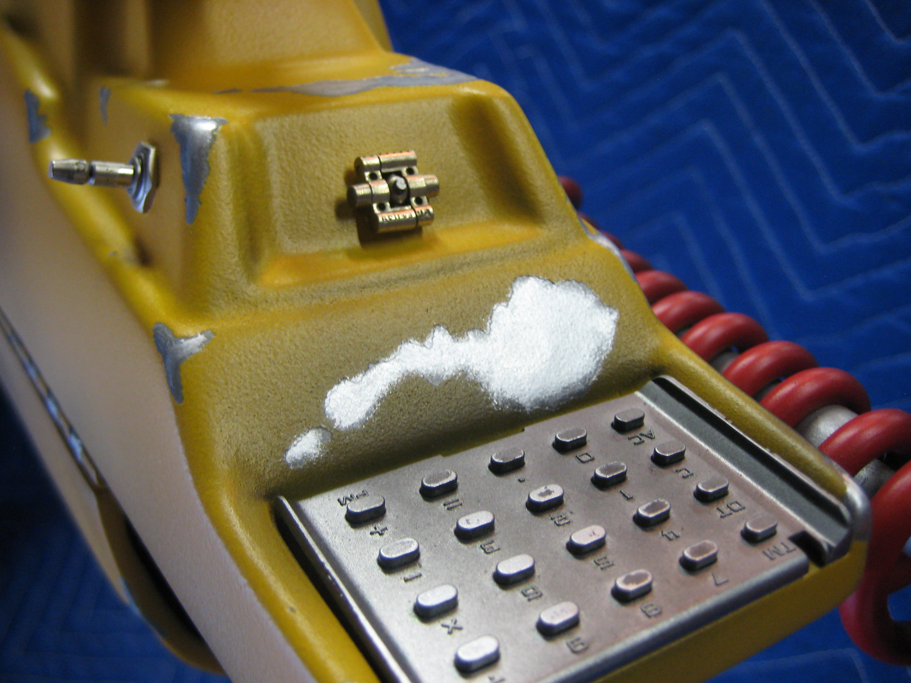

Just a quick update, my MOW-PP2 gauntlet set now feature all known found parts. It was a long shot but i found and have since then added a real Glenross dental expansion screw.
Here's a pic or two with the added Glenross expansion part.

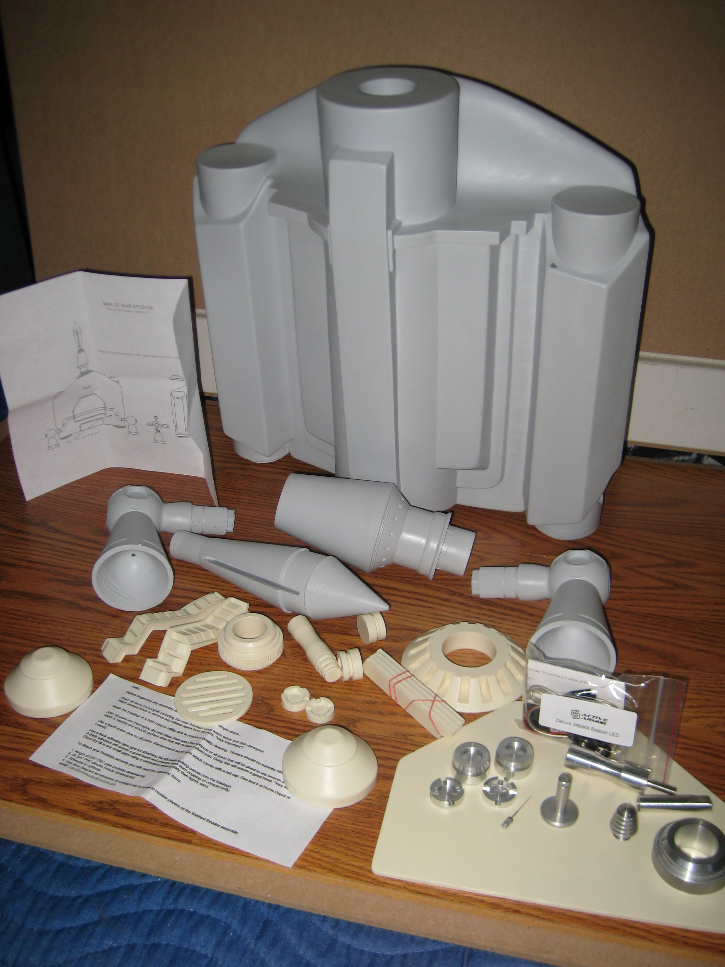

Thanks guys, package came in from MOW and its time to get back to work :) adding aluminum and found parts i had stockpiled. hmm i still need hooks, i'll pick those up on the fly.

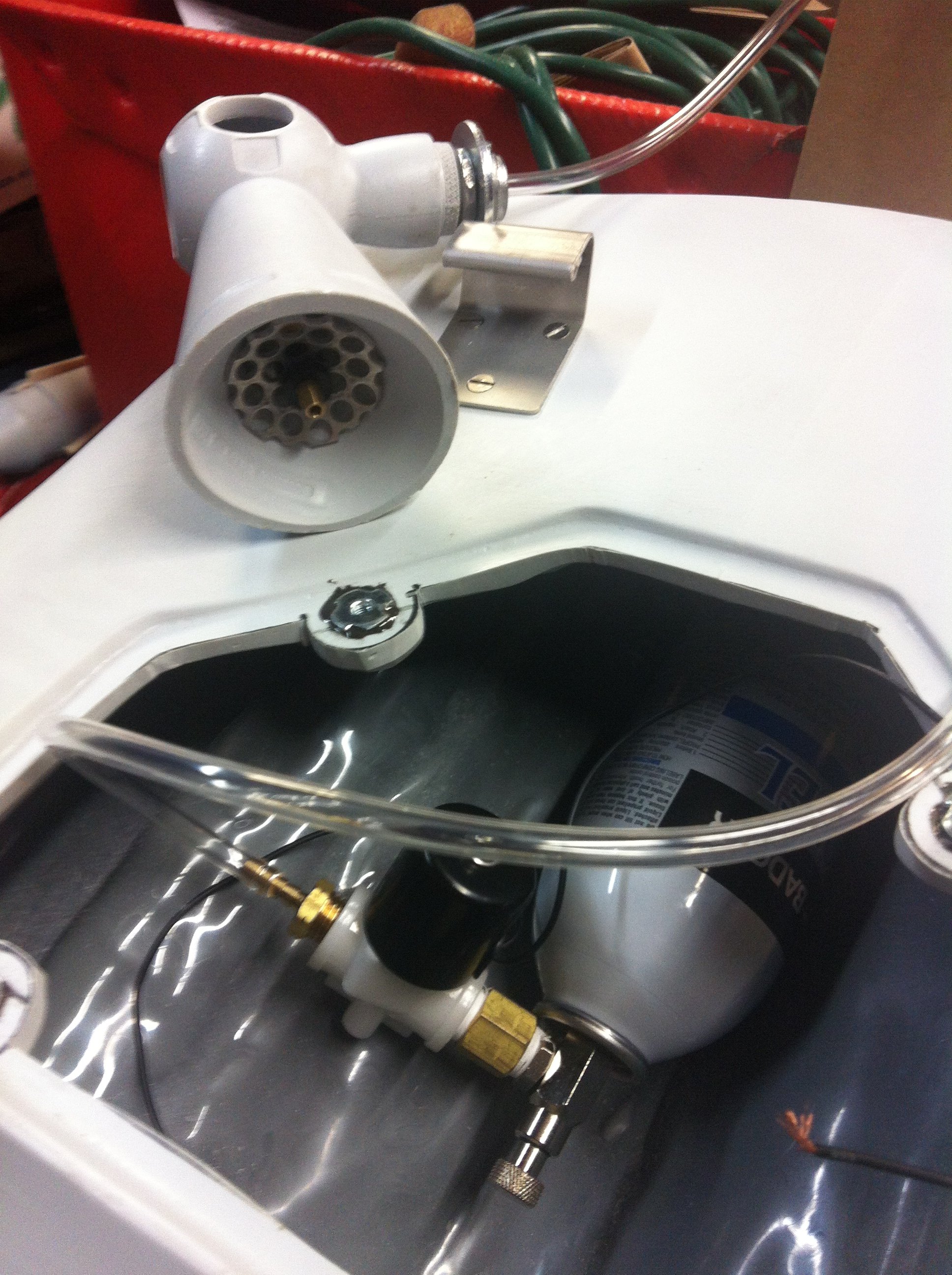

I may get crazy with a smoke or compressed air system.

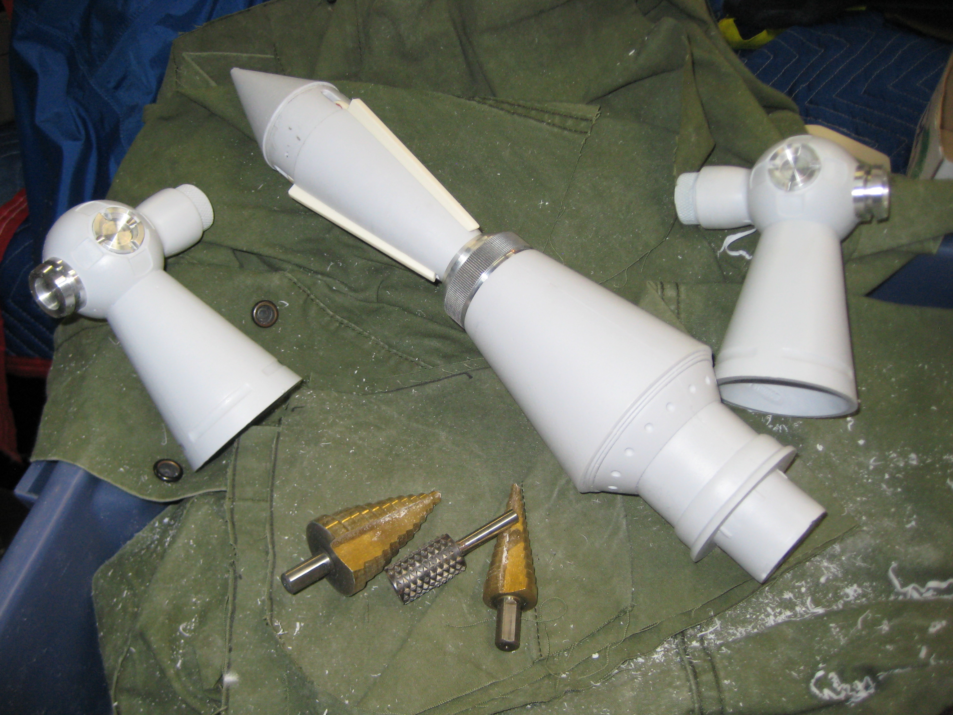

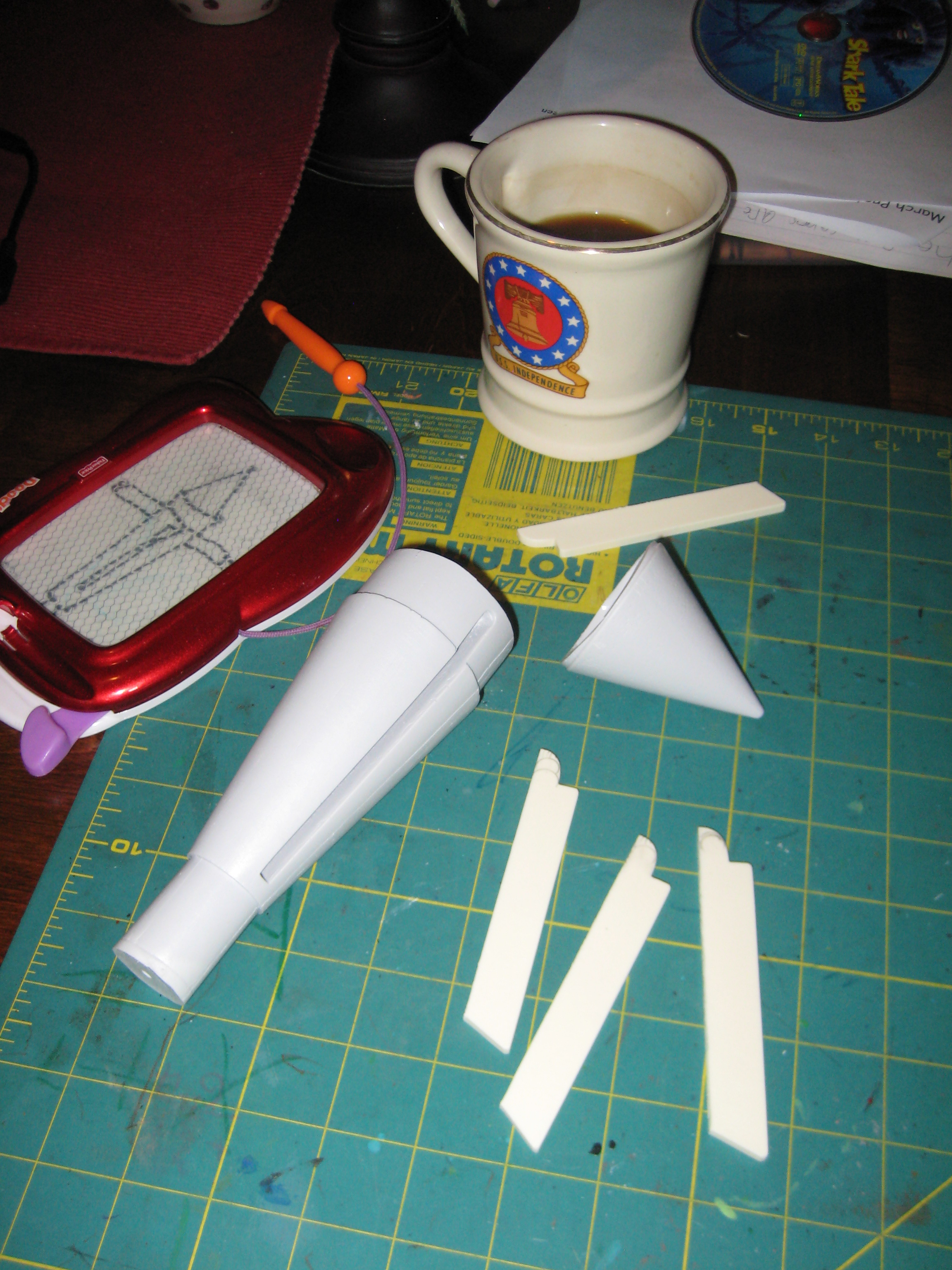

OK all parts washed, time to start building. so i was checking out the parts over coffee and i thought i would make things interesting.

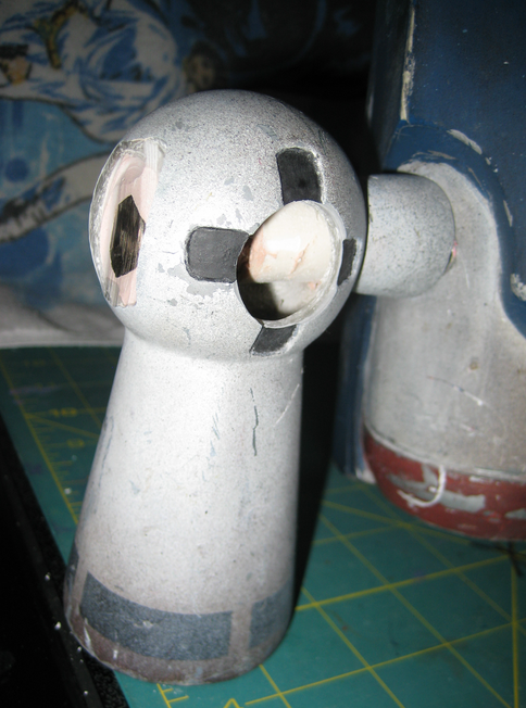

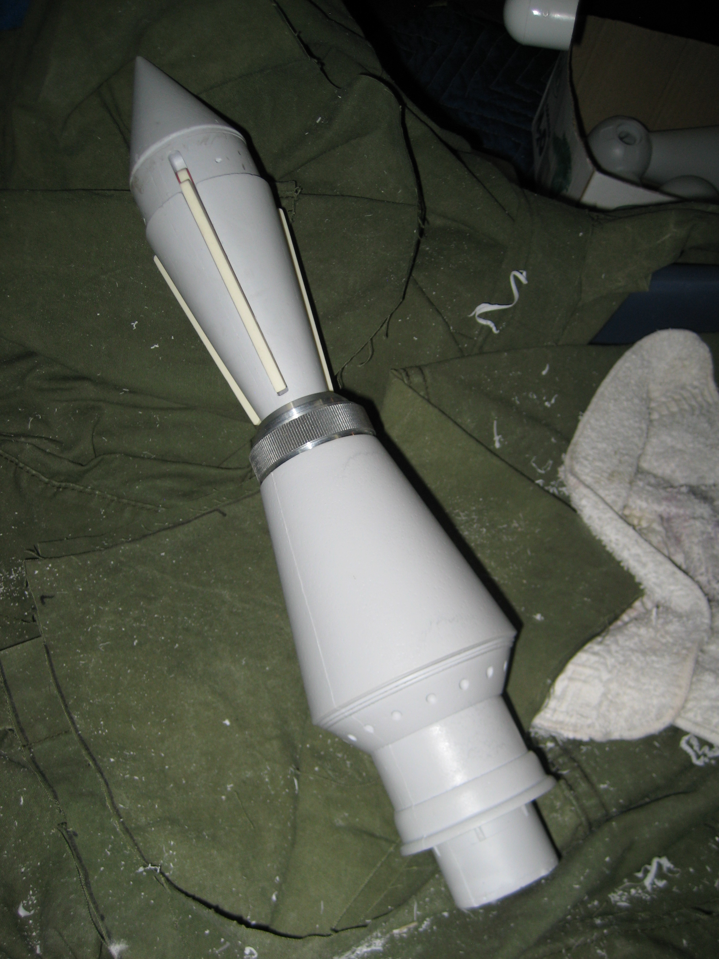

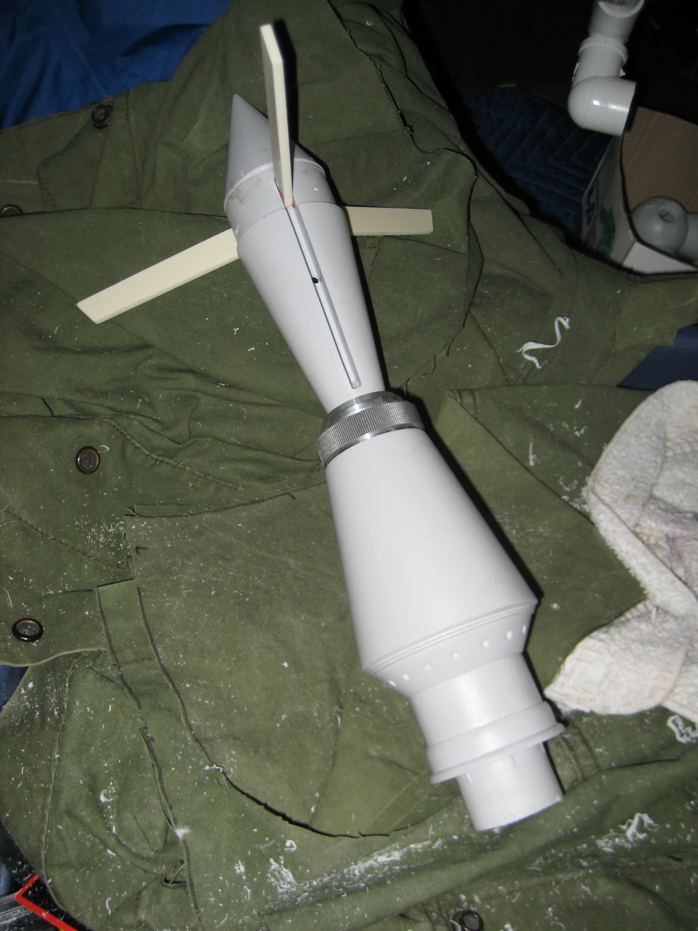

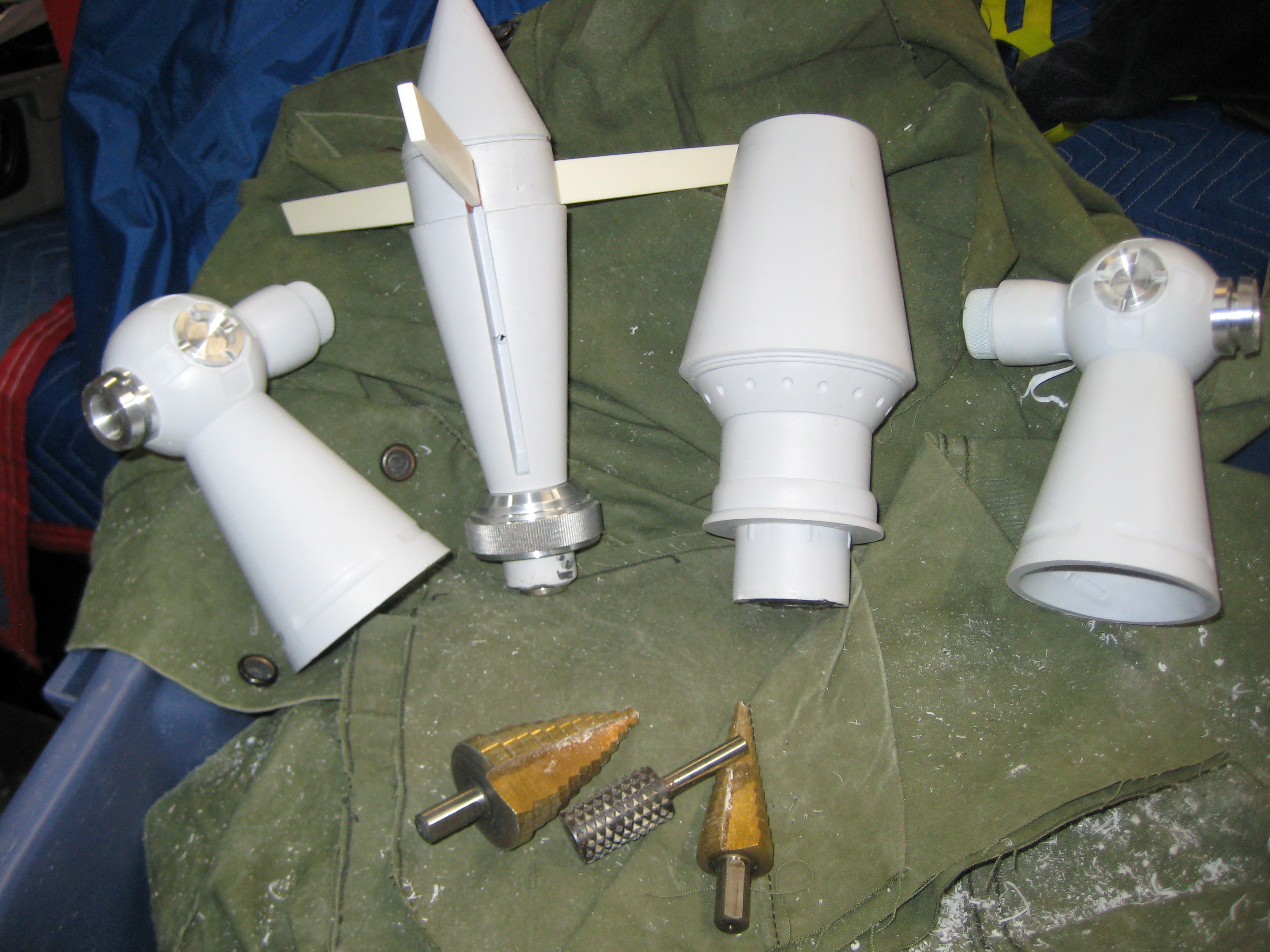

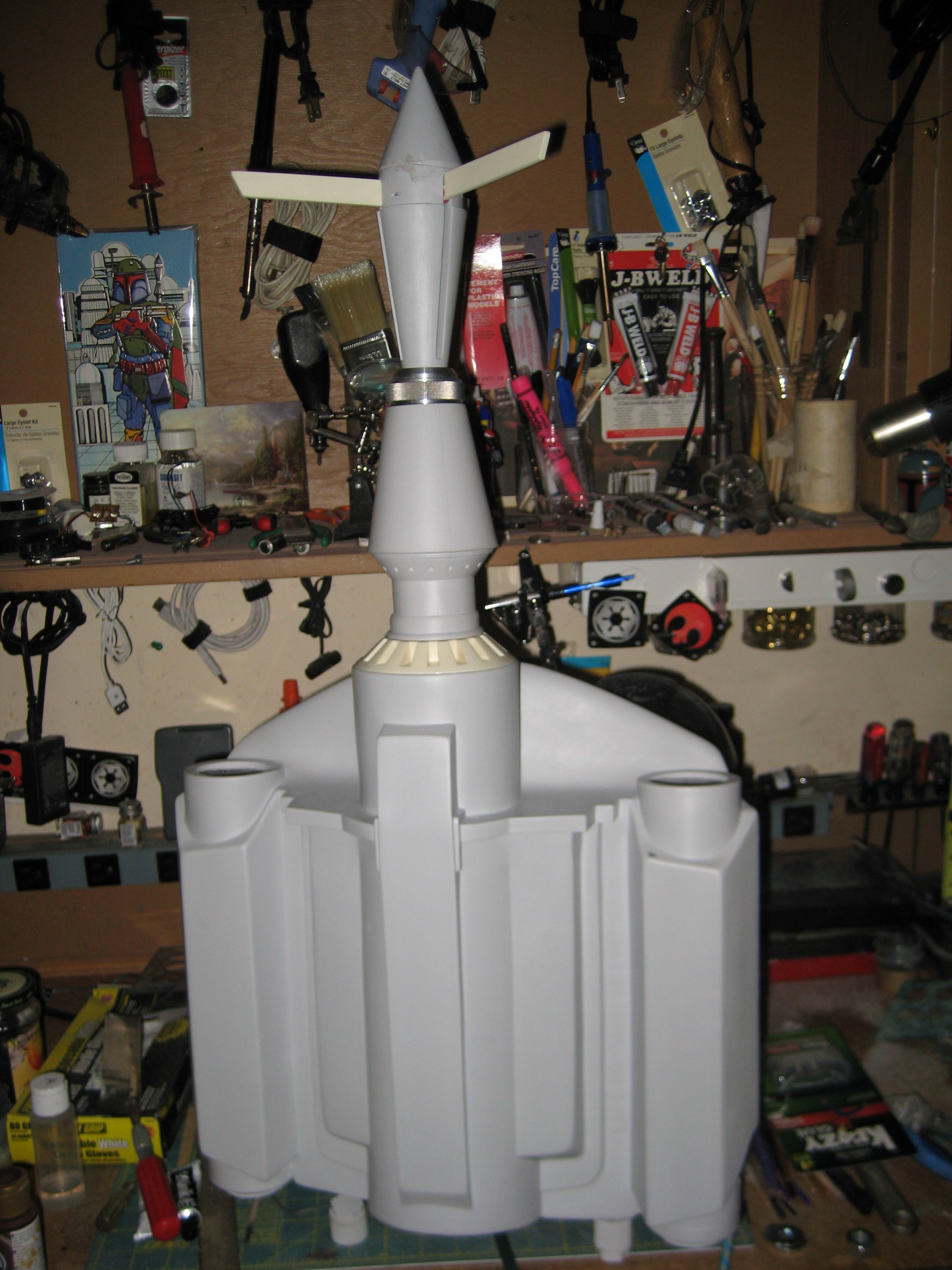

Going with retractable fins albeit manual movement. Rocket is going to be a two piece unit, bottom half screw on and the top portion rare earth magnet attachment. I rounded off the fin tips to assist with movement. I taped a toothpick to the back of each fin to serve as a temporary spacer then i drilled the pivot points. once the holes were drilled i used small nails with cut off heads as setting pins. Also i added small cardboard washers in-between the fins and the rocket sidewalls to stiffen up the movement. Thrusters were trimmed and aluminum pieces fitted.
That's all for today
Ok I got all the parts I needed:) I'm going to start working on the Jet Pack soon. Can you smell what the rock is cooking?

I like the idea of usable calc pad buttons. You could do a lot with that, it's starting some ideas right now lol.

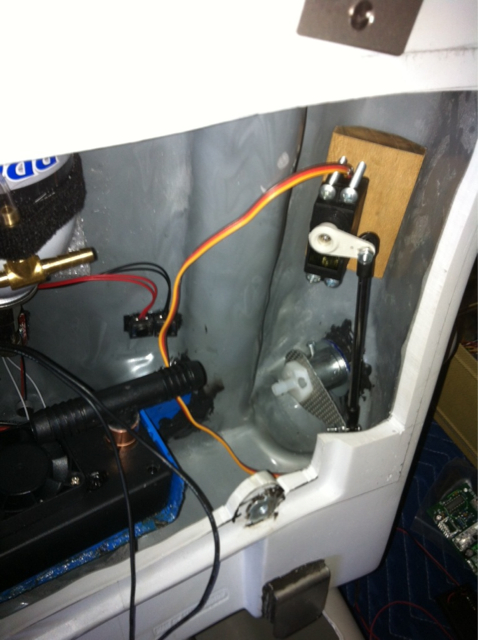

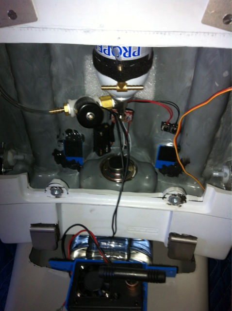

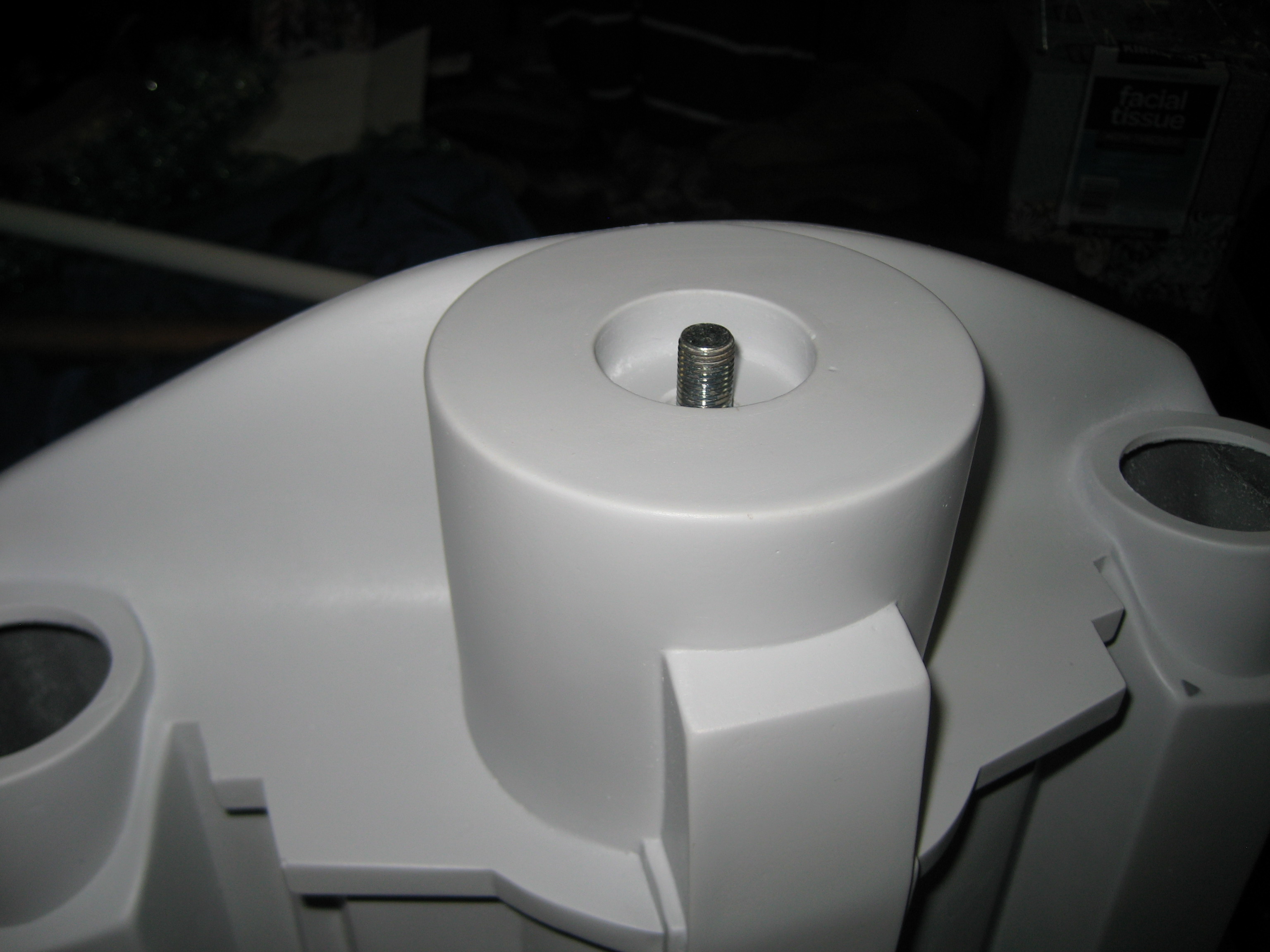

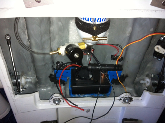

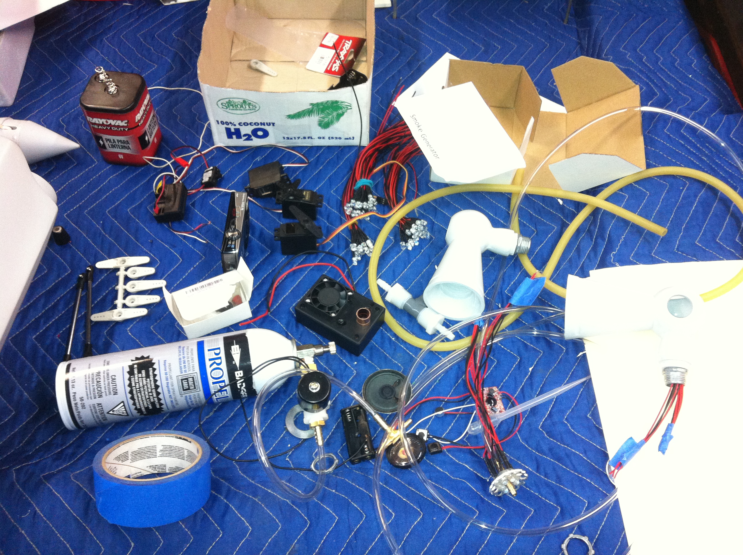

Jp kicking my arrssss :) but I'm having fun. I'm planing to fully build it, test it, tear it down then send it off for paint. I have a ton of pics and plan on showing all TDH members how to add these effects for themselves. I'm going to install activation buttons in my ammo pouches. I'll have more on that later, here's some progress pics
