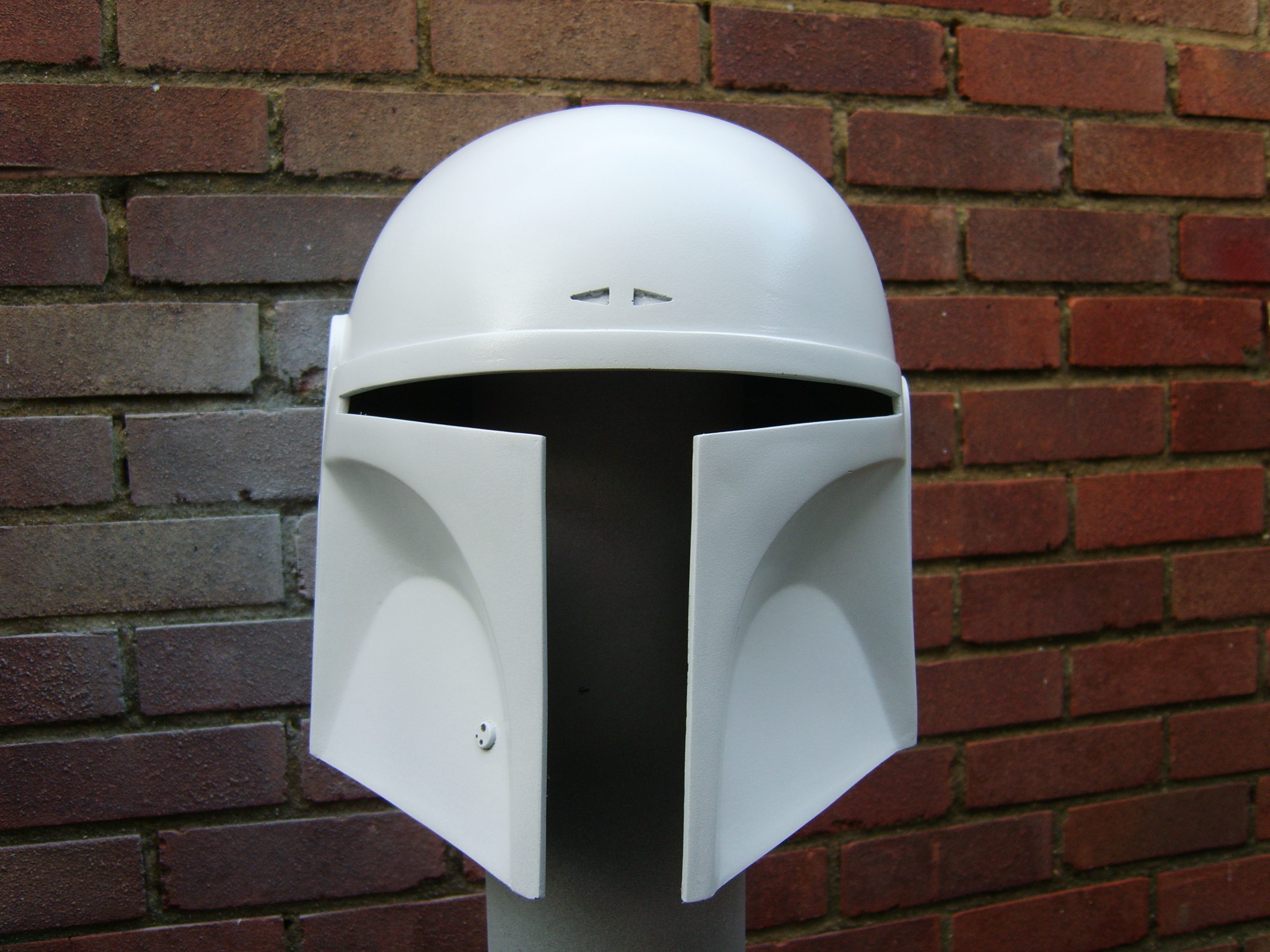

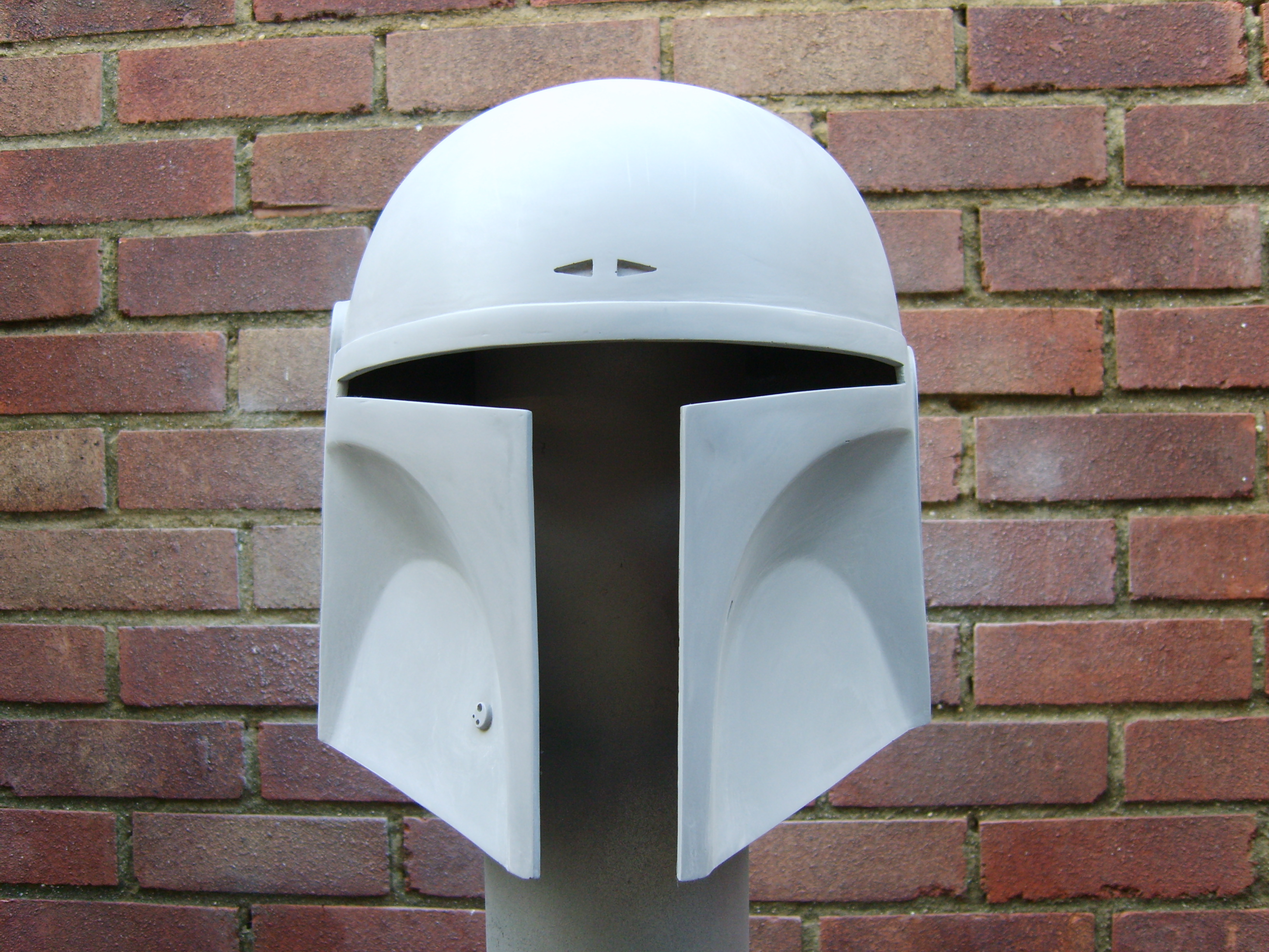

Spent a good while sanding the helmet smooth as I could with various grades of wet and dry paper, finally ending on 1200 grit, then I sprayed a few light coats of Tamiya Fine Surface Primer which in my opinion is the best primer there is, it literally shows up any flaws of which there were a few :) So I went back and used Isopon p38 to fill those imperfections, re-primed the helmet and then sanded it smooth again, once happy with the results I applied my first coat of Halfords Gloss White, it came out very nice and even but not very glossy, what needs to be done now is wet sanding and lots of it :thumbsup:

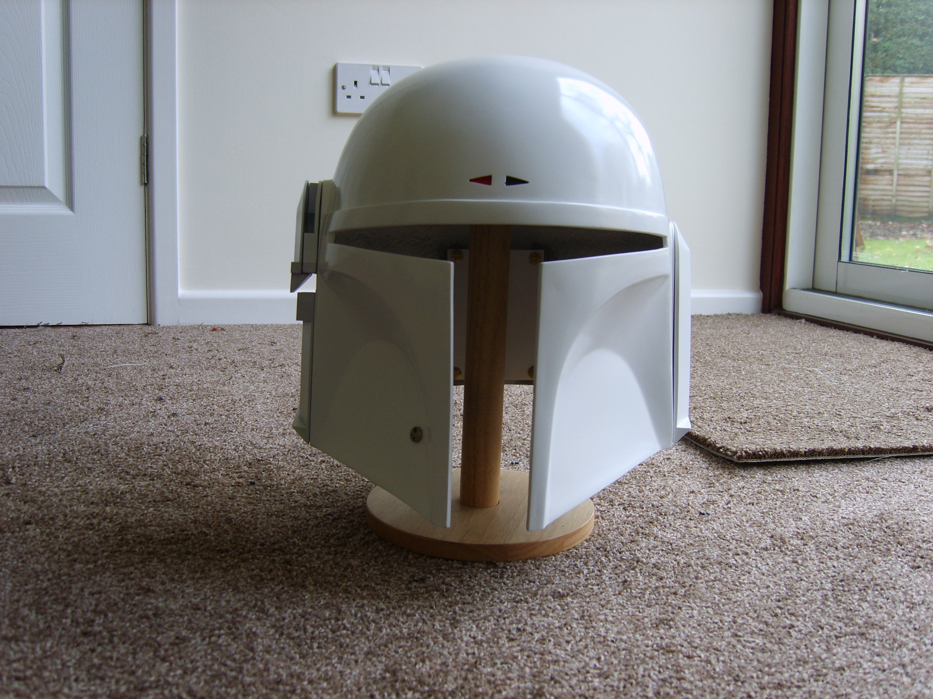

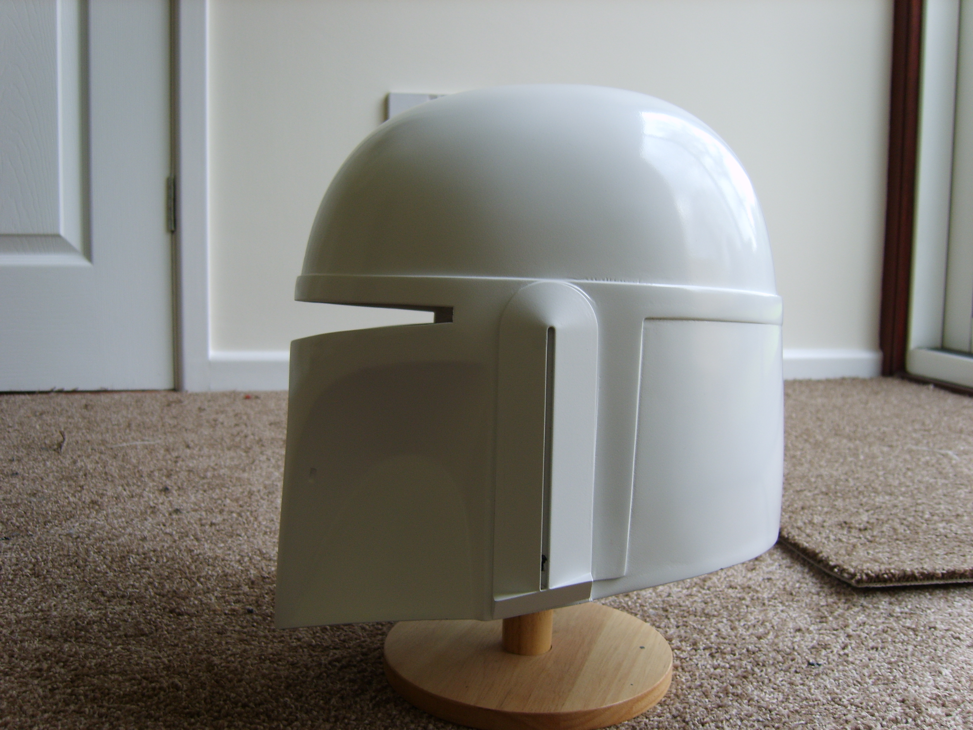

After 3 solid rounds of wetsanding and repainting I am happy with the final sheen on the helmet, I know I am not going to get it absolutely flawless, I have now coated the helmet with Humbrol Acrylic Gloss Varnish and am waiting for that to cure over night, I will then give it a good buff and take some pictures as its dark here now :thumbsup:
*Update*

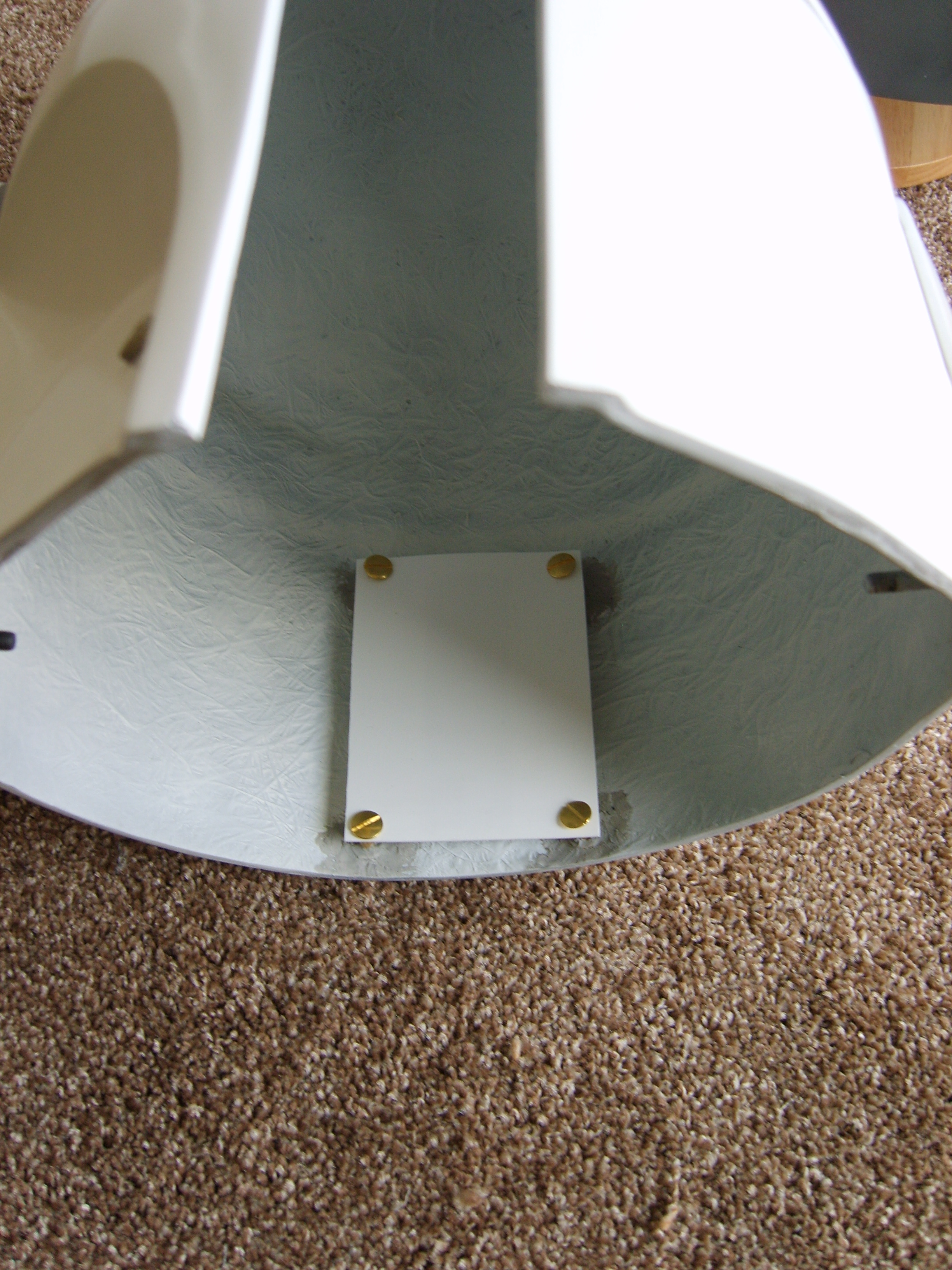

I have managed to get this almost finished, all that needs doing from here is fitting the visor and RF stalk and painting the RF topper, I have gone for the look with the turn signals painted green and red, I have also fitted the MQ-1 board to a sheet of styrene which is then held in place by 4 chicago screws and t-nuts, I welcome any and all comments, this has been a fantastic helmet to work on and looks quite stunning in person :thumbsup:
