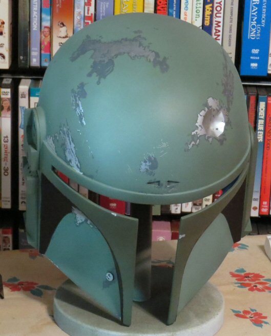

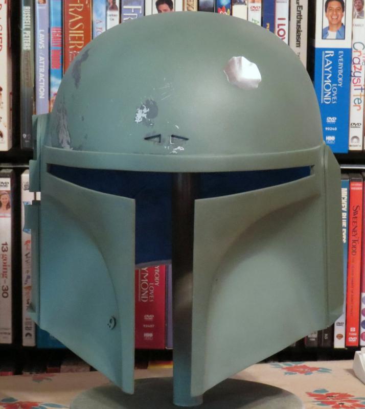

Smaller update today. Did the small area around/above the turn signals, and filled in the dent
with silver. Also did the physical scratches around this section.
I like to have a good amount of time when working on the dent/streak, so I left
that for tomorrow. I'm hoping to get that finished as well as the big scrape on
top of the dome. Then it'll be on to killstripes.

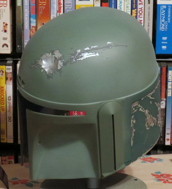

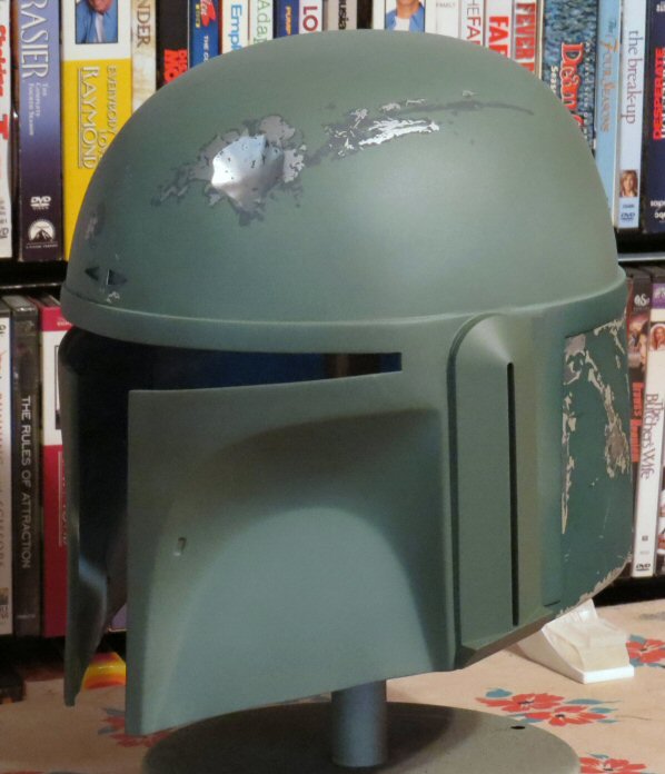

UPDATE: July 12, 2014
Dentage! :) This is another fun area to do. It's probably the most recognizable
feature of the helmet, and there's lots of small detail intermingled within and around the dent.
It's hard to photograph without glare since it curves around a good portion of the dome, so
here are 2 different angles.
I got started on the big scrape, but I had to take a break. :lol: I'll finish it tomorrow and then
I'll cut the physical damage into the cheeks/mandibles and paint the outer cheeks.
The dent is one of my favourite parts on the whole helmet. Looks terrific!

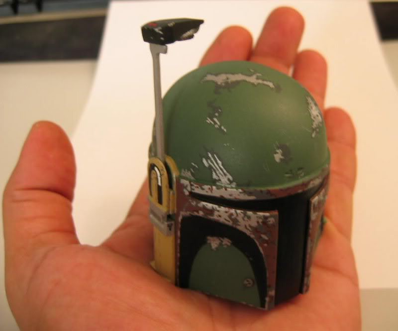

But the smallest helmet that I've ever painted was a 1/4 scale replacement for the Sideshow Premium Format
Fett statue. Natty15d did an amazing sculpt that looks so much better than the helmet that came on the
figure! That was really fun to do, and I used my "standard" ESB color palette on it. Here it is. :)
No stencils for that little guy!
Yeah, that little helmet was fun to do. Very challenging!

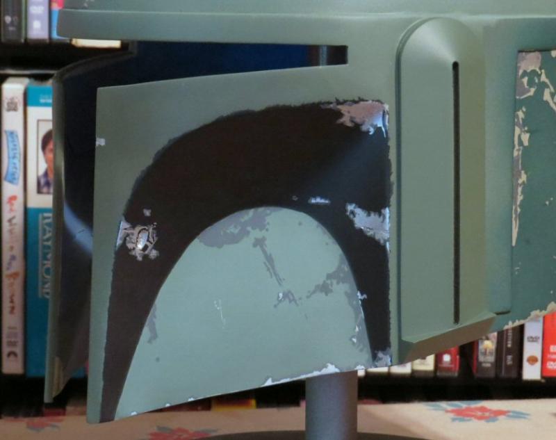

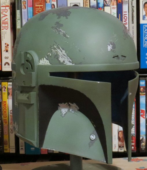

UPDATE: July 13, 2014
Whew! Got a lot done this weekend. Finished the big scrape in about 3 sessions.
Also got the upper cheeks painted, and did the detailing on the right cheek. As you can see
in the pic below, the Borden has been base coated with silver as a sort of primer. I'll go over
this with a brass color, then weather it with a couple of light washes.
The nicks on the mandibles are the physical damage that I did with an X-acto blade.
It's starting to look Fett-ish now. :)

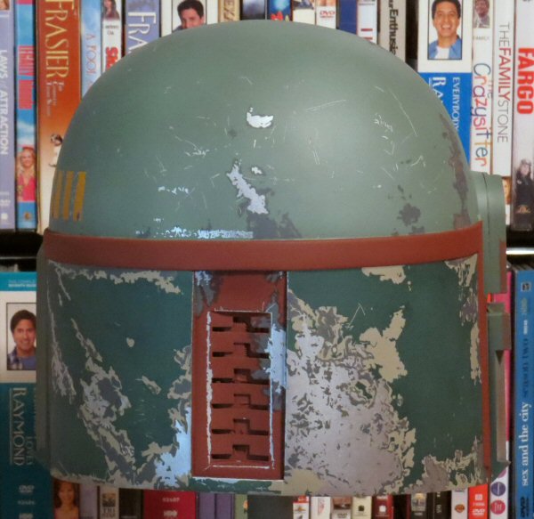

UPDATE: July 15, 2014
Less time to work during the week, so smaller updates.
Got the left cheek done. This is another of my favorite areas. The gray damage on
the inner cheek is so angular looking compared to other parts of the helmet. Plus it has
that strange darker greenish-gray color along the outer edge.
This brings me to the killstripes. I do the stripes before completing the remaining gray and
silver on the left side of the dome. The position of the damage is very closely related to
the stripes, so I do them first. I like to have a good amount of time to get everything masked
up, so I'll hold off until tomorrow. :)

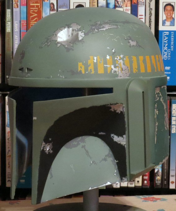

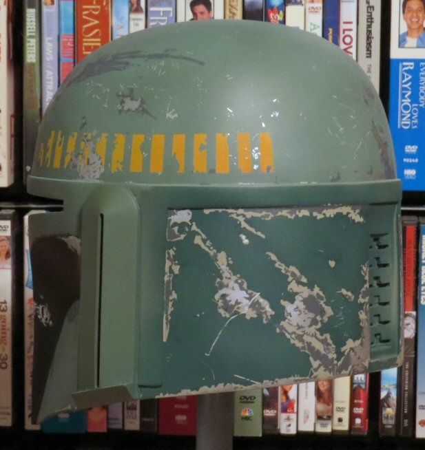

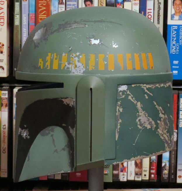

UPDATE: July 18, 2014
OK, back on track now!
Got the whole killstripe region complete. I've got a thread in the Prop Building Workshop forum
that outlines my process for doing the stripes, so I won't repeat it here. If you're interested,
you can check it out here:
http://www.thedentedhelmet.com/f32/boba-fett-esb-killstripe-tutorial-49888/
Here are several angles of the helmet's left side. With the curve of the dome, it's hard to
photograph all the detail in one shot. It appears more prominent or fainter depending on
the angle of the lighting.
I find that the stripes look better if I apply a couple of light coats. It leaves them just barely translucent.
Here's the last one.
There will be just a bit more detail added to this section once I've gotten the mandibles done.
I add the fade under the killstripes close to the end of the project when I'm doing the final
weathering stages.
Next up will be painting the RF ear. After that, I'll be able to lay down the base red on the mandibles!

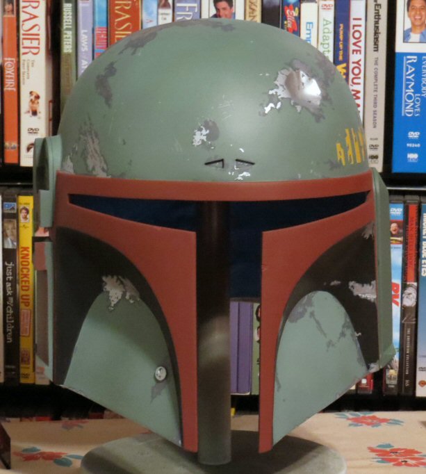

UPDATE: July 20, 2014
Red! :) Got the mandibles masked and painted. This is the most complex masking on the entire
helmet, and the ears-on just creates an extra masking step. I decided to do the red prior to doing
the RF ear after all.
I actually did the mandibles yesterday. After letting them dry overnight, I had some time to begin
the damage. I started with the keyslot area.
Next I'll begin working on the band above the keyslots, then on to the vertical sections behind
the ears. The front sections will come after that.
