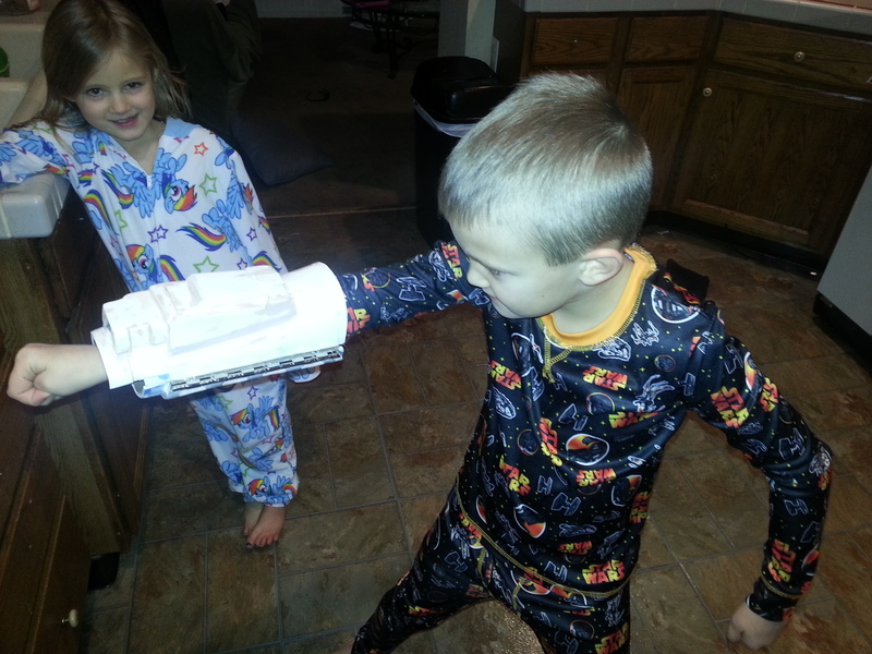

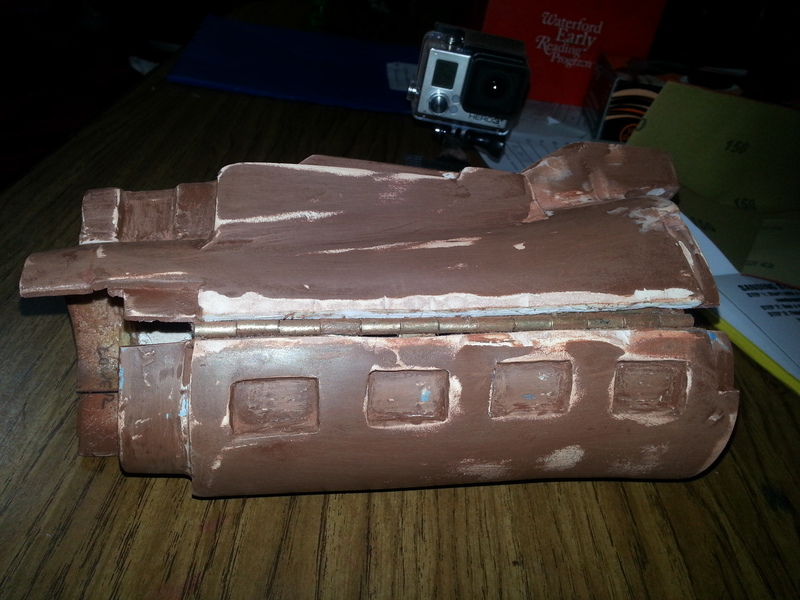

I also did some gauntlet work today. I am still working on the videos but here are some pictures of the most current state of the right gauntlet. The kids even enjoy it.

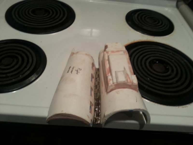

Well the video is up of the joining of the two halves of the gauntlet. Now that that is complete. I need to put on the whipcord piece and the rear hose piece and paint the gauntlet. I really am liking the way this turned out it might not look quite as nice as some of the other gauntlets, but considering the most expensive piece I have purchased for this gauntlet was the 7 dollars for the hinge I think it is going well. The most expensive part is going to be the painting.
Any comments are appreciated. You might say I am desperate for approval :D .

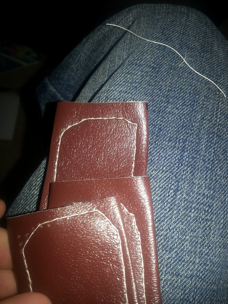

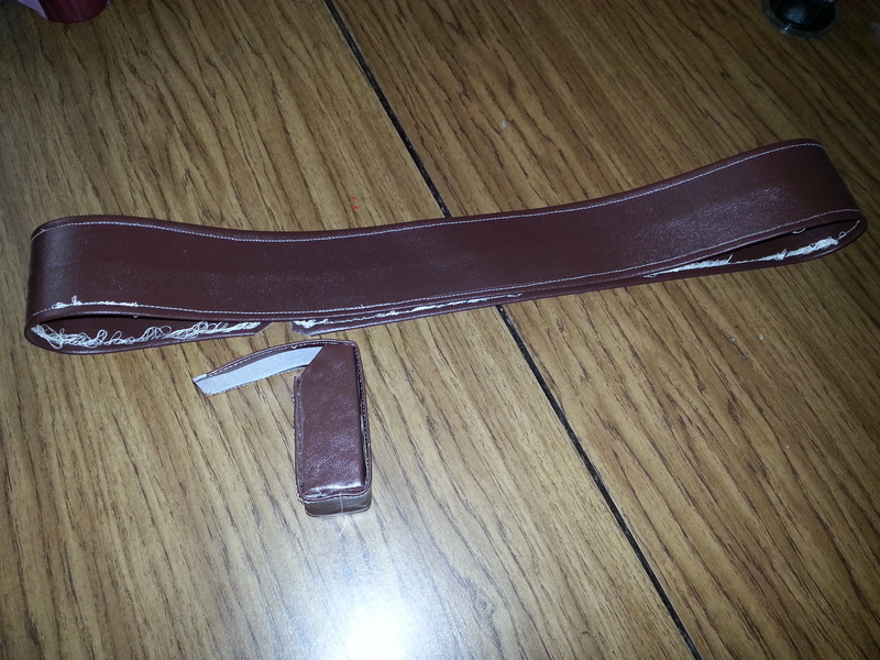

The stitching was a nightmare, but my first attempt at a ammo belt is at least now in a belt shape... I also made one pouch as a proof of concept there is minimal, but actual storage in the pouch itself. I could probably build it out of something thinner and be fine, but I had this stuff on hand. Enjoy the pictures. I took a time lapse as always, but those take a while to process.

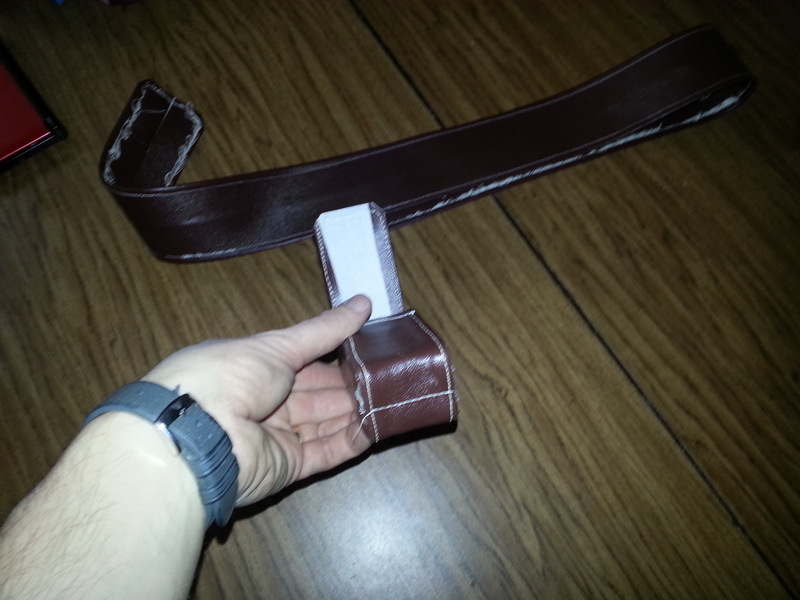

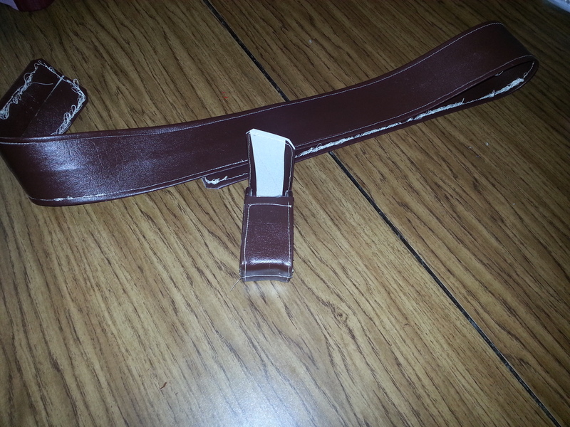

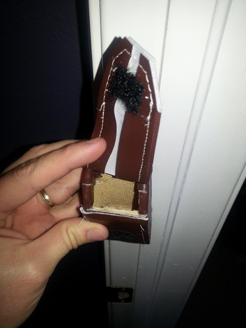

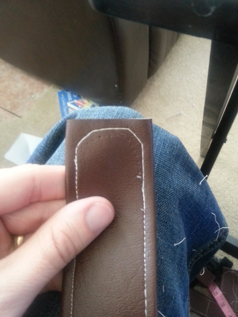

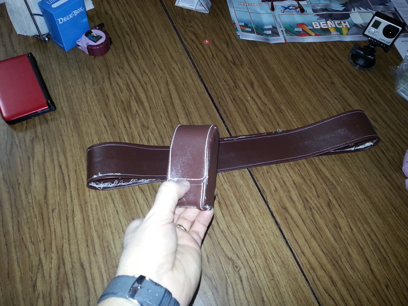

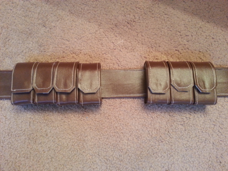

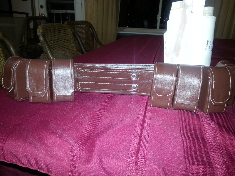

Alright the ammo belt. This could have gone much worse, but I am actually pleasantly surprised with how it turned out. Here is the pertinent information.
1. 1/2 yard of vinyl from Joanns Fabric (I had a good coupon so it cost less than 10 dollar)
2. Spray Adhesive (Mine was from an old car project)
3. Materials to make the inside of the pouches
4. Liberal amounts of hot glue
5. An understanding wife
6. Ribbon Tape Measure (To measure your fat gut)
7. Time and Patience

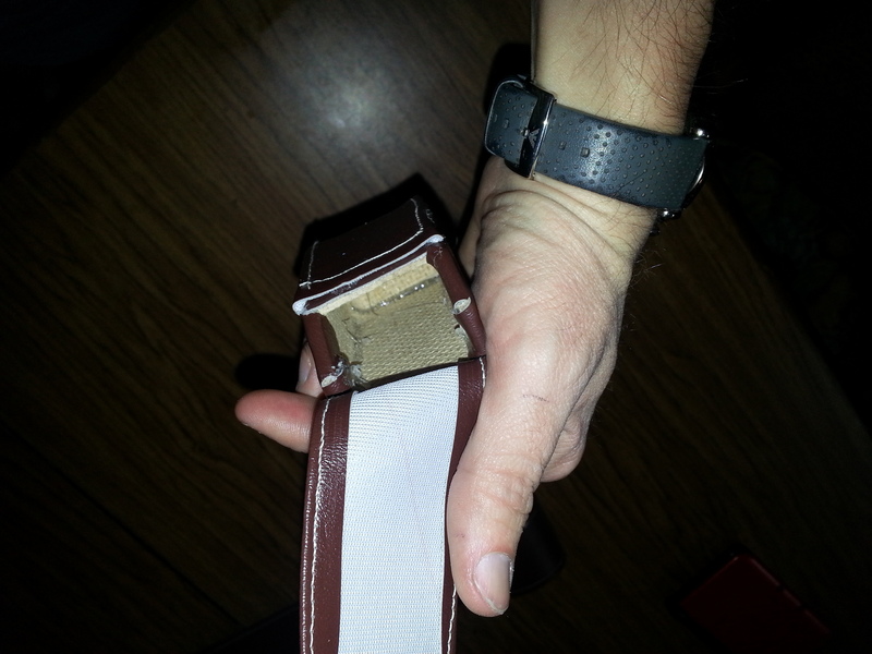

Belt:
1. Gather Materials Above
2. I think most normal size people will be able to do the entire belt with plenty left over for some mistakes with a 1/2 yard. That material is expensive save yourself some money. After I am completely done I will try and take a picture of the remainder of the material I have
3. Measure your waist
4. Cut out adequate length and width to make belt (The templates will give you the width requirements, double it up if you want to have that leather look on both sides)
5. Mark the center line
6. Spray adhesive on backside, multiple coats are suggested, let it get tacky between coats, do it again
7. Fold the sides to the middle
8. Find some way to let it sit folded while the adhesive cures (I found a large board with clamps holding it to the table works

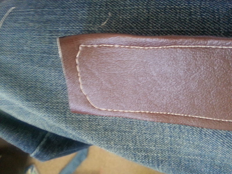

9. Add the stitching (After testing on a scrap piece)
10. Add Velcro for closure
11. Add Grommets

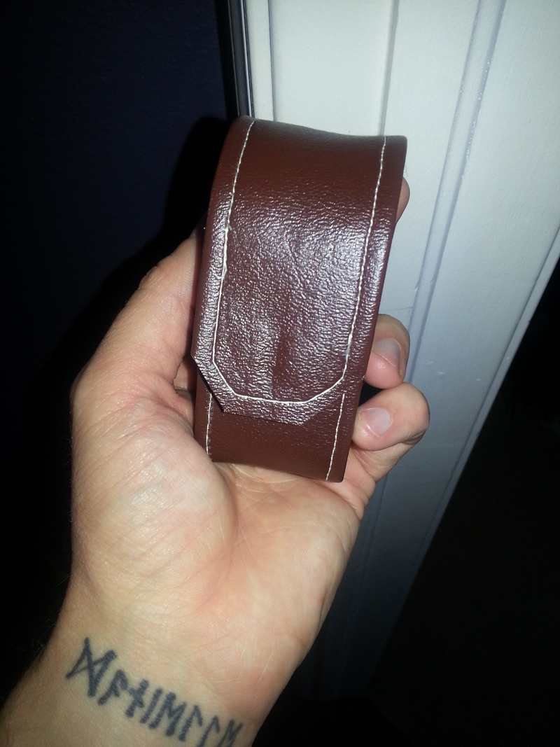

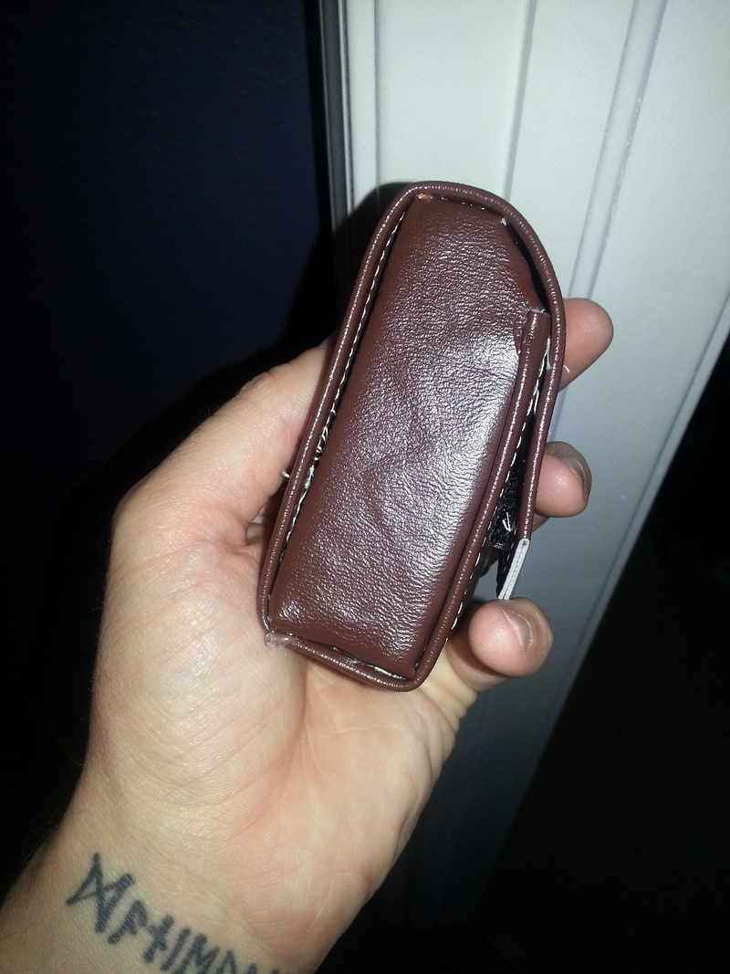

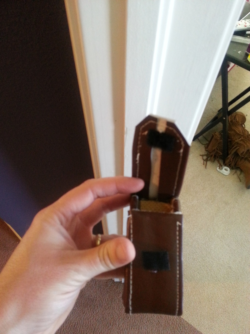

Pouches:
1. Gather Materials
2. Make decision on functioning vs non functioning (non functioning is easier)
3. Make inside pouch area. This could be a block of wood, foam, or in my case plyboard material I had in the garage
4. Cut out the outer covering I didn't mind the excess on the back as it will be covered by a strap and that is a place you could conserve a little bit of material
-- Please make a template out of a card stock or thicker paper it will make your life easier
5. Glue the outer coverings on
6. Make outer straps
-- Ensure they are wide enough, but not too wide for the pouch
-- Understand how you want them to close before you get to crazy
-- I decided to go with velcro, if non functioning, just a dab of hot glue could keep them shut
7. Sew the outer straps to match the stitching on exterior of pouches
8. Add any necessary snap button things
9. I will be adding velcro in the future to the back side of the straps to attach the side pouches to in the ESB style
10 Attach to belt I did this by NOT gluing the strap along the back of the pouch.
I hope this can help someone thank you for stopping by.
Some things to note, practice sewing in a scrap piece, so you can adjust the sewing width and other settings to your liking. The video is pretty self explanatory from here on.

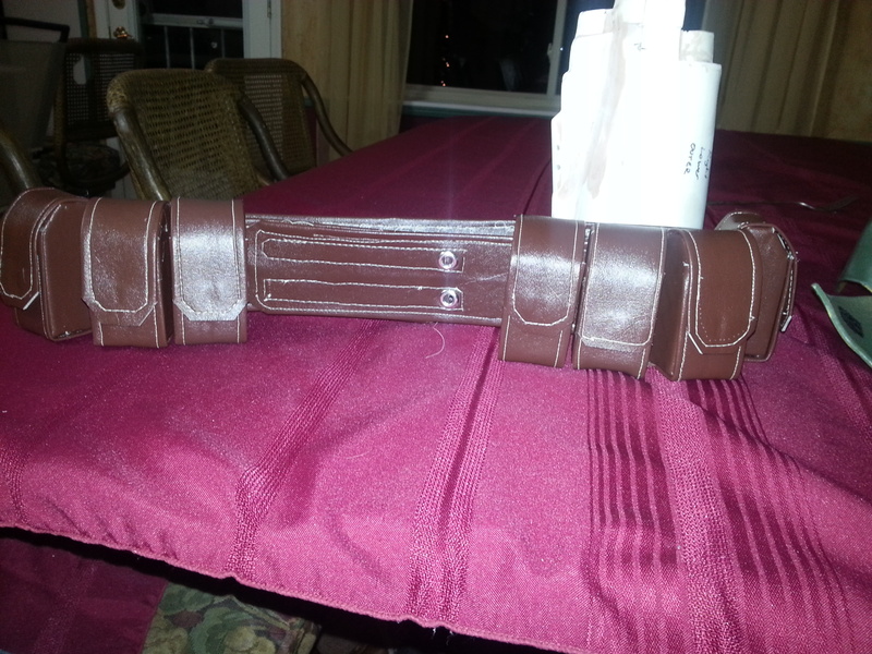

I also finished all the pouches on the belt today, just have to add the Velcro and grommets to the belt, I haven't decided whether I am going to add the screen accurate button clips on the pouches as necessary. As you can see from the photos below I went back and tried to get the ends of the stitching better and they are better, but they still aren't perfect. I am calling that part of them done though. Again I am pretty impressed with how this is working out.
On the belt!!

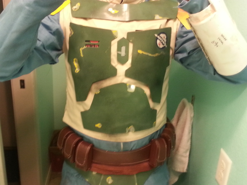

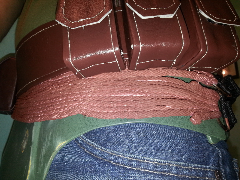

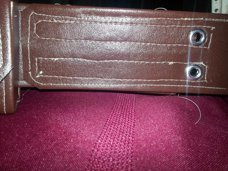

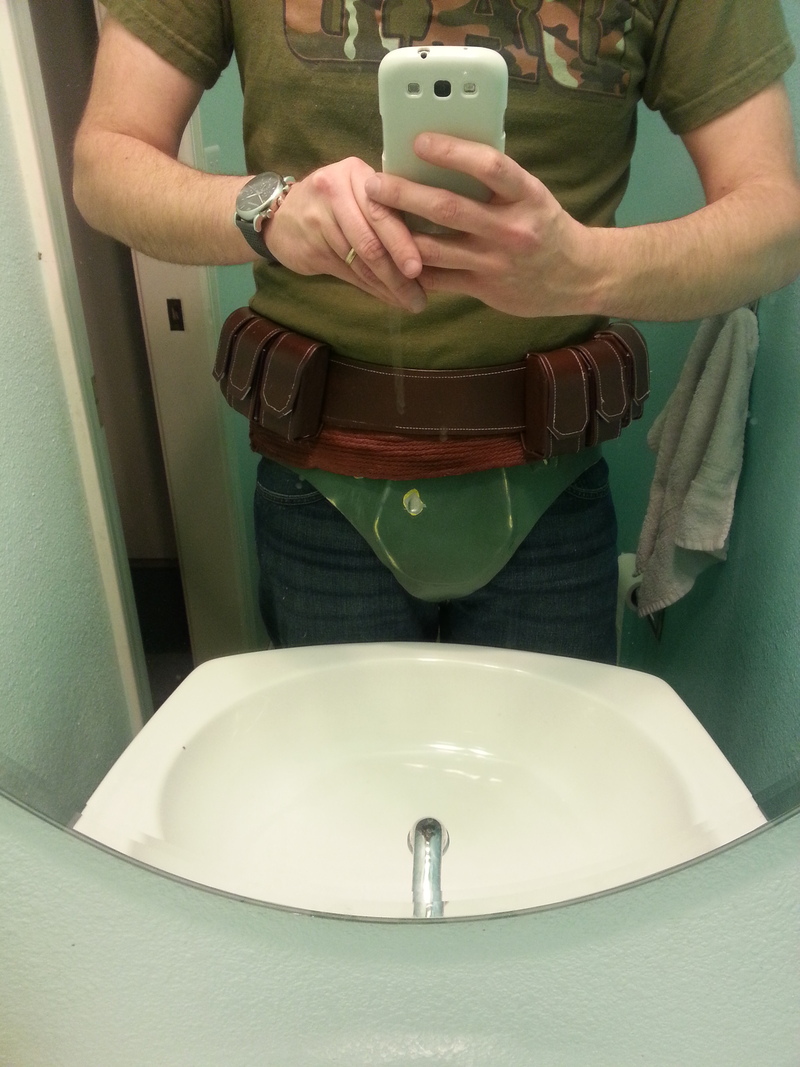

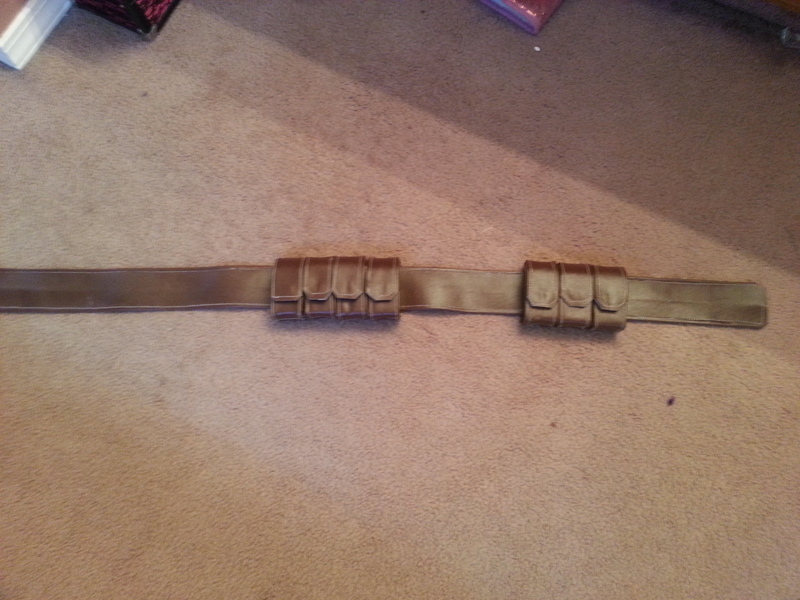

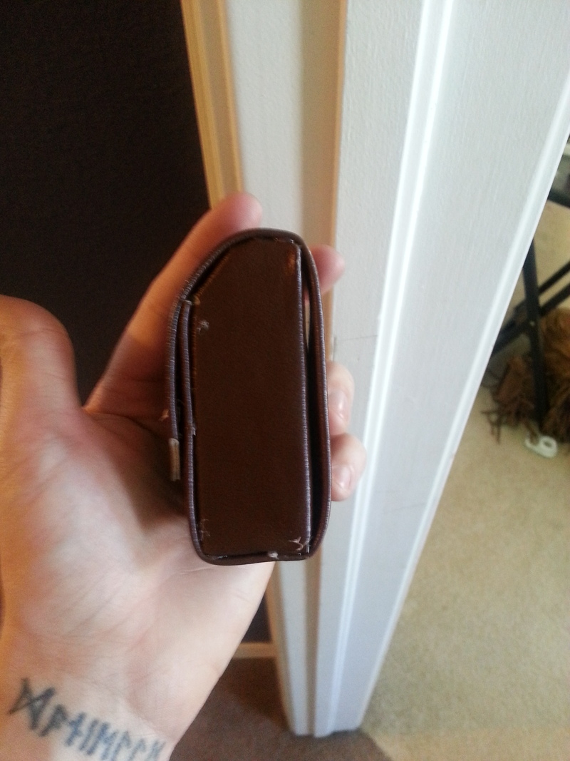

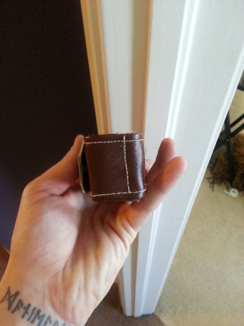

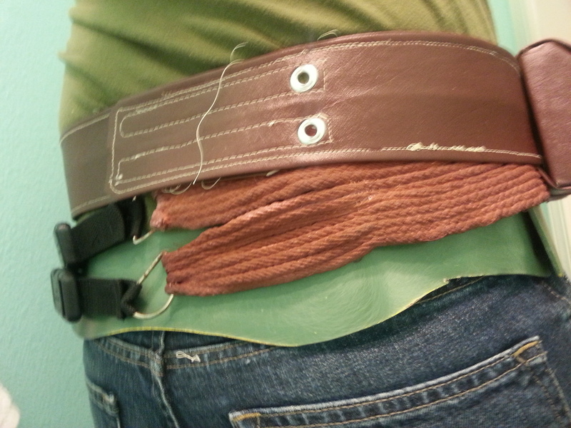

I got the ammo belt finished. Which prompted me to take some photos. I like the way it looks, but after seeing some of the killer work on this site it is hard to be satisfied with anything I do (Like crooked sewing, and plastic clips vs metal on the girth belt). For my very first home made costume I think it is turning out well enough, I think the belt looks great on.

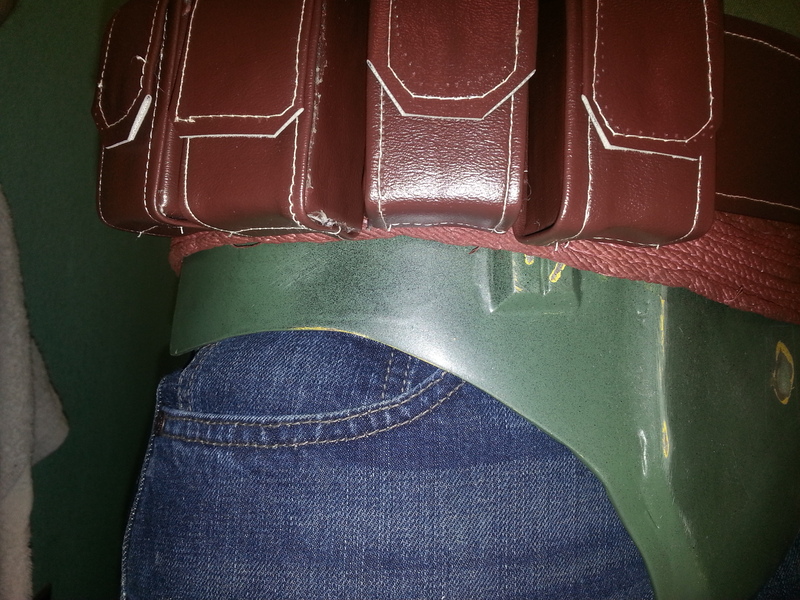

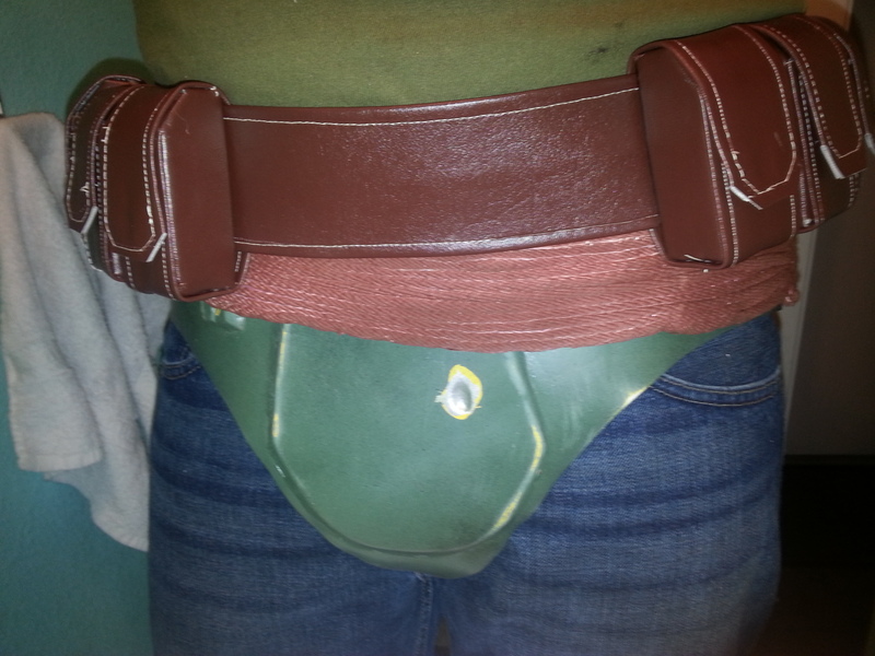

Then I was just too excited so I put on all the costume I have thus far and took some more pictures!!

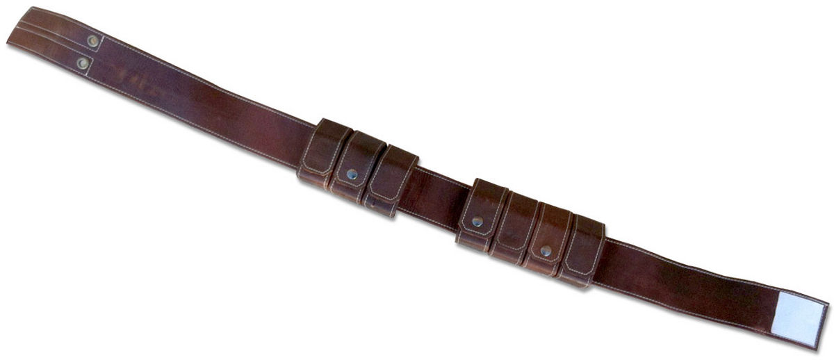

Great job on the belt so far. Don't forget the required buttons for some of the pouches. Also the pouch flaps should be even and come almost down to the bottom. This is just if you want to be more accurate.
The girth belt you have could be made slightly more accurate at little to no cost to you. Take 4 old belt buckles and use those for the ends. The girth belt actually is a horse girth belt and has 4 belt buckles. Use a solid nylon strap to connect the two ends together.
Here's an example of a completed girth belt.
Lastly start looking at how your backplate connects to your neck armor piece. Typically the back armor plate slides under the neck piece and is attached together via the 4 studs that appear at the top of the armor. Additonally not shown are the two slits that hold the harness straps that hold the jet pack onto your back. Consideration on how your jet pack will attach to your body is pretty important as it will cause back/neck issues if not handled correctly.
Great job so far...the above are just suggestions to look at to improve the quality of your build and wearability of your suit for an extended period.
crumdum . Thank you for the tips. It is overwhelming all of the little nuances that can easily be missed such as the strap being a little bit lower on the pouch that I don't catch. I could remove the vinyl straps and move them down just a hair. I will look into that in the future. I still plan on adding the snap buttons, but I really think I can do that at almost anytime and I haven't seen ones that I like when I am out scavenging, so I am waiting a bit longer. The girth belt is also one of those things where I am waiting until I stumble across some good buckles to make those changes in the future. The back piece is another story I have been thinking about how best to attach the pieces together (Back and collar) I am leaning towards 4 small bolts along the top through the collar and screwing into some keyboard screws. I haven't decided whether I will make the jet pack, so I haven't added the slits for the straps. I will before I paint it in case I decide to go that route. I really do appreciate the comments and the clean pictures those are great visuals that I can use. I am not going to be up to 501st standards when I get done, but I am still proud of what I have built so far. This is all practice for the helmet scratch build that i will be doing last. The goal is to have it ready for the Denver Comic Con in June of 2016.

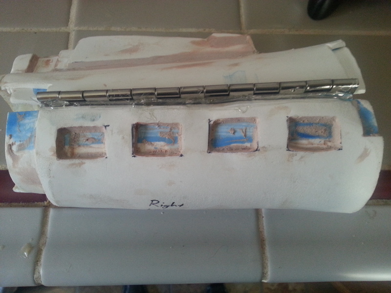

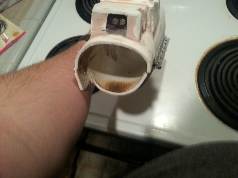

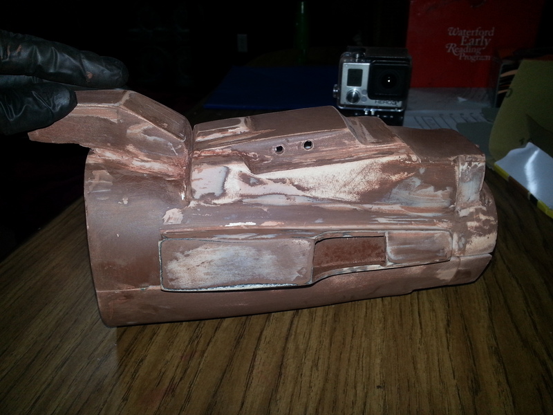

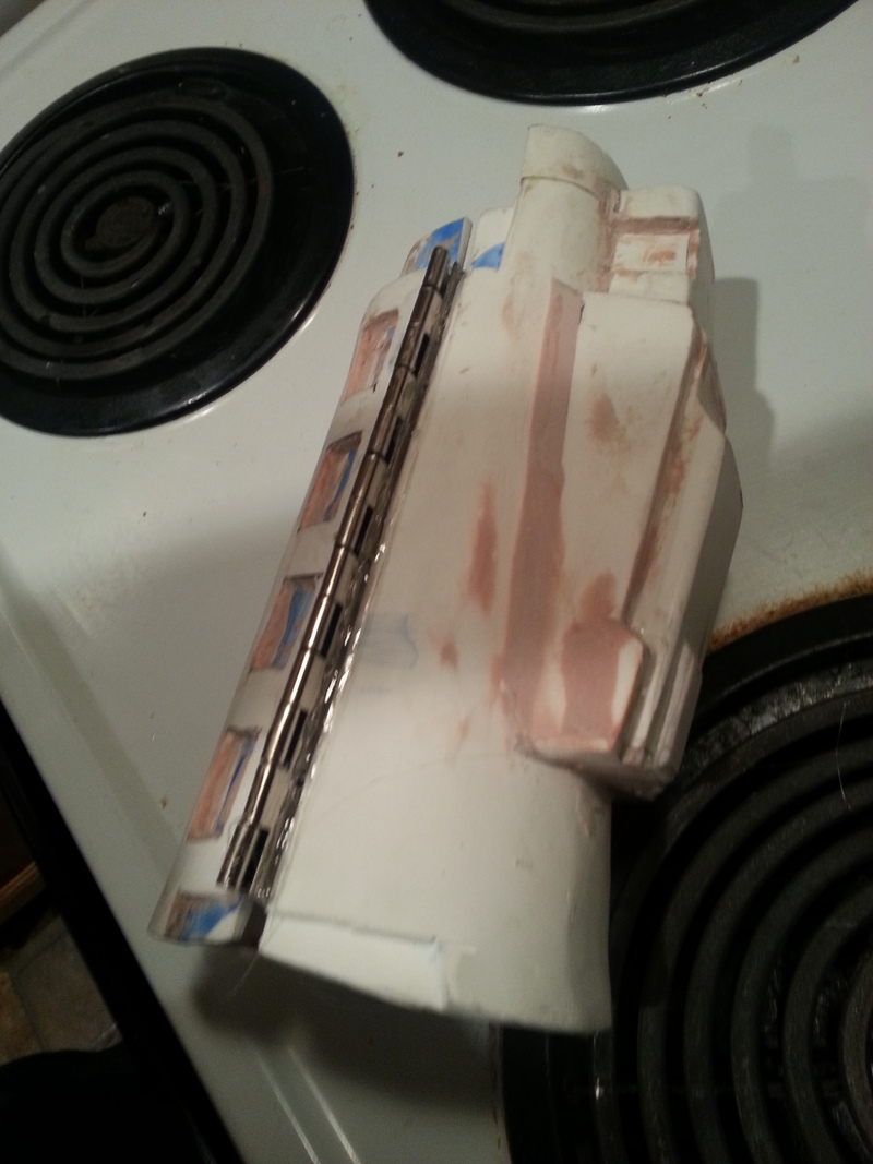

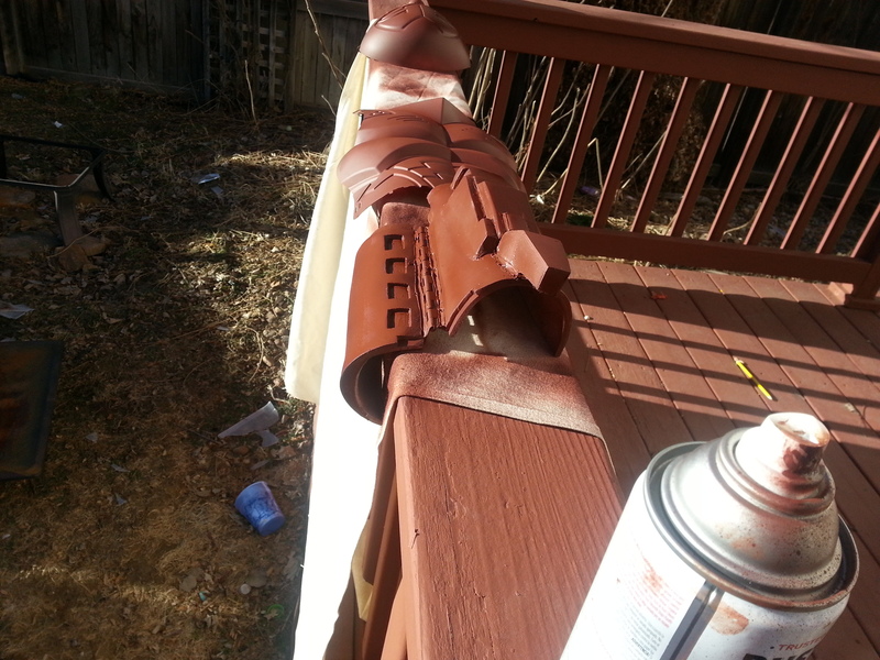

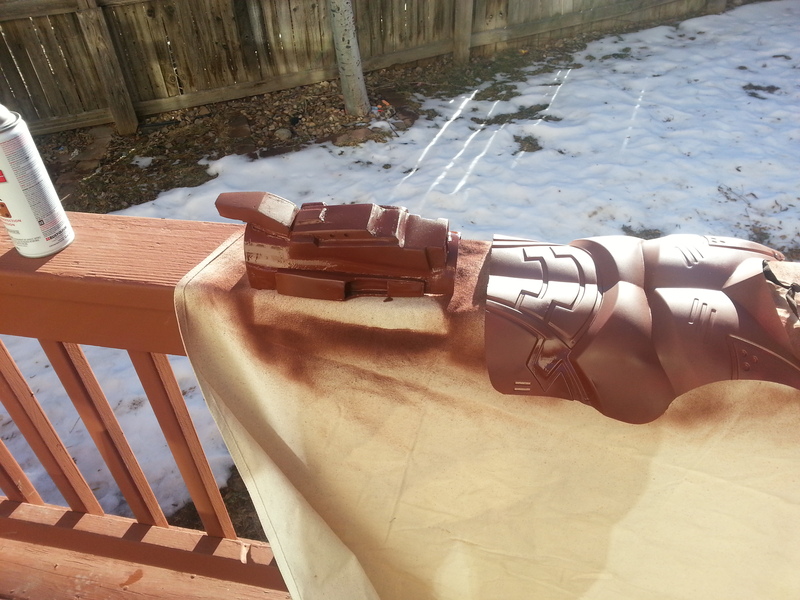

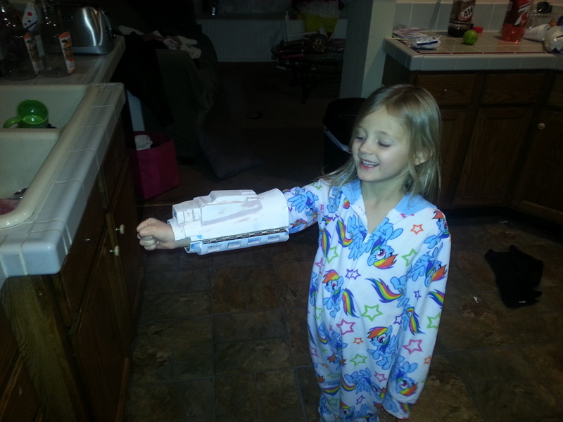

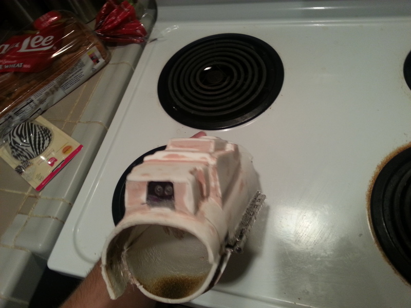

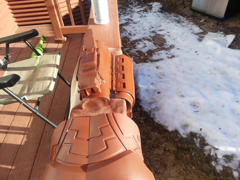

I put a coat of primer on the right gauntlet today after putting on the rest of the pieces, and cleaning up some of the edges. I will still need to do a light sanding once dry, and clean up some of the edges then maybe one more primer and shoot a base coat of green down.
Before Cleaning up the Bondo and one about half way through. I also straightened out some edges with the exacto knife. I didn't take video for that part.
I like the rust colored primer to me it works that way if it scratches through to the primer it just looks older.

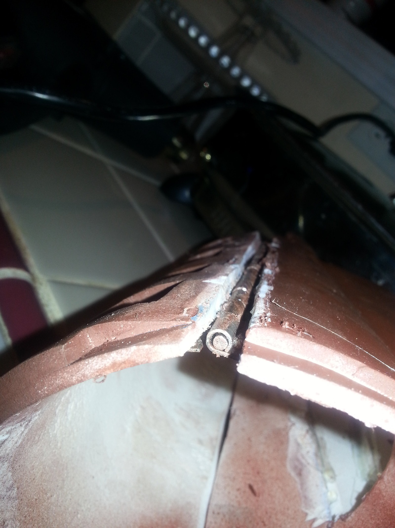

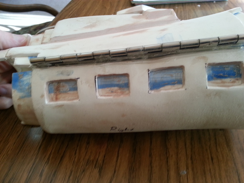

Two things on your gauntlet hinge. It's better to dreamed out the hinge are on the forearm so the hinge doesn’t extend outside of the guantlet. Not only is does this look better but is MUCH safer for when you are walking around. I already stab so many people with the guantlet darts it's crazy, but that hinge could extremely easily snag on someone else's clothing hurting you, them, or both of you. There are lots of tutorials posted here on hinging Guantlets. When you finally put on the suit in full you will realize how very little situational awareness you have walking around in the suit...every little bit you can do to prevent someone from possibly getting hurt should be taken.
Sent from my SM-G900V
Dreamed out? I am assuming an auto correct issue there.
I think I know what you were saying. I moved the hinge a few minutes ago. I think it will look much better the new way. Thank you for the tip. I wasn't in love with the way the hinge was sitting I feel much better about it now. I did it very quickly too. Still have to let the primer fully dry, then I will bondo, sand, and smoothe one more time.
Yea that is cell phone fail...Dremmel = dreamed. Another thing to consider is to build bondo over the edge of the hing on the inside to insure a flat surface. it helps build strength into the hinge, but more importantly wont snag your flight suit arm and accidently tear it while wearing it. The other side (aka open close) can be secured via velcro, magnets (use STRONG magnets) or a removable hinge pin. On my gauntlets I use magnets which keep the gauntlet close together and have a small piano hinge near the far back to "lock" my gauntlet on. The hinge only about 1.5 inches long...and the magnets basically keep my gauntlet closed. The advantage of this setup is you will have some wrist flexibility (the gauntlet can pop slightly) but never fully open at the wrist...something awesome when wearing the costume in locked wrists for a few hours (while holding a heavy blaster).

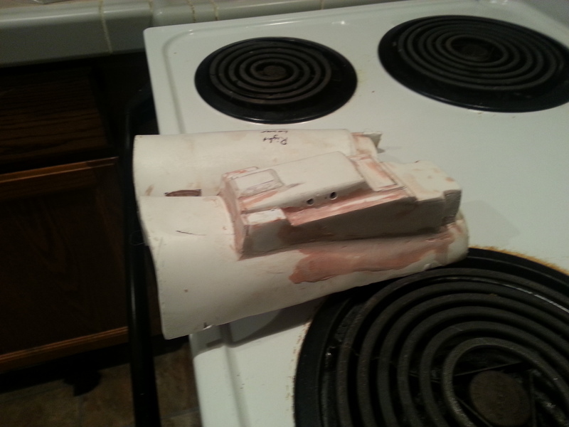

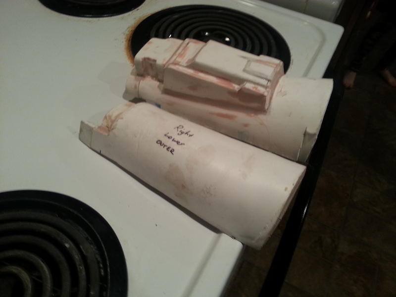

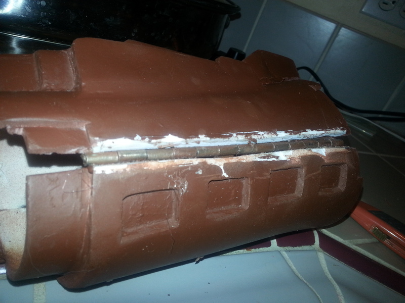

So today I finally did a little work on the costume:
1. Removed excess hot glue
2. Added bondo (Thank you beetle for mentioning mixing bondo on glass and keeping the two parts apart, and only mixing about 5 minutes worth at a time. Clean up was a breeze)
3. Sanded the right gauntlet, the kids wanted to help today so there was some negative work, but worth it if they are interested.
I am going to wait on the painting until I get practice with the air brush and enamil paint. I think I am going to attempt the knee pads next.
The goal is to build everything before I scratch build the helmet. I want all the current experiences to finalize before I take on the more important part of the build and that is the Helmet. Below is the current what I can think of list in somewhat the order I plan do get it done.

Here are some sanded pictures.
