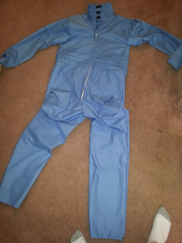

View attachment 93002View attachment 93001

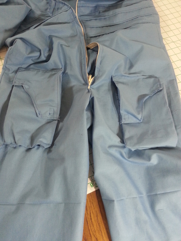

The picture on the right shows before I added the collar, the picture of me on the left shows after I added the collar. The flight suit was almost done, but I still needed a collar and pockets (I still haven't added the shin pockets at the time of writing this)
In video 3 which is quite a bit longer. I added the collar, as well as the pockets. I learned quite a bit, but still made some annoying rookie mistakes. Which included a TON of seam ripping. I also took in the pants and several areas much tighter than what they were I could have probably saved quite a bit of material if I would have done a better job making my legs smaller. I also wasted some material when I made the sleeves literally to small for me to fit my arm in (Which I had to laugh at, because my arms aren't that big). If I were to do this again I would keep the neck seal on the flight suit but I would do it in the white material so it would be more "movie accurate".

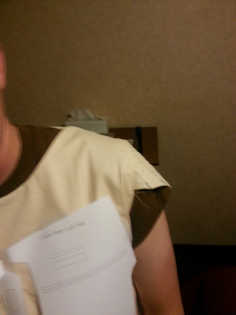

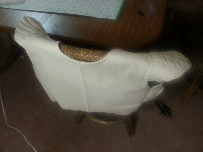

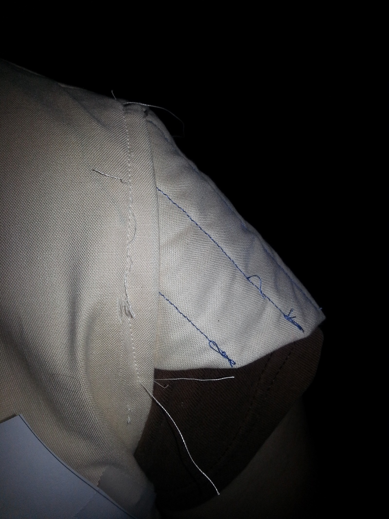

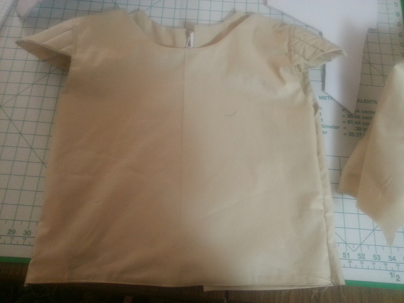

So after the flight suit I went right to work on the flak vest. I used some pictures from the internet and drew a pattern on the material. It turned out almost perfect. The only problem is the front doesn't have a wide enough shoulder piece, but other than that I like it. Also I really wanted to make it zip from the side, but couldn't find a short enough zipper when I was out and about that day that fully separated. I still have to add the panel to cover the Zipper in the back, and a real pull string to it. I works how it is right now. I also didn't get any video of making the sleeves, but pretty much I made sleeves, doubled with batting for padding , then I positioned them in the sleeve until they pointed in the direction I wanted them and sewed them on. I hope you enjoy the video and pictures.
Here you can see the gap, that exists, but can also see the flight suit.
Here is a picture of the vest on with the little sleeves:

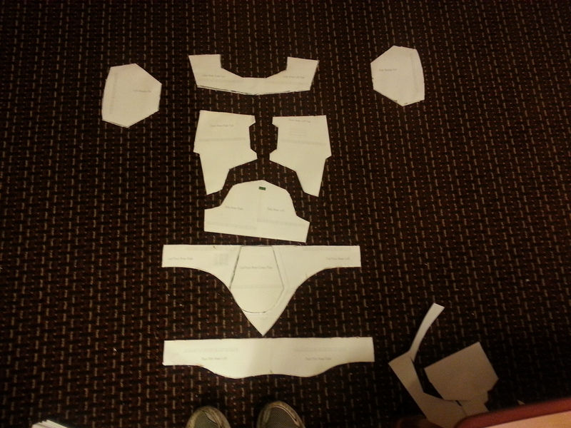

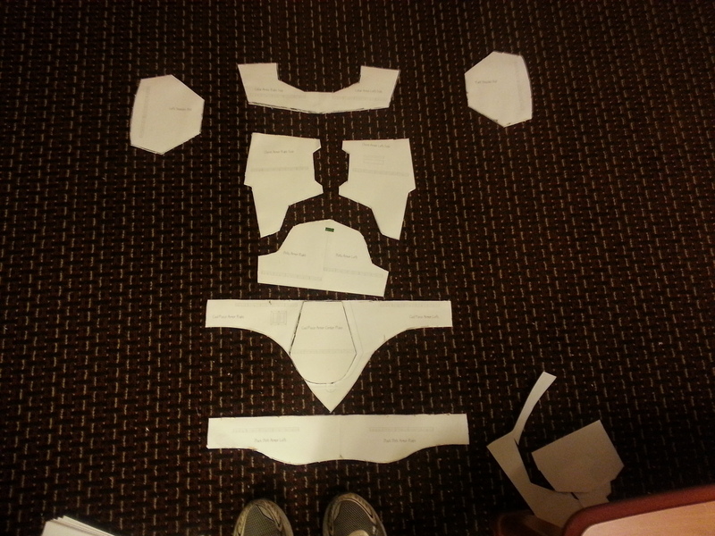

So the fun part started. I got some expanded PVC foam (sintra) from a sign shop (FastSigns) it was remnants and the young lady working the counter just gave it to me. I got enough there to do the chest, shoulder, and waist armor. I did not have enough to do the knees, back armor, or gauntlets (If I use it to even do those). I have since purchased a heat gun and lots of other little nick-nacks. This project is being done on the cheap, but it is really starting to nickle and dime me. I used the templates from this site, laid them out on the sheets and then started cutting it out with my dremel. I am on a business trip so the back drop of the next several videos is a hotel room, luckily it isn't tiny.
Pictures:

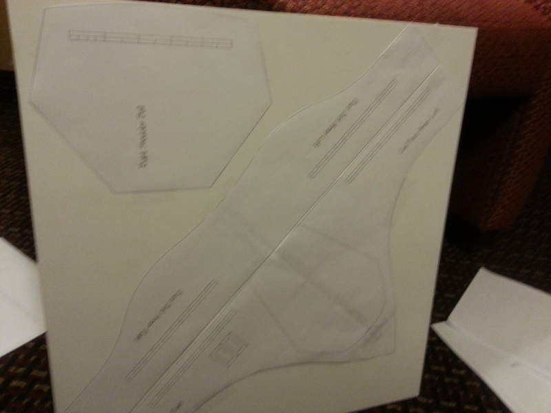

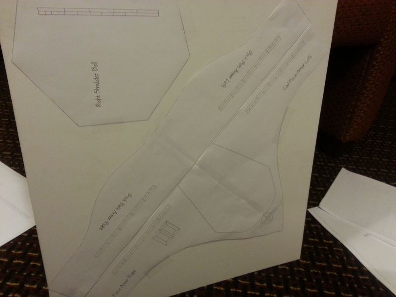

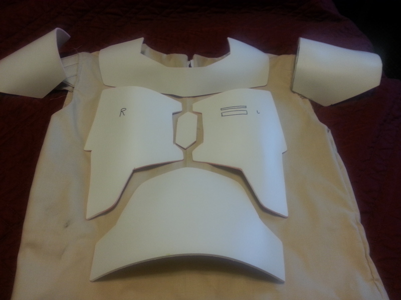

Template testing on vest, I wish I would have tested the collar I didn't think about it, but I did almost everything else.

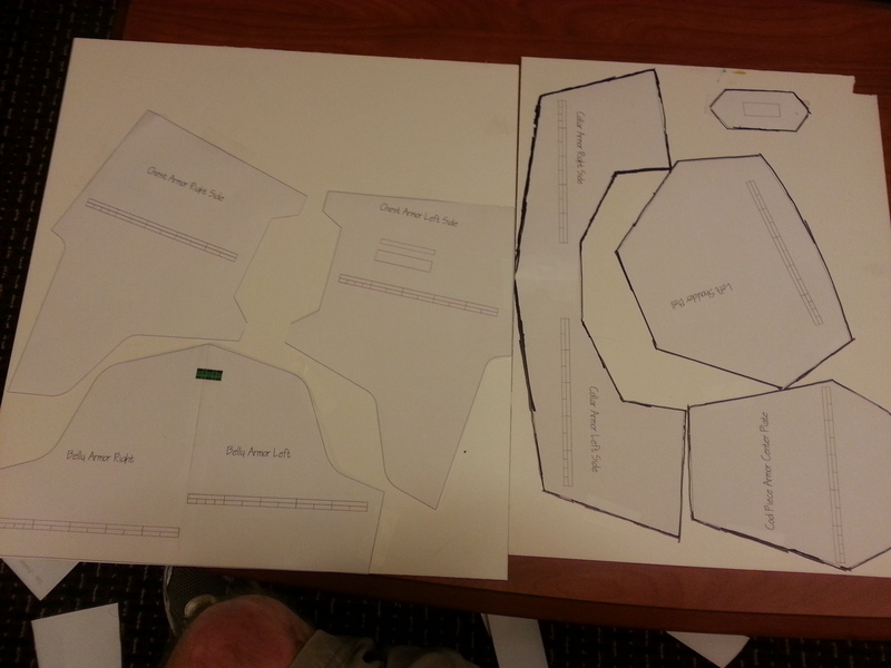

Laying out the templates
And Cut out!

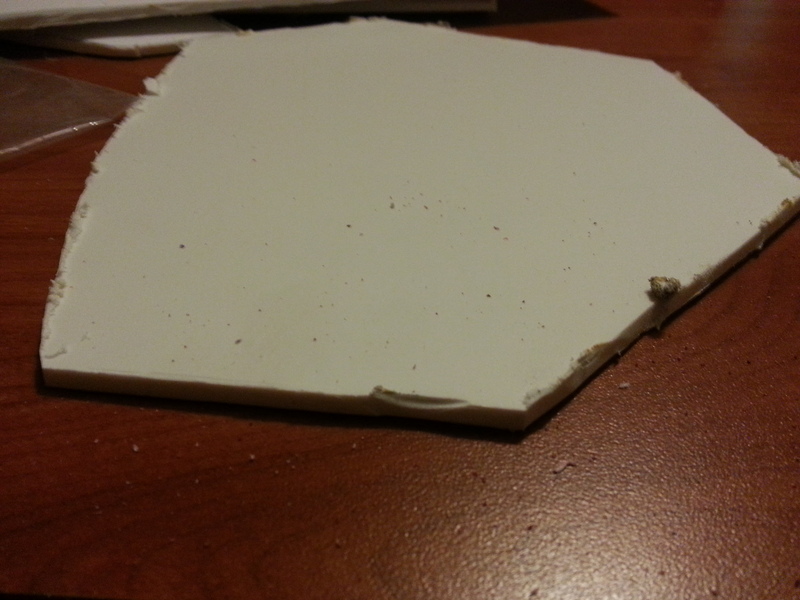

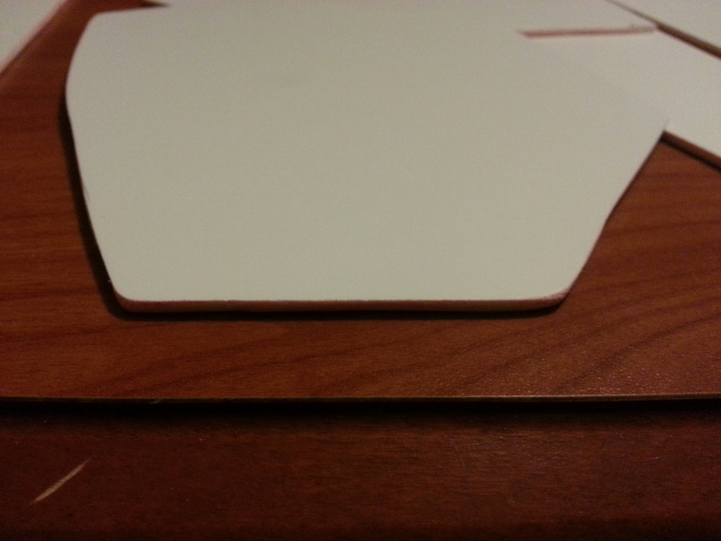

After I cut out the pieces I noticed there was quite a bit of sanding that needed to be done to clean up the edges. I also used that opportunity to bevel the edges as well on the corners. There isn't much to say about the process. I got some cheap sandpaper from Harbor Freight when I picked up the heat gun, and the whole time wished I was at home where I have an orbital sander I could have used to make short work of the pieces, but when you are 500 miles from home and in a hotel room you make due.
The before picture of the edges of the shoulder pad:
This is after I got done sanding:

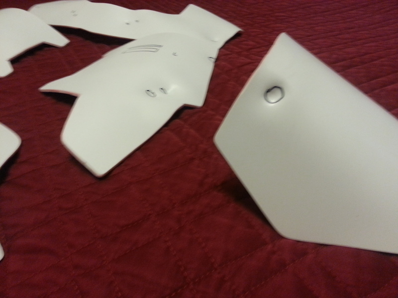

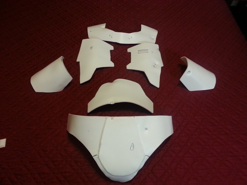

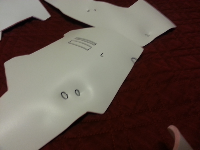

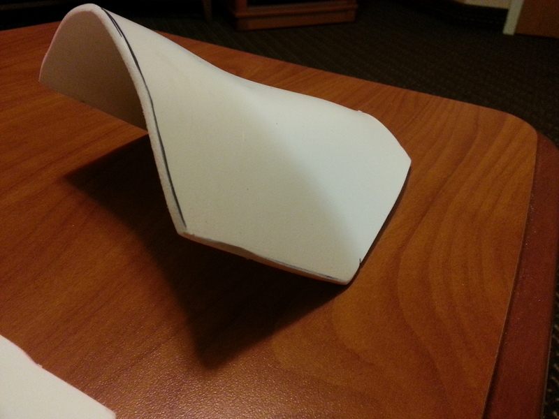

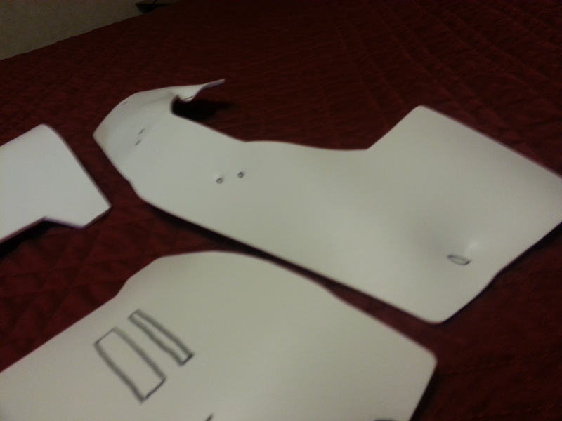

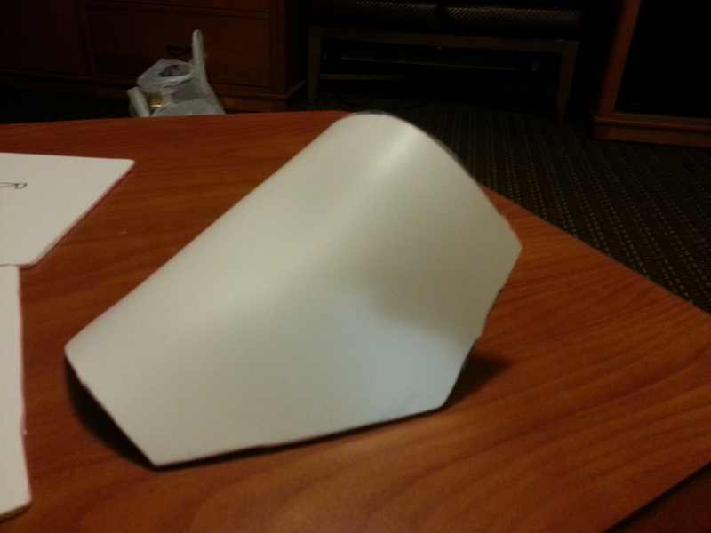

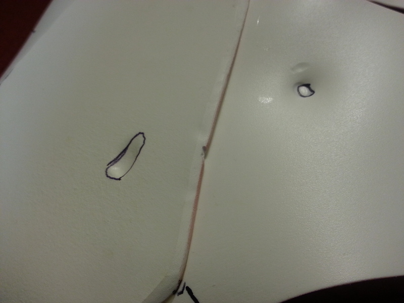

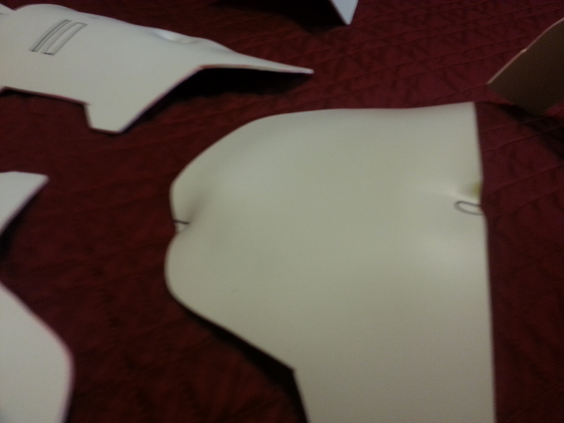

After I cut the armor out I started shaping it. It wasn't that hard to shape the chest, stomach, and shoulder pads. The collar and cod piece were not as easy, but I think all turned out well. After I shaped the pieces I added pock marks and large dents to the items.
Here are some photos of the newly shaped pieces.

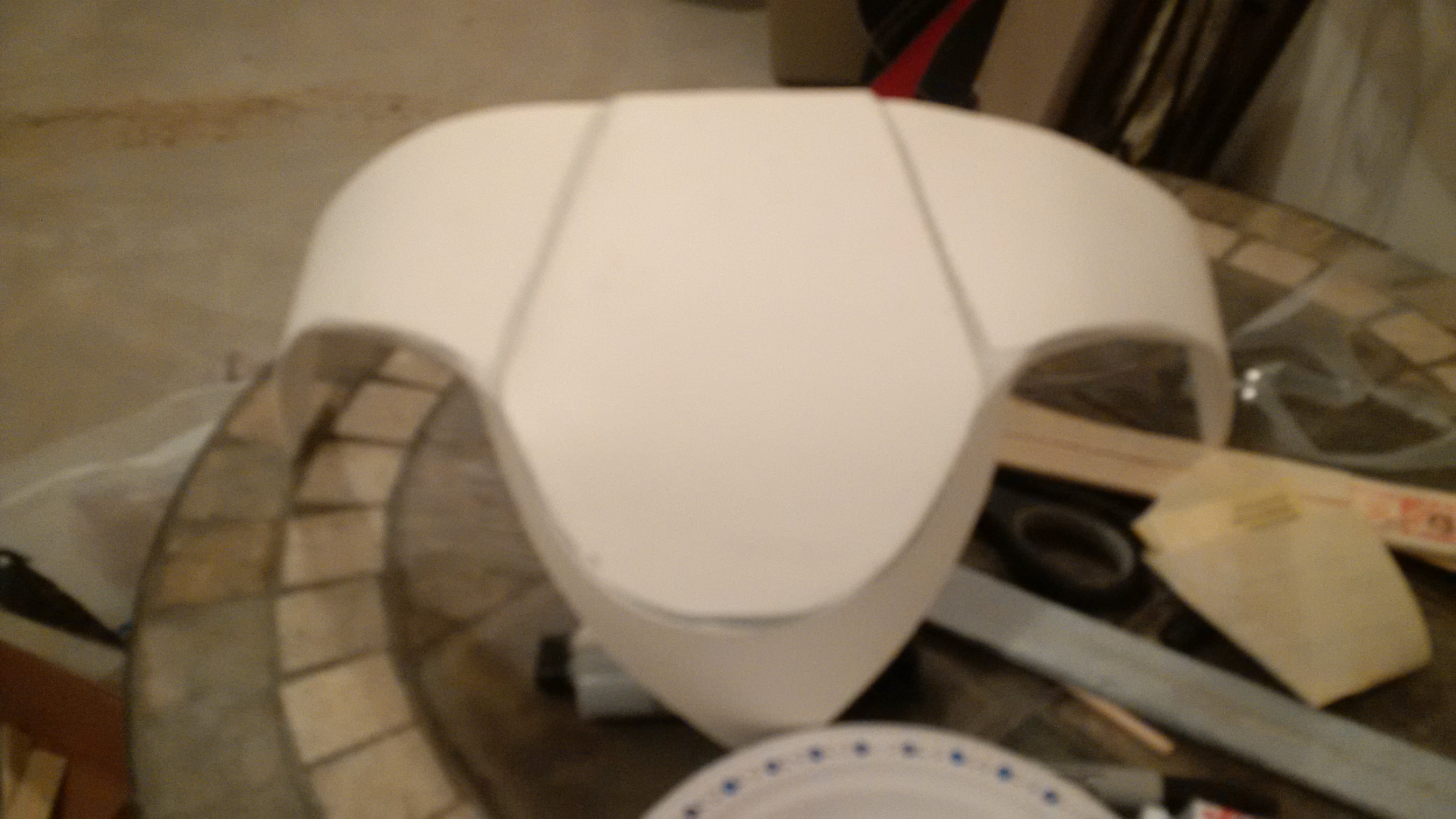

I recommend you make your COD piece from three pieces, Main strip, front plate, and bottom cusp. By separating the bottom cusp you will be able to achieve a better profile

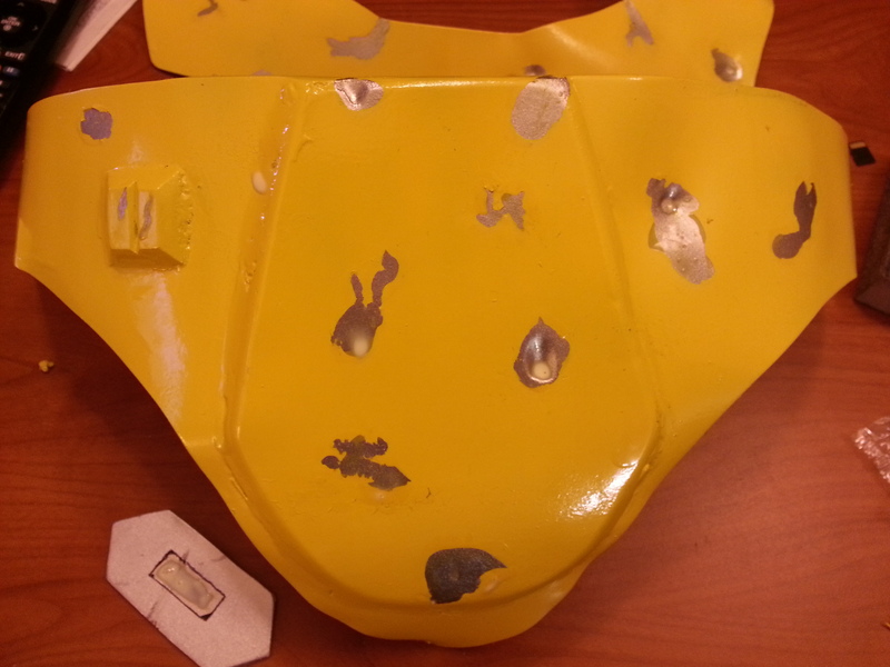

Malkavian. Here is the reason why it was no good getting the advice about the three pieces. This cod piece work was done almost a week ago, I am just getting around to writing the post.
The cod piece shaping could have been accomplished better another way. But live and learn. I built up the buttons using two layers of pvc sheet. If I were doing it again I would have done the intelligent thing and put another layer of Bondo before painting. As I have said before, I have a bad record with patience I just want to get this done so I move too quick sometimes. I still haven't fully decided how I am going to mount all of these things to the flight suit. If anyone has any suggestions I am leaning towards velcro, or snaps. I think velcro would be easier, but I don't know if everything will stay put. Don't want to loose the pieces while I am walking away. The pictures above make it seem like I did the cod piece work at the same time. I actually did it a day or so later.

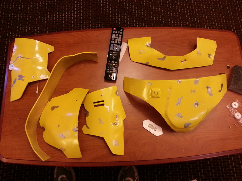

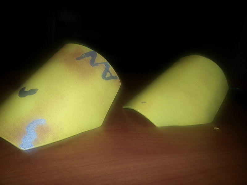

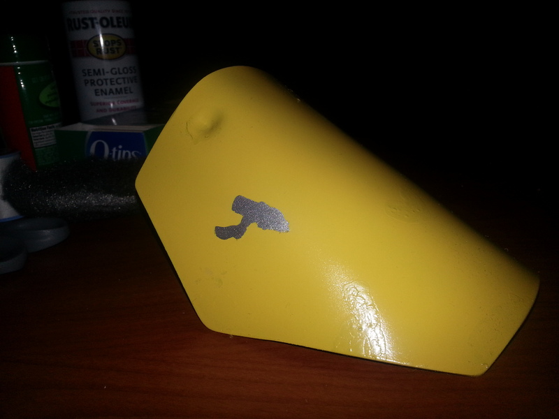

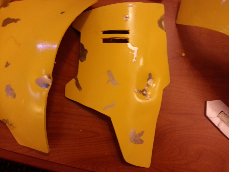

In today's video I added the battle damage using a heat gun and just a sharpie to dent the pieces. It was not that difficult and it was the last step before painting. I have since painted and repainted the pieces several times as I went WAY overboard on the amount of "weathering" I applied to the armor.
The denting technique was not difficult the heat gun and pressing the piece to me worked wonderfully. The battle damage is done with masking fluid I first bought from hobby lobby for $15 then found at Walmart for $7.50 so I took back the hobby lobby stuff. You can see in the video I already have the primer, silver, and yellow coats of paint. If you look closely I did the masking video after I did the de-masking video. I think it worked out pretty well. But I had to tone it down ALOT. I figure the paint video should have probably come firs, but I will finish that one in a couple days because I still haven't finished all the painting.
Pictures:
