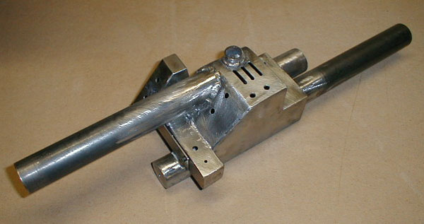

For steel, I'd go mild steel and wall thickness definitely not over 18ga. otherwise it would weigh a ton. It would be very durable. I once welded up a Ghostbusters proton pack wand from 16ga. steel and you could have thrown that thing out of an airplane and not hurt it. Check out the pics.....
