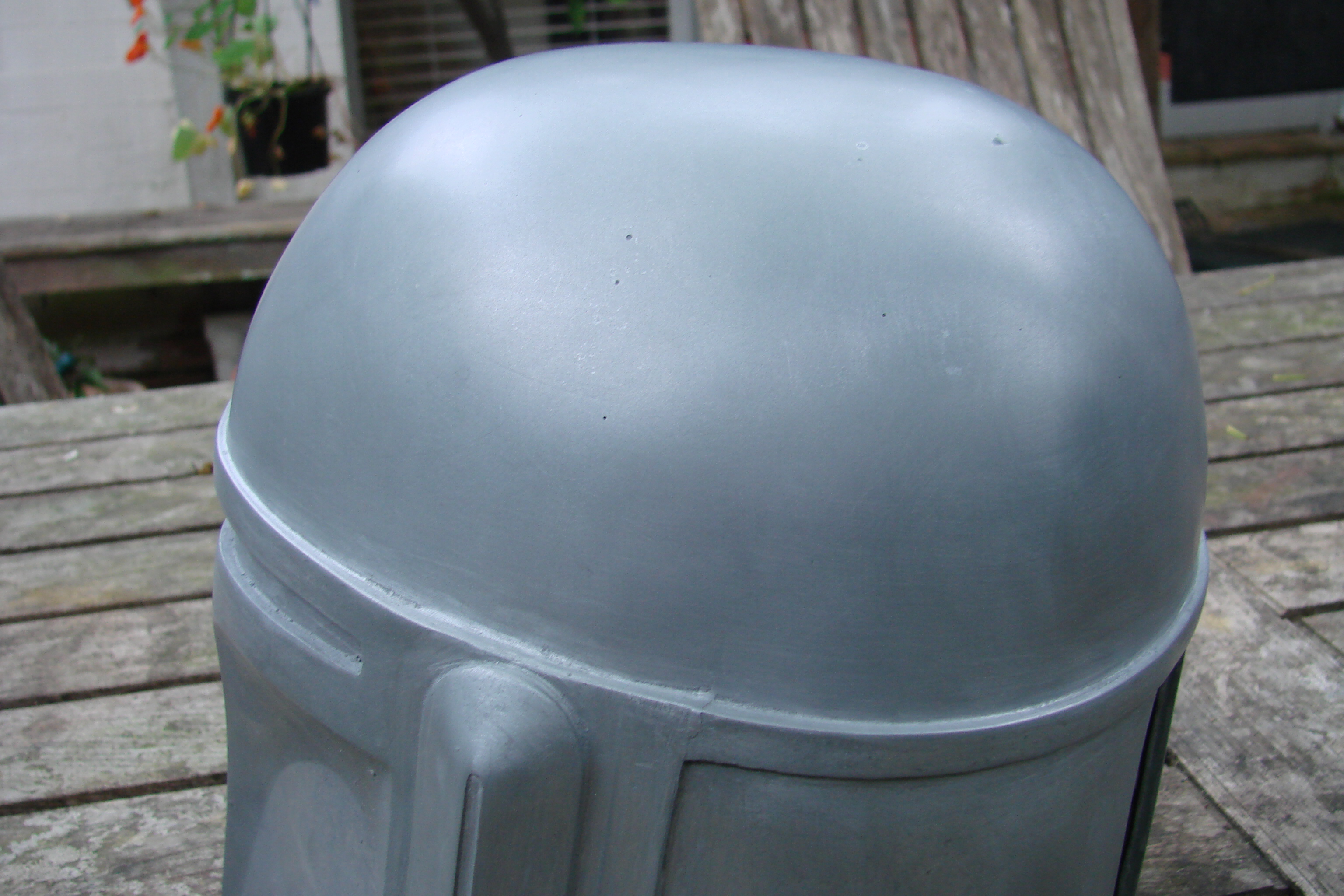

Got my Asok Jango ILM lid a few days ago ,Impresive most impresive , IT TOOK ONLY 10 DAYS! from payment to posesion and that includes making it sending it from the U.S to Aus then customs , thats unheard of in my experiance any way ,

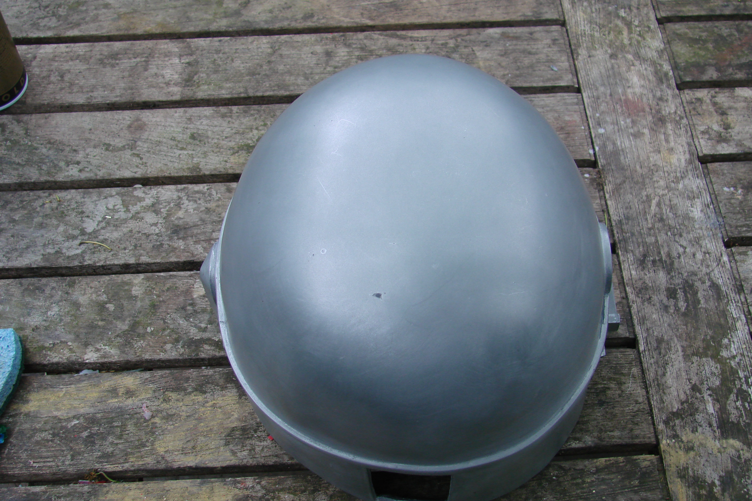

I got in to work on it trimed her down sanded out the seem in the dome, managed to get rid off it compleatly DSC03819.JPGDSC03818.JPGDSC03819.JPGDSC03818.JPGsorry about the double pics
Biggest advice on a cold-cast is just make sure you don't OVER sand the silver areas, cause what will happen is the the silver powdered resin will rubb away, revealing standard fiberglass, that can ruin the entire finish. I use a 00 steel wool to "polish" it, and it works very well. Other than that, enjoy your build. LMK if you need any help!
Thanx for the advise iv never worked with a cc lid before,i was very nervous when removing the seam on the dome from the molding but it was a throw up between keeping the seam or removing it and risk going to far i think i just skimed by,

as for sanding, you don't need to be too gentle on the asok lid. there are a couple places you will sand through no matter what, the rest you can pretty much abuse. the spots where it gets this is that booger on the front that sits just above where you right eye will be when wearing the helmet, the other is on the seam just behind the right ear. both places aren't terrible because you can blend them in with the weathering that goes around the band.

With my Asok, I didn't sand down far enough either for fear of taking the CC off. The seam still showed from the mold, so what I did was I sanded a little bit and then thoroughly mixed aluminum powder with superglue and used a popsicle stick to apply across the seam... I made it a little thick so I could sand down to the same level as the rest of the helmet... when this dried I sanded (320 grit, 400 grit, 800 grit, 1000 grit, 2000 grit... yes a little over-kill, but I wanted it smooth) and then I used 0000 steel wool and shined it all up... it didn't come out too bad and matched pretty good :)
