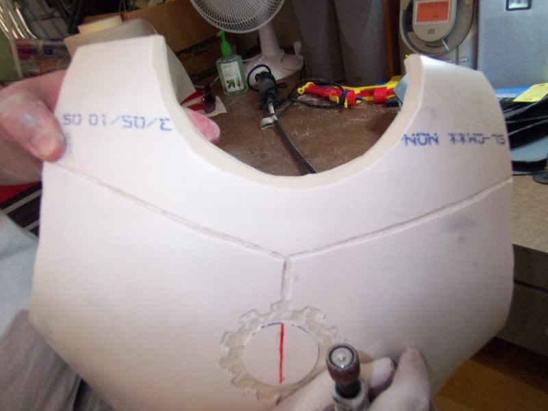

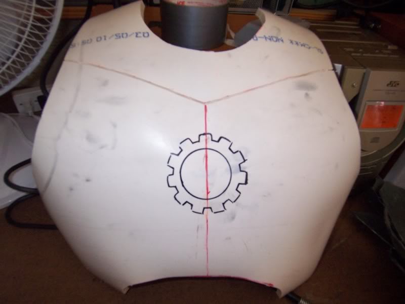

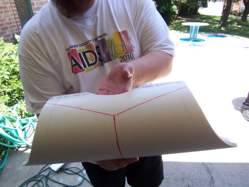

I Started with 6" PVC pipe and traced the stencils on. I did A rough cut and then final cut.

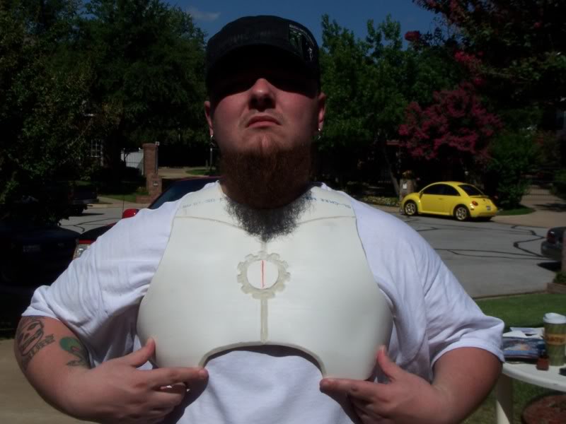

I used a heat gun and another scrap piece of PVC as a buck to smooth and shape the breast plate. I also traced the design of the chest insignia.

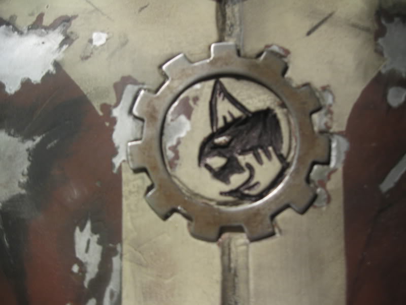

I used a dremel to cut reliefs in to denote the shapes of gorget and individual armor plates. I also used the dremel to carve out the Cog shape a bit and to bevel the edges of the plate. I have a real steel cog that I will be inlaying in the chest then carving a reeks head into the center (Murraan Clan sigil)
here is the final fitting before i start final sand and Fit and Finish.

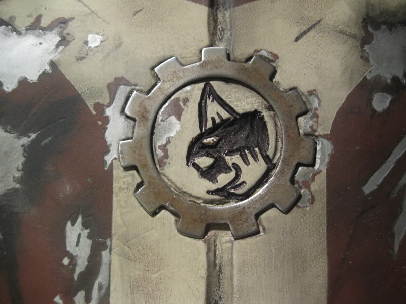

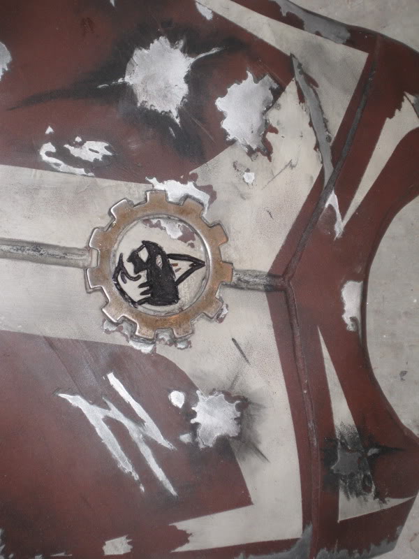

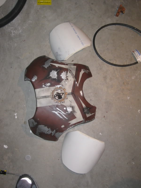

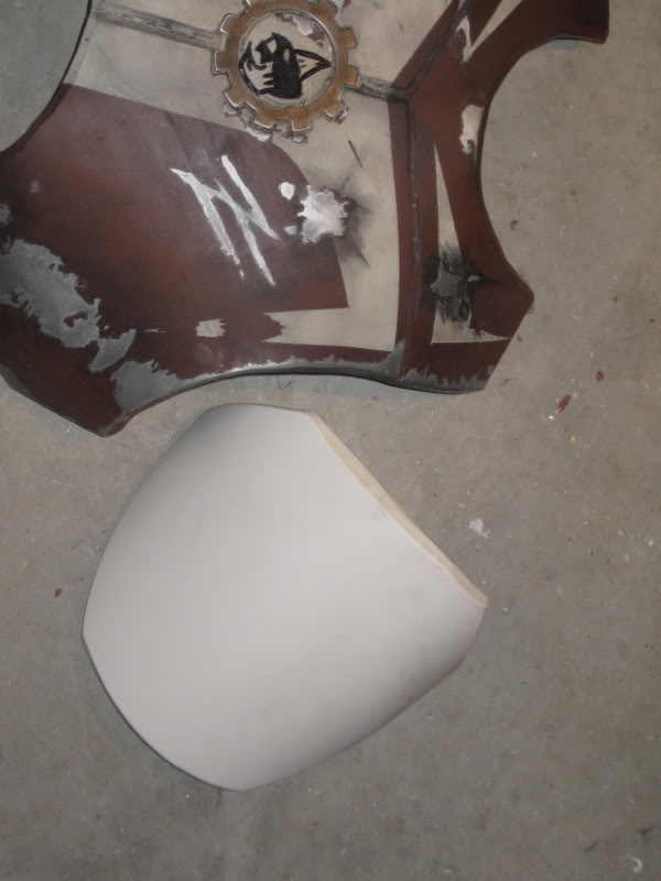

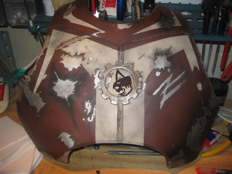

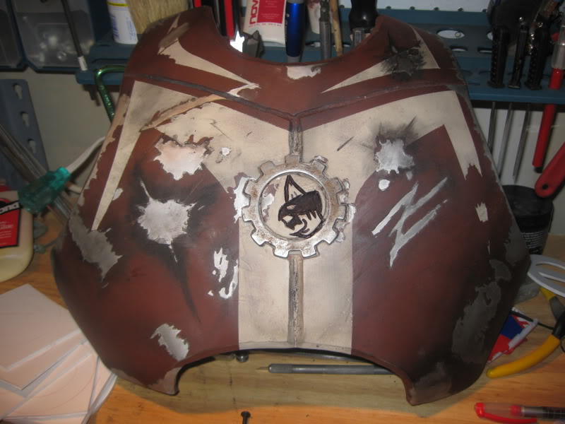

Here is the Finished breast plate and start to the new shoulders. Work on this has been slow, as I dont have a work space of my own, and relying on the generosity of other people for their garage. lol
The silver was done with Rub-n-Buff. I painted the raw PVC first, masking damage off with toothpaste. After all the paint was done, I cleaned up the toothpaste, leaving only primer undernieth. At that point, I had green damage. I masked off AROUND the edges of the damaged parts with Ben Nye liquid latex. Once the latex was dry, I added the RNB with my fingers and buffed to a high shine. After the masked off portion was done, I free-handed a little more RNB for worn damage (as opposed to chipped). Then it was a matter of just using some artists charcoal to do the carbon scoring and grime. I put a dull coat over the entire thing.

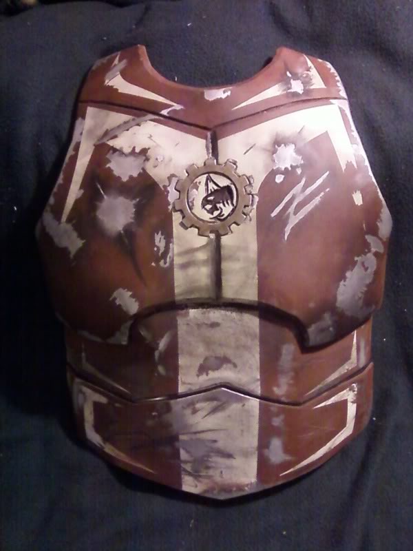

here is the completed chest/ab plate. What do you guys think?
Again, this is more of a Legacy style build, but ultimately, it will be a hybrid of legacy and Modern.

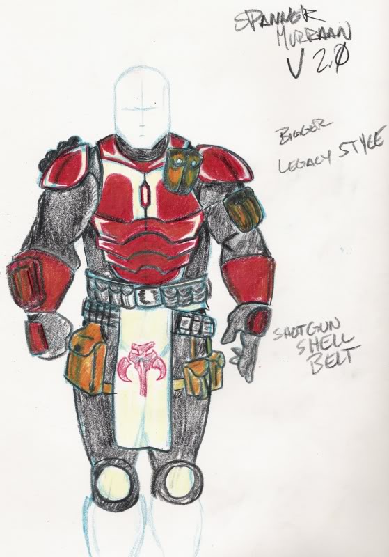

That looks awesome dude. Can't wait to see it finished. Just throwing my 2 cents in, and maybe you already thought about this stuff but what about bicep and thigh armor? I think your design would look a little better with it.
Actually, I had thought about it. But my Character is a combat mechanic and sabatour, so I thought those spaces would be best reserved for tool pouches, and weapon holsters and such. Plus it would help with mobility and such... blah blah. They look bare in the drawing, but I actually have a lot planned for those areas

wow just wow!!! i would love a set of chest armor that looked like that!!!. that is amazing!!! how in the world did you shape that from pvc pipe?? i know you used a heat gun but geebus that looks thick... you must have some great upper body strength!! B^) great job!
also is there any chance youll share your stencils with us??
