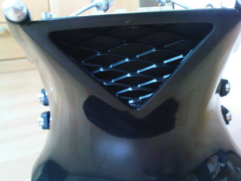

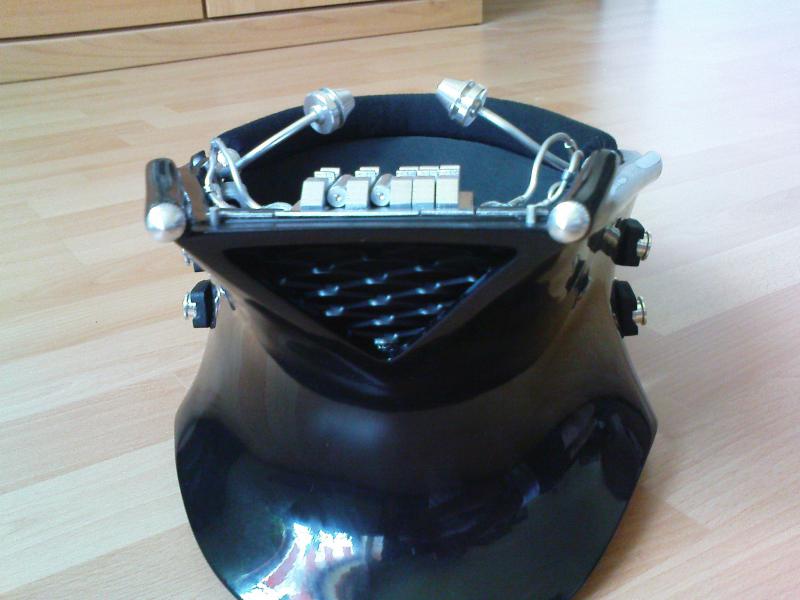

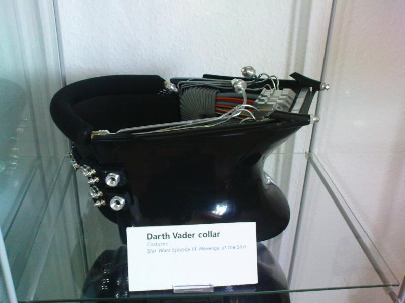

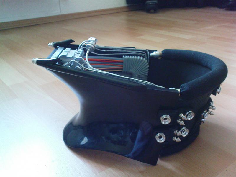

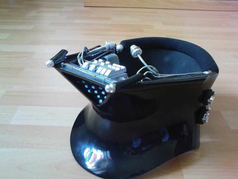

After 1,5 years i finaly finished my first part of my RotS reveal mask replica:

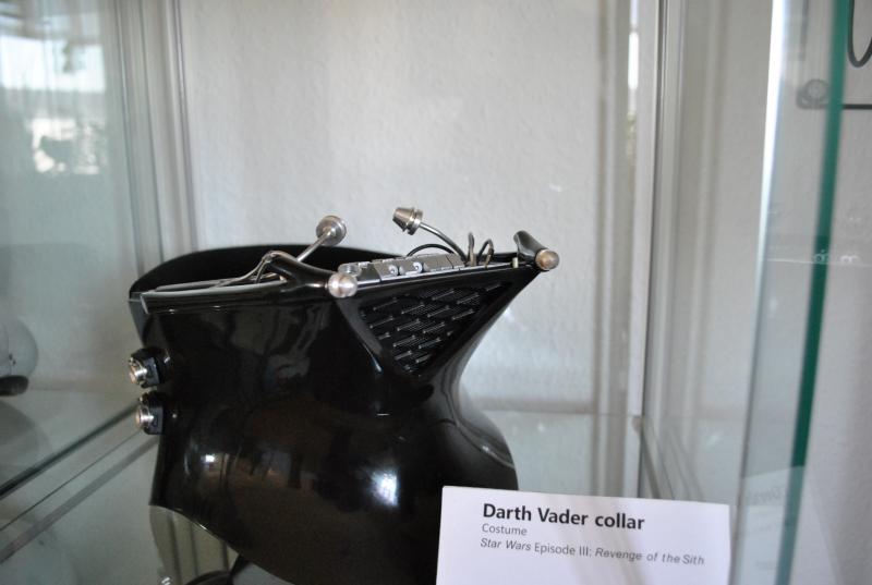

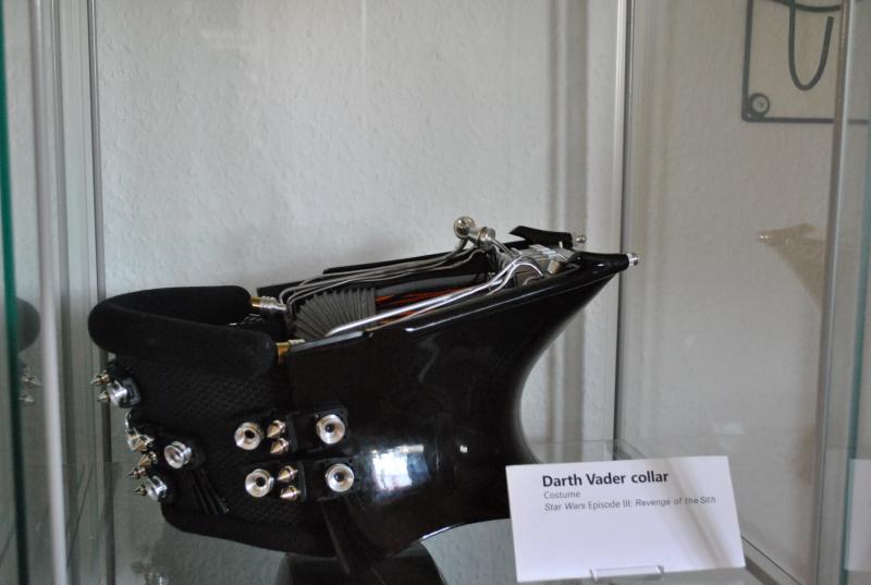

And here with the replica exhibit plaque

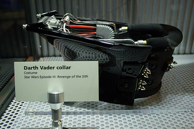

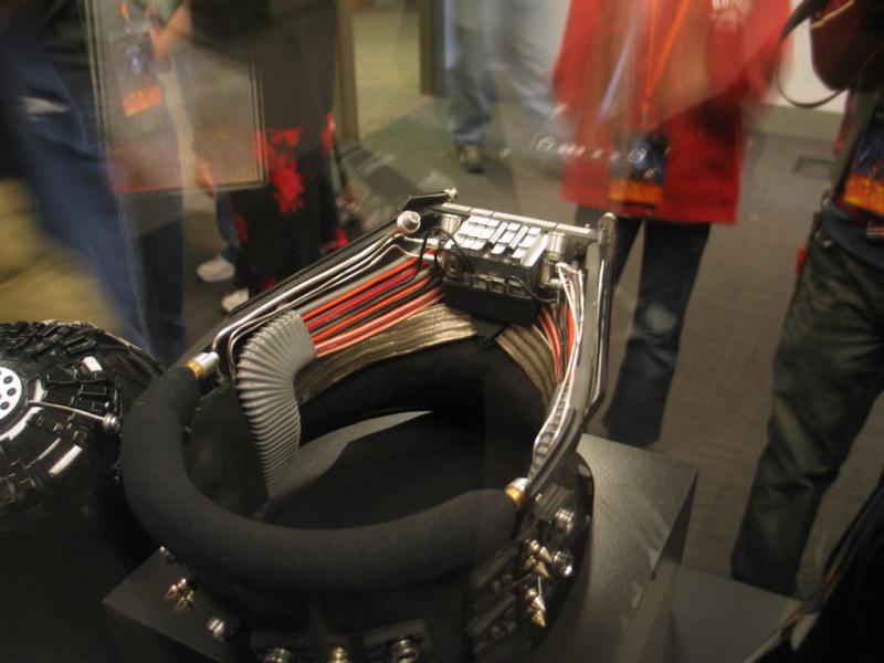

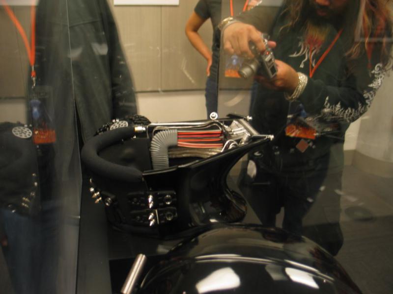

And some comparsion pic's to the screen used:

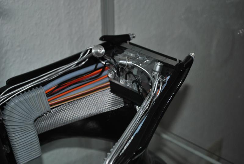

edit...i have seen i forget 3 wires on the vocoder....will add these of course. :lol:
Nice work! Don't be shy - details, details!

Hi Azrok,
The raw chinpart and uppermask i got from fettpride here.
The chinpart was more in prototype stage so i have to scratchbuild 90% of the rest of the parts.
Here's my WIP thread in the propden:

The prop itself:
The orginal were made by Don Bies.
It later got displayed on some exhibits like the MOM,Celebration IV and Where Sience Meets Imaginations.
The last display pic's you see above were made in my display cabinet, i also just also made a copy from the exhibit plaque.
So till yet it only got displayed at my home.I just tried to get it close as possibe to the screen used. Seems it works :)
Parts:
Cause of the partlist, well i didn't have one, lol.
There are machined alu-parts like the wheels on the neckseal,the endcaps on the neckbrace and the airnozzles as well as foundparts like the spikes on the AM plugs,tusks,and braided-wire-hose.
The neckseal mesh was made in the lasercutter as well as some parts for the vocoder.
Some other parts got scratch build by hand or are rotocast resin parts.
So it's something from each source.
