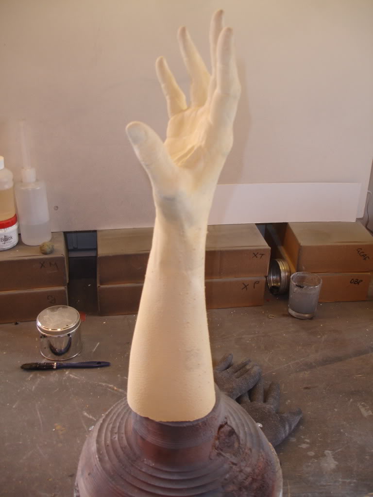

One of the few things I am able to life cast on my own is my right fore arm.
I started by plugging some drainage pipe with a piece of mdf.
Mixed up €70 euros worth of alginate(dental impression material) and stuck my arm in.
2 mins later I pulled out my arm and poured in some cheapish dental stone called 'Caffa D'
It's much harder than plaster which helps when you are casting narrow things like fingers.
As soon as that was set (10 mins) I cut away the pipe and carefully pulled the alginate away.
After a quick clean up I coated the cast in Diamond glaze and mounted it on a rotating block ready for the sculpt.
