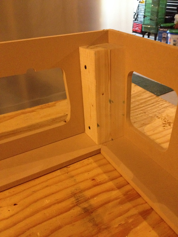

I started with a HIC box kit from Zenix, which arrived very quickly. The online instructions good and easy to understand. I had to make my own corner pieces to attach the sides and top to.
But was able to determine all the angles needed. One peice of advice when the instructions say 2x3, their is a reason! A 2x4 is too wide and will overlap into the control panel holes, so I had to rip mine down to fit.

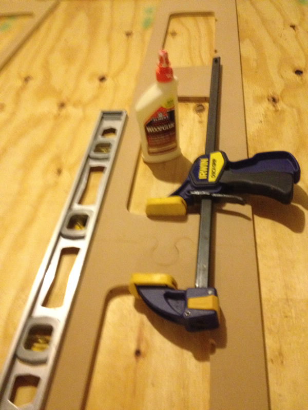

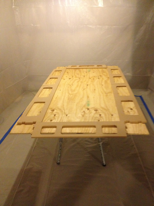

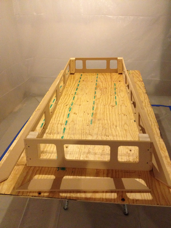

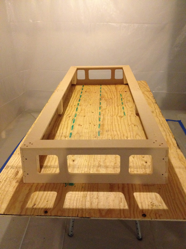

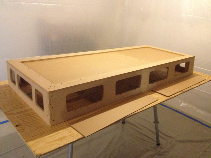

First laid out the HIC kit

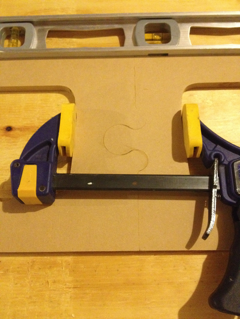

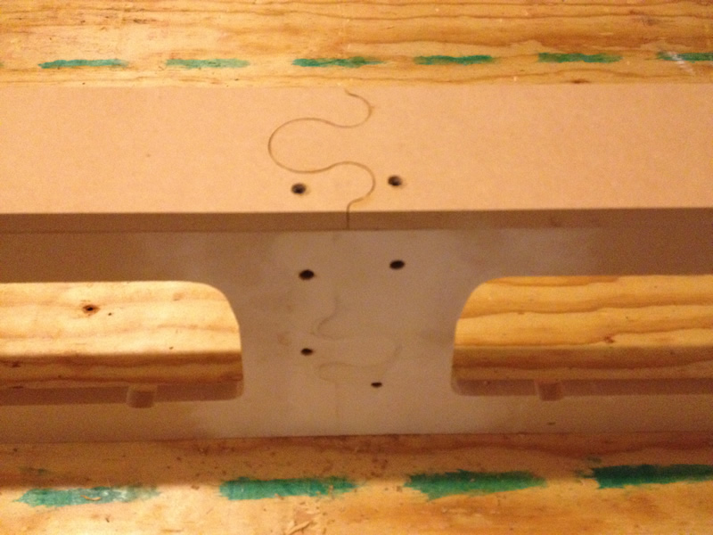

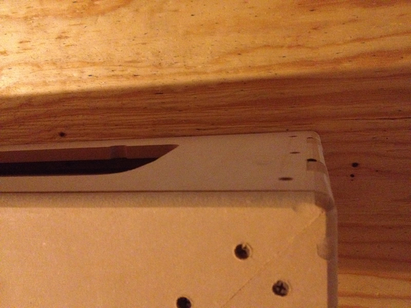

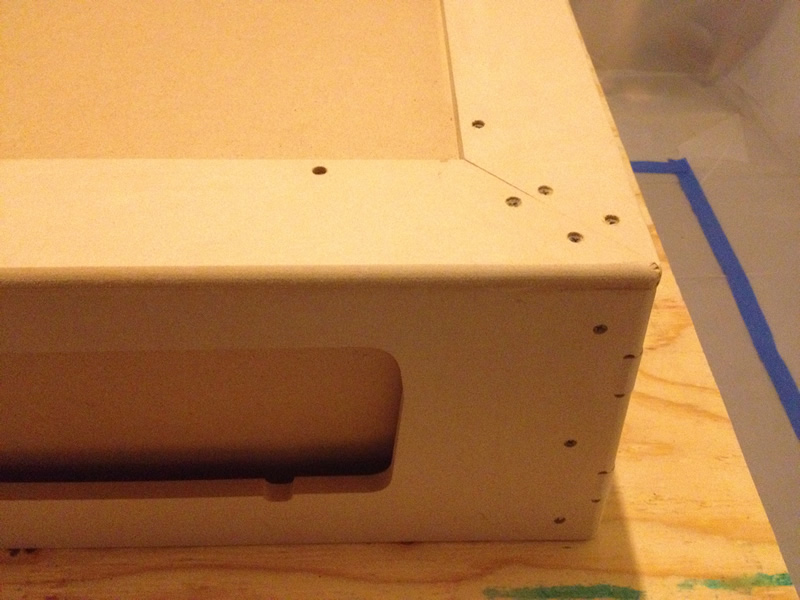

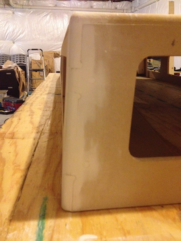

I first glued the puzzle pieces together.

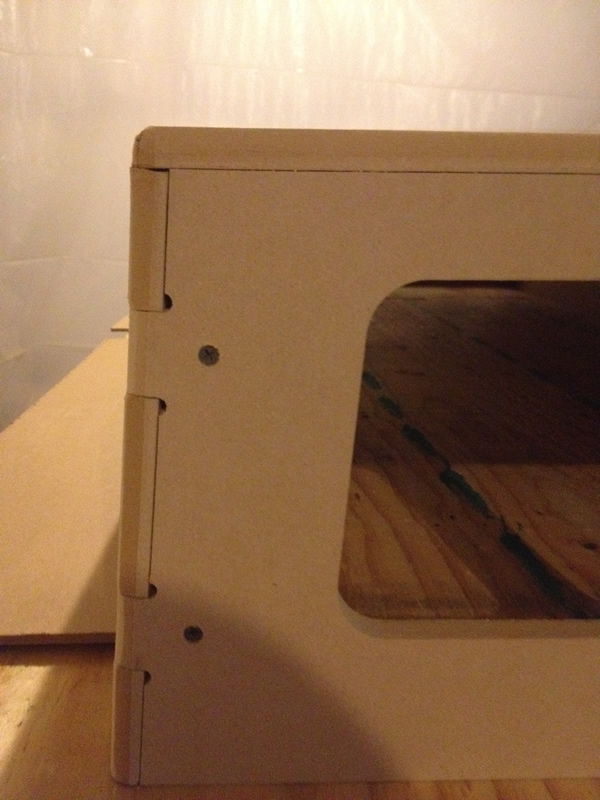

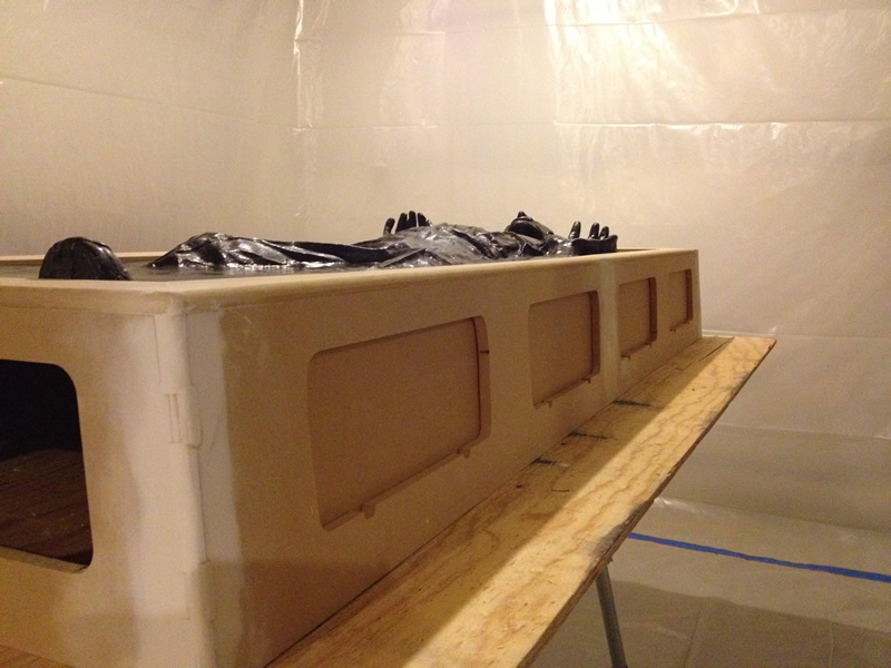

Once the glue dried I put the shell of the box together
Then added the frame to the front of the box

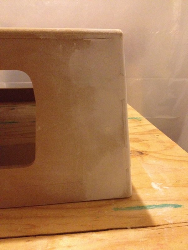

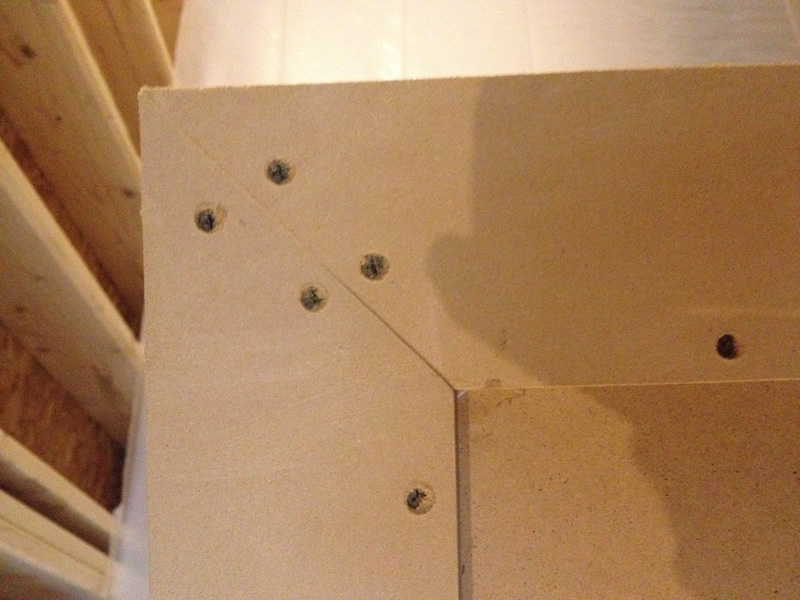

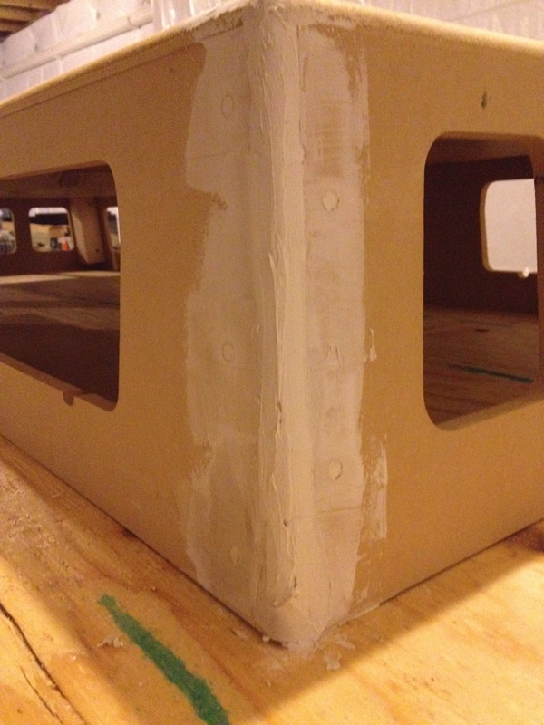

I added some wood filler to the sides to fill in any gaps between the "puzzle" piece connection, thinking it would need some added strength when handling it later when putting the box together.

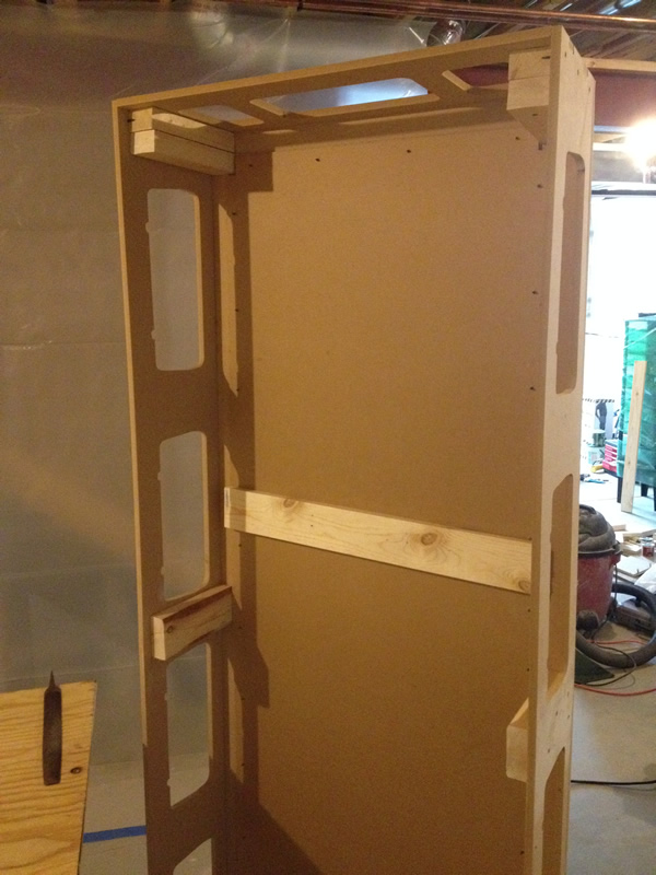

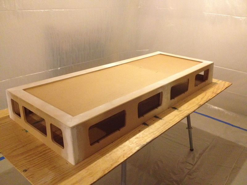

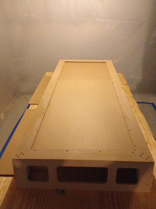

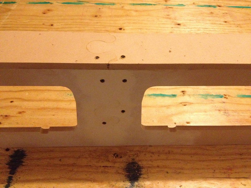

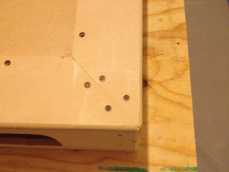

Added the backing, used 2 4x4 sheets of 1/4" MDF board to anchor Han to. I screwed it through the front of the frame. I used a 1x4 on the seem just to strengthen the seam.
Completed box, you can see the pieces of MDF laying next to the box which i will use to attach the control boxes to later. I've been going back and forth on if I wanted to angle the sides or not.

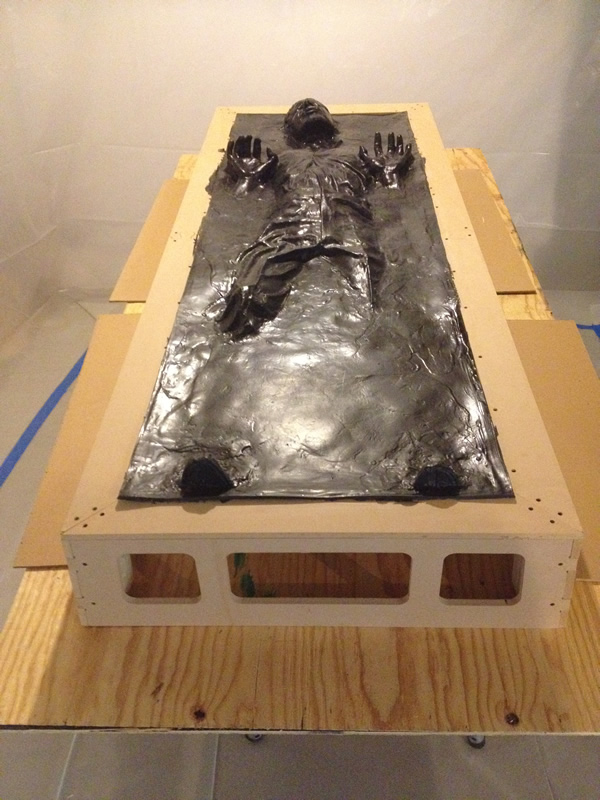

Who couldn't resist to see how Han would look in place?!?!?!
As you can see some trimming is required to make the cast fit inside the frame.
I then choose to round over the edges using a 3/4" router bit.

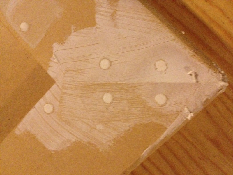

On to filling those all those screw holes. I ending up using drywall compound since I had a lot left over from a previous project and knew it would be easy to sand.
It takes a little longer to dry completely vs bondo or wood filler, but was willing to deal with the added drying time. Only needed two coats to get all the holes
After some sanding, it looks a little better.
Time to put Han back on the table and trim him to fit.
Had to cut off a good chunk off the side and bottom.

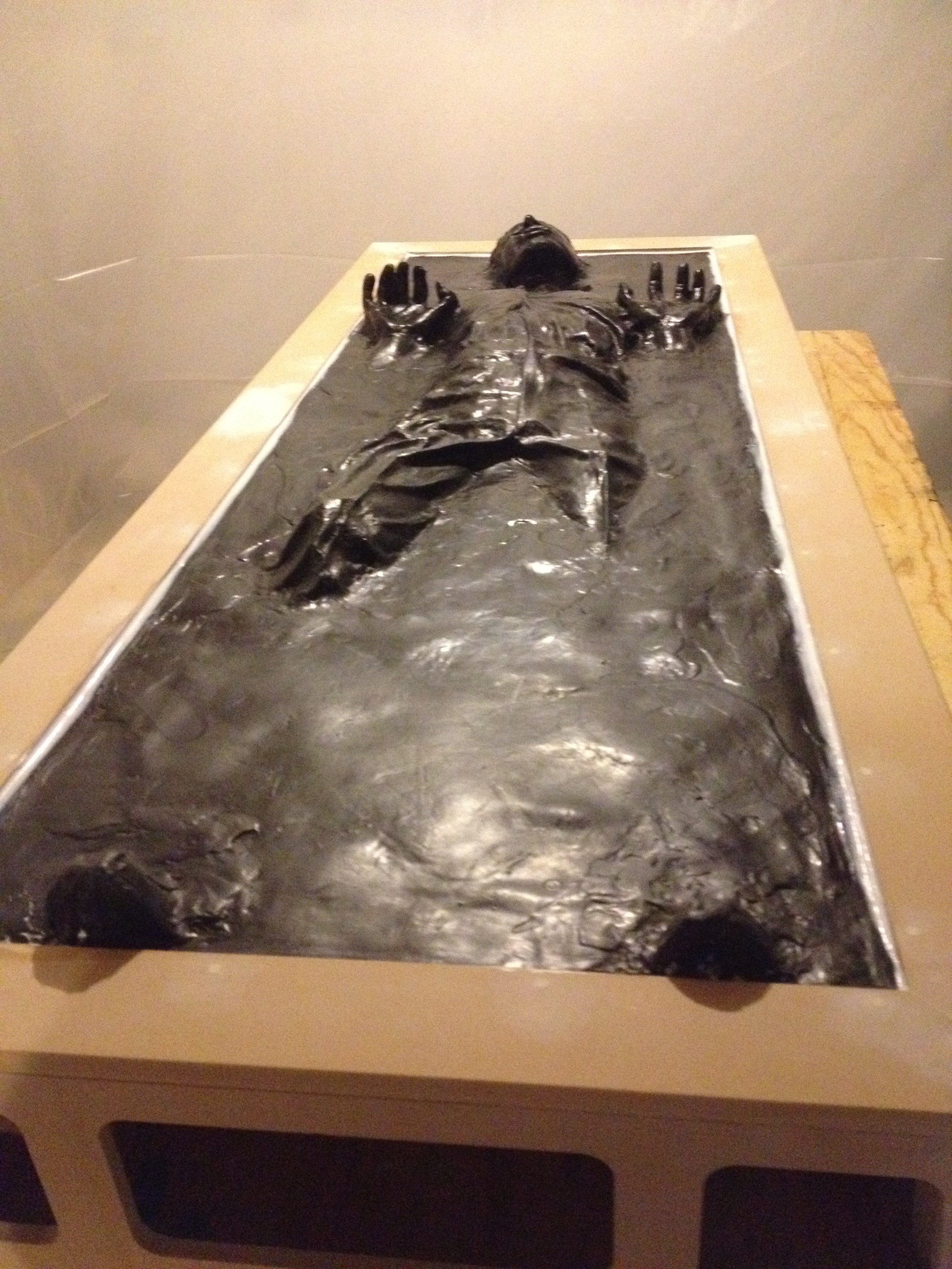

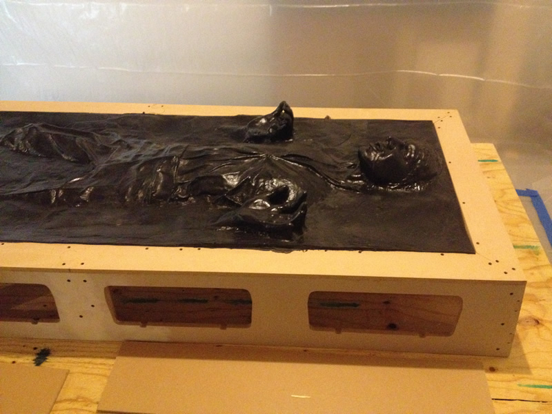

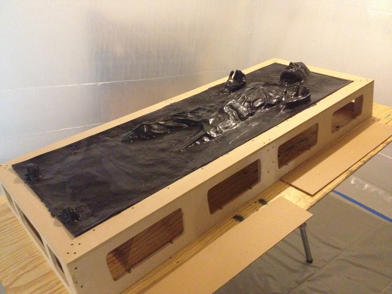

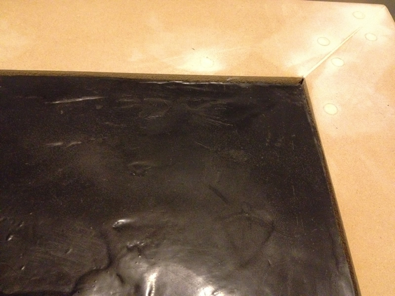

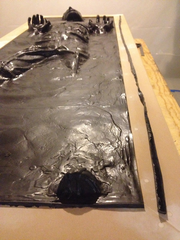

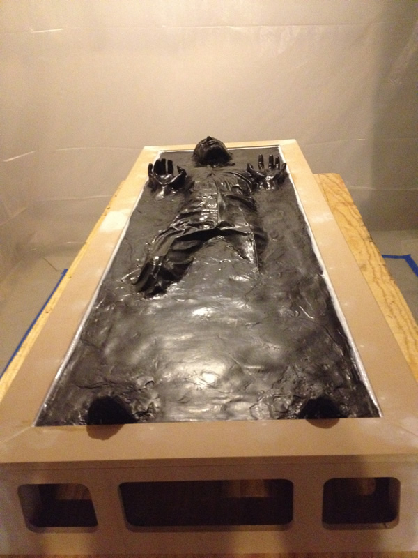

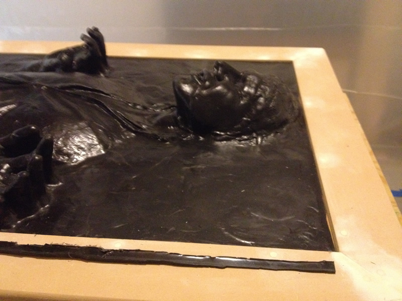

Making good progress (I think). I was able to get backing for the control panels attached and glued down the cast, using construction adhesive (Lots of construction adhesive).

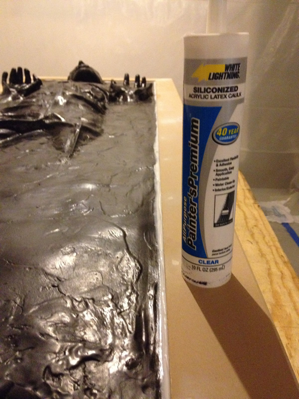

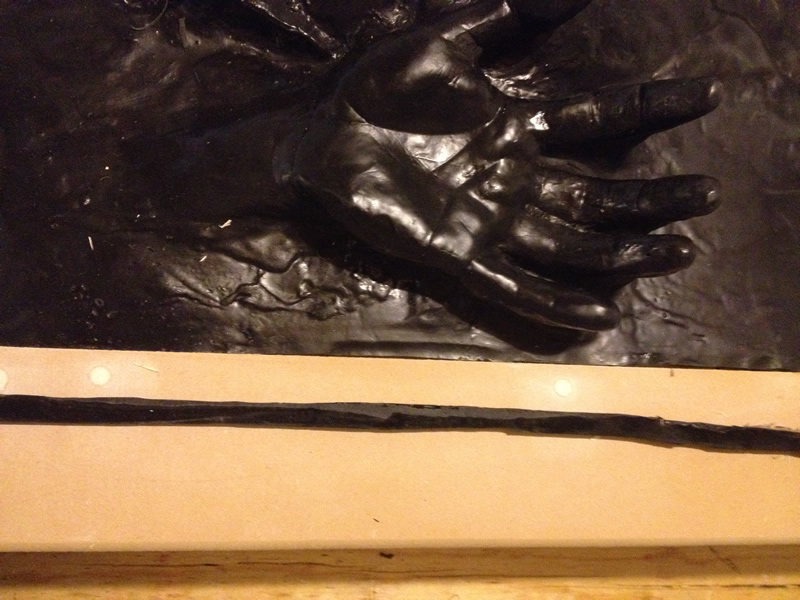

I added some caulk around the edges to fill in any gaps between the cast and the frame. I'm hoping when painted this will give me a good look of the center being "one" with the frame. It also provides a good "ramp up" from the cast to the frame so I don't have a 90 degree transition. haven't seen anyone else do this, so hope it turns out alright. Also had time to do some priming of the box.
I attached the backs of the control panels with construction adhesive.

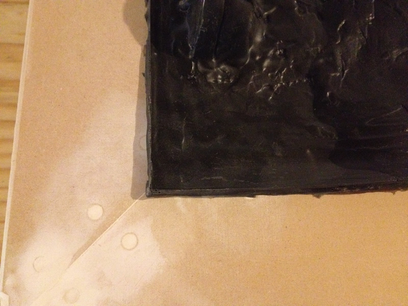

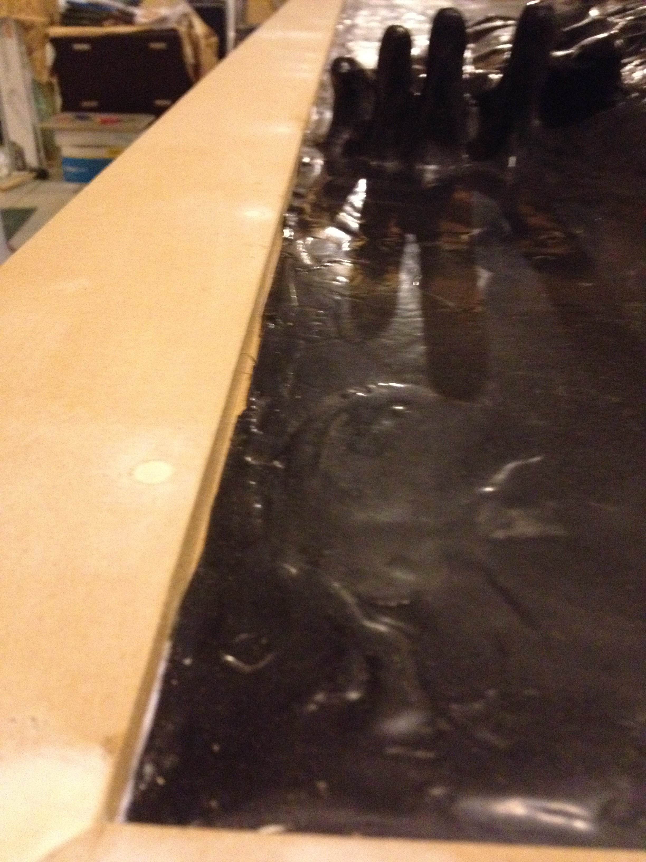

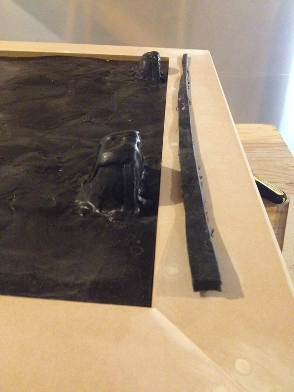

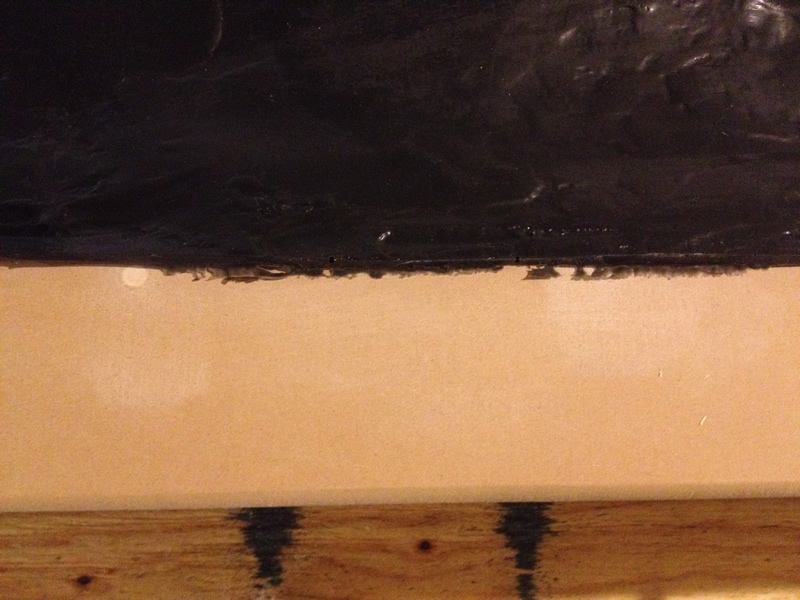

After gluing Han down, I had some rough edges in some spots.
So I used some caulk to fill the gaps and create a "one" piece look between the cast and frame.
When the caulk is applied it is white but dries clear. If their is any place where a poor caulk job would be appreciated its here, because you don't want it to be a "clean" line all the way around so being a little sloppy is a good thing.

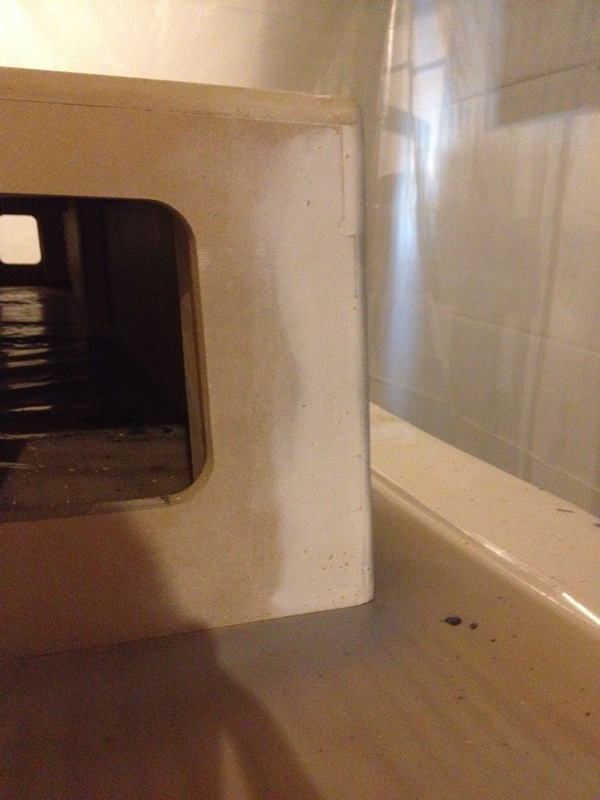

Let the caulk dry over night and then primed the box
Before After
I'm still waiting for some pieces to finish the top and bottom, which is why I did not fully prime it.
Just planning on using the automotive primer and then paint, so hopefully it will act as a good sealer. Might go back and put on a second coat of primer on the edges and thin spots.

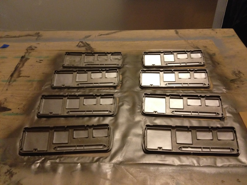

Shot of the raw control panels

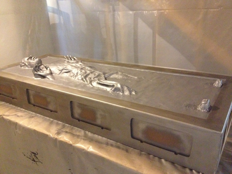

After painting the base color, same color as box will be (Rustoleum 7519 Stainless Steel)
Now after making the cut out areas aluminum

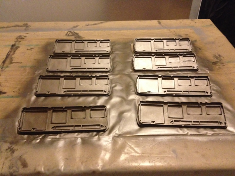

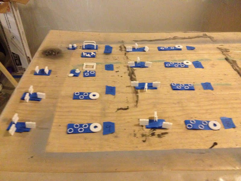

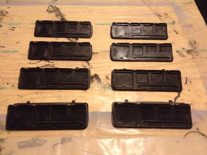

Laying out the greeblies to be painted, grouped them already by which panel they will be placed on.
Now I'm trying to determine what color I should pain them? Should I make them aluminum, to match the background they will be placed on. Or paint them a satin nickel, or some other color, to have some contrast.

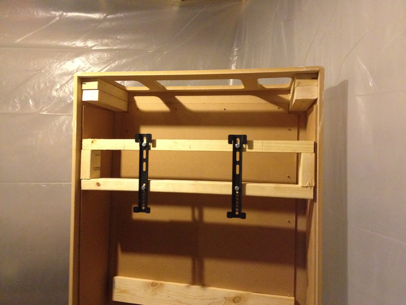

Made some progress over the weekend, on big step was determining how to hang it on the wall. After batting around a few ideas I settled on using a TV mount. Since it's easy to install and just need to rest the hooks onto the plate on the wall. Even provides left/right adjustability if need be. Looking around, most 32" TV mounts say they can hold over 100 lbs. and with the current weight at 76 lbs. it should have no problems.

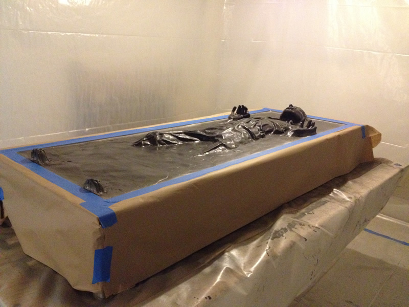

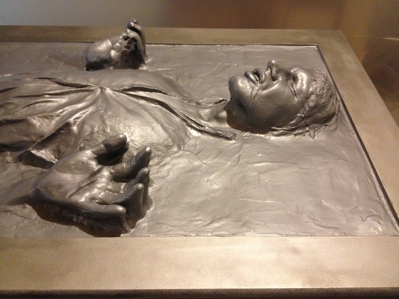

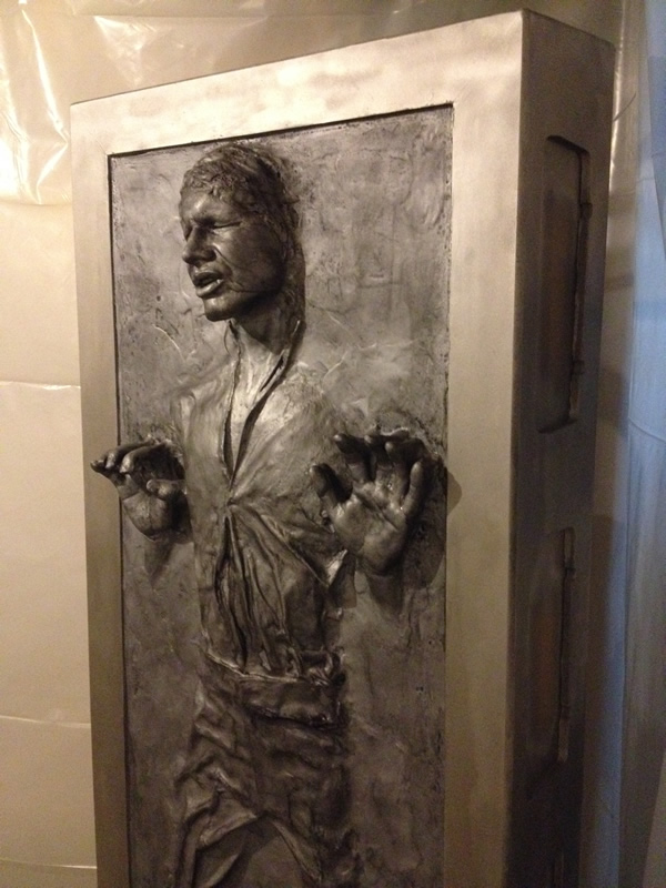

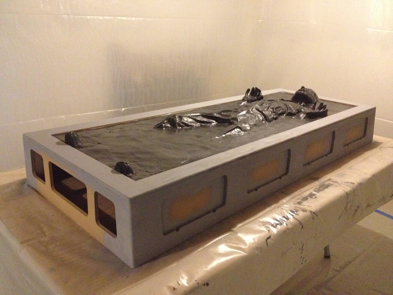

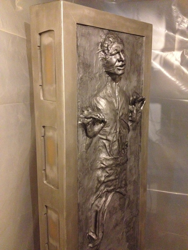

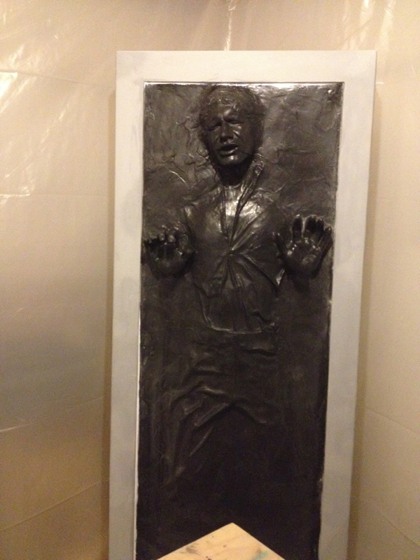

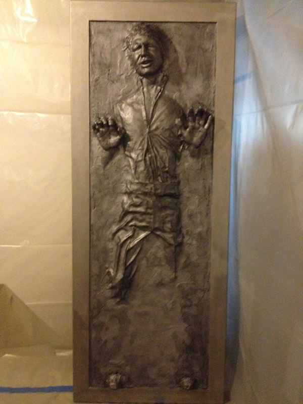

Painted the box and Han. Think it turned out pretty well.
Taped off the box after painting it first.
One coat of 7277830 Metallic Matte Nickel
Applied two coats of black wash
I love the colors!!! I think they are perfect, the metallic matte nickel even looks pretty good by itself with the 7519 Stainless Steel, but adding the black wash bring out all the detail and provides the depth, making it look even better.
The wash comes off a little darker in the photos than it does in person. Also the lighting isn't ideal.
I used a acrylic paint (black) that my wife had laying around. The brand name is Delta Ceramcoat.
Looks a little something like this:
I mixed it with water, about 1/10 ration and added some dish soap (to prevent the mixture from beading together, otherwise it would look like Han got rained on and you'd see a lot of water spots)
One thing I learned was even though the water might not seem "dark enough" it is. Just apply one coat let it dry and see where you stand. Then you can apply a second if you'd like. No need to try to do it in a Big Bang approach. Less is more.
