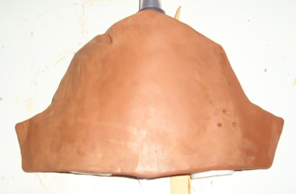

Ok, im gunna try and make some fibreglass chest armour and I am using clay to make the model, im then going to use plaster to make the cast...but im going to finish modeling all the amrour...this is what I have done so far...what do you think?
I left a large gap for the chest display because I am going to use a piece of sintra to spilt the two to make it stronger.

Awesome!! Looks great so far! The only thing I would do is made the ab plate a little shorter, since it looks a little too tall right now. Other than that, it's coming along nicely! :cheers

While you're at the stage right now, refer to your reference photos, the corners and edges should be much more rounded. Aside from that, you're headed in the right direction.

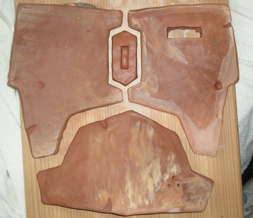

This is what I have made.....i am going to buy some silicone to make the moulds then I can get things started...but I have got to wait for all the clay to dry first. I hope this is going to work!
