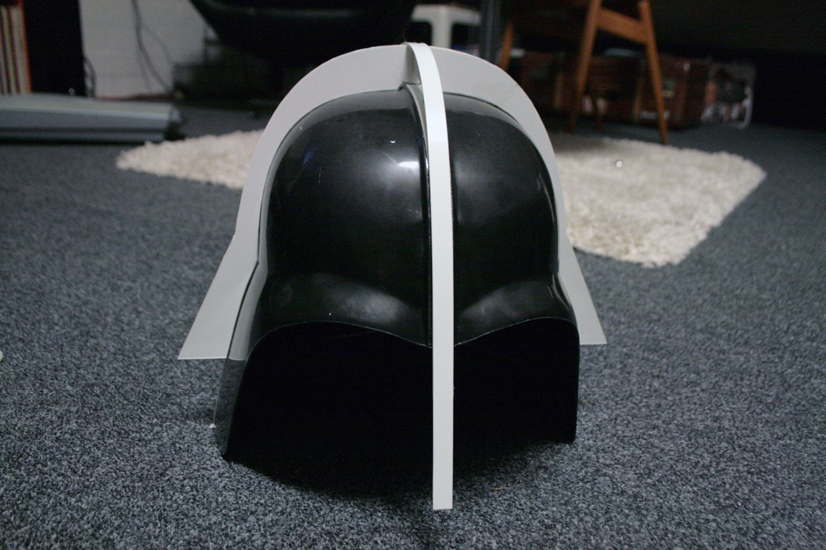

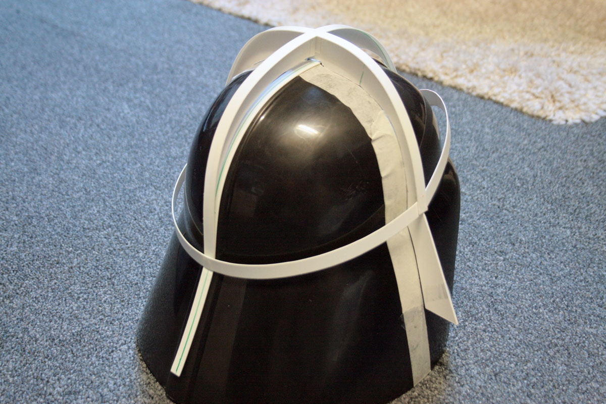

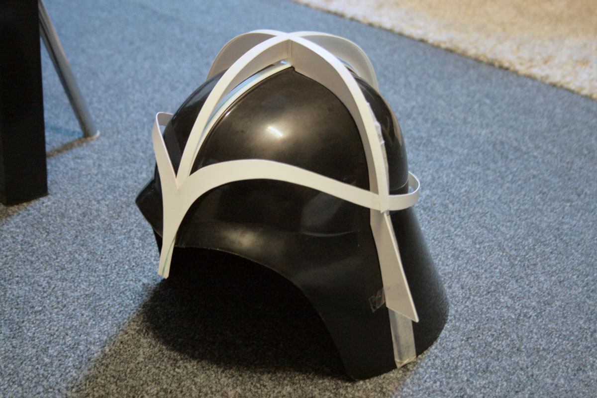

First progress report…started making an X frame over the existing helmet which reflects the contours of the concept helmet.
Yea really pumped to see this lid. I've always loved this version of vaders helmet.

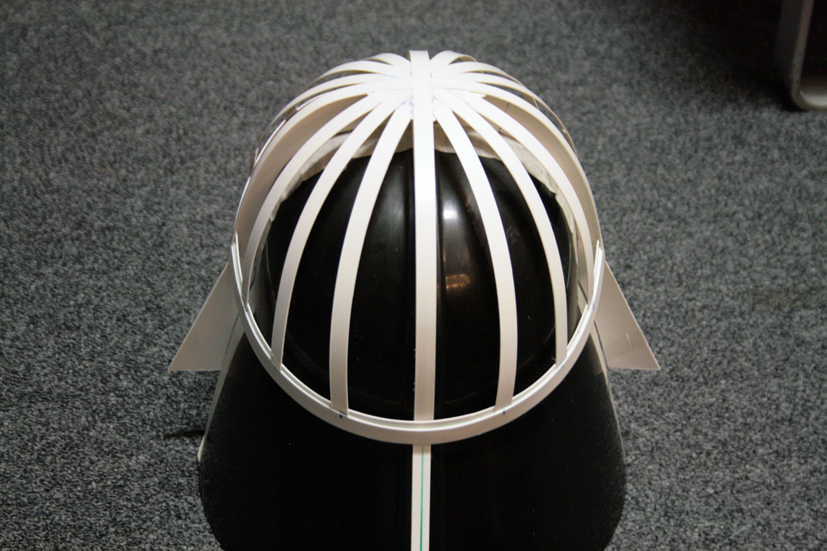

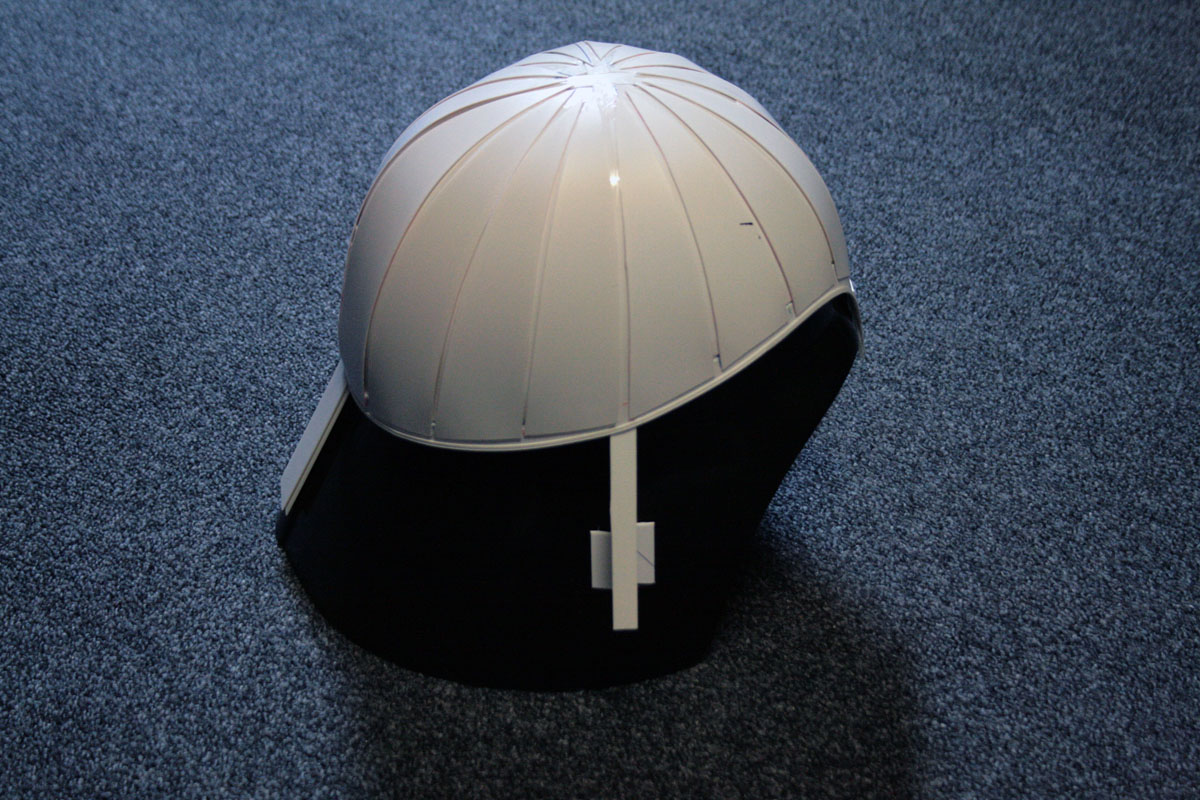

Today I added the rim of the upper dome, now that the “borders of the upper dome are defined , I can roughly fill in the blank parts. After that I can work on the lower part of the helmet shell.
Making steady progress. Created a “basket” shape for the dome, this way I can control the symmetry of the dome, later I will also close the open spaces.

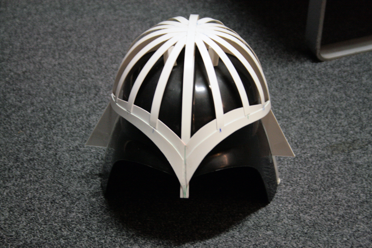

Just closed the dome. Now I’m working on the rim of the helmet. Once that is finished the dome is ready for fiber glass and filler.
Creating the rim of the helmet was a bit tougher than expected. Literally took me 20 templates to cut before I ended up with something that fits. Also figured out that the only way to get the eyebrow part to look the way it does, was to make it from a separate piece. I try to give it that “Samurai” look initially intended by McQuarrie. I think I got it. Now It’s ready for a layer of fiber glass.

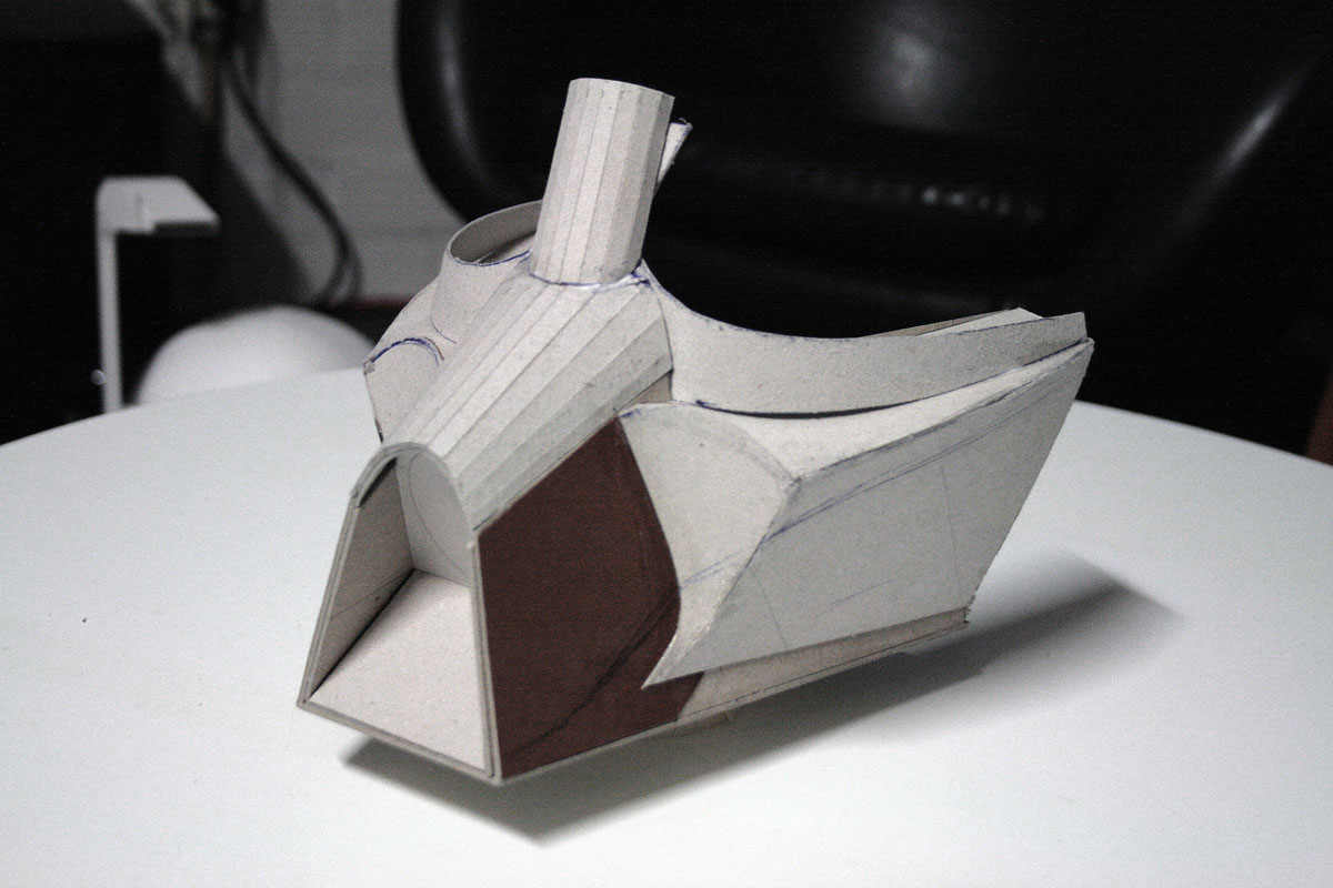

But first I will start on the mask, this part is a bit daunting, there is a lot going on shape wise, and I’m not yet sure how to start as a base.
Well…started crafting the mask, it’s only a cardboard test model to figure out the way I will construct it.
