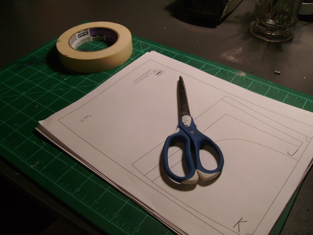

ok now that mom is pleased w/ my room I figured I'd start

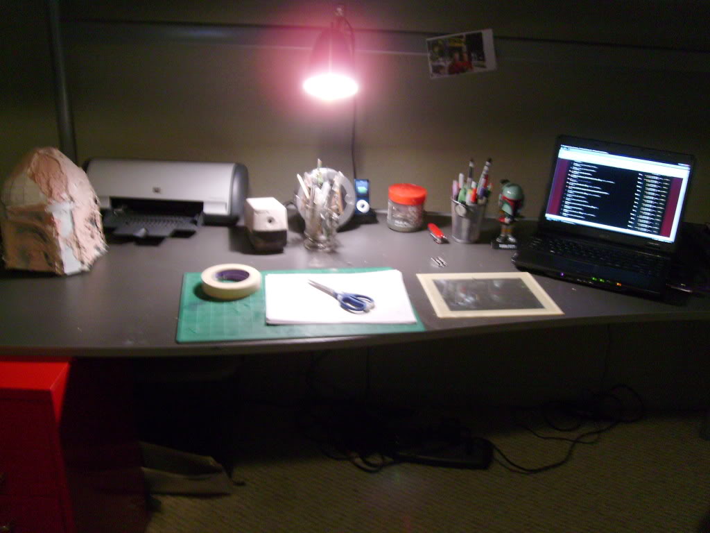

so got my work area
and the stuff I need for assembly right now
thats all just thought I'd let you know 'bout what u r going to need
lol I love how u have the forums pulled up on ur laptop there right next to your workbench! Is the boba bobblehead mandatory? lmao

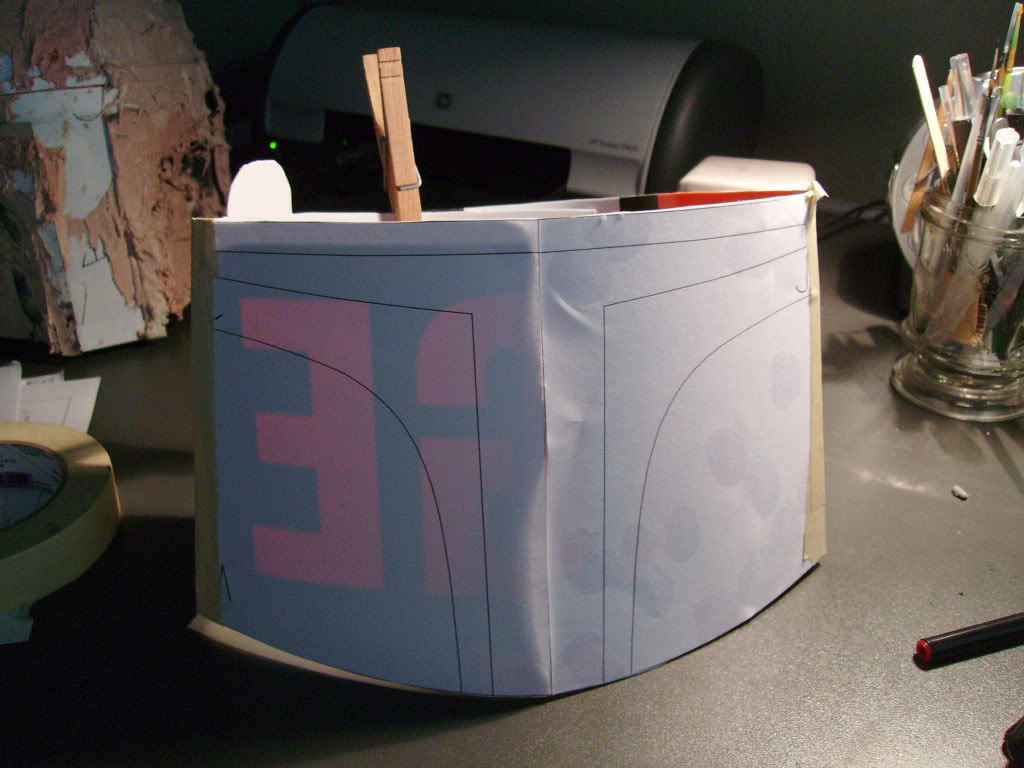

take the dome base and slide it into the top to were it rests on the ledge thats made by the inner surface and the outer surface. that will keep the shape nice vod.

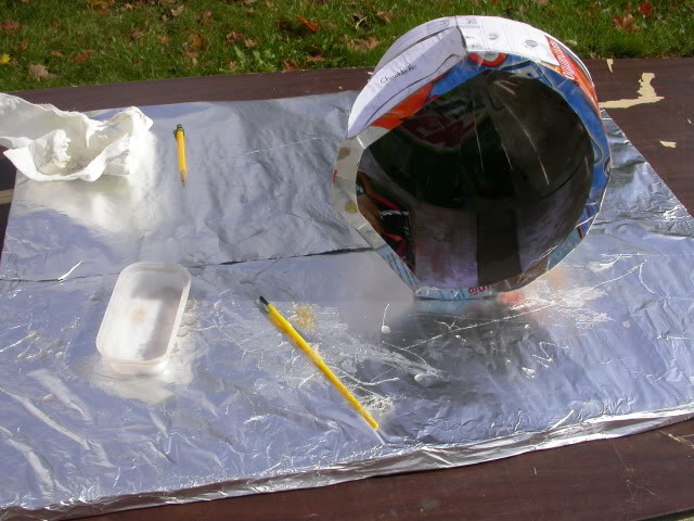

All right. Did you print out ALL the templates? They are all important. To solve your shape problem, make sure you have the helmet base sheet cut out. I cut that out, taped it to the bottom of my helmet and cut most of it out, leaving a rim around the edge. I've been taking it off as I'm applying bondo and fg but for initial shape the HELMET BASE is essential.
See how there's a rim on the bucket?
Hope that helps!

if you plan on making more than 1 bucket, the helmet base can be made of something a little more premenant like a piece of fiberboard or something, then you can tape the bucket to it until you get the resin coat on, then pop it off and glass the interior. Kinda like a jig. I plan on making one when I get settled in at the parent's place.
