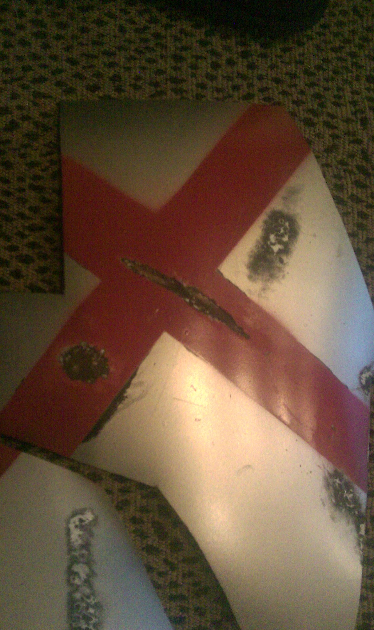

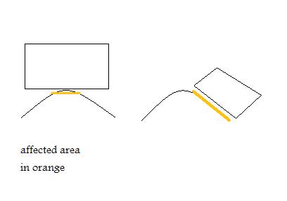

3.2 (making bullet effects) Remember that a blaster shouldn't affect bes'kar just its paint, energy shots would hit and deflect or just evaporate, bullet shots shouldn't be full circles and should be a little oblonged (in my opinion) Start by pressing down at an angle (if you are using a pointed sander) or by pressing down flat (only do this if you are on a "hill in your armor so not your entire sander is hitting the armor) rotate in a circle and lift, finetune by shaping how you desire
3.3 (Making slashed effects) Claws, swords, and lightsabers exist in the star wars universe, if you are upclose and personal be sure to reflect it! (parry first haha) Take the edge of your sander and just press firm, you can do this multiple times in teh same line or parallel to give it a longer or claw apperance.

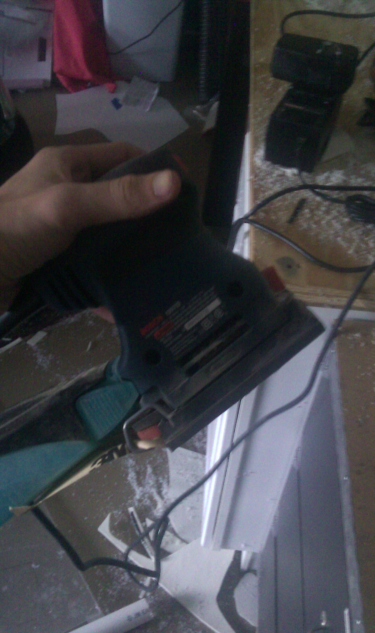

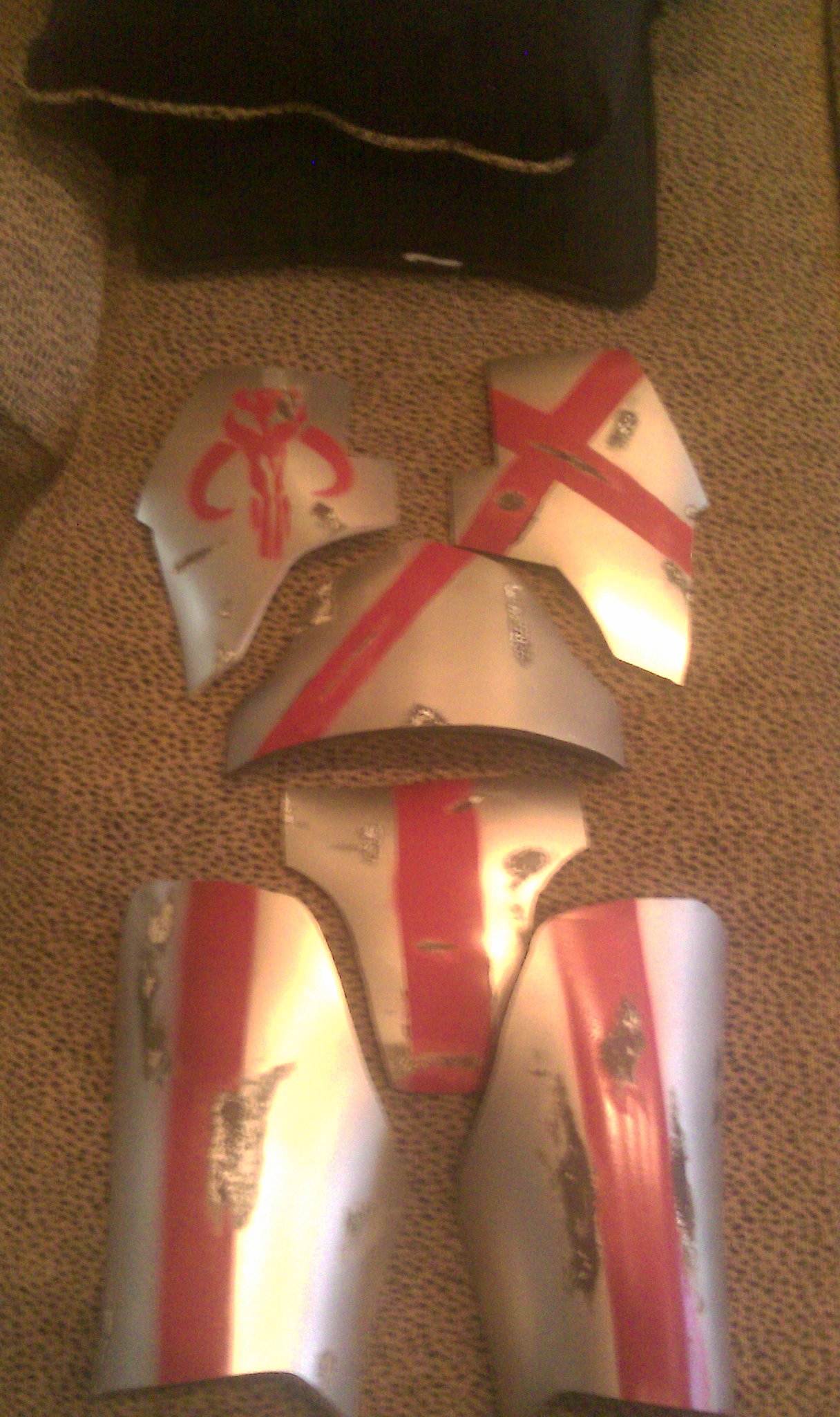

1. Full Armor Weathered
2. Square Sander
3. Weathering with Slash (on stripe) and bullet effects

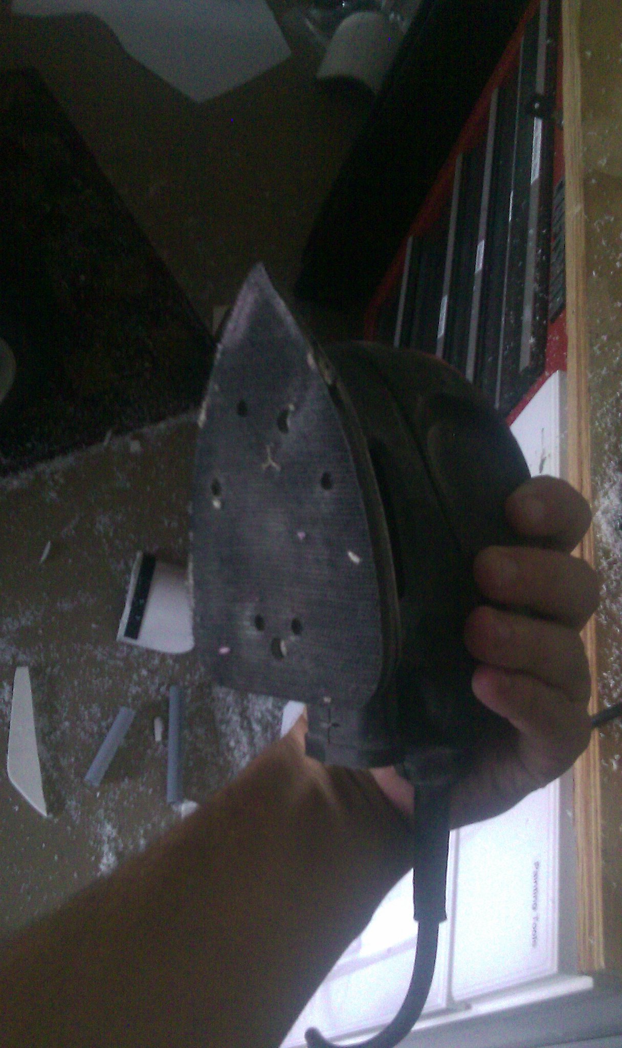

4. Angled Sander
