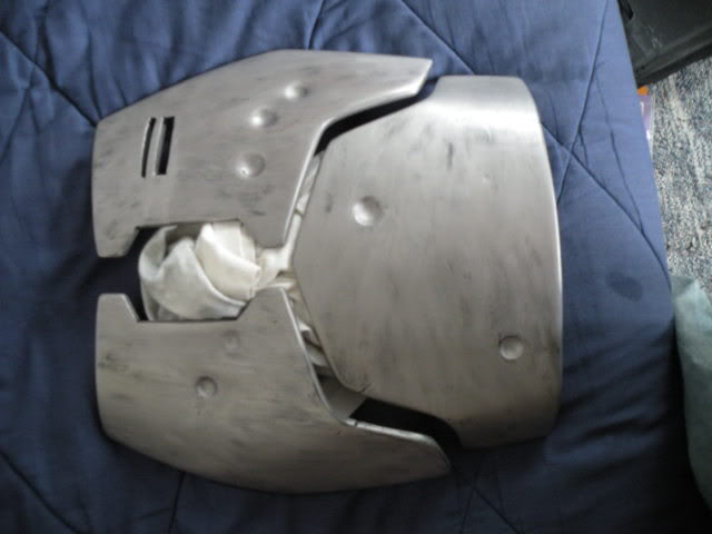

Recently I have begun to use rub n buff metallic wax for my base coat. I think this might be overkill on my part since the metal color doesn’t matter a whole lot unless you don’t paint over it, but I’m practicing for a Jango. There are several different shades of gold, copper, silver, and pewter available; to this point I have only used silver and pewter. Rub n buff also requires a lot of prep work before it can be applied. You need to prime your armor, wet sand at 400, and wet sand at 1000. Better results can be achieved by wet sanding at various other grits going up to 2000 and priming in between each wet sand.
After your armor is all sanded apply a bunch of small globs of the rub n buff all over the pieces and begin rubbing it vigorously with the palm of your hand. Rub n buff is a wax so it needs heat to melt it to the primer. You will probably get smudges and places where the rub n buff will just not stick. This is very frustrating, but it happens to me every time. At this point you can either: resand and start over, try applying more rub n buff, take the armor as is and move on to the next stage.
After the rub n buff is on you can make it very lustrous by taking an old t-shirt and buffing it very hard. I spent 10 minutes on each piece when I did this and the results were pretty cool; I could see my own reflection in the armor!

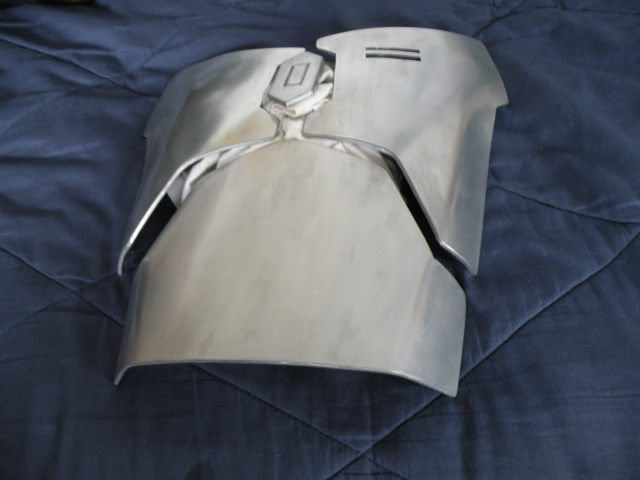

Here are pics of pieces rub n buffed using various methods
Pewter (I have used this color a few times and I have never gotten really good results like I have with silver. I’m not sure why)
Silver buffed (in the ab plate of the first picture, that’s not a large smudge; that’s actually the reflection of me taking the picture)
Silver not buffed
And a couple of comparison shots

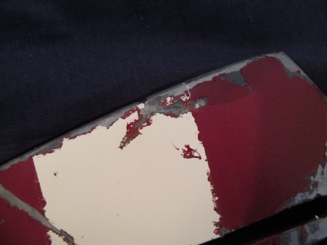

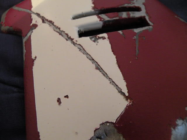

Now on to the painting! This is definitely my favorite part of the whole costume building process. I use layered weathering which means that I have a basecoat, and then I paint on all the layers while masking off portions of the armor between each layer. I used to use toothpaste and then I used rubber cement, but now I use liquid latex masking fluid. This stuff costs 15 bucks for a small bottle so toothpaste or rubber cement are really much more cost effective.
Apply your masking fluid to wherever you want the metallic color to show through. Remember that you want to leave room for your aesthetic primer so make your damage a little smaller than you see it in your mind. Weathering needs to be random, but it also needs to make sense. The edges of metal plates weather a lot faster than the inside; the same goes for raised surfaces. When doing the rest of your weathering make sure to mix up damage type (scratches, scrapes, dings, blast marks), size (small scrapes, long scratches, etc.) and placement (even spaced damage all over the armor doesn’t actually make sense). If your armor had any stripes or sigils on it make sure that the paint chipping overlaps them too. It’s a little thing, but showing that individual bits of weathering are not confined to certain colors makes the whole piece look much more realistic.
After you’re done masking the base metal apply a few coats of your aesthetic primer. After is dries mask off areas of the primer and apply a few coats of your topcoat. At this point you can begin to rub the armor with your finger to remove the masking fluid (or wash your armor under a faucet to get rid of the toothpaste) to see how the weathering looks. Pat yourself on the back; the hardest part is done!

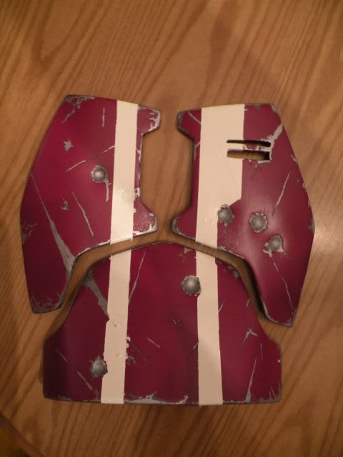

At this point you can begin to paint on any stripes, markings, sigils you want. If you’re going with basic geometric shapes it’s fairly easy to just make their outlines with blue painter’s tape, but detailed designs are more difficult. I’m going with 2 stripes going down the armor on this set so I just lined up all of the painter’s tape and then used ripped up pieces of newspaper to cover the rest of the armor. I applied my masking fluid and then laid down the ivory paint for the stripes. I remove the masking fluid before doing sigils and designs because after enough layers of paint the latex is really hard to get up, and because repositioning the painter’s tape always rips up some of the masking fluid anyways.

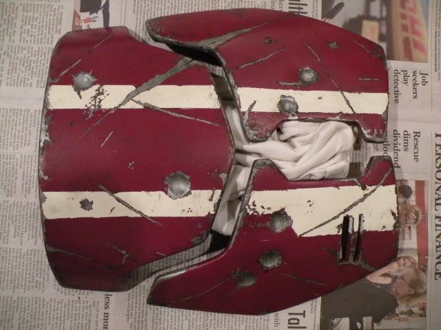

Here are the stripes painted, but before the masking fluid is removed
and here is a shot with the latex removed
some close-ups of the weathering

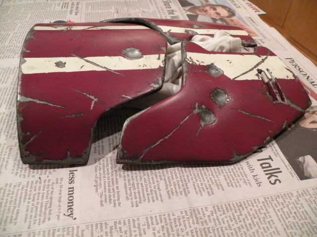

Some close ups of the grime in the crevices
And that’s it! Here are some pics of the finished pieces so you can see how it comes out.
Silver not buffed
