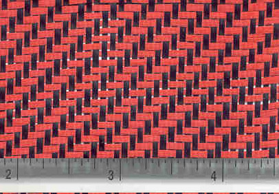

I have a little spare time and was thinking of making some samurai (like from movie Last Samurai) armor out of composite materials. I have some carbon fiber/kevlar stuff, which I thought would make some kickass armor ( I have red/black, yellow/black and blue/black see sample below).

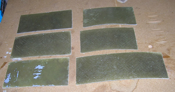

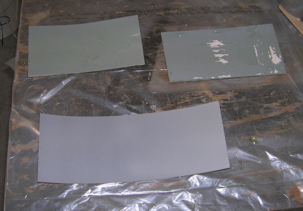

The next picture is of the plates I got off the molds, the longer one will be for the SODE (arm armor).
On the second pull of the plates I used starting with the outer surface layer, paper towel, glass mat, papertowel, glass mat, paper towel.
