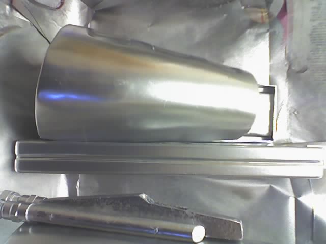

This is the first couple of shots of the initial chroming of the gauntlets. I have used the same Humbrol silver that I used on my BM lid. I made need to re-do the resin pieces on the right gauntlet though, as it appears the paints goes a bit warped on the resin, even through the primer.

PIC 1 and 2 show some more chroming

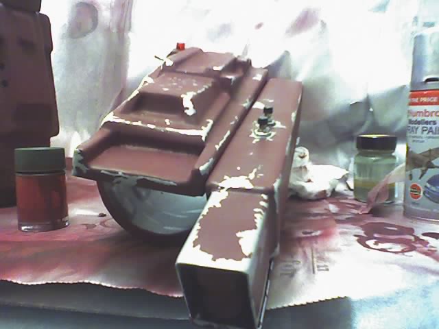

PIC 3 show the first coat of red on the left gauntlet, I ran out of gas in the cannister so have had to take a breather!

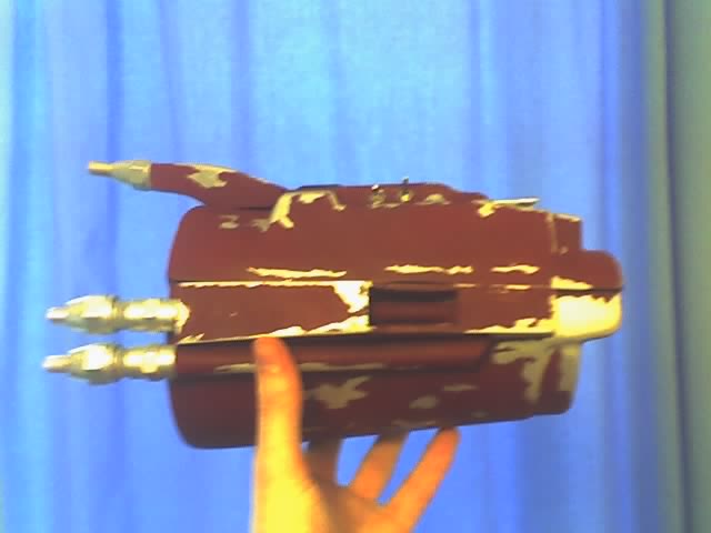

Heres some more progress pics.... The left gauntlet has been painted and the mask removed, I need to do one more coat on the right gauntlet then I can remove the mask

Managed to get quite a lot done over xmas. I have now completed the right gauntler all except for some light weathering and misting.
I have attached the switches and darts, and added velcro and padding.
Here are the finished pics.......

As a base silver I used Humbrol Chrome, this stuff really is shiny and I noticed that by applying some masking tape to it some of the shine is removed and makes it look a lot duller which makes for great effect.
The red is a mixture of tamiya flat red and games workshop scab red, its mixed 50/50. Make sure you apply the correct amount of thinner if you plan to spray this as the games workshop paints are quite thick. The only thing to be careful of if you plan to mask over the games workshop paints is lifting. Masking tape, even the low stick stuff can lift the paint, so i would suggest using copydex or masking fluid
