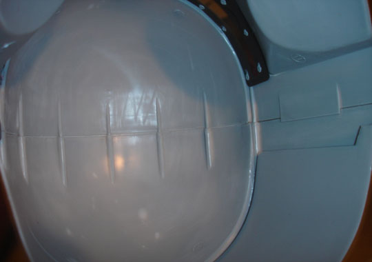

Got my ebay Jango helmet today. Ended up being a very chepo Rubies helmet :cry . Does anyone have any bright ideas on how to fix the gap between the seams? It is the two piece helmet
. Hope I can fix it. It wasn't too expensive, but still.

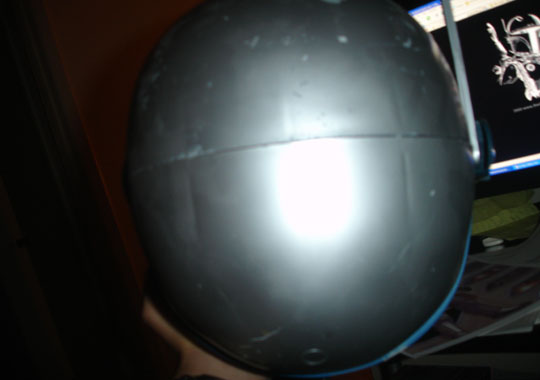

mine is a two piece too and im going to be making it a solid reinforced one piece!

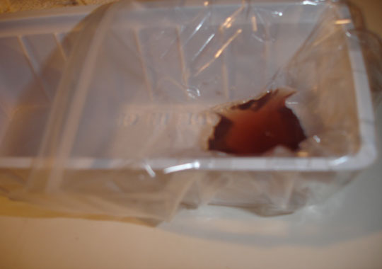

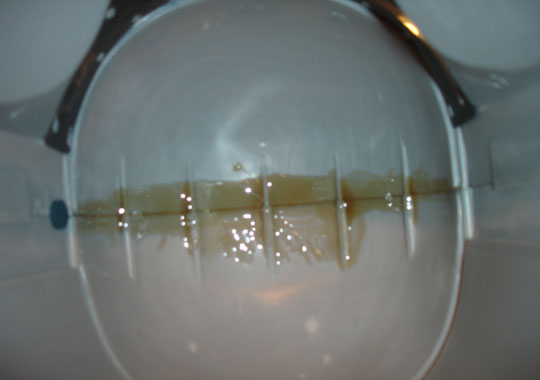

5.use the popsicle stick to fill the crack from the bottom <amount of hardener used will determin how fast it drys<i would use a seperate batch or have a blower ready for quick drying.

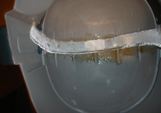

6.dip fiberglass strips and start laying and forming along split.
7.let dry tack, repeat

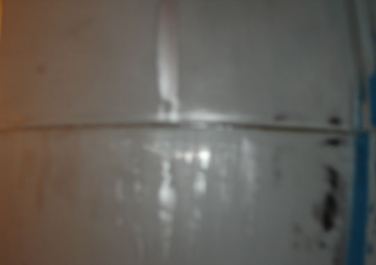

8.remove tape. crack should be filled however these helmets have indentions on them theat will need filler<glass
9.if seam is not completly filled apply fiber glass puddy to outer, fill, sand, prep for paint.
