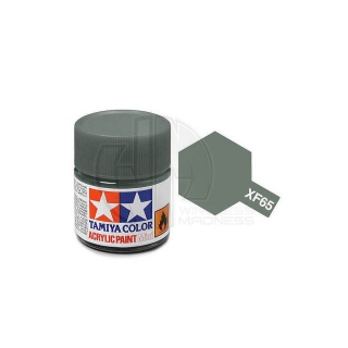

I plan on using Tamiya Flat Field Grey (XF-65). I did some test strips and it turned out pretty good.
