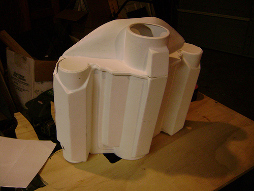

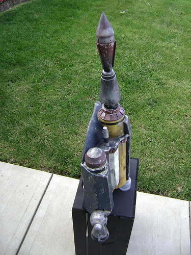

I got this pack from a fellow member here some time ago (thanks Charles) and went to work on it about 3 weeks ago. I'm fairly sure it is a "Bradley Fett" kit. It is Vac formed plastic and resin. This sucker came in over 18 PIECES and it was very difficult to get all the parts to fit together right. So. 100 % screen accurate? No. But pretty darn close in my opinion. It will have hooks shortly, as soon as I order them. Feel free to comment or complain.

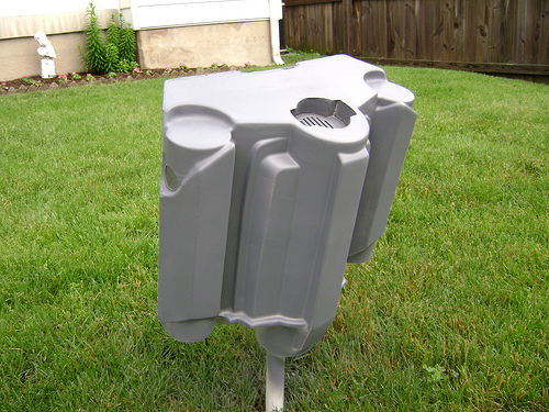

As you can see there were sooooo many gaps and joints that needed to be filled. I've never done so much gluing, bondo and sanding on one project.

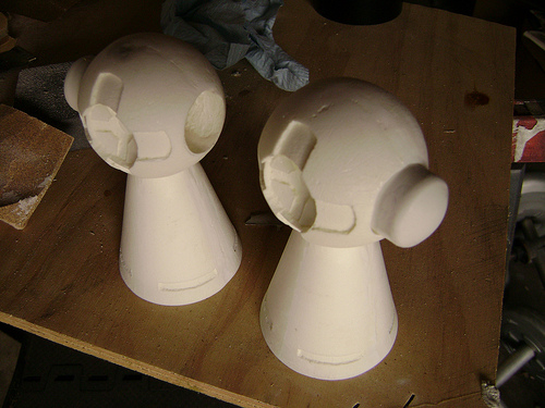

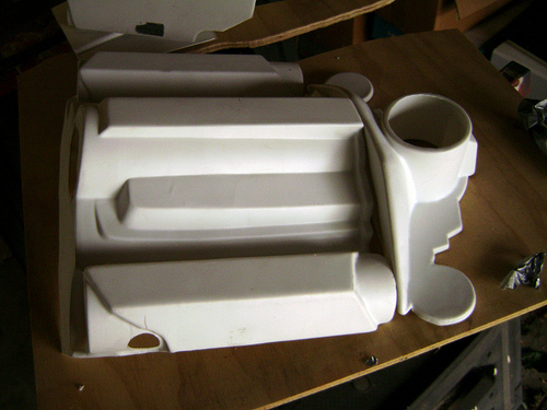

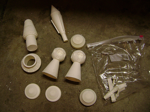

Most of the resin pieces that came in the kit. Some in pretty bad shape, some broken. Again, lots of sanding and bondo.

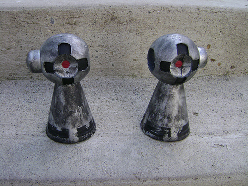

I epoxy'd in 1" PVC caps into the thrusters so a long piece of piping could be inserted thru the body and hold the thrusters in tandem.

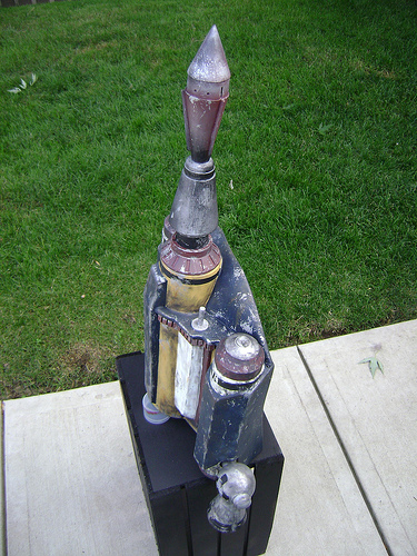

Missle portion done. Colors are boxcar red, chrome silver, black and grimy black.

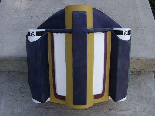

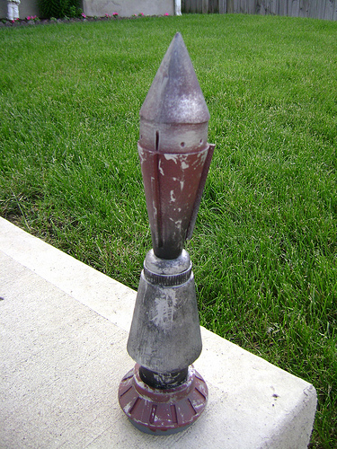

All base colors applied. I was getting worried because it looked so "tuti-fruiti" without any dirt. Colors are light blue, boxcar red, flat white, Up armor yellow and black..

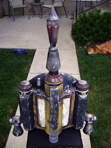

Here's where I am today. Weathered with chrome silver, grimy black and rust. The back cut out is held in place with some strong magnets so the inside can still be accessed. Missle and thrusters are removeable.
Wow, when I saw it in the base colours I was like mmmmm but then the weathering...Wow. That looks bloody amazing mate, seriously exceptional paint job.
Although I dont know whats better, the jet pack or your dog lazing it out on your lawn:lol:
Great work though,
Lewis
Thanks Lewis! I used to see finished jetpacks here for sale with asking prices of $500 + and I was like....yeah right. Well, now I get it. This thing was a bear to prep and paint. Came together better than expected though for my first run.

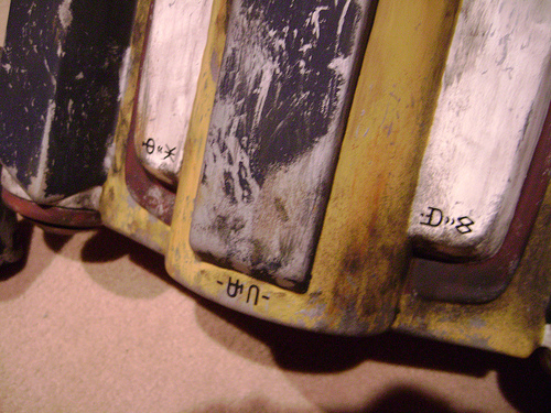

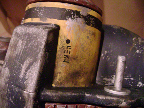

I painted it by hand using floquil and polyscale bottled paints. The white and yellow took SEVERAL coats but the blue covered in two I believe. For the scratches and and scrapes I did two methods. I used bright silver paint (bottled) poured some on a paper plate and then dipped "chore boy" copper scrubber in the paint. It is like a brillo pad but all copper mesh. I then just randomly started dabbing here and there and it worked suprisingly well. For smaller areas, I dipped a couple of "strands" from a broom in bright silver and layed them here and there to give the illusion of....well.....scratches. I hope that makes sense. Kind of hard to describe without you actually seeing the process. I then finished the pack with "grimy black" (bottled) and several coats of Testor's Dul-cote.

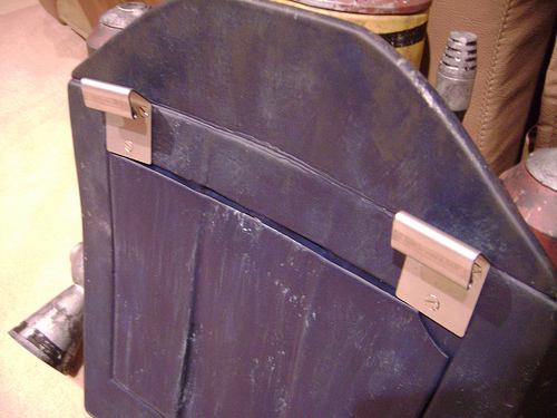

Little update. To finalize this thing I installed my hooks from FullMetalFett (which are awesome by the way) and put my decals on (Thanks Scott, also awesome)
There are those decals I wanted to see, they really bring the pack to life, amazing work:) Cheers for explaining how you painted it, given me a few ideas for mine.
