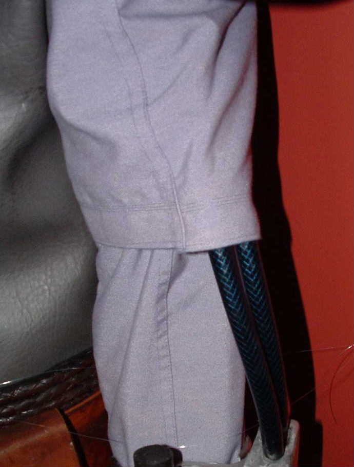

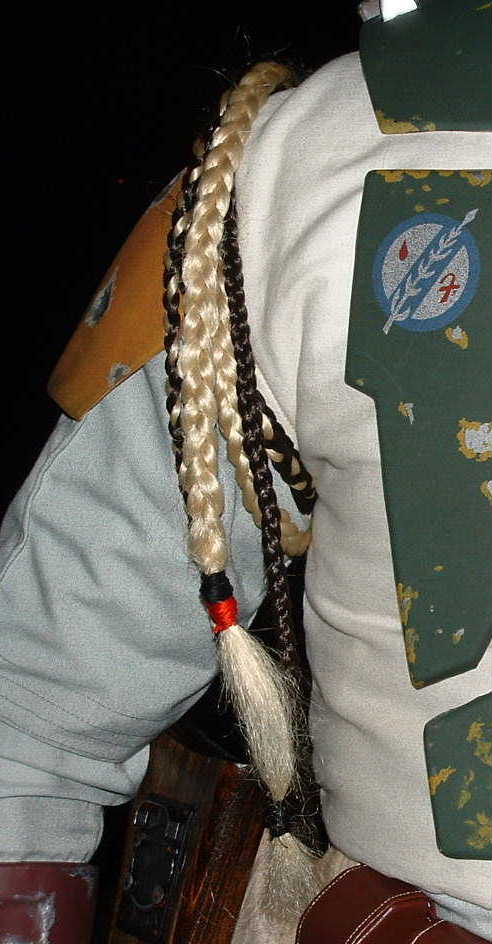

To dye my Boba, I used RIT Pearl Gray dye (powder) and a tiny sprinkle of blue rit dye. I filled my washing machine tub with boiling (yes boiling) water. I let the dye mix with the boiling water and then put the fabric in. Once the wash cycle was over, I would re-set the machine again. I continued to do this for hours, and kept adding boiling water to keep it HOT.
Here is a pic of my Boba suit using this method, and also my Jango (which due to the deep color saturation took MULTIPLE DYE BATHS to get it right).
