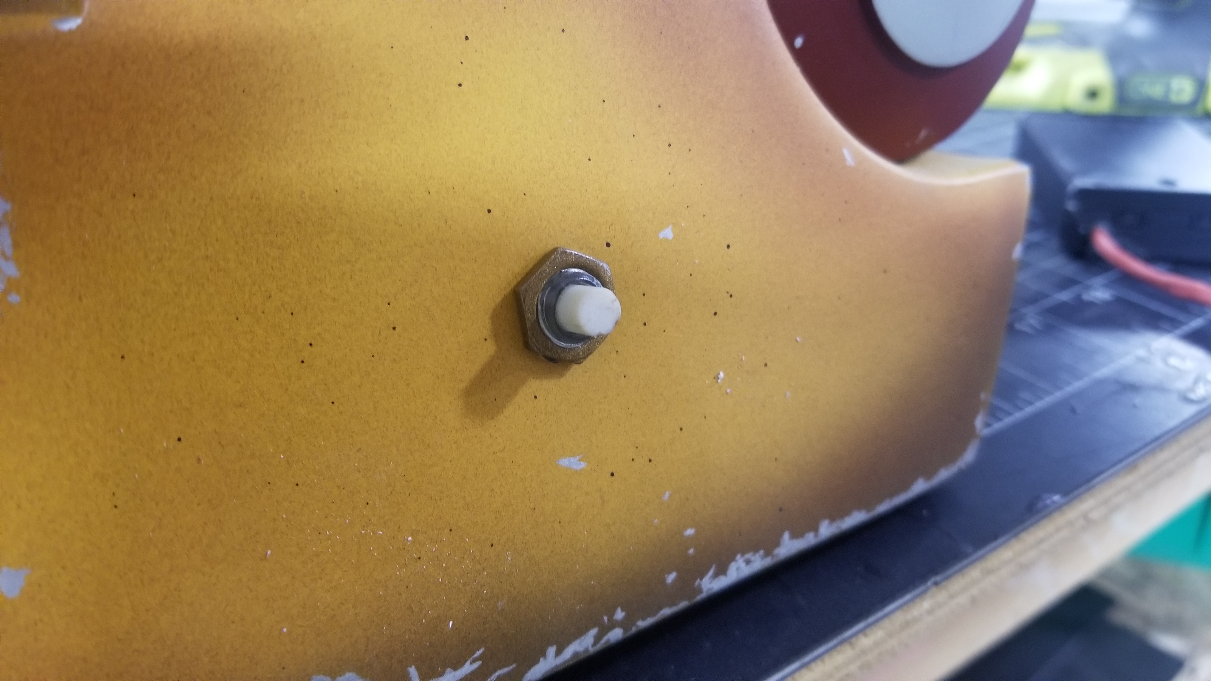

For the switch, I found a single pole rotary switch at Ace. The brass tip unscrews and then you can cut away the threads. I painted the nut with gold and misted it with brown. I am happy with the result, looks close enough for me. I don't know if anyone knows if the button was a push or rotary, but in terms of looking the part I'd say this works well. The other nut I used on the back so it only poked out as much as I wanted it to.
Gardner Bender Single Pole Rotary Switch Magnesium 1 pk - Ace Hardware

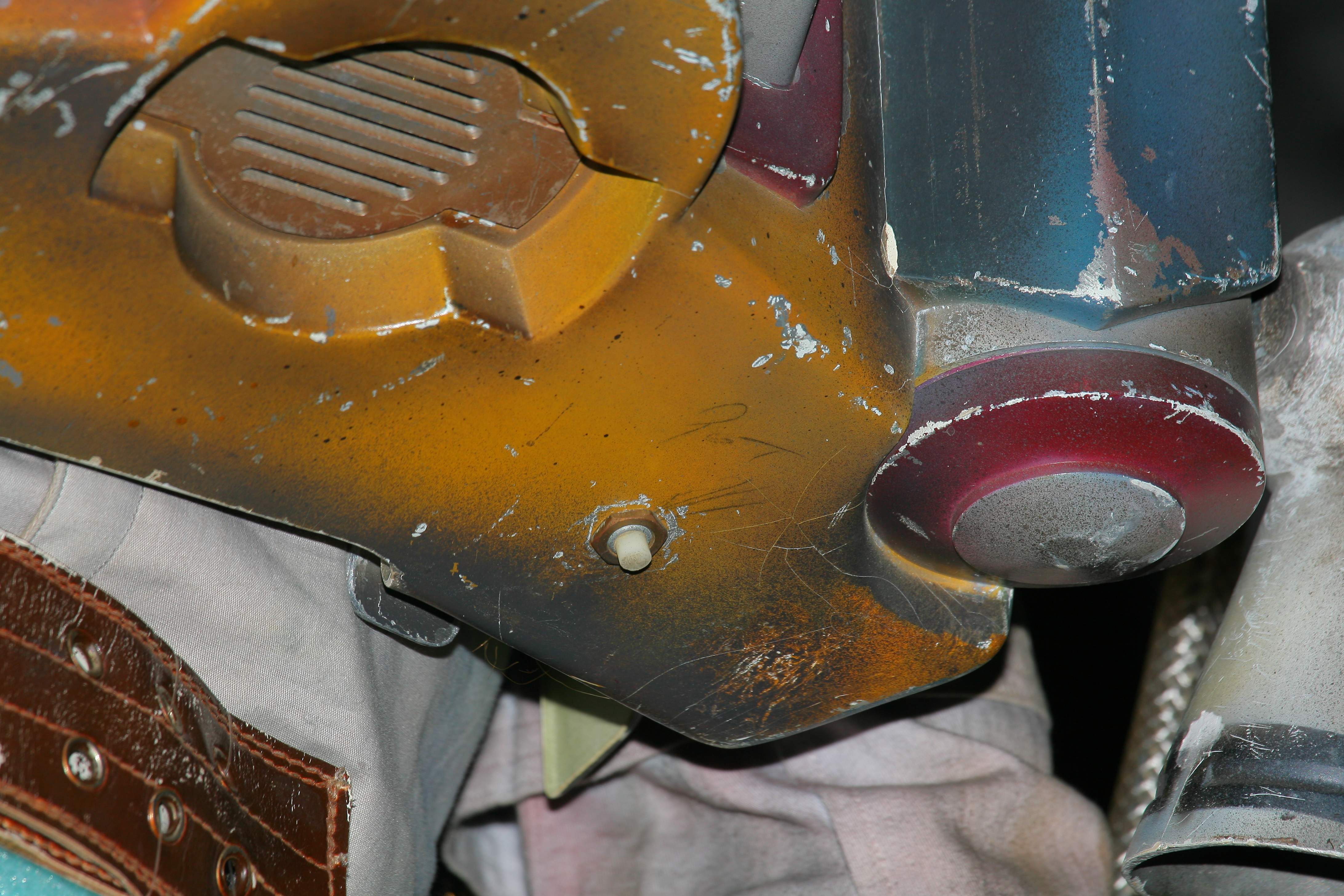

Which makes me ask: are there any known dimensions for this part? In particular the outer hex nut and the diameter of the center "button". It doesn't seem like a complicated piece to build or model and 3D print, so if I can get some dimensions I might be able to work with that.
Worst case, I can probably use the Eaton part dimensions to make one.

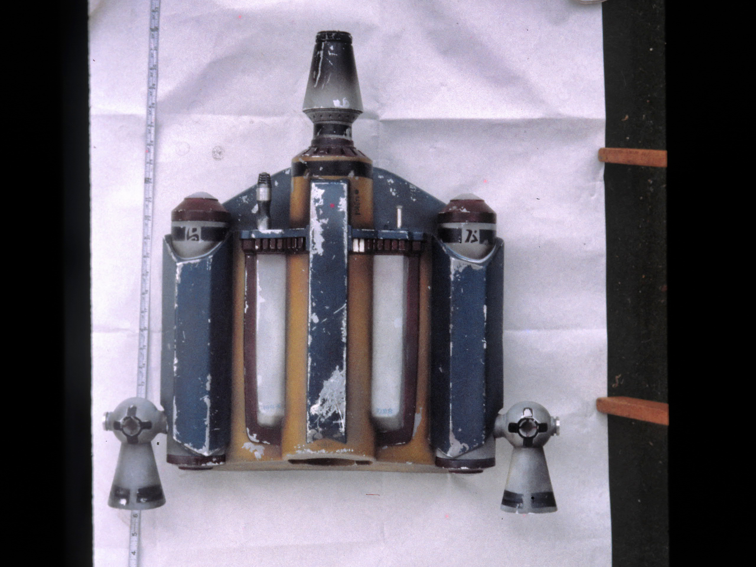

If you took the time you could probably get a rough measurement with these photos (and the others from that set). Most of them have a tape measure present. Then compare that to when the jetpack is on display and the stunt packs that possibly could have used the same underside greebles?
Ended up using the Neutrik port dimensions and this image to make some estimates:
If the port on the left is 22mm wide, I estimate the hex nut (flat to flat) is ~12mm, the middle metal part is ~9.2mm, and the center "button" (in white) is ~6.4mm.
Looking at the specs on the Eaton part I linked to before, the dimensions are 14mm / 11.68mm / 7.87mm
The ratios between the parts are about the same too, the metal "center" is about 77 to 83% of the face to face nut width, and the button is about 67 to 70% of the metal width
