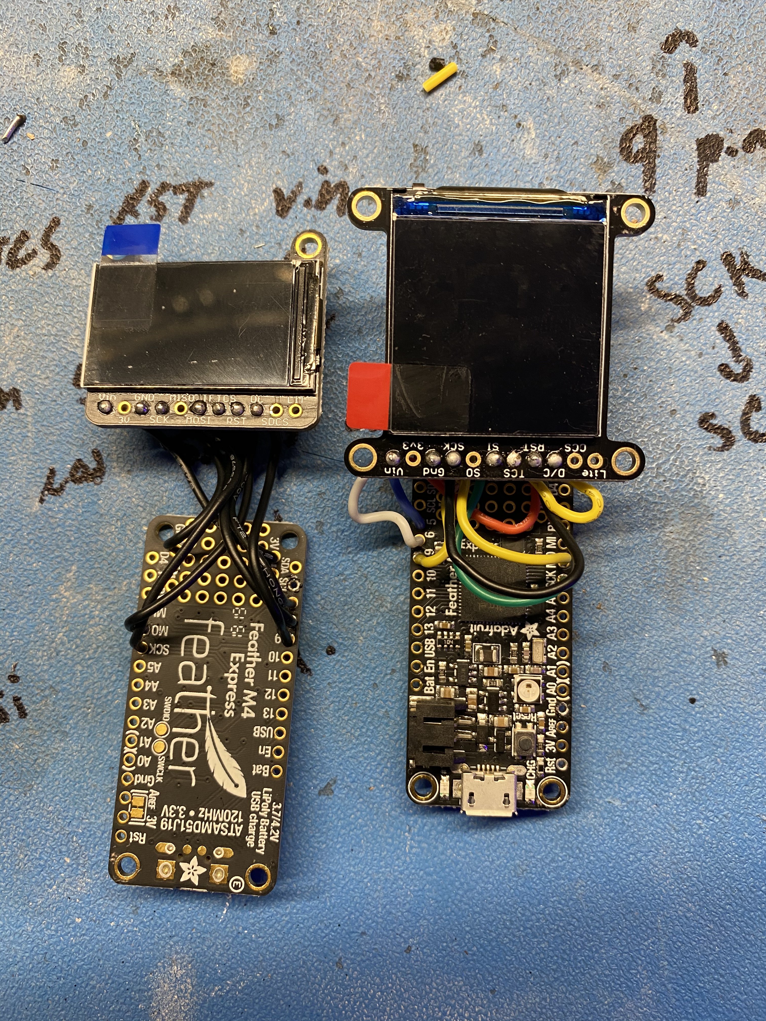

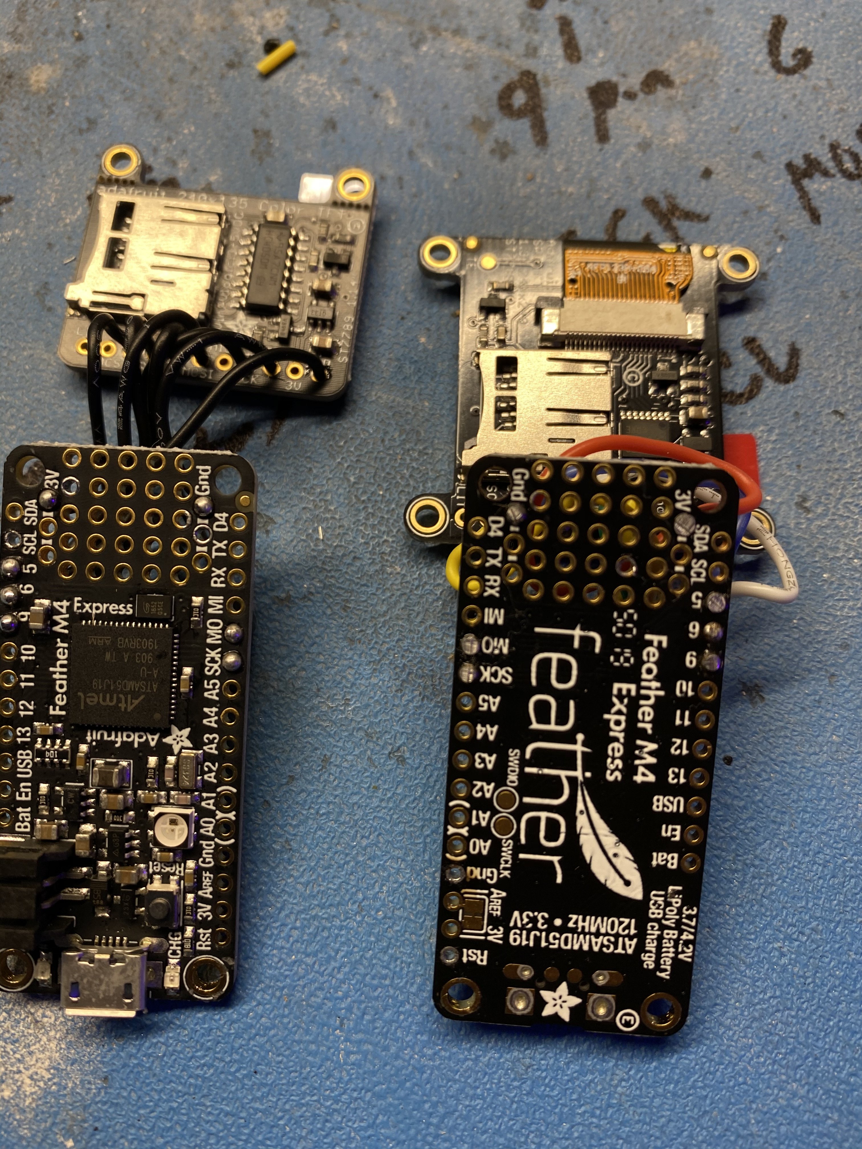

Hello, I was actually finishing a commission for someone when I decided to look at see what the sequence said on his pre-beskar gauntlets. I ended up finding this forum and literally just now made an account. I used the provided github project and created one for my beskar outfit I'm currently in the works for and one for said pre-beskar/Durasteel gaunlets. In total I think its about $80 for parts for both of them. Since it uses Adafruit components and they are currently not shipping, Mouser.com has the parts in stock (primarily the displays and boards. The Li-ion Polymer batteries you can get almost anywhere. You can customize the text, speed, rotation of text, and even add Bitmap images. The only set back I've found is that a bit of tinkering has to be done with images since it gets some memory allocation issues. (But not that big of a deal). The one with the black wires and pretty soldering is the one I made as a commission and the ugly multicolored one is mine. I'll probably go back and clean up mine tho.
