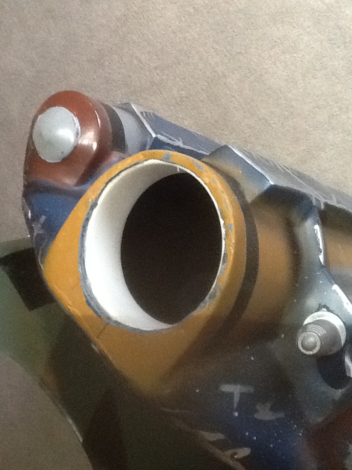

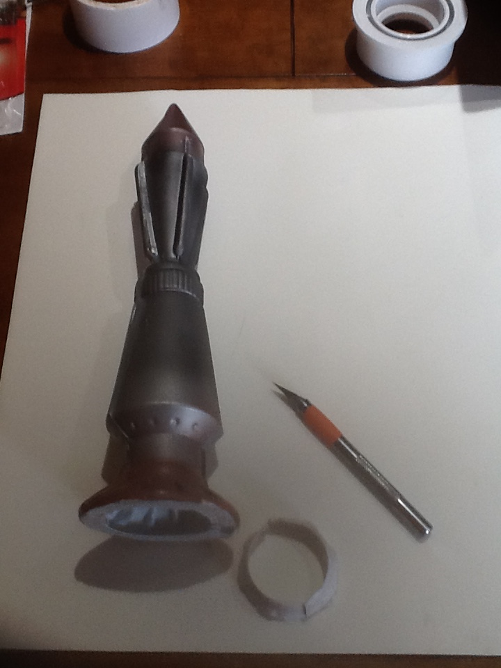

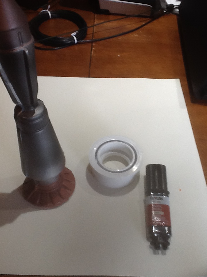

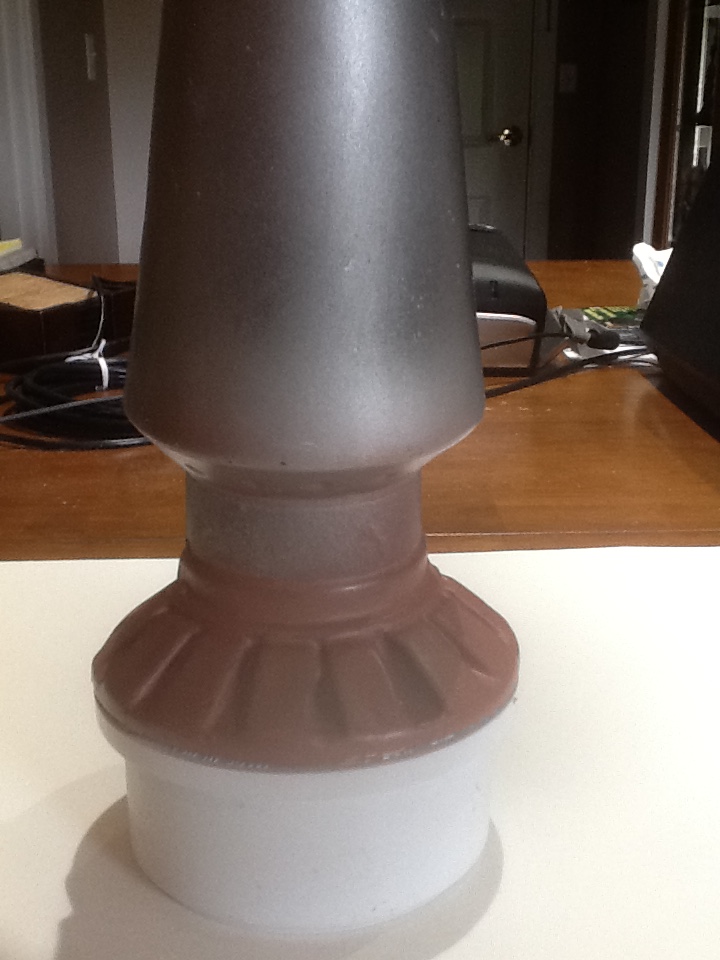

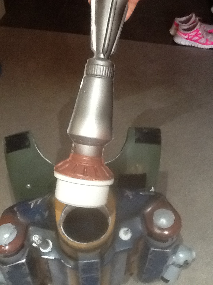

Here's my 'Franken' Tank' and Rocket retro fit. WARNING: It's a Rubie's and hasn't been detailed or painted yet. That's the next step.
ITEMS NEEDED
a ) 4.0” O.D. x 3.50” I.D. PVC by 1.25 LENGTH:
b) 3.5” OD to 2.5” PVC reducer
c) DEVCON - Plastic Welder
d) X-acto knife or equivalent
STEP 1: Sand inside the 3.5" ID PVC ring (item a above) to allow an easy but snug fit with item b above
STEP 2: Remove Tapered Flange from Bottom of the Rocket and ‘square’ by trimming to present a flush fit to a flat surface (table top)
STEP 3: Cement the Rocket onto the top of the 3.5” OD to 2.5” PVC reducer .
STEP 4: Using the 4.0” O.D. x 3.50” as a template. Position it above the existing Hole in the top of the Tank and score the top of the tank from the inside diameter. Gauge the placement of the PVC tubing positionally toward the back of the Tank and the two sides leaving about 3/16” back-set to allow for cementing the ring up against the remaining top of the Tank as well as the walls. NOTE: You will only contact the Tank walls with this insert method around appx 60% of the hole as the Tank walls fall away from the center line of the hole.
STEP 5: Remove and Insert Rocket as needed.
This has proven to be a really easy job and one that improves ease of packing and transport as well as provides better stability over that not even passable original glue down job.
