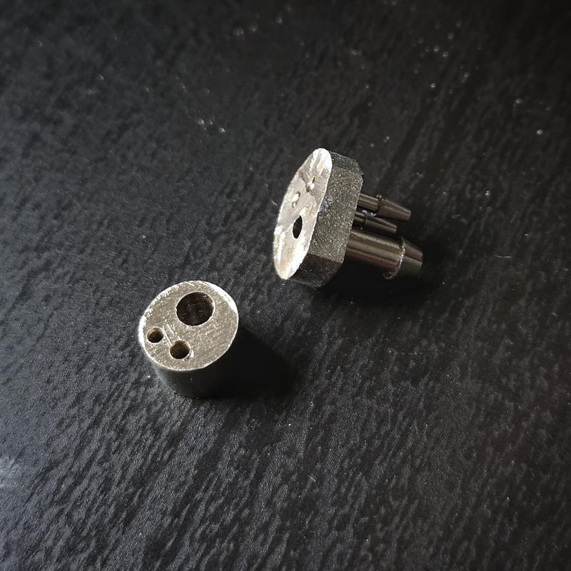

First order of business was to cut the borden connector and flip it around so the two small holes are in the correct orientation.

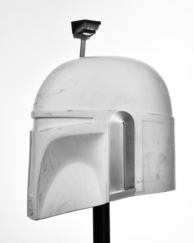

Dry fitting the ears, rangefinder and borden connector.

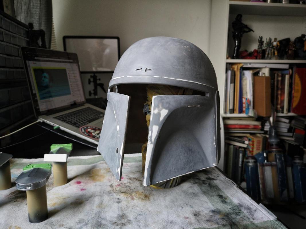

Primed helmet and filled gaps with epoxy putty.

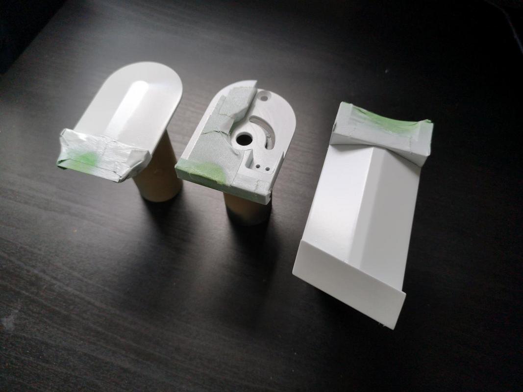

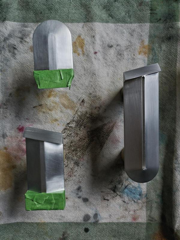

Metal ears primed with Mr Hobby Metal Primer

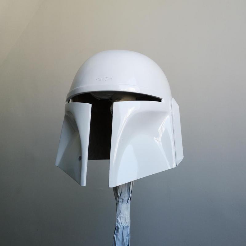

Gloss white paint down. I had already painted the red and blue triangles which are masked with Blu Tack here.

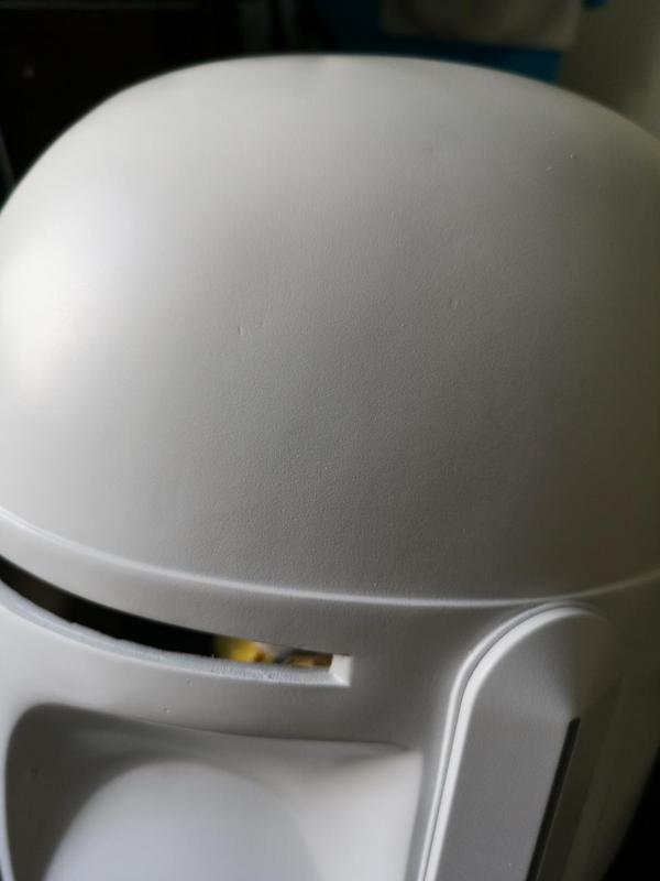

The helmet had patches of matte texture after three coats of white and two coats of gloss clear.
To resolve the inconsistent surface, I wetsanded it with 1000, 1500 and 2000 grit sandpapers to smoothen it. Then I polished it with Turtle Wax polishing compound and buffed with microfiber cloth.

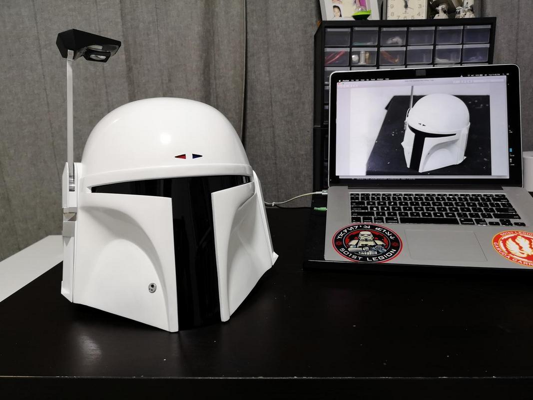

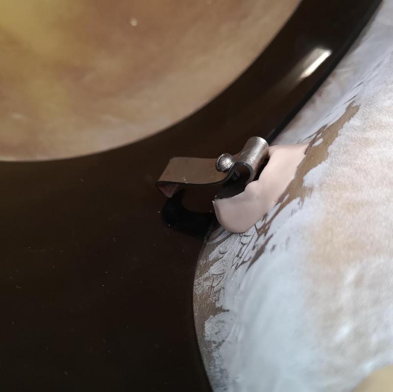

Finally, I installed the visor with metal clips and used a heat gun to press the visor so it aligns perfectly with the helmet's curvature.

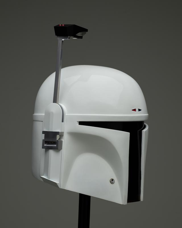

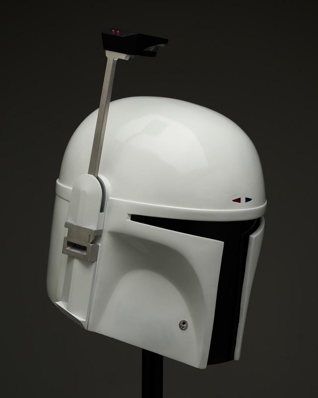

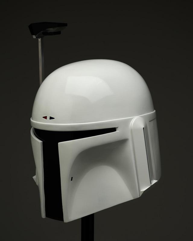

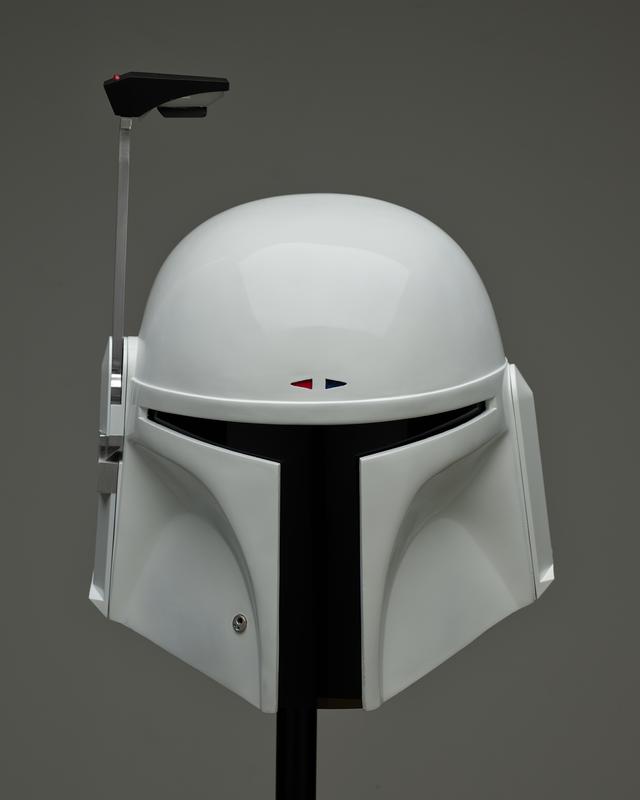

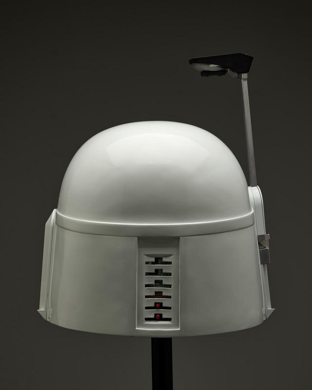

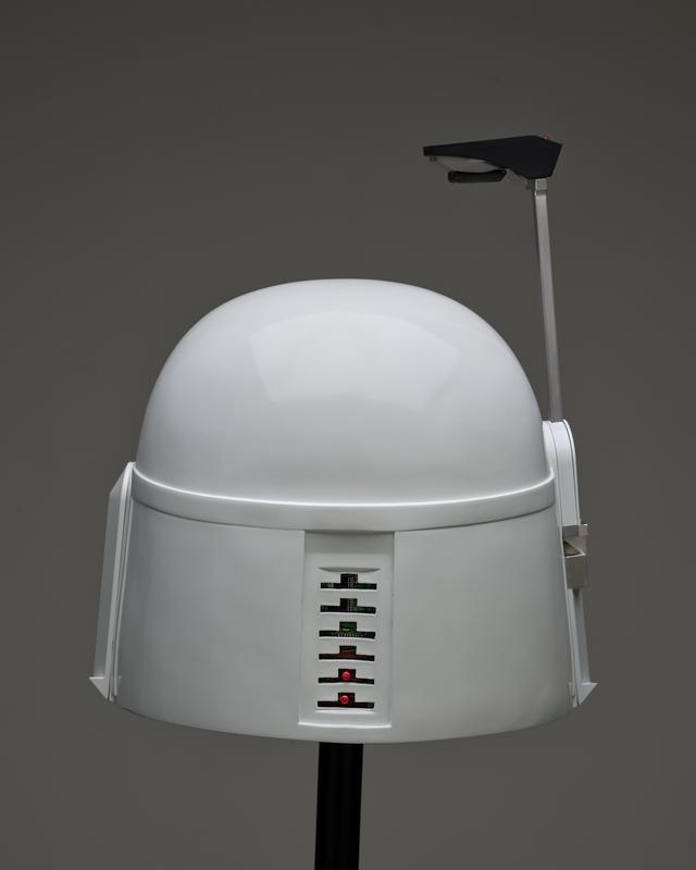

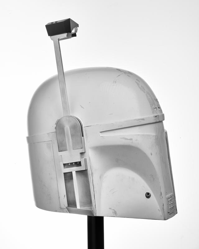

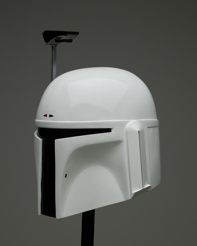

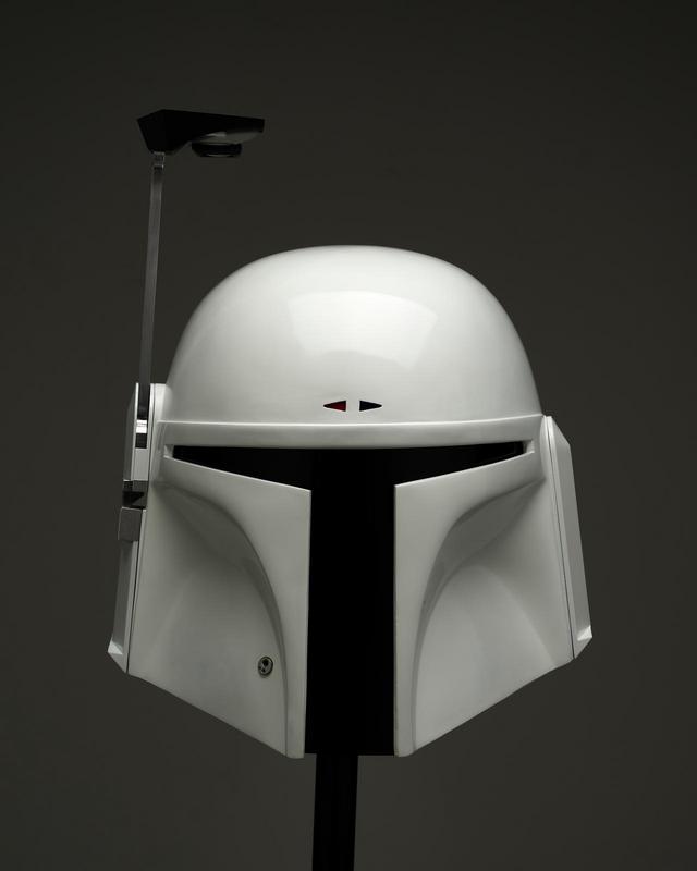

And here's the finished helmet!
I will bring it to the studio for beauty shots soon.
Finally got around to photograph the helmet.
