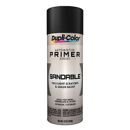

I've been making an attempt to try a lot of different primers over the past year, and I think I've finally settled on two I really like. Rustoleum Universal Bonding Primer, and Duplicolor Sandable Primer. The Rustoleum is a high-acetone solvent mix that adheres really well to plastics and epoxies, and the Duplicolor is a laquer base primer that adheres incredibly well and goes on super super smooth (seriously feels like it was wet-sanded). Both dry super quick (handle within 2 min and top-coatable anytime) and have stood up to gorilla tape pull tests for me. Only problem is that they're quite a bit expensive.
