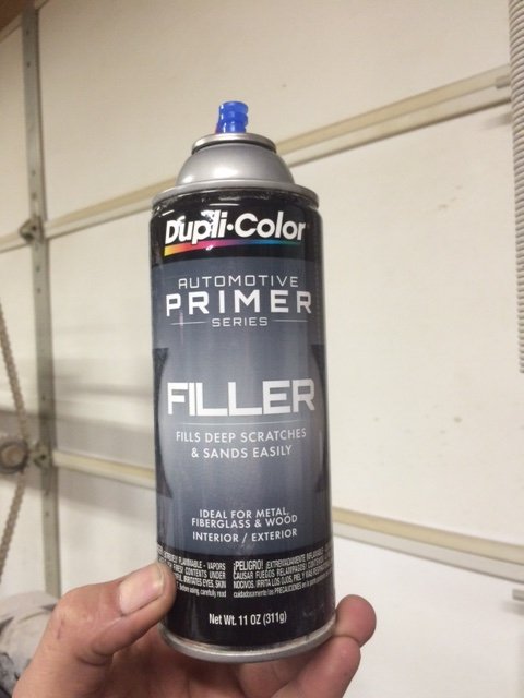

What material are you painting? If it is metal or fibergalss duplicolor self etching primer is great. If it is resin I have had success with regular rustoleum after applying valspar adhesion promoter for plastics.
Dupicolor Adhesion Promoter and Self-etching primer was recently recommended to me for a Cold Cast helmet I'm about ready to paint, it should work out great.

I like Duplicolor. Automotive paints are usually pretty rugged when they cure, and I've never had any issues with
spiderwebbing or cracking. I spray it in 2 to 3 light/medium coats and allow a few minutes between each one.
Duplicolor all day.!
