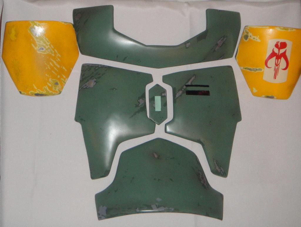

Here's the most natural-light lit picture of the PrePro 2 suit that I can find (all the ESB shots are much more strongly lit):
And my custom underway under similar lighting:

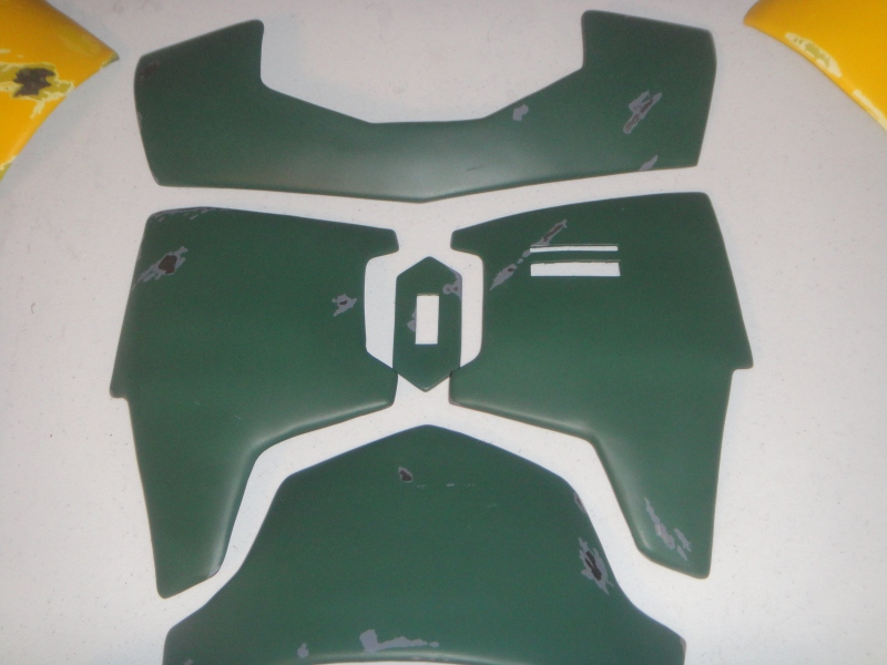

For context, the paint-up I'm doing is based on the idea of matching the gray-primer/POG scheme of the helmet, under the notion that an original-issue set would match in colors. I ended up using the US Med Green and Euro I Dark Green as the mid-layer on both, with the Panzer Olive Green as the oxidized outer layer on both. This is what my paint job looked like prior to weathering. You can see the US Med Green/Euro I Dark Green showing through the scrapes, with the gray primer as the deeper layer exposed in other places:
Even in contrast to the POG, it doesn't look too dark to me, but I don't know how it would look on a yellow primer layer versus gray. Since I wasn't going to be doing the yellow on anything but shoulders and knees, I didn't bother doing a paint chip of that combo...
