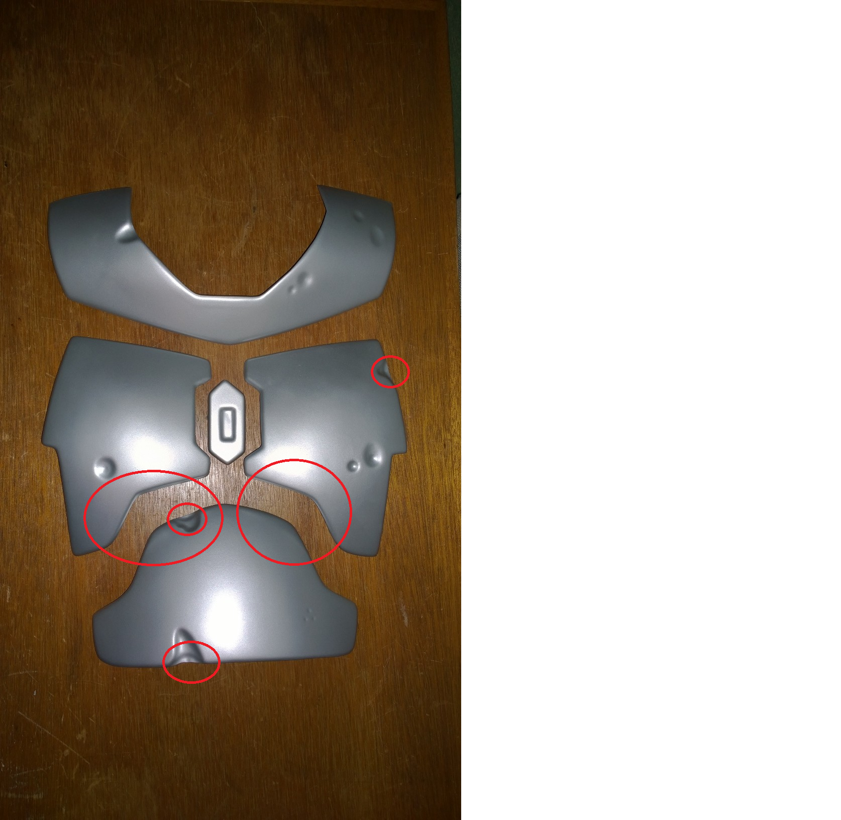

Thanks man! Can anyone tell me if I trimmed an appropriate amount from the damage edges? In my quick research I noted some people grinding away parts of their dents, but most seem to keep the edge in line with the intended armor edge, so I assumed that to be the best way.

It looks like you have more to trim...look at the gallery for reference pics to see how thick the armor should be and what need trimming.

I think the two chest pieces are what need trimmed the most, which is not a big deal in terms of painting because I need to reshoot them anyway. I didn't tack cloth them before spraying, so they have dust specs in the paint. They were also the pieces I tackled first, so they're worse-off than the belly and collar. I just looked at RKDs magnet attachment thread and he has pictures of the rear, where it shows how much lip he left. Very helpful.
THe Ab plate dents have that extra plastic which is what makes me think you didnt trim the plates thin enough
Edit: RKD does intend that the lowest portion of the dents at the edges of the armor be trimmed inward.
Original Quesiton: I think I know what you're talking about, and I was worried about those. You mean the most dented portions, where the armor is its lowest? I was going to grind those out, but looking through builds on here, it looks as those most people do not grind out that big of a portion, but just a slight bit of the edge. It looks as though RKD changed the dent from a one tiered dent, to a two tiered dent at some point. The builds where people have the first single tiered ab plate do not have any amount ground out. Maybe I'm just being too timid about it! I would be interested to know if RKD intends for that to be cut out of there, assuming we're talking about the same spots.
Take a look at the circled areas all of them show "flashing" extra plastic not intended to be left after trimming.
attachment.php
Thank you much. I didn't realize they were so thin. There are a wide variety of thicknesses people decide to leave them as from what I've seen in build threads, but now it seems like not many actually cut them thin enough!

That's good advice! I think a trimming tutorial would be excellent, at least as a basis for where to begin. As for what I did (likely not the best method):
  • I used a die-grinder with 80 grit to trim, which worked really well for the most part. Got a little carried away on the inside left portion of the collar. It's not too noticeable probably until I say something, but I cut into it too much and will have to live with it.
  • After trimming to where I wanted, I used a pretty coarse sanding foam to take down the edges, probably 200ish, just to get it back to the rounded shape, as opposed to the hard edges my grinder left.
  • After reshaping the edges, I used 600 grit to smooth them out.
  • Roughed up the face with steel wool and primed.
Just in case anyone ever inquires to a method to do it. I'm sure others have better methods... less clumsy or random than a blaster, errrr die-grinder. I am not particularly happy with the silver I had on hand. Since I have to redo a bunch of it anyway, I will be looking for a nice aluminum color. Thanks Fett 4 Real!
