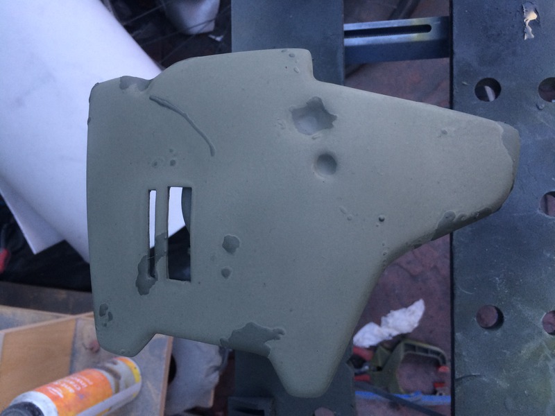

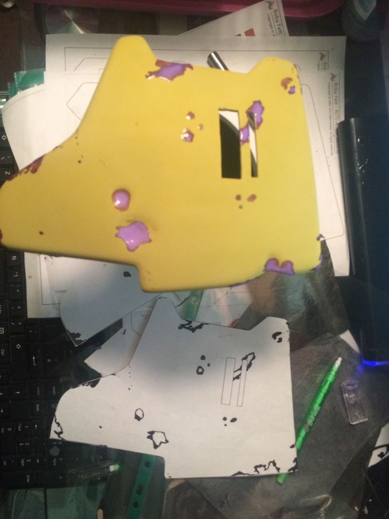

So i painted the final colour of the boba fett armour and its 116 Humbrol mixed with 104 humbrol 10-1 ratio mixed with a Humbrol thinner 50/50, sprayed with a Iwatta compressor and evolution brush

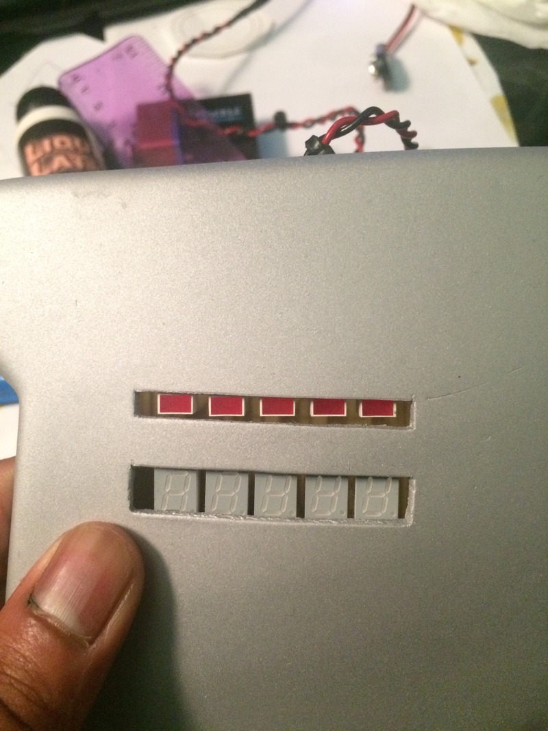

As you can see Silver no issues :

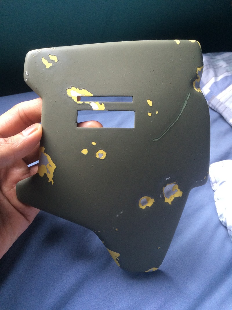

Yellow no issues:
ESB Green no problem :

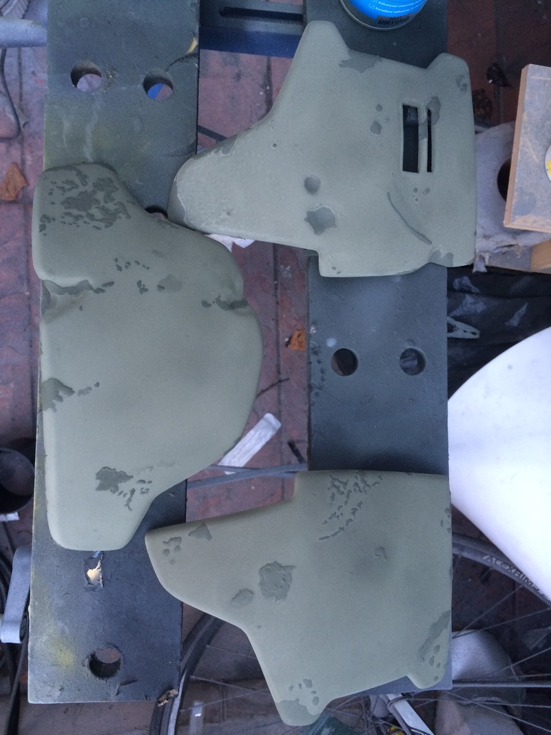

Now the second i go to finish it with the final shade of green this happens ! WTF !:
tried thin layers, tried warm environment, tried everything it keeps happening - went to the shop bought another 116 same issue
Whats wrong i cant figure it out
Thanks
There is a possibility that it is the paint. I've done some research on Humbrol and found many complaints on other forums about the formulation on their paints since 2013. From what I've read complaints include:
- Blotchy applications by pro level painters
- Paints never drying
- Color variations from tin to tin of the same number
- Matte paints drying glossy and vice versa
- Unmixable separation of oils and pigments

50/50 is PROBABLY too much....theres no magic forumula. You need to add a little stir...add a little, stir. Then when its the right thickness (not to thick but thin enough to go through the brush) youre good to go...Id add a bit of paint to the mix if you still have it. I like to put my humbrols into old model masters bottles so I don't have to open a tin thin it out each time....I make a batch thinned and all and go to town.

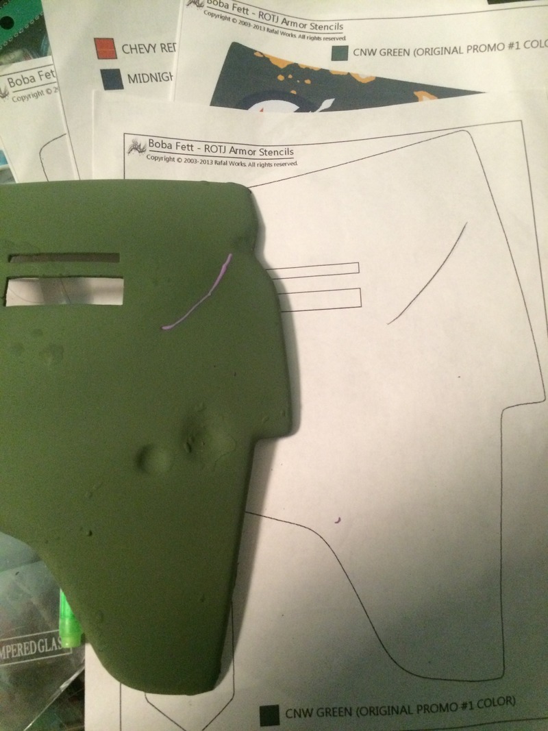

do i did a mix 5ml paint 4ml thinner 60/40 and used the electronic stir
the paint appeared to do the same thing- this lead me to believe the green was eating the darker green
so i put on a very thin layer of primer and sprayed over it

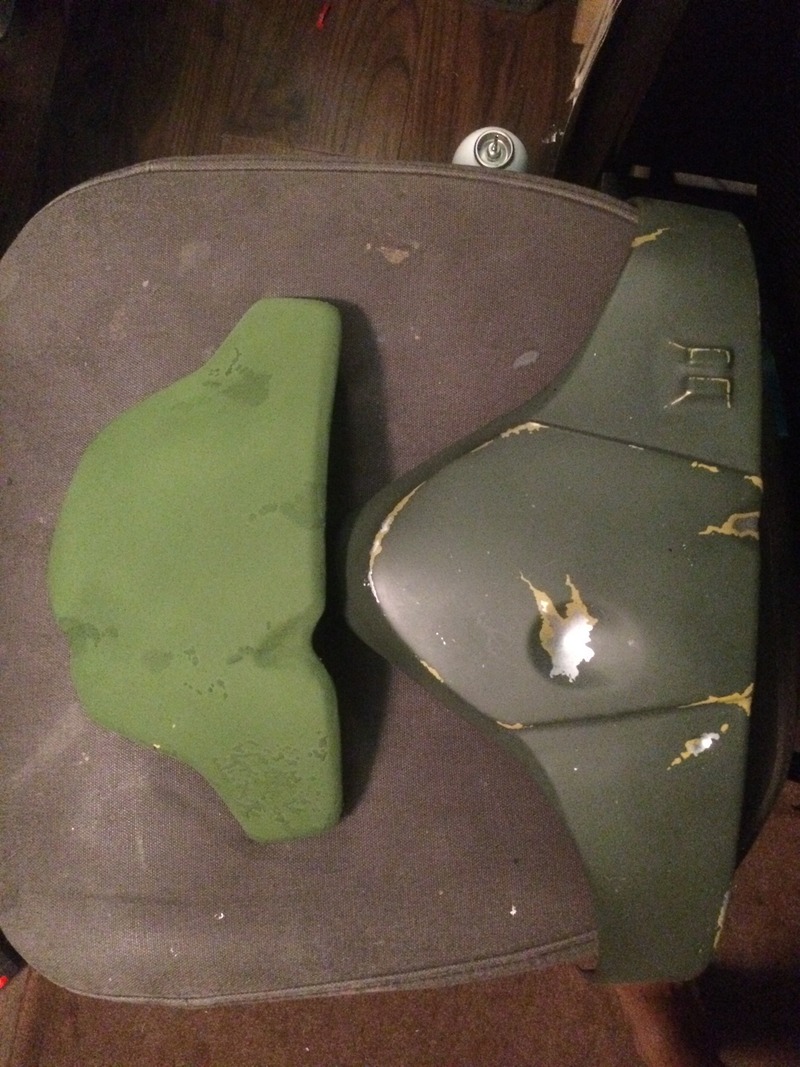

this was the result:
What do you think (i know it needs weathering) but is it ok for 501st standards i followed ralfets template to the dot
F4R pretty much said what i said in your thread over on the BHG lol. He is 100% correct in that there is no magic formula..i wish there was lol..but generally i do 2:1 paint to thinner if i had to give a number of some sort. It all depends on how thick the paint is to begin with, and the brands are all different as well. I also do the same thing and put the humbrols in model master jars pre thinned. As much as i like the humbrols, i hate those little tins!
Now onto what what you have there..it looks.... ok. The issue is the paint now looks way to thick. The layers should be very thin so you dont get those deep edges. But becaue you were having so many issue with the paint in the beginning, you really ended up with a very thick coat of paint. From a distance it would probably look fine, and may pass legion standards. If it was mine though, id strip it down, and start over doing whatever you did to prevent the issues you had in the beginning...less thinner, warmer environment etc.

i see what you mean about the paint being to thick - i believe its because of the primer it was thick even though it was a super thin layer
