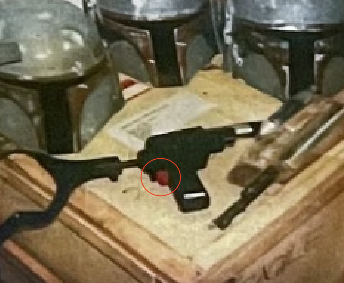

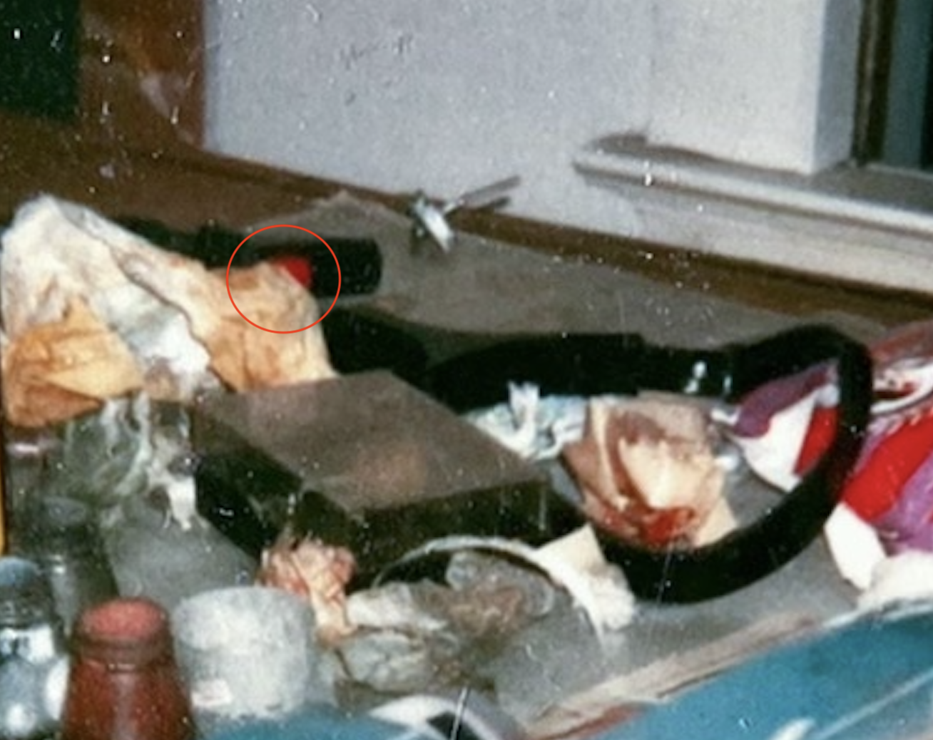

We know the sling gun(s) sent to Daydream had a red button because of the at least these two pics:

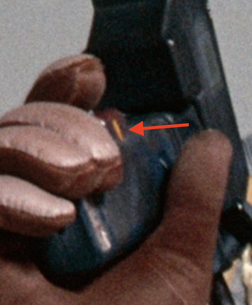

I'm almost 100% certain it was painted red because in pictures of the prop after it was painted at Daydream show the original yellow button underneath all the paint where the paint got scraped off.
How do I know for sure that is a paint scrape? Because my Kaisers do the same thing to the button. The plastic scrapes the side of the button on mine, too. Plastic-on-plastic scrape happening on the side of the button in nearly the same spot:

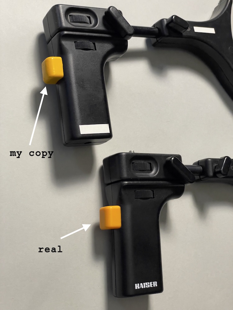

This means just painting the button yellow first would not be the best way to replicate the look, because the yellow might eventually scrape down to the base black plastic at some point. So why not just get the yellow button? I'd love to buy another one with the correct color button but those are pretty scarce (if anyone has one for sale or trade, let me know). The next best option is to copy the button and cast it in yellow plastic. So that's what I did. I used Smooth-on Rebound 25 to make a simple mold and Smooth-cast 300 white plastic to cast. I used a very, very old tube of 'Tints-all' yellow paint pigment I had on hand to color it. It took a couple of tries to get the color right. The tints-all probably wasn't the best option for tinting. It didn't want to completely dissolve and caused darker specs at the bottom of the cast. But for this purpose, the results are fine.
Now it's ready for a PP2 paint job....
I only have the one, and it's too yellow. I can probably make more, but I found some plastic material that is already the correct color and I'm going to experiment with melting it down and putting it in the trigger mold. See what happens. May be a better looking button.

The other thing is right after my last update a version with the correct trigger button came up for sale, so I grabbed it.
Looks like I was close on the trigger color, but not quite enough. It really is orange (or if you grew up prior to the 16th century like me before the color got it's own name, we can still call it yellow-red).

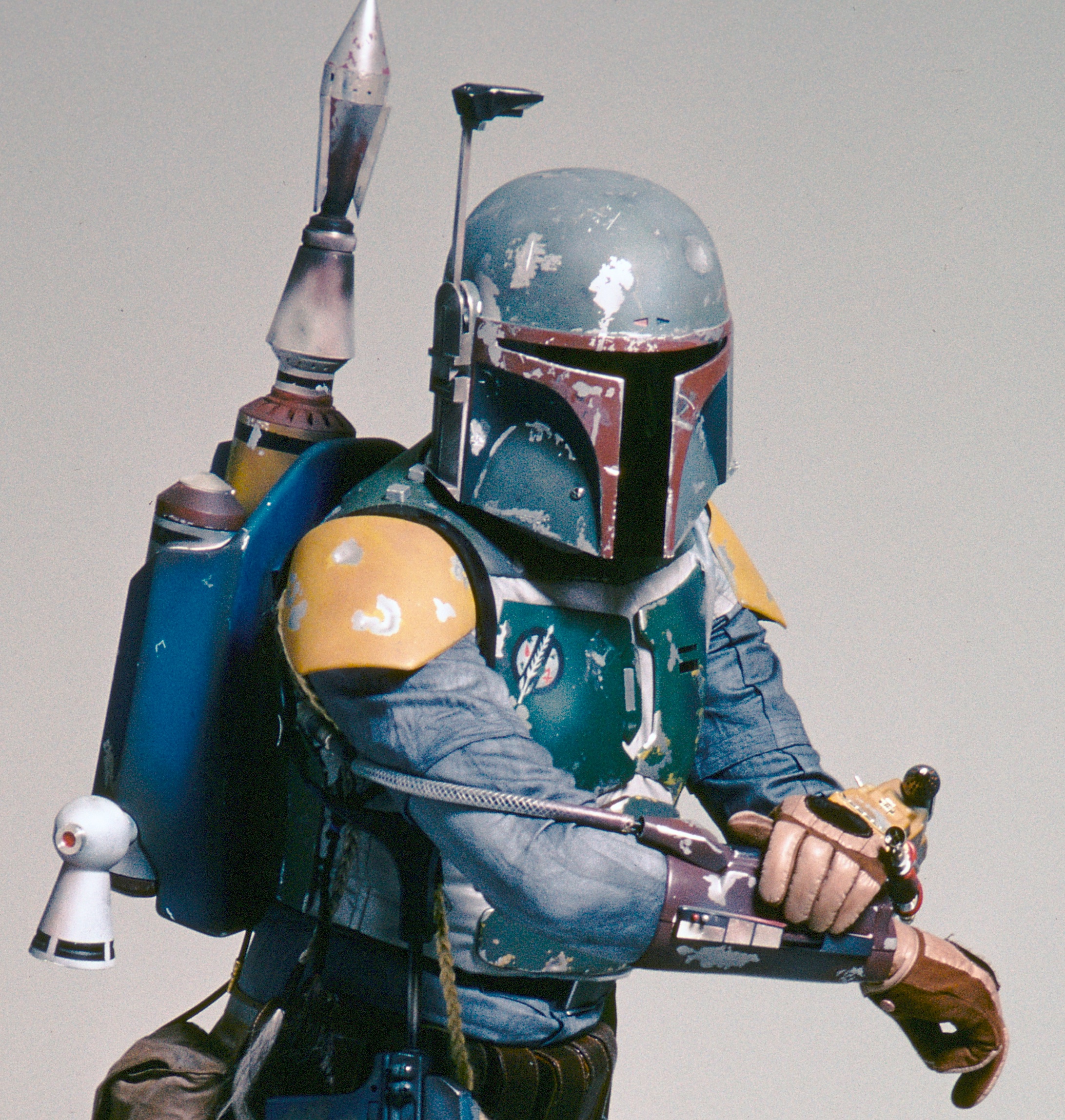

I've been trying to figure out the weirdness of the PP2 jetpack beacon. It has some unusual features. Namely it appears to only be three slots high at top for the light instead of 4 like all the others. And it has an asymetrical black stripe on the top segment below the slotted top.
I've been asking folks what they think and I agree it appears to be a combination of masking tapes that didn't get pulled off all the way.

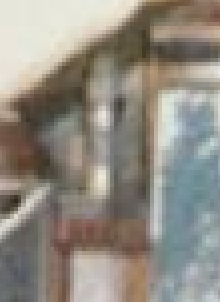

I feel like it's two layers, one that got hit with silver and another that got hit with black. Those are both colors that are on the jetpack in that area, the silver being the base layer. The weird shape in the back is probably just a tape-end coming up. The anomalies also seem to be present during the shoot at Kenner for the toy marketing shots:
So I'm gonna try to just make that work with masking tape, but if anyone has other ideas, please feel free to discuss here.

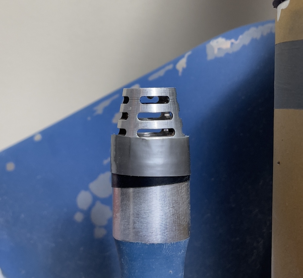

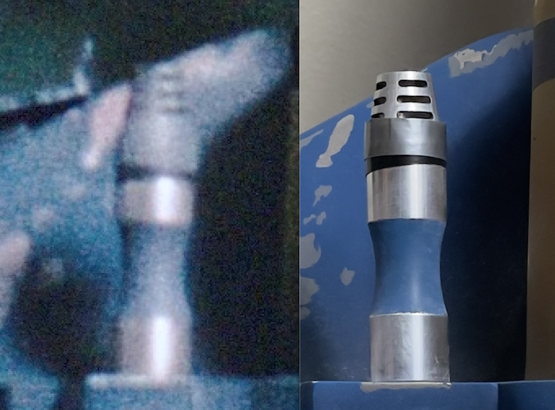

After discussing it with a number of bright people in various other places I decided to go with duct tape over electrical tape to replicate the funkiness of the PP2 jetpack beacon.
Of course, I'd prefer a more accurate beacon than this 15 year old one, but I don't know anyone making this style with the press-fit top and without the dome on top.
