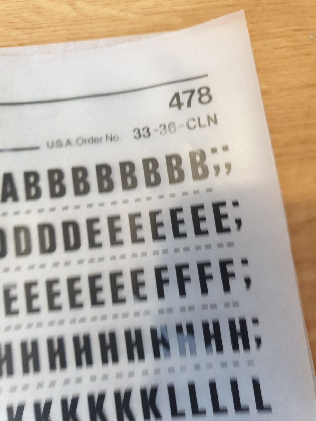

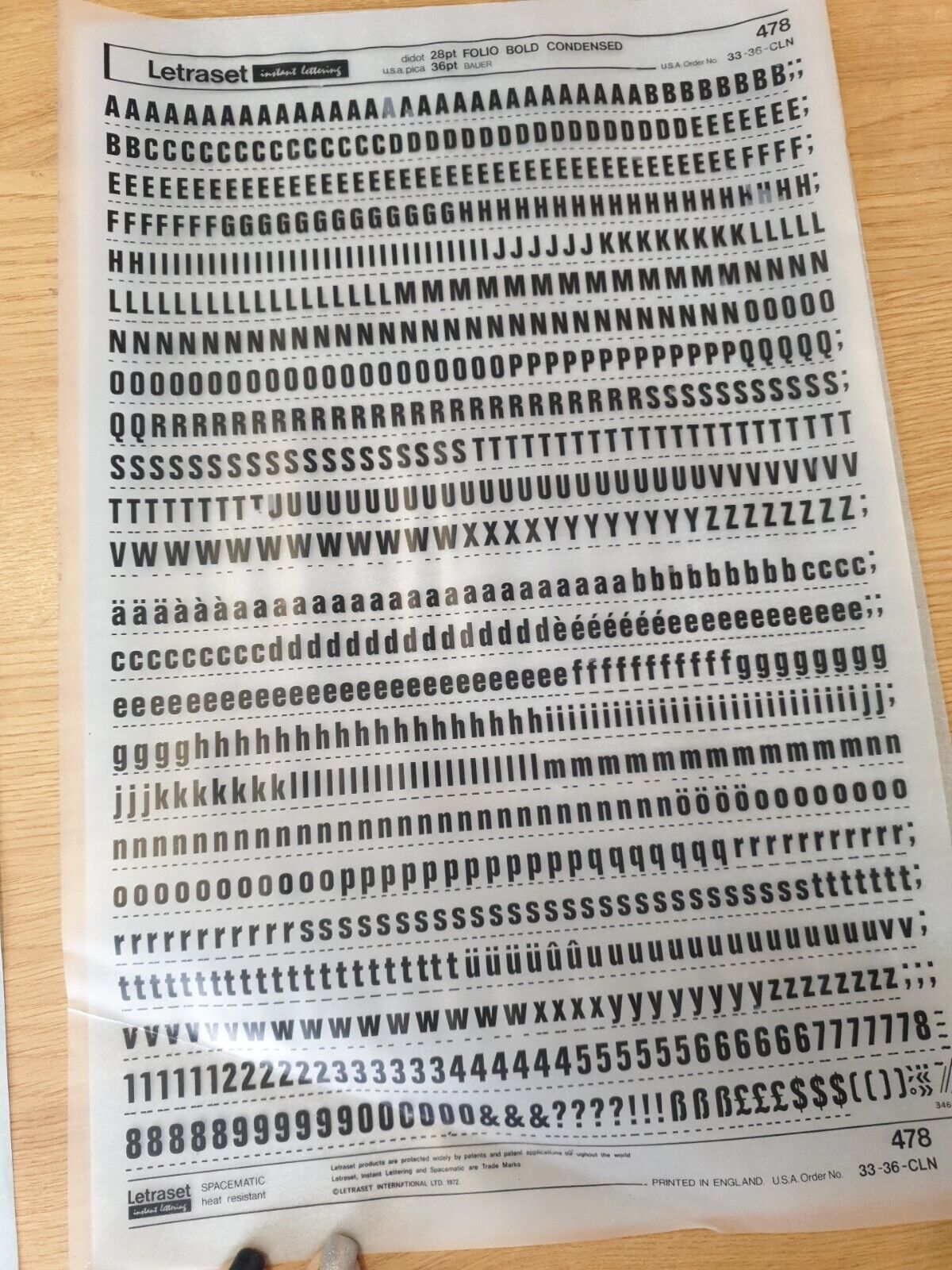

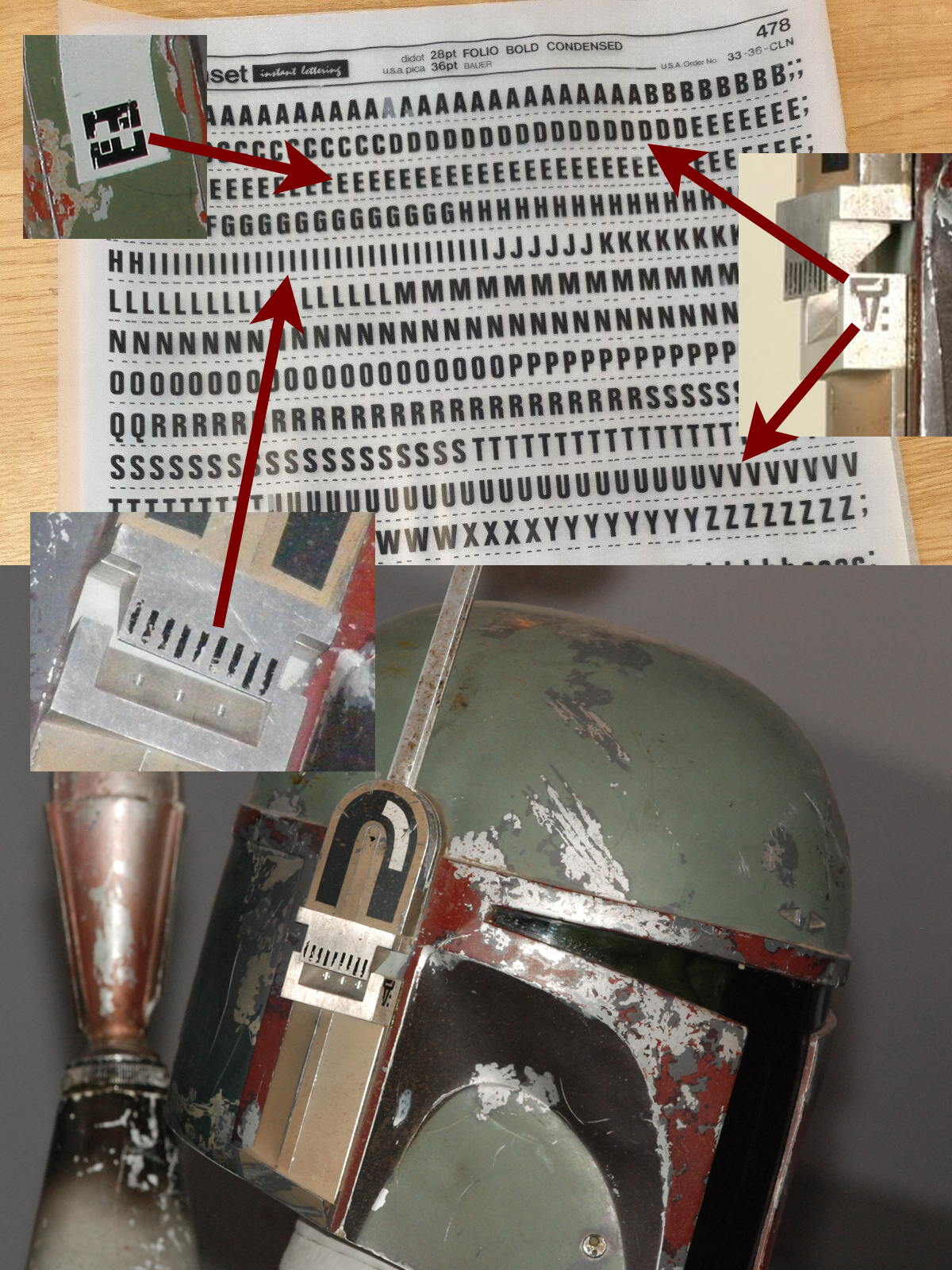

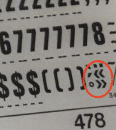

Finally got an original Letraset sheet in fantastic shape so I can do the helmet runes closer to how they looked on the original during filming in 1978.
RafalFett has a terrific post on this sheet here: Letraset Dry Transfer Font - Folio Bold Condensed.
you can also make runes for the PP1 and PP2 jetpacks:

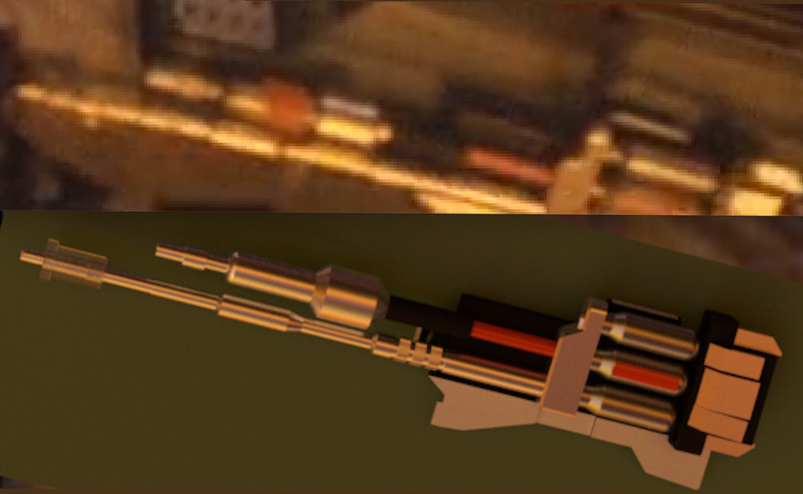

ConvergenceProp has been working for a long while on this awesome ESB flamethrower and partnered with MinuteFett to finally bring it to the community. This is a CG render (bottom) of the new flamethrower to compare it to a screen cap of the original (top).
This little puppy (and it's much smaller and compact than people are used to!) sets a whole new standard for this piece no other previous version can touch. ConvergenceProps is doing a write-up detailing lots of very interesting details including a found part that's at the heart of it. And MinuteFett will be making these available very soon. Really looking forward to getting this on the new gauntlets.

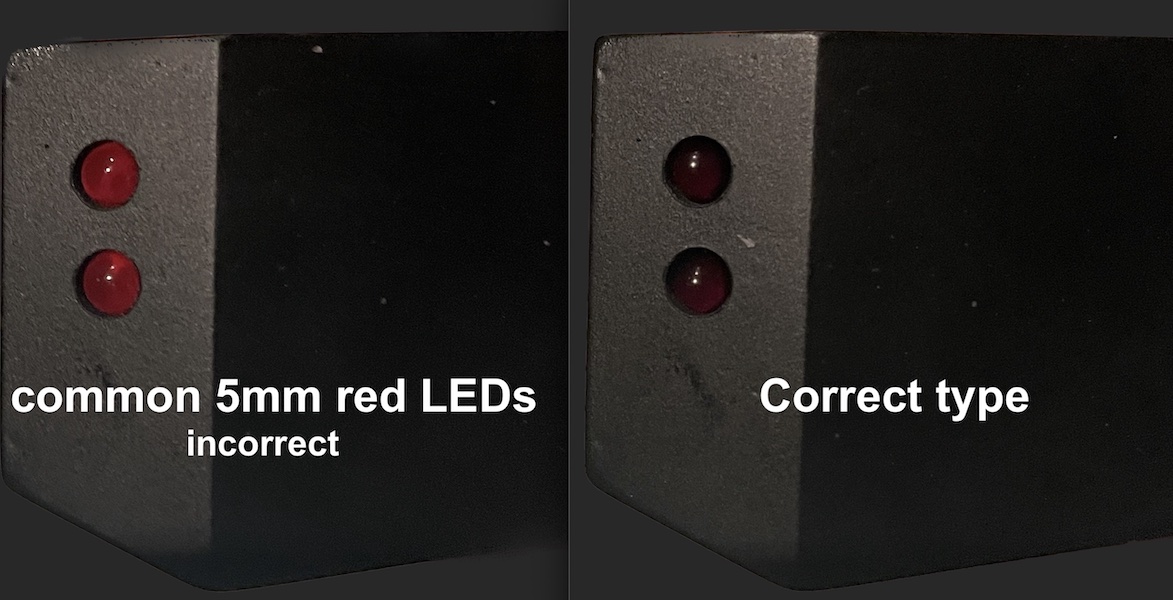

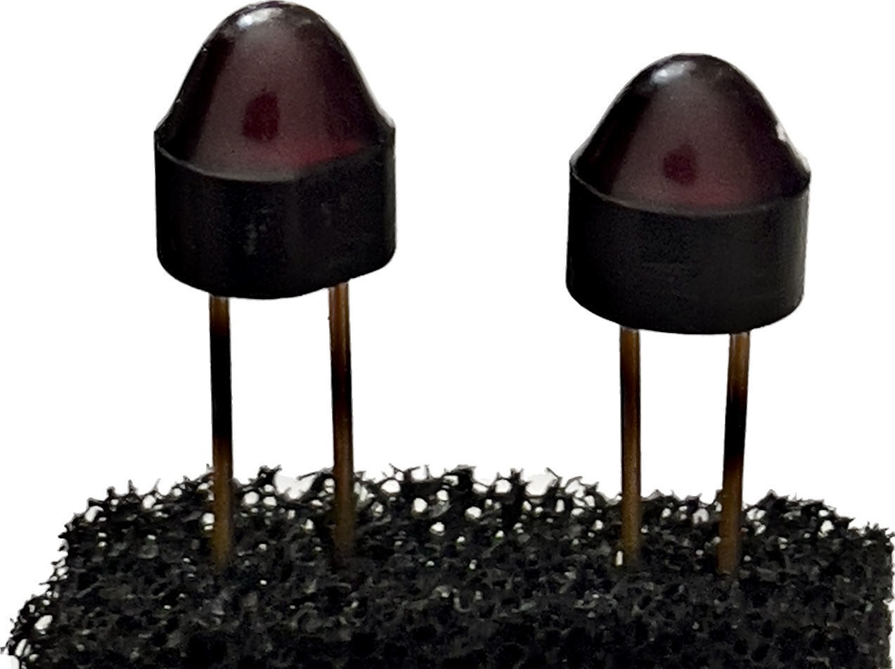

I updated this information on the last page of my helmet electronics post, but I will put it here as a fresh update for anyone who missed it.
The two red LEDs in the Fett rangefinder are a specific type of LED which became obsolete by the 1980's. They haven't been manufactured since the late 1970's. They are the Fairchild FLV102.
These differ from the common modern type in several ways, but most notably, they are much darker when not lit. They used a darker red plastic to cut down on ambient light interference since the light output of LEDs at the time were often not high enough to counter ambient light under some conditions. This made it hard to tell if they were on or not. So for a time, these were the best LEDs on the market until light output dramatically increased and ambient light was no longer an issue.
The flv102's in action:

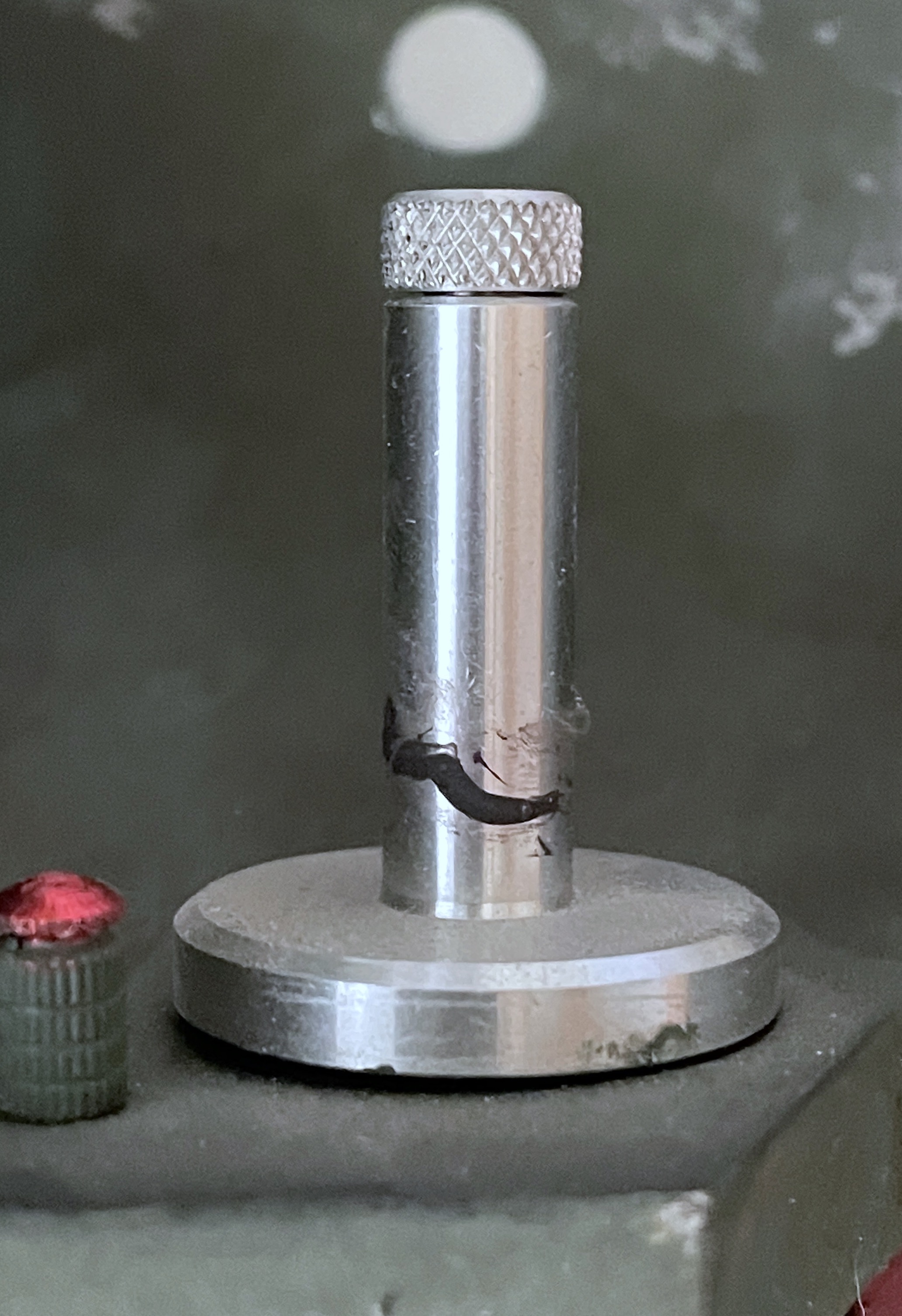

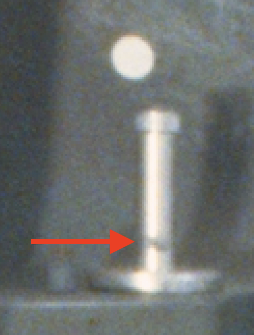

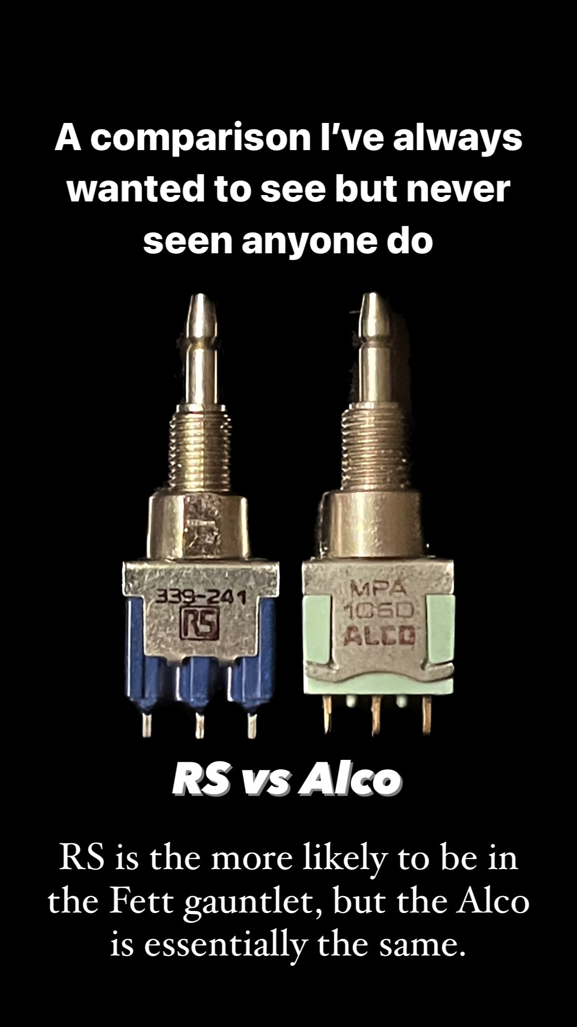

why the RS is more likely?
Two reasons
1) RS Components was the go-to source for a lot, if not most, of Fett's electronics, which were completed in England. Alco is American.
2) Someone I trust has verified for me the RS 339-241 is indeed the correct part.
Hopefully those with evidence will share when they can someday. Otherwise, I see no problem using Alco if that's what you have. Which is what I was curious to find out.
